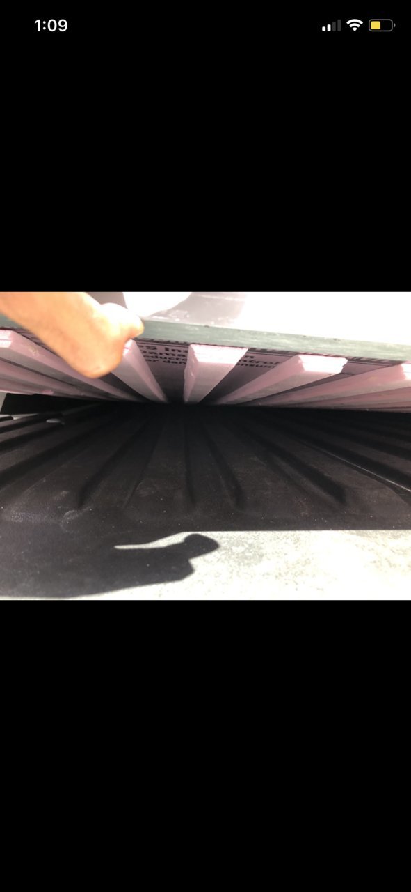

    I'm glad to see people having concerns about weight, if you can your truck lighter, the benefits are huge. This was the cargo area, or base plate build I did in my 2007 4runner. When I built this one, I used 3/4 inch high ply birch. My reason being that if I'm taking the time to actually build a proper way of securing gear or cargo, it better do it's job at holding things, and not just holding things while I cruise to the local mall parking lot.
    I just went out and weighed a 180 square inch piece of that material and it was right around 3 pounds. The google machine says 1/2 inch will be closer to 1.5 pounds per square foot.
    Let's do some quick/rough math, numbers don't lie.
    A short bed measures about 20 square feet, and then you subtract the wheel wells, so lets say we can call it 15 square feet for the sake of easy numbers. Even with 1/2 birch (which I think it too thin on its own for my uses) would come in at 22.5 pounds. Obviously a 6 foot bed will weigh more. That's JUST the wood, no hardware, no tie down points, no coatings, or ANYTHING and that stuff adds up fast.
    With that being said in my 4runner I faced the backside with two layers of fiberglass (for strength and securing the hardware for my tie down rails) and applied a truck bed liner coating, so the setup wasn't light, but it was very strong and effective. With my rear seat delete, I still think I ended up losing weight overall.
    Sure the benefits of a dedicated floor panel are awesome, but as the saying goes, there is no free lunch. I think if more people took the time to weigh things, or their rigs, they would be shocked. 20 pounds here, 50 pounds here, 100 pounds here.....it all adds up.
    Composites are a whole different ball game, and I think could be a great solution for base plates, but $$$$.
