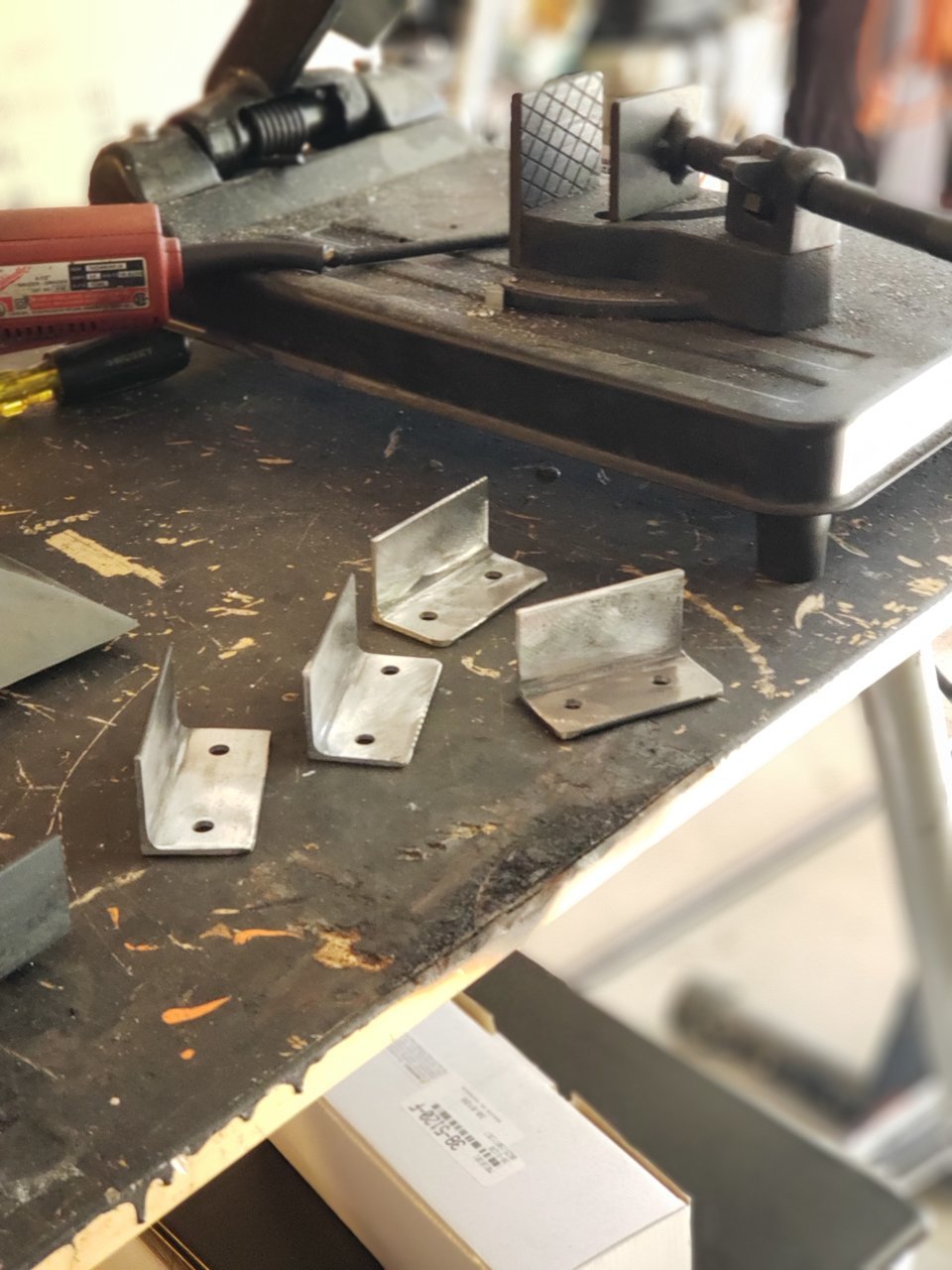

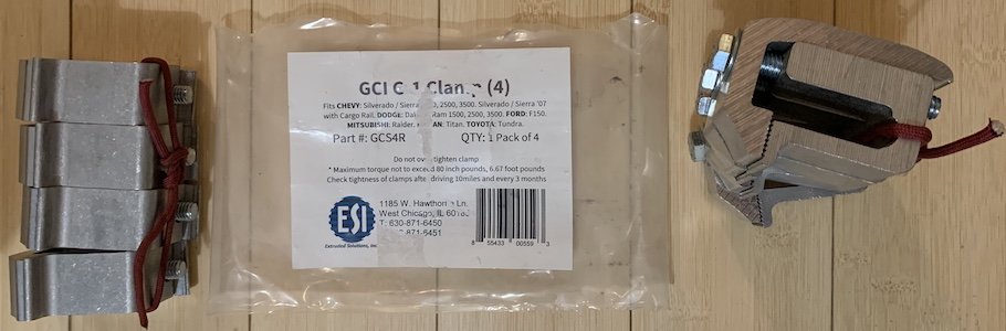

    Edited since I sold the clamps, but leaving info here for other 1st gens.
    For those with a 1st Gen Tacoma, the GCI G-1 Clamps won't work without modification. They are not quite deep enough to fully clear the sheet metal lip they mount around.
    I went through the process to make these work for the 1st gen so that the clamps holding the Vagabond to the truck bed were shorter, slimmer and didn't have a protruding edge to catch humans, dogs and gear when moving in and around the truck bed.
    I threw them in the mill and used a 5/8" end mill removed material shown in the photos below.
    Click through and/or navigate through the photos to see the details.

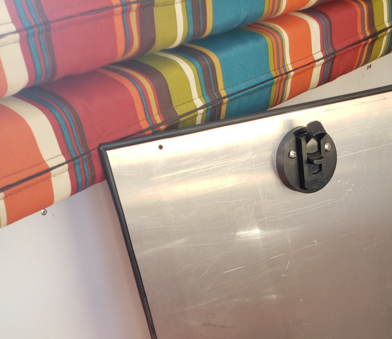

    Please keep us updated on your build, it'sincredible! What's the sheet material you're using? Starboard?
  5. Oct 27, 2020 at 4:40 PM
    #4405
    excav8tor
    excav8tor Well-Known Member
    Mar 1, 2016
    #179882
    154
    vic
    2016 Toyota Tacoma TRD sport 4x4 White
    Hey thanks , so the sheet material is aluminum. I finish the edges off with car door edge molding for a professional look

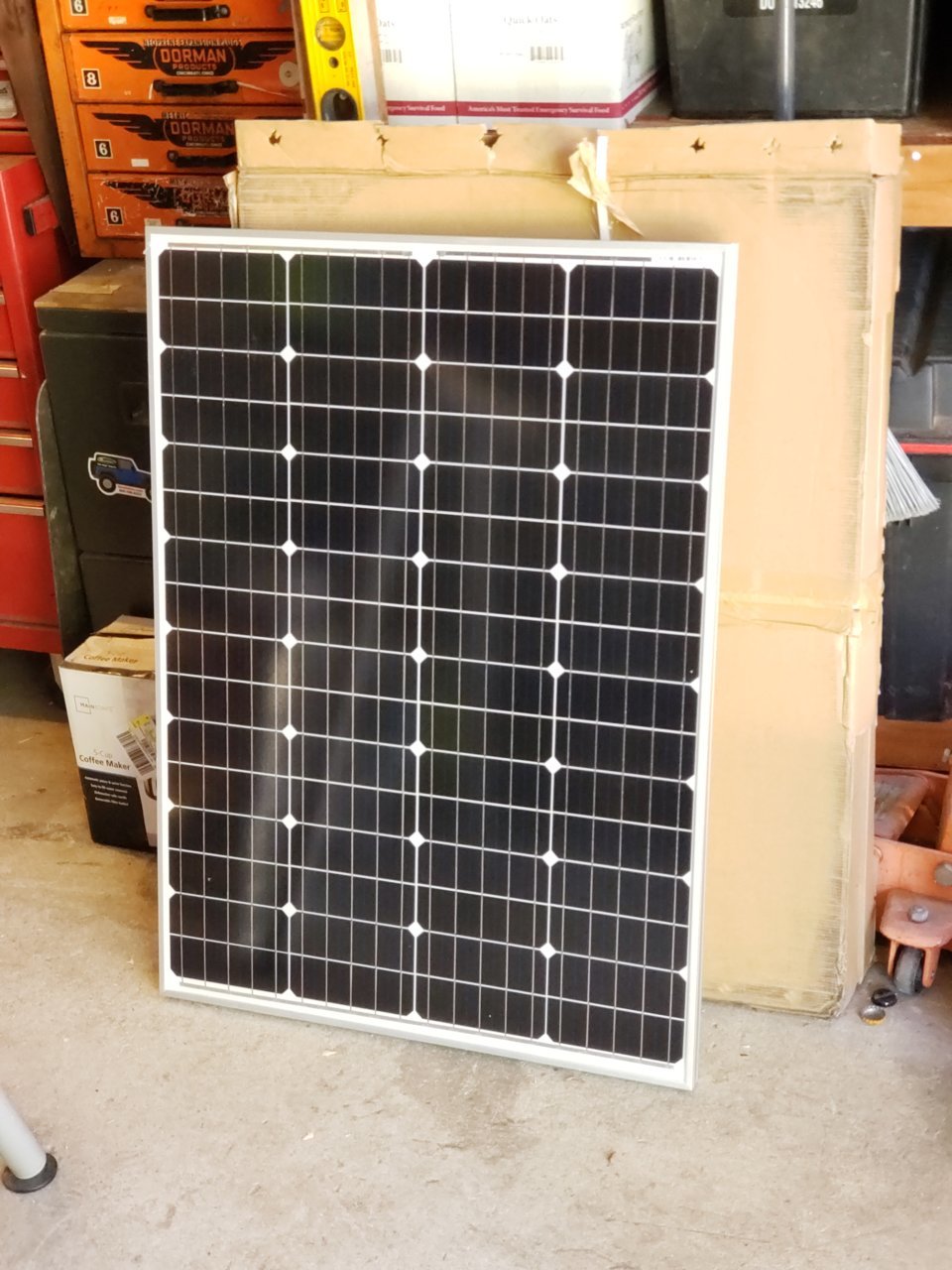

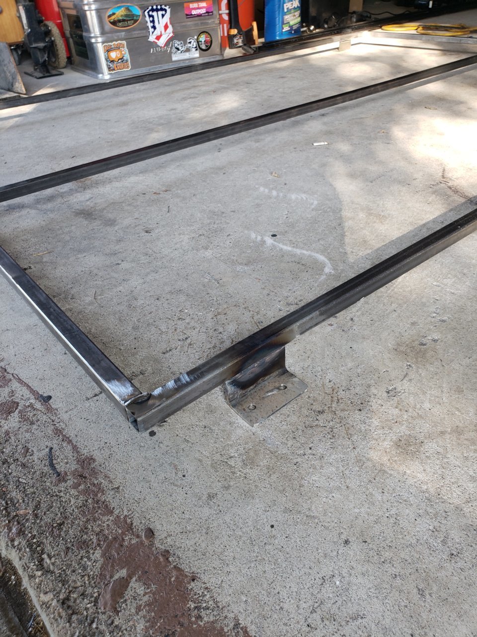

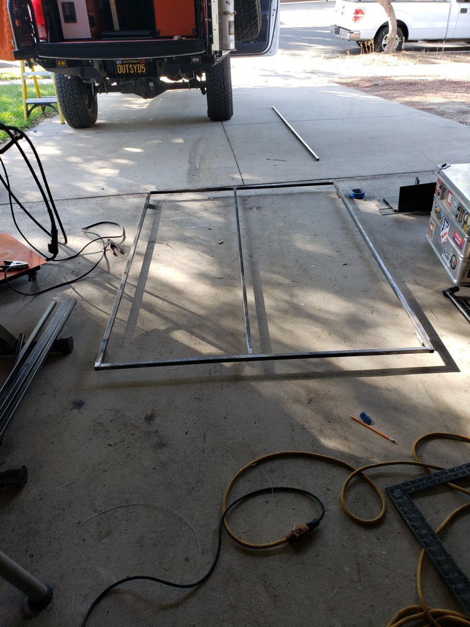

    20201104_110848.jpg 20201104_133144.jpg 20201104_141709.jpg 20201104_141730.jpg
    So today begins the solar build. I contemplated using the L track like most everyone is doing, but honestly I don't see myself needing to adjust rails once they are in a specific position. So I'm making my own rack using 16 gauge 3/4 steel tube. The panels will insert inside the frame (which should protect them somewhat from tree branches) and will line top and bottom rather than side to side.
    This may allow enough room for a paddle board on the other side.
    The frame is almost completed, then a dry fit and off to powder coat if all looks well.

    How many watts of solar are you planning?
  16. Nov 4, 2020 at 3:11 PM
    #4416
    excav8tor
    Mar 1, 2016
    #179882
    154
    vic
    200 watts, 2 panels
