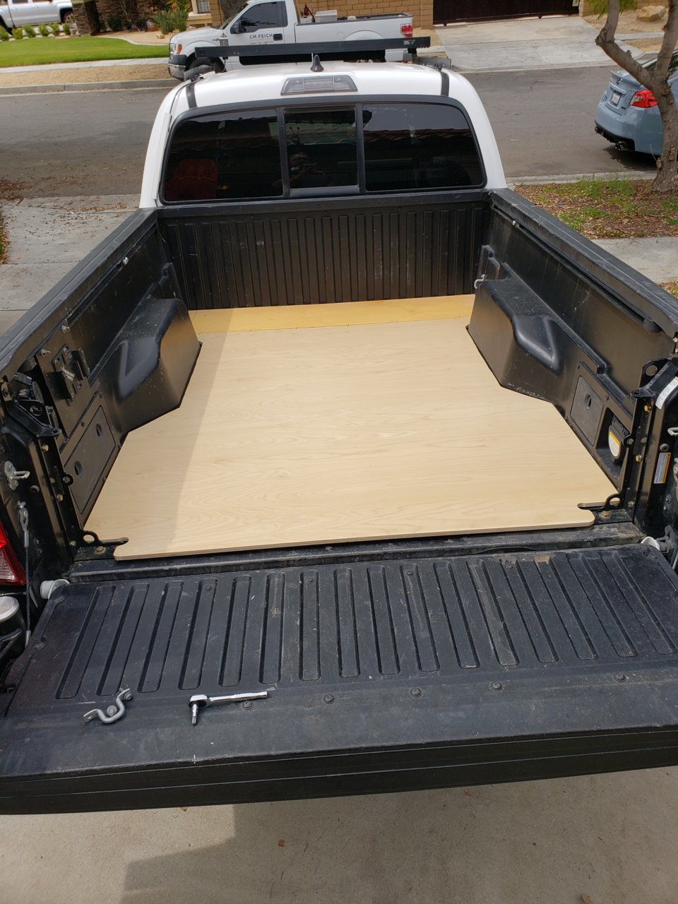

    This may not work if your using bed stiffeners, Trim the baseplate around the bed stiffeners then drill some new holes to hold down the baseplate

    2016 Toyota Tacoma TRD sport 4x4 White
    Here's a look at the baseplate tried around the total chaos bed stiffeners.
  4. Nov 5, 2020 at 1:50 AM
    #4424
    SliMbo4.0
    SliMbo4.0 Well-Known Member
    Dec 15, 2015
    #172322
    1,435
    Rick
    Colorado Front Range
    07 Tacoma DCSB TRD offroad
    BP51, BAMF hangers, BruteForce HC, SCS, Vagabond Drifter
    I would suggest not using the stock bed bolts. People have done it but I did not feel comfortable holding my $10K investment with even less threads. People that utilized the stock bed bolts also used spacers between the baseplate and bed to keep the baseplate from bowing/breaking at the point of anchor and then coming loose from no tension on the bolt.
    Food for thought...GooseGear baseplates don't use the stock bed bolts for a reason. Just drill thru the composite bed on top of the ribs and and bolt down using whatever hardware you want.
    ***Just remember that whatever threads are spaced out due to the baseplate thickness are NOT holding your bed, camper and everything else inside to the truck itself. If those bed bolts strip out and fail...well, now you got that flat bed you didn't know you wanted ;)

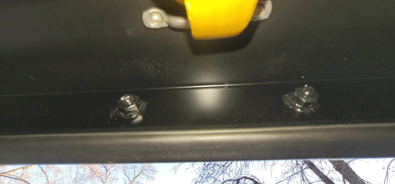

    #267279
    73
    Here's my first mod. I bought a dulled finished stainless steel handle from McMaster Carr. I think it matches the camper perfect. It made opening the heavy duty lift struts way easier! The handle is solid steel so it's kind of heavy, but nice quality. 20201106_161601.jpg 20201106_161616.jpg Screenshot_20201105-191928_Chrome.jpg
  18. Nov 6, 2020 at 4:58 PM
    #4438
    joeydurango
    joeydurango Nightfall Overland
    Sep 21, 2019
    #305951
    400
    SW Colorado
    Heavily modified 2015 TRD w/Drifter
    That looks like a Taiwanese version of the Don-Jo USA-made door handles... except more expensive. Don-Jo makes one in aluminum with a satin finish, I just ordered one. $18 on eBay.
