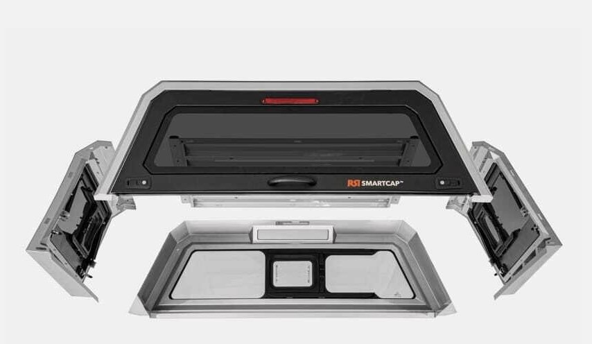

    Wonder if anyone change the back window lock to compression latch/lock or if its an option like the Smartcap?
  15. Nov 10, 2020 at 5:32 PM
    #4455
    socalexpeditions
    socalexpeditions IG: @socalexpeditions
    Sep 22, 2017
    #230791
    5,396
    Good way to lock yourself in hahaha. The Vagabond handles let you turn them from the inside so you cannot lock yourself in.
    These look similar to the frontrunner door latches that can't be opened from the inside (so technically, it'd be difficult to lock yourself in since you can't close the latch).

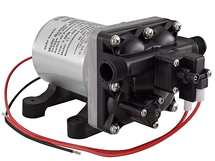

    Does anyone have experience with designing an on-board water system? I am soliciting any input on my design.
    This is one of my winter projects, but I have absolutely NO experience with water systems. I tend to think of water designs similar to electrical designs (my professional area of expertise), but I know there are definitely differences.
    Some of my design goals include:
    • Be able to filter creek or river water to EPA worst-case standards (99.9999% bacteria, 99.99% virus, 99.9% Crypto/Giardia)
    • Double filtration of water so that water in the tank is clean, and water is filtered prior to use
    • Able to switch system from fill mode to use mode, reducing tubing required
    • Storage of 15 gallons of water
    • Vent won't leak water when driving on rough road
    I was excited to find the Water Pure Technologies filters. It seems like most overlander's have installed UV water purification systems. I find these to be overly expensive and complicated, since they required power. Also, it appears that most of the UV lamps need to be replaced yearly. The Water Pure Technologies will filter water to better than EPA (99.9999% bacteria, 99.9998% virus, and 99.99% Crypto/Giardia). The filters last over 100,000 gallons.
    I have copied Dan Grec's design for the double-filtration system. I have never used three-way ball valves, but it seems like they should work. Dan implemented his system using four two-way valves, but that seems overly complex to use.
    One of the items I have not been able to find is an air relief valve. Many people have a vent hose that is run higher than the top of the tank instead of an air relief valve. This isn't really an option for me, since I am trying to fit everything in a bench seat.
    Here are some of the links to the major components, for those interested. Thanks for any ideas you have.
    SHURflo Pump
    Ronco 15 Gal Tank
    Water Pure Technologies Filter
    wally11, SaphiraTaco and HCJ like this.

    EDIT: I looked at the diagram again and it looks like the water is filtered once as it goes into the tank and then filtered again as it is used. Nevermind below…
    Maybe I am missing something, but running the filtered water back through the tubing that dirty water was run through kind of makes the best filter greatly reduced in efficacy, right?

    That on-board water filtration system is ingenious and progressive, @MapJunkie what are some of the use-cases where you feel it would be helpful?
