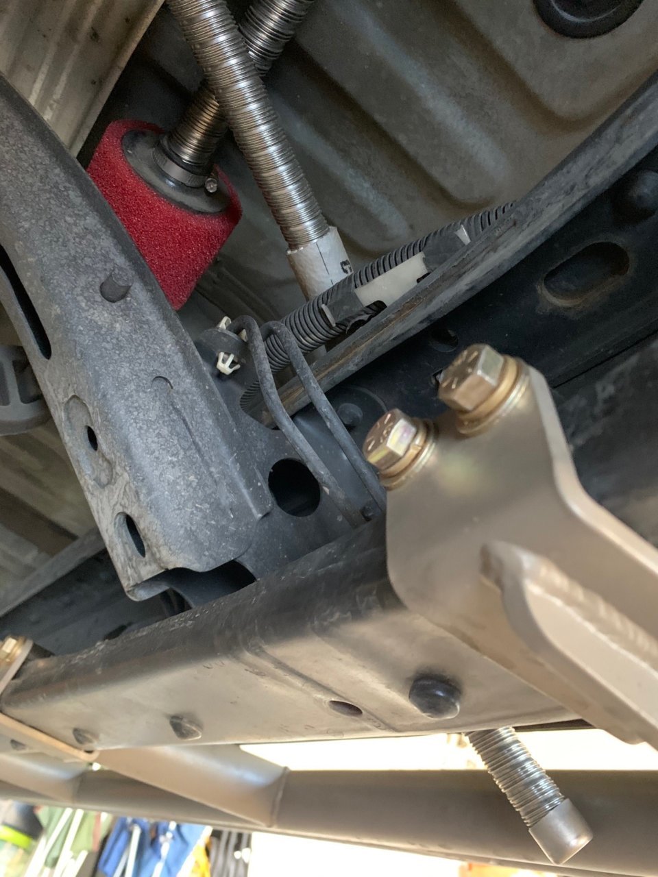

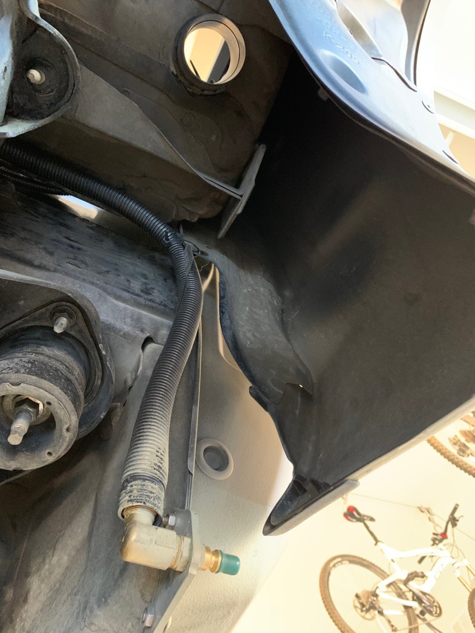

    Has anyone thought about installing a Propex in the wheel well? Phil mentioned this concept when I picked up my Drifter, but I don’t think he has implemented it yet.
    I did a proof-of-concept fitting with cardboard and plastic ducting. I made a box with the same dimensions as the Propex and routed the ducting through the cubby.
    I think it will work, but it is going to a challenge designing and fabricating the bracket to hold it. I think I can mount it using the threaded bosses for the cubby.
    Is this a good idea? The main disadvantage I can see is that any maintenance is going to require lots of work to remove the unit from a very tight space. I love the idea of getting dry heat without taking up bed space.

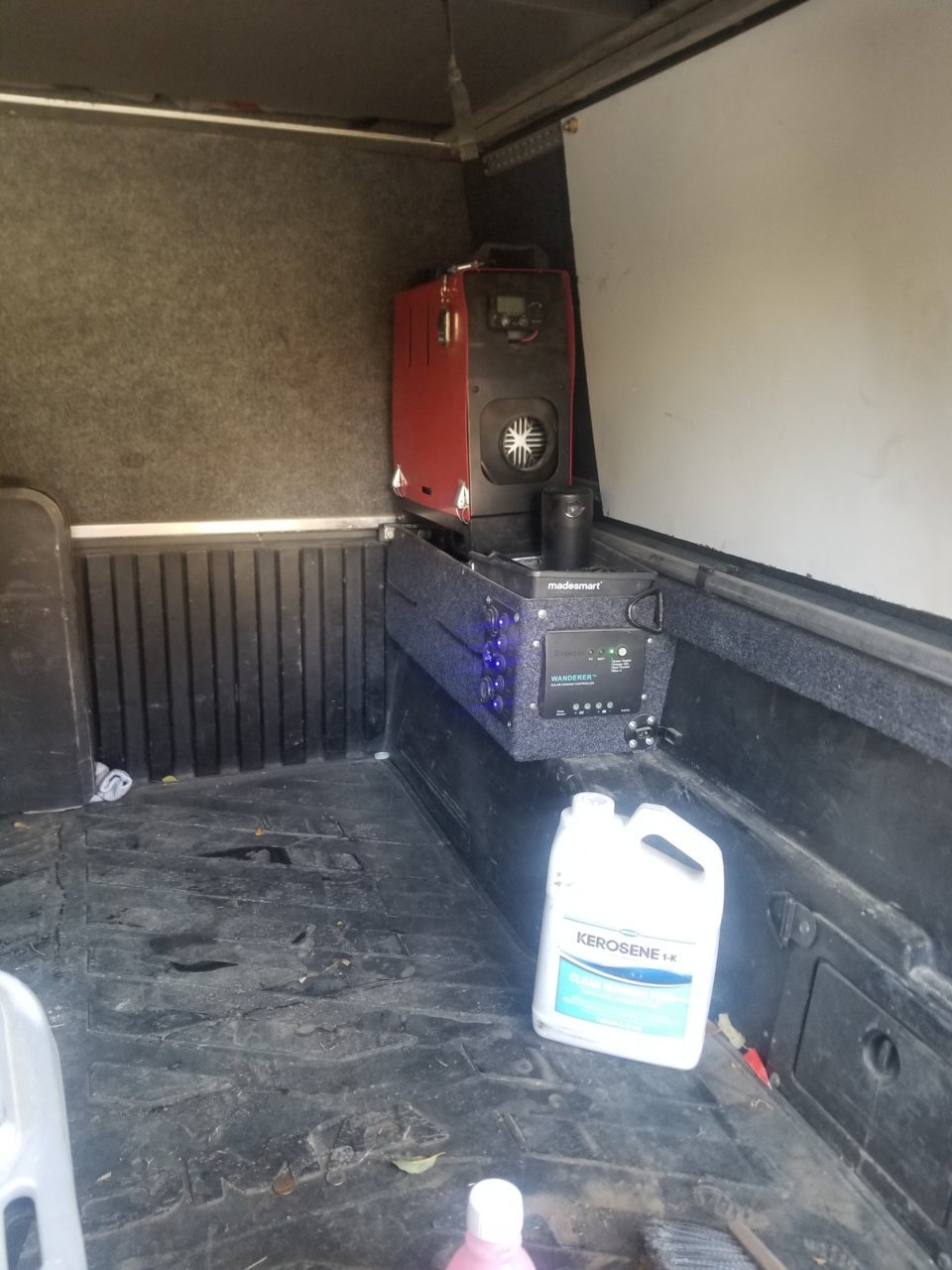

    I haven’t done any research at all, but with the propex being propane, can someone speak to the reliability in higher elevation and the possible condensation it can produce? These are the two main factors I went away with the buddy heater and with both units being propane, wasn’t sure if/how those problems are eliminated with the propex. The propex has a hefty price tag so I assume its a non-issue, but clearly don’t know the science behind it.
    I purposely made the area where I have my diesel heater - the same dimensions of a propex l, should I feel the need to upgrade to one.

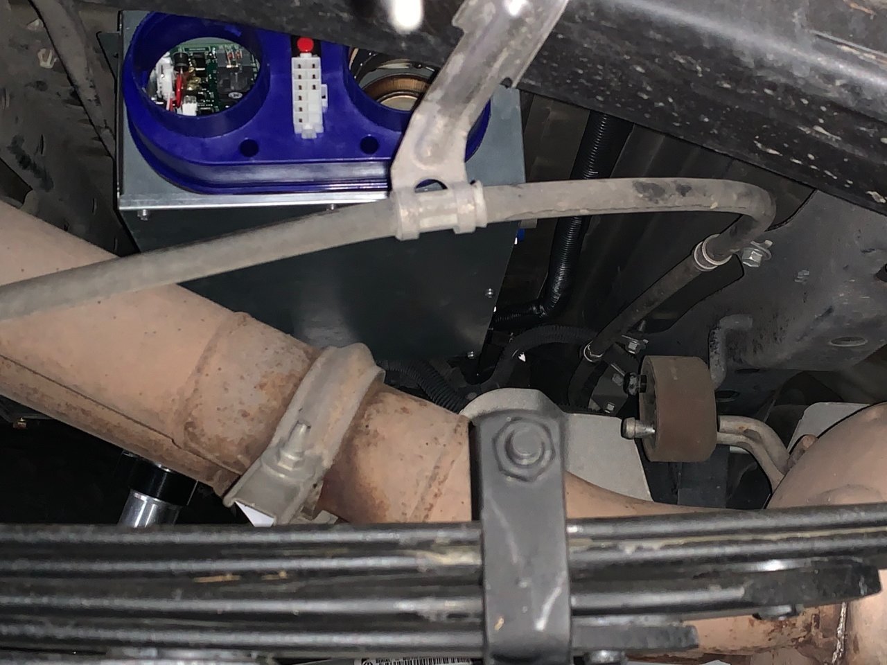

    Iggy’s design uses his spare tire location. Because I am running stock tires (by design) I would like to keep my spare in the stock location. Try as I might, I can’t find a large enough spot to mount it in another location under the vehicle with the spare tire in place.
    Here is @Iggys install.

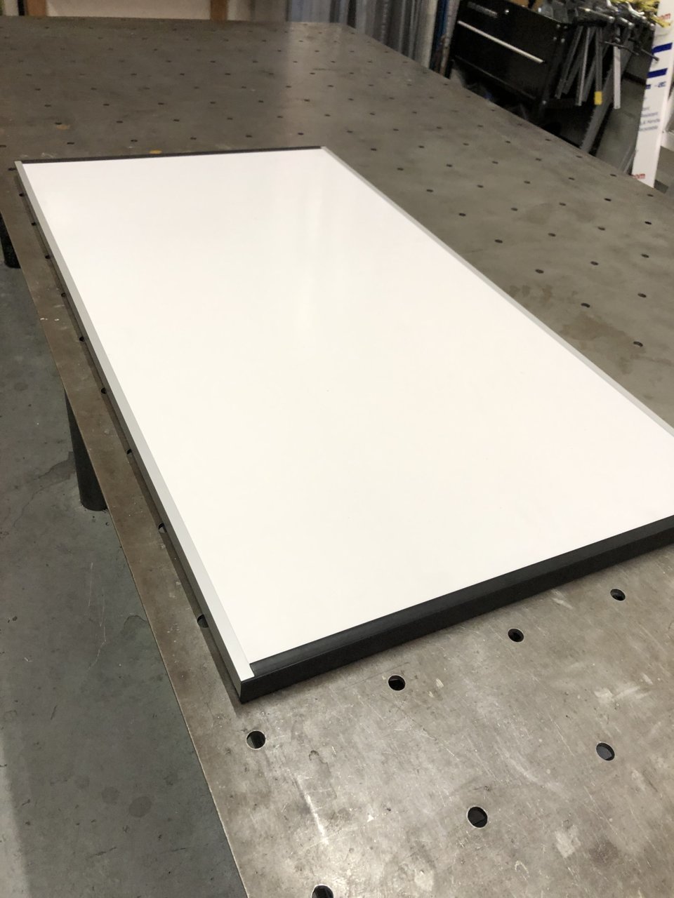

    Bed Extension
    I got my bed extension yesterday and I am impressed with the new materials. The old design was fabricated out of the same materials as the bed platform - strong, but not visually pleasing.
    The new design uses a thicker composite and looks better. I have been using a small piece of plywood as an extension. Unfortunately, I could only use it in the middle of the platform due to its lack of strength. This VO platform will work at the rear of the platform and will be easy to tuck under the bedding when not in use. This will preserve maximum interior space.
    Does anyone with a new Drifter know if the bed platform now follows this new design with the 1” thick composite? I would buy one if it were available.

    i was at VO a few weeks ago and was shown the new bed platform that is the new materials /design

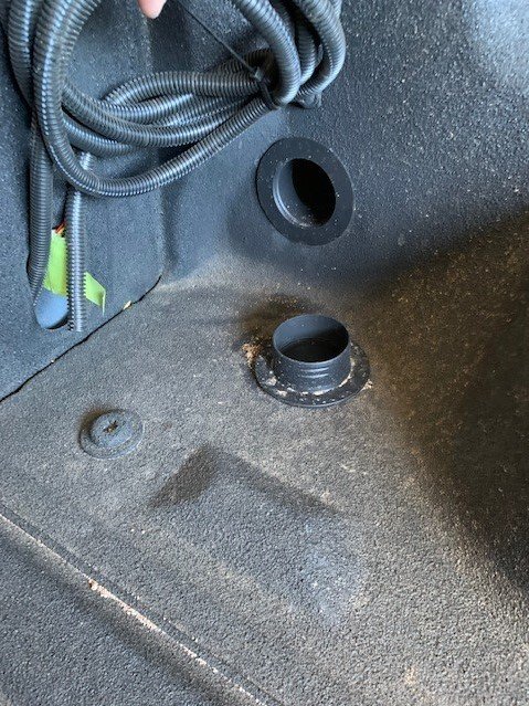

    I waited months to get mine from VanCafe. I wound up mounting mine under the bed of my Tundra. I cut a hole in the bed sidewall for return, which will just be open to the space, and cut a hole the bed just in front of the wheel well for the supply. I will duct the supply to a vent mounted in the front of my couch/dinette. I also found some clamps that allow you to crush the stainless pipe so I used that for both exhaust AND intake instead of the blue silicon included. The intake pipe that came with it was easily crushed and didn't want to chance that under the truck. They also just show the intake as open, but I added a foam filter with virtually zero restriction to keep the AZ dust out. Just waiting for my Nomad to duct so it doesn't fill with rain water.

    The propex can be mounted in many different positions. I kept my spare and went in front of the rear axle. Not sure about the Tacoma but inside the fender would have worked too but more difficult to mount.

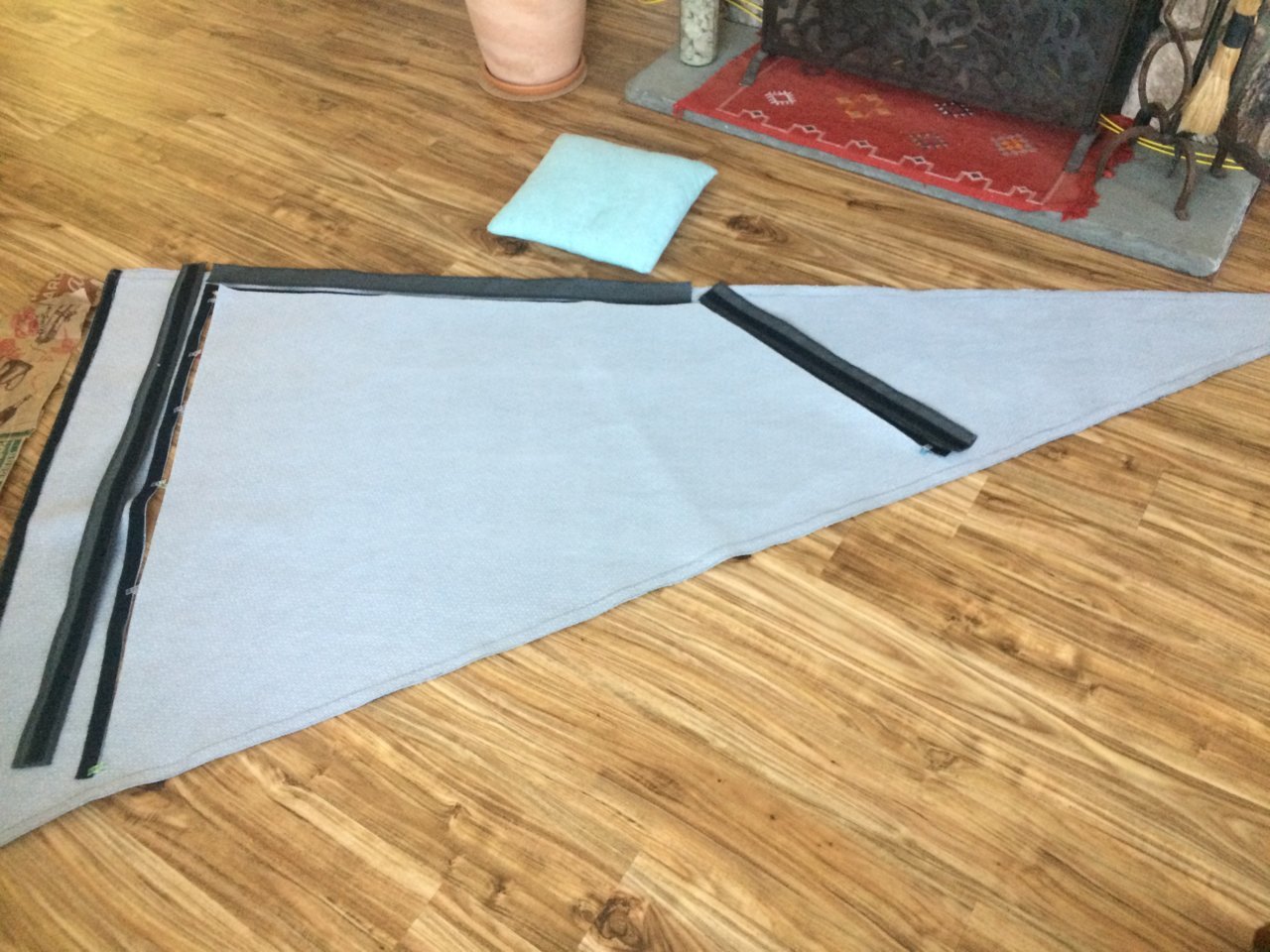

    My sweet lady is currently working on sewing a thermal pack for the tent which is based on this homemade FWC one https://www.wanderthewest.com/forum/topic/5269-building-an-arctic-cold-weather-pack/
    I’ll report back when we finish it up and get some snow days in with how it’s working in case anyone is interested in a new Drifter project.
