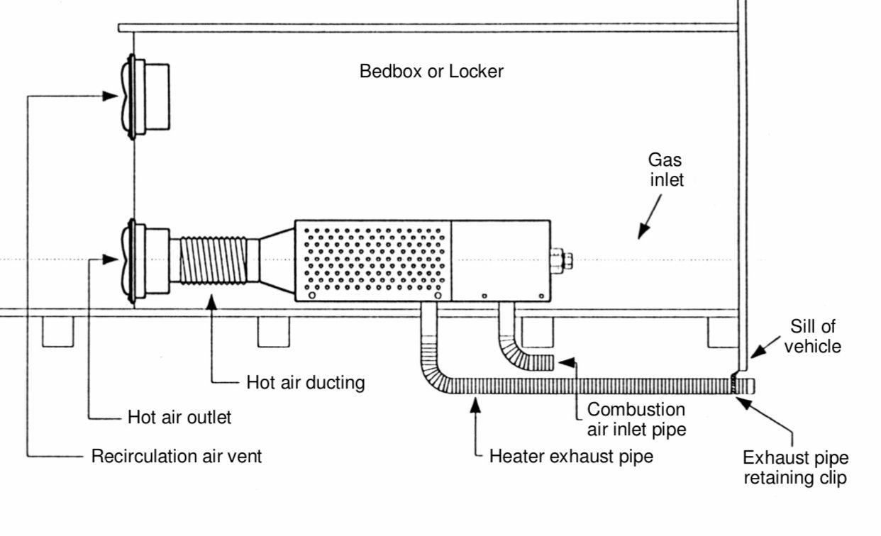

    With the heaters mounted in the spare tire location, wouldn't you have to worry about deep water crossings?

    Yes, however...
    I avoid deep water crossings like the plague. Lost my transfercase on my last truck, almost hydrolocked my 4Runner, and soaked my current trucks interior.

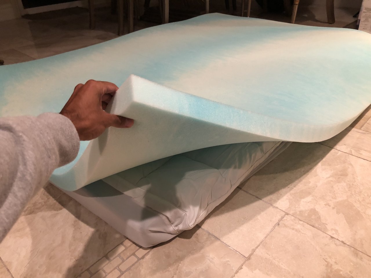

    Test dummying a 2” mattress topper from Walmart.
    Just opened it up to air out, but it feels significantly better if the mattress topper is under the current Vagabond one instead of the other way around.
    Will update on how it feels (subjective) once fully expanded and if I can close the Drifter with it.
    You’ll notice it’s too wide - I bought a queen with the intention of cutting the width of the mattress topper. The queen was the only one long enough to match.
    UPDATE: It sucked. I slept on it with my dog, and he ended up tearing chunks out of it too. It did not help my back/shoulder pain one bit either.

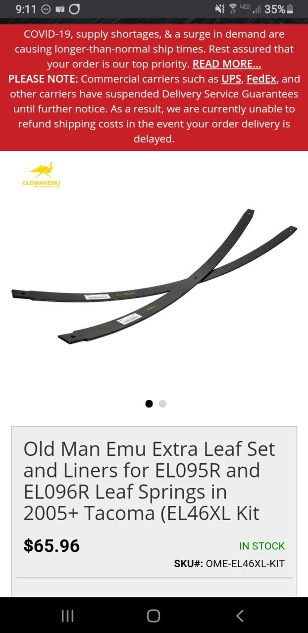

    I installed the OME Dakar HD leaf pack for the drifter, but after picking up the camper it seems I need to aal. It's rated to support a load of 660 pounds plus the 15% from the aal (759 pounds) still doesn't seem like enough...? Not sure what to do. What do y'all think?

    I have the extra leaf. Here is what it looks like with around ~900lbs in the bed + spare

    This is precisely why I wouldn’t want to mount a heater under there without some sort of waterproof encasing/box. Although we can try to avoid water crossings, sometimes its inevitable and going a different direction to try to bypass it is not possible

    I’m definitely considering mounting a Propex HS2211 in some kind of portable tote now. I like the idea of just carrying along a 20lb propane tank and running the grill and heater off one source. Last thing I want to do is carry another fuel source like diesel.

    Exactly, can't always avoid it where we like to go... you'd give up any chance of doing Mojave road with that water crossing...
    There's some great trails out this way too where crossing 3ft of water is mandatory...

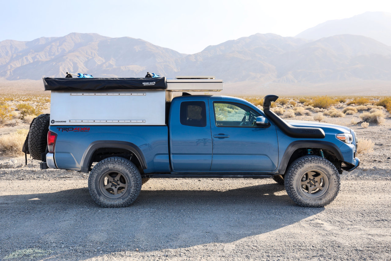

    So clean! Do you feel like it helped with drag into headwinds at all?
    d.shaw[QUOTED] likes this.

    Vagabond Drifter, King 2.5 coilovers, King 2.5 rear, Pelfreybilt front / rear bumpers and skids, rock sliders, Safari snorkel, Smitybilt winch, Baja designs 20in, wide cornering spots, S2 rear. Deaver expedition series stage 3 rear leaf.
    i haven't gone too far since getting it on yesterday, ill report back -

    Never tried it but always thought if you got enough speed the wake would keep the water from reaching the heater. The bottom of my Propex sits 4-inches above the rear doors so I would expect water intrusion in the cab. The 2211 is weather resistant but not submergible. I thought about using high heat caulk on it and wrapping the duct with the stretchy water proof plumbers tape to make it more water proof. Although now you are talking height that would enter the truck bed as well where my Vagabond carpet and house battery will live. I have diff breathers but would avoid this height of water at all costs.
