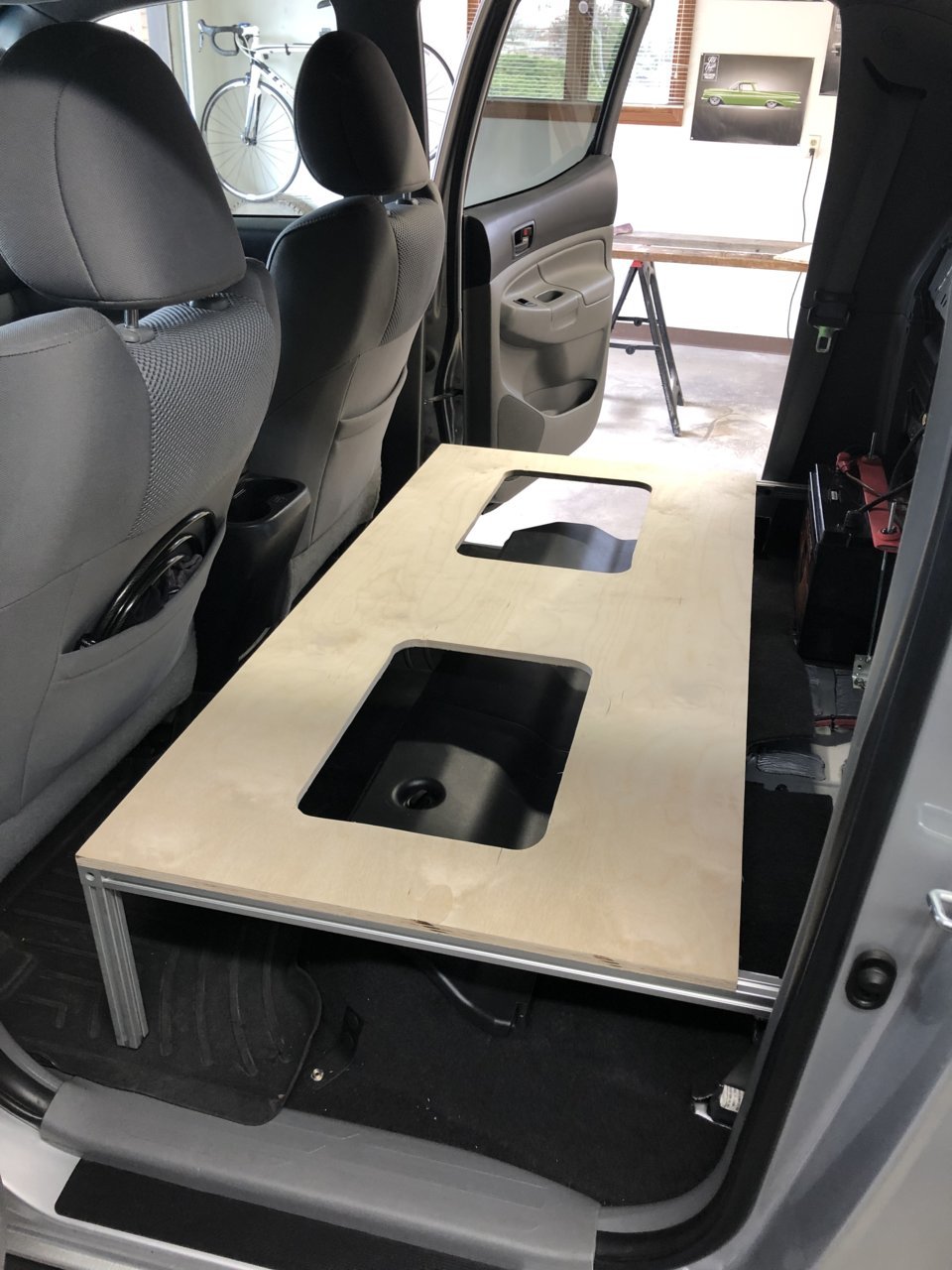

    Finally found some time to rebuild our interior to accommodate our growing daughter. She should now have plenty of room for a while since her bed is over 4 feet long. It also serves as a nice little couch if you open the little door.
    WN-KFpOPw8OYYHrV0sNO-0NZe6ITsq5AF5z7cZ23_bef0dacaa5f58dda9482b27411128b56d3d1781c.jpg
    With the mattress removed, there are some storage cubbies underneath and the center opens up completely if I need to lock our bikes inside.
    Z8lP51_uaZ4FIfyWRnFFZKVfpvQm1BWCTSdQoXeU_a23dfbd732f6357fc5259caa612d5787ef05ccb1.jpg
    The center platform slides out for bikes or to pull other gear in/out more easily. It also comes out completely and has folding legs hidden underneath so we can use it as a camp table.
    mCmKH7BjOLxCkEF0fuW7613Kg4nkrRCvmTQawu1i_6fd76bd5279ab4e6df32e280e2a7e8c062207285.jpg
    rhQGam28aWR5xv5Q-SV-Zf6a-jDqHkPcOQYl7EMK_d40607b6fec4f73a2c7382de7675da245797912e.jpg
    I need to do some finish work like adding some carpeting and turning the tall cubbies in to little drawers for odds and ends.

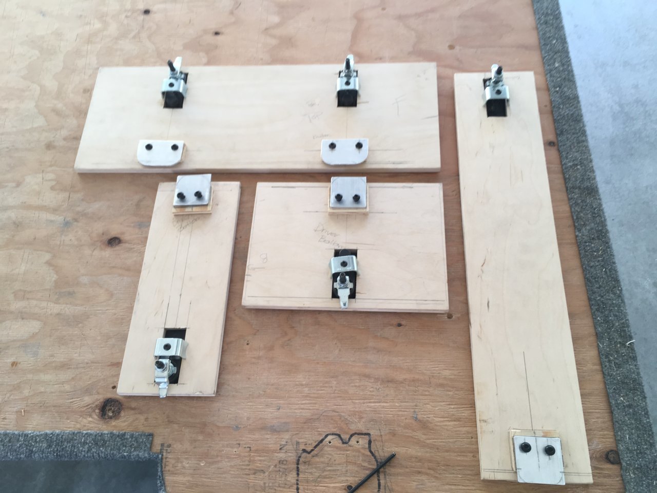

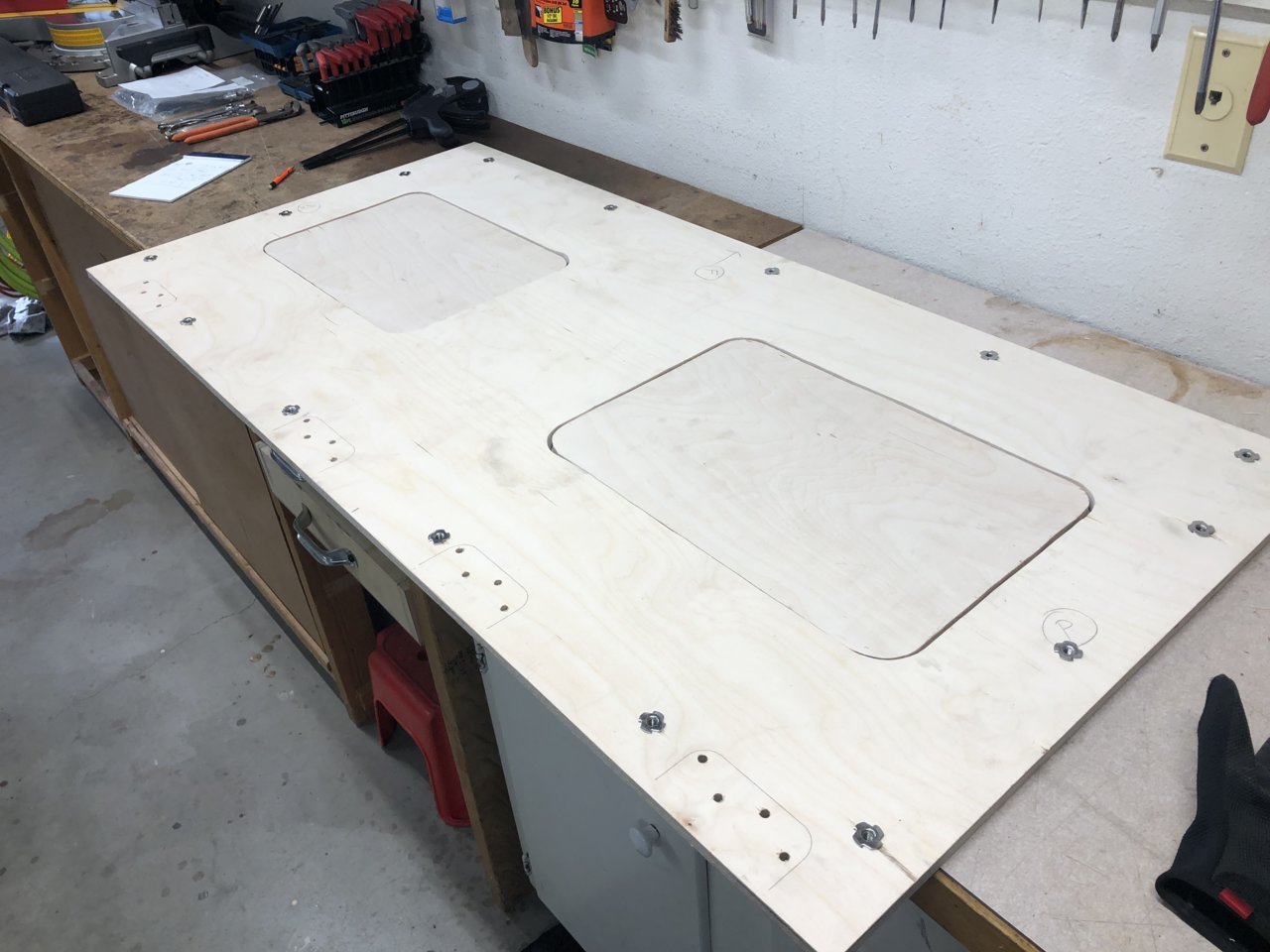

    Figured this was by far the best thread in terms of getting some suggestions on what kind of latches would be recommended for this application with all the build outs I have seen on here. I started looking at all the different Southco ones online and my head was spinning. I cut these two lids/access holes in my rear seat delete deck I am building and need to get a latch for each one to keep them secure. So I am looking for suggestions on the type/etc. that might work best.
    The lids are going to rest on a ledge on each side of the hole, so the latch would be located on one end or both ends if needed. I think something that sits pretty flush is probably best.

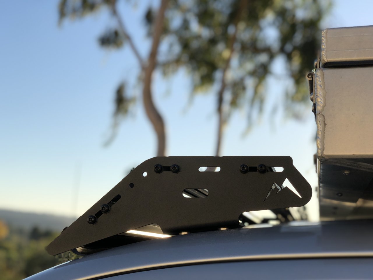

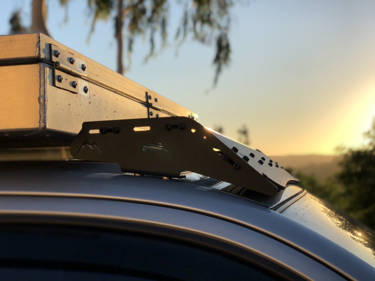

    I measure 51” center of track. Just get the Renogy 160w and it will fit perfectly across the L track. No need for cross bars.
    I have some pics of my solar setup on my build thread.

    Southco Inc SC-62025 Lift-and-Turn Compression Latch Grip Range .63 to 1.02 Pawl Forward - 1.81 to 2.20 Pawl Reversed, Southco Lift and Turn Compression Latches
    These work great. They have a locking version that I use on the top of my drawers.

    Thanks @jimlangfordphotography. I will check these out.
