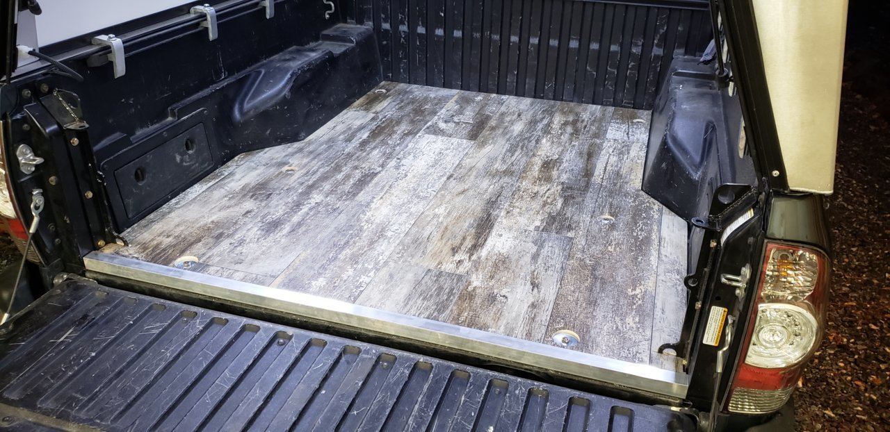

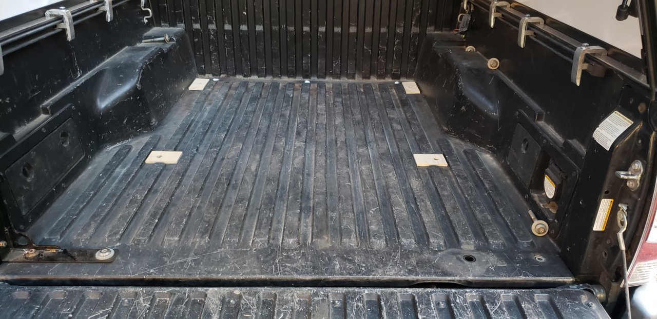

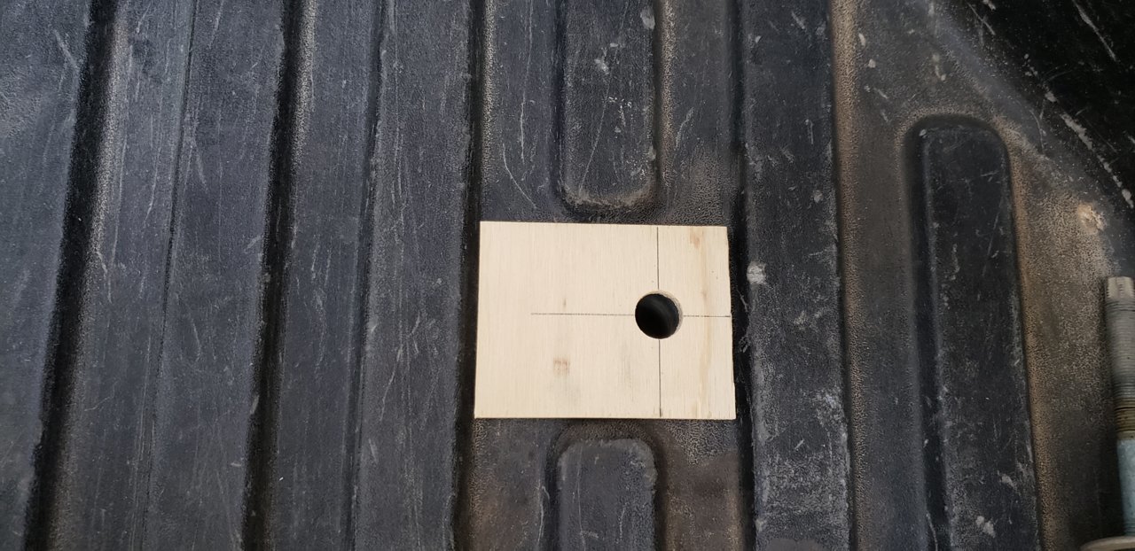

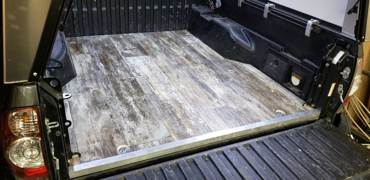

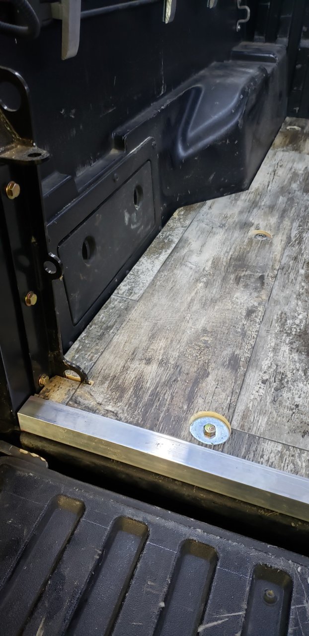

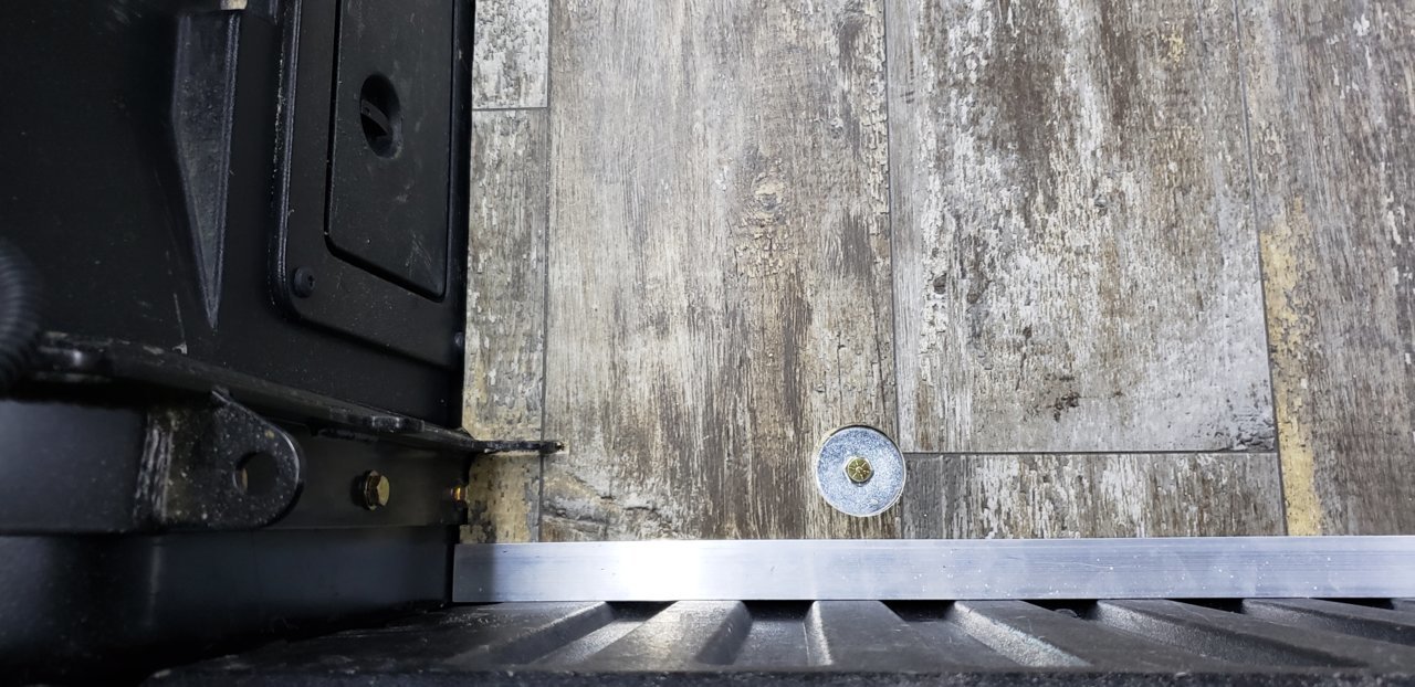

    I finished up my base plate today. I used 13 ply Baltic Birch. I had some remnant vinyl in the basement that I used for the flooring. The front and middle bolts were long enough, but the rear bolts were too short. I tried to find the correct length and what I found was m12 x 1.25 x 6" was hard to find and at least $20 a bolt, so I used grade 8 3/8" x 6" with a locking nut. I think it worked out great. I used 3/8 ply in between the ribs as spacers. I maybe should have used metal, but I had the ply. The hardest part was milling around the bed stiffeners.
    I'm looking forward to the cabinet build out this winter. I'm still working on the layout. I know it's individual, but what do you'll think is the most functional setup? I'm working around my RTIC 65 cooler and Thedford portapotti. I'm thinking water tank near the cab and maybe a sink/table above the cooler.

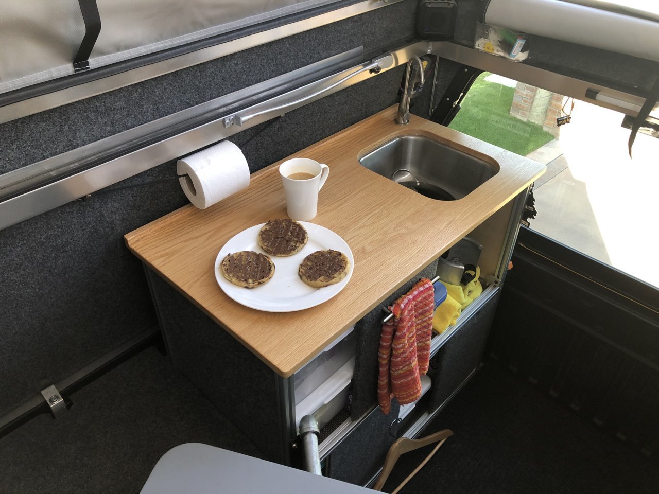

    Just my $.02, but I would really push for having a fridge > cooler! My Dometic CFX40 is the single greatest thing I have bought for the camper build - I love not having to worry about my baseplate getting soaked from a cooler. Seriously kicked myself for not buying one years ago.
    One more piece of advice I could give is keeping the hallway wide. Build up rather than out.
    I would take a look at @MJonaGS32 's build that I believe incorporates a fridge can toilet (going off memory)!

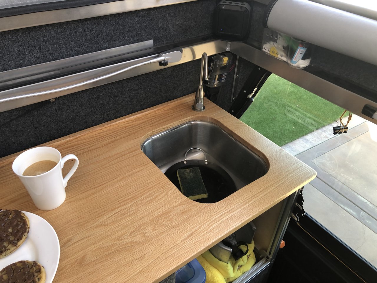

    I pulled some pics for you
    Here is @Eazy.E setup
    Here is @tacoburn327 setup (please tell us about the latches and panels you used)!
    Here is @MJonaGS32 setup
    Here is my setup. I’ll be adding a toilet next week under the bench seat in the passenger front corner.

    Nice work! Mine is not nearly cut as nice as yours is. I'm gonna use 4 mounting bolts instead of 6 like you did.

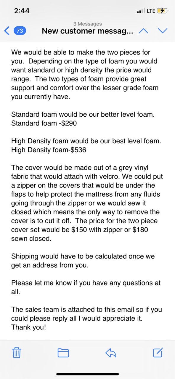

    Also update on the new mattress situation. I sent pictures of the Vagabond foam to North America Mattress to have them recommend the best alternative. Little more expensive than I hoped.
    This quote us for 80” x 48” x 4”, which is one inch taller than the current Vagabond mattress. That’s why there’s also a quote for the covers.
    I will get a quote for a 80” x 48” x 3” for those who want to fit it into the mattress covers you already have.
    Here is the pricing:
