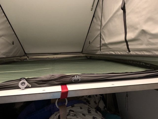

    I’m back to using an Exped MegaMat Duo long/wide.
    3.9” thick.
    The 3” Exped DeepSleep did not provide deep sleep.

    Do you have to deflate it to close the top with bedding?

    I did before with the comforter. That was fully inflated, which I realized that it’s the the actual inflation I want for sleeping.
    I’m doing more testing ASAP and will report back. It’s still doing it’s initial inflate and I’m not wasting energy or damp breath to fill it.

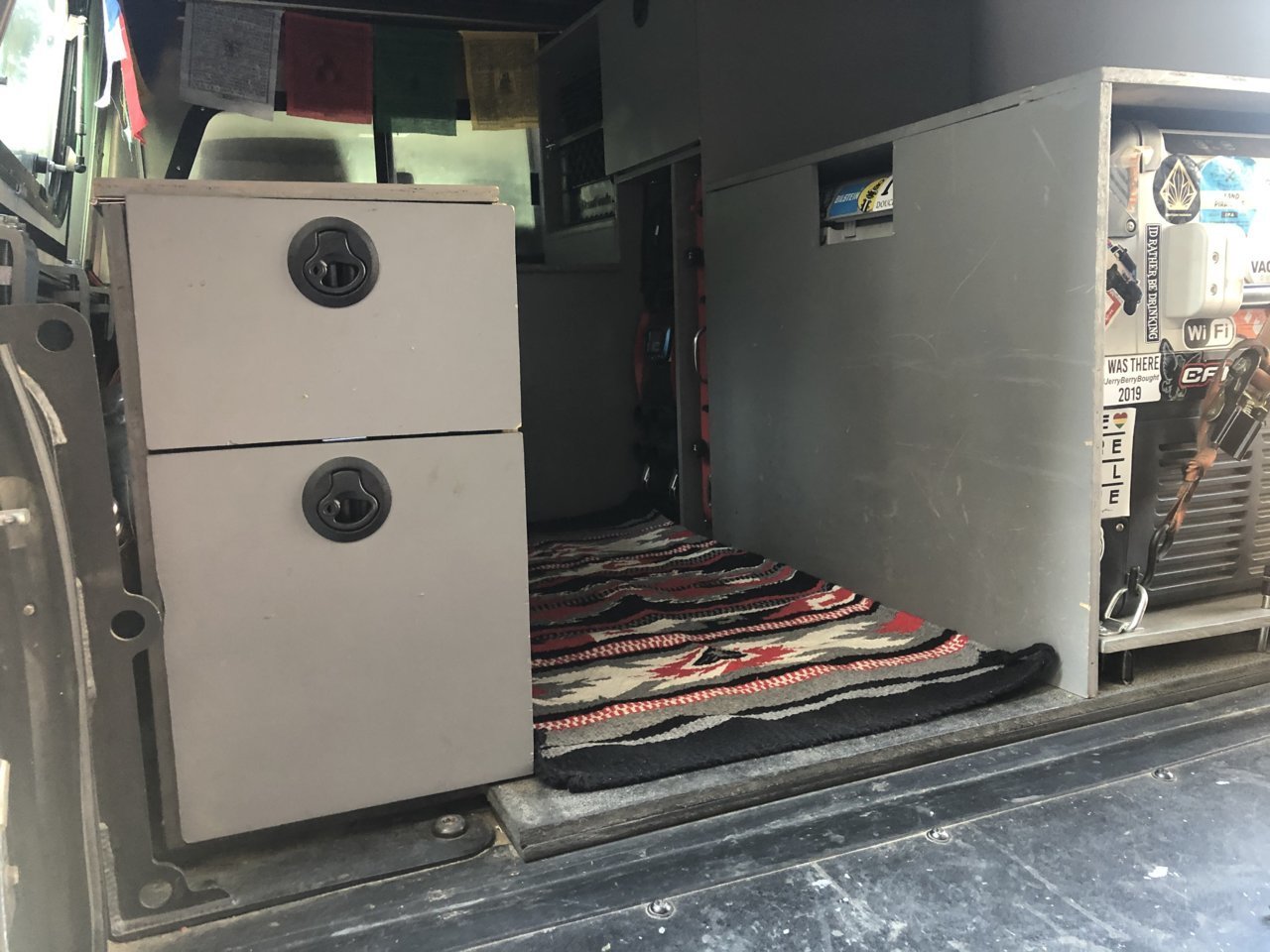

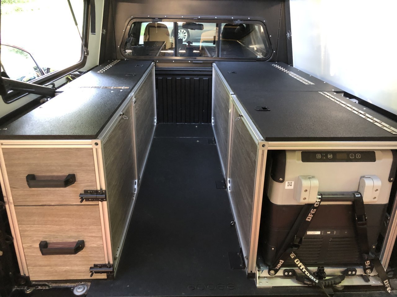

    Maybe build a cage around the fridge if you're concerned about putting direct weight on it but I don't think the brief climb will hurt your fridge slide. I ended up with a GosseGear camp kitchen slide that has the aluminum 8020 frame and I use it to help get up top. I was actually going to build a removable or hinged top plate since the pieces that go between the frame are not strong enough to hold a persons weight.
    I'll find a couple pics to post...
    Since the stove and fridge are on a dual slide the frame is too tall to just step on without also grabbing above to pull yourself up also so it never really gets anyone's full weight.
    I couldn't find a good close up of the slide panels but they're a type of laminated board.

    If you remember the size (1/4” or 1/2”) and material of the panels, let me know. I looked at many alternatives to switch my camper up and didn’t find anything I liked (or cost effective).

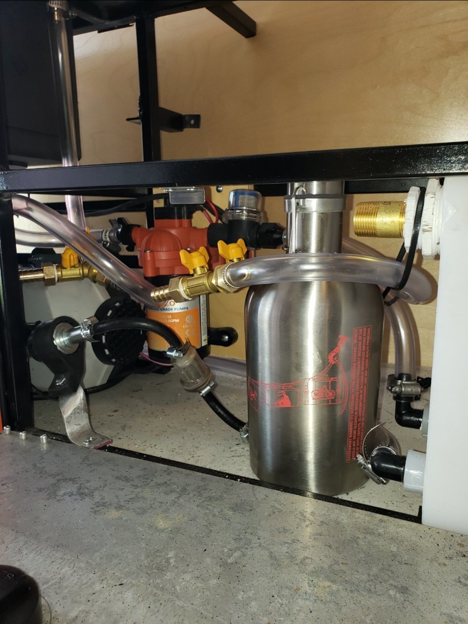

    Stock

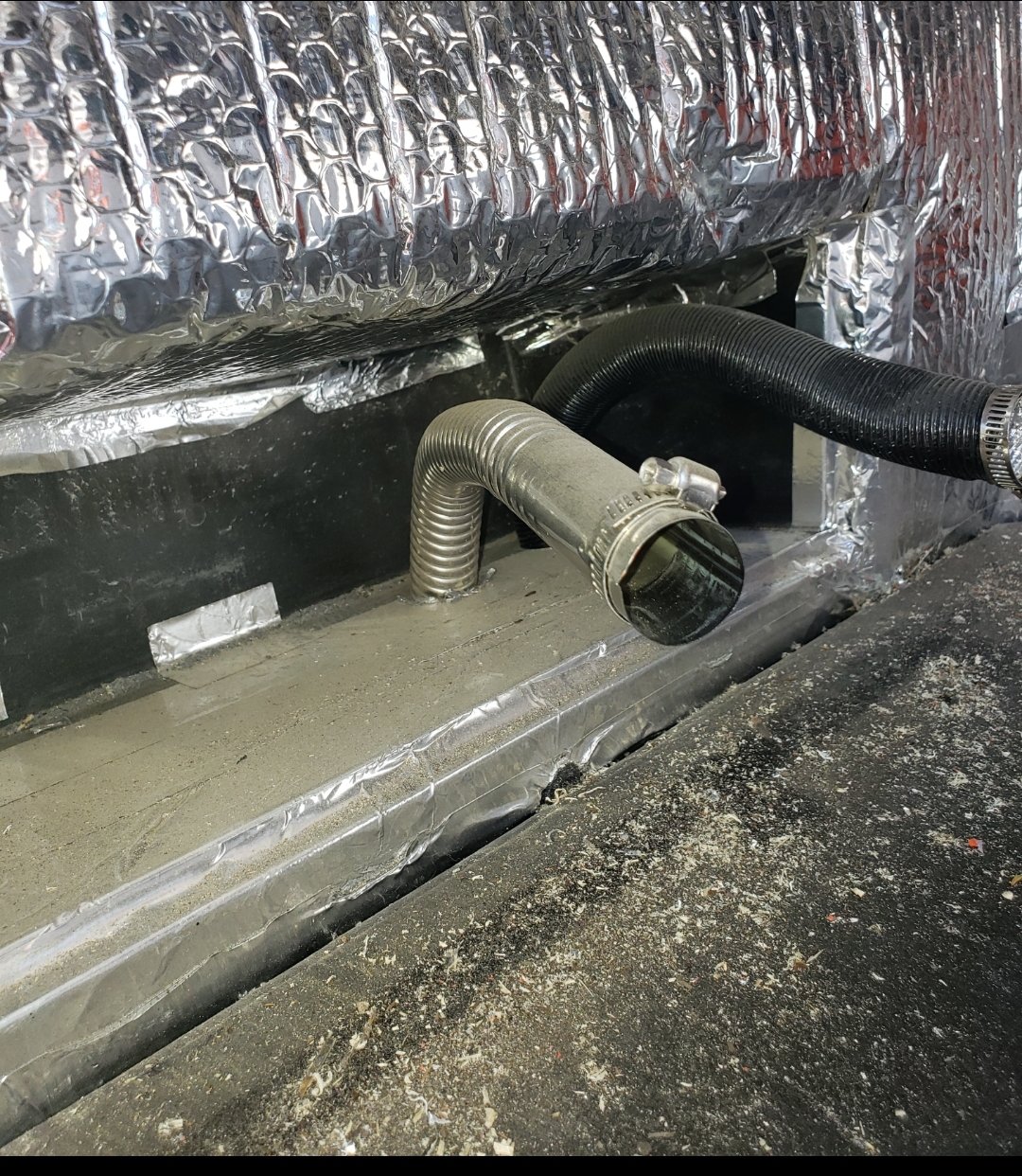

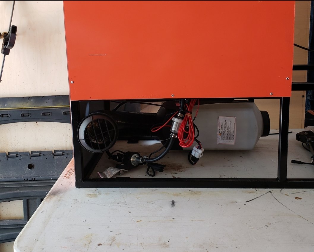

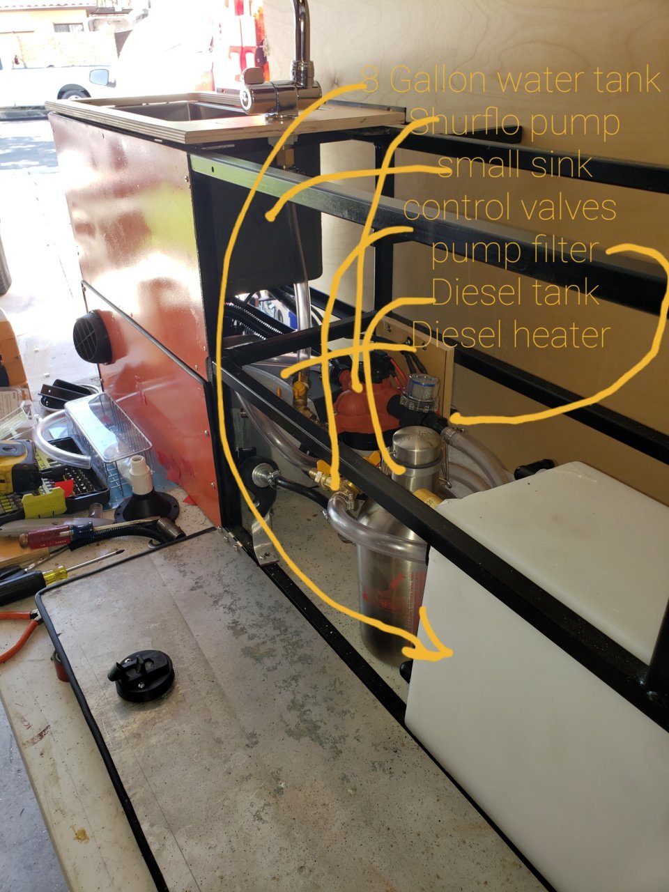

    Can you show some more details of how you rigged up your heater? What did you use for a fuel tank and where did the vent the fuel tank? I love your build and it looks like a better execution of what I want to do to mine

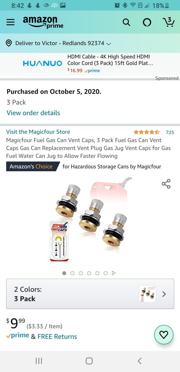

    Hey! So the fuel tank. Well its a stainless steel beer growler from a local Redlands Brewery. I used a gas can vent kit i found on Amazon ( https://www.amazon.com/dp/B07ZT3GPKR?ref=ppx_pop_mob_ap_share Screenshot_20201119-204223_Amazon Shopping.jpg
    I ran a small clear 3/8 hose from the Fuel tank to the rear hatch. There was enough clearance to squeeze the hose in between the hatch, camper and bedside where it just wedges in. The frame i built from 3/4 steel tube for the cabinet has mounts welded to it to receive the heater. I used rubber bushings to bolt down the heater to eliminate any vibration noise when its running. Apologies but I don't have many pictures on my phone now but I've been getting lots of questions so ill post up some more soon.Screenshot_20201119-204223_Amazon Shopping.jpg Screenshot_20201119-203752_Gallery.jpg Screenshot_20201119-203709_Gallery.jpg Screenshot_20201119-203643_Gallery.jpg

    It should be 1/4" thick since it fits in the grooves of the 8020.
