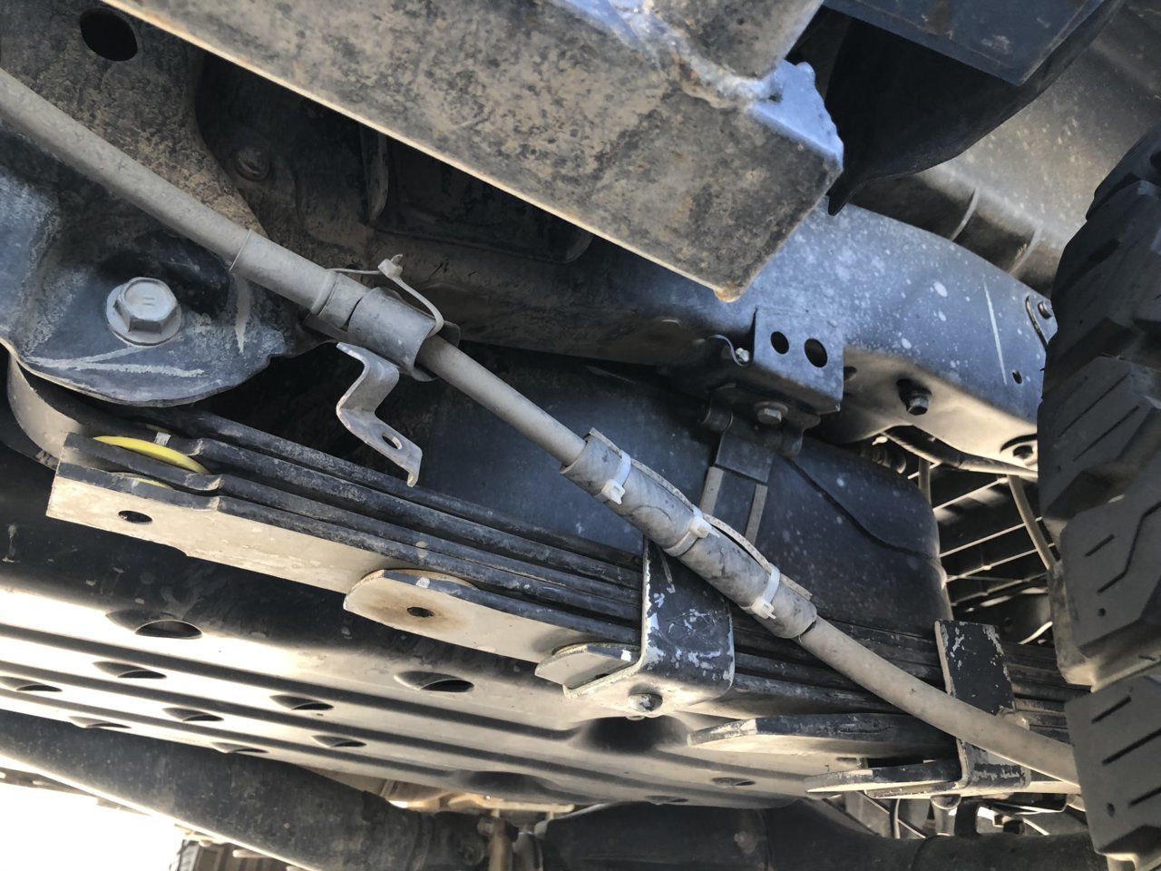

    Okay, simple question for you folks with Deaver's on your truck, specifically 2nd Gen but I'm sure 3rd is probably the same. I don't see any holes on the spring pack brackets to reattach the parking brake cable brackets on either side? What are you supposed to do with the dangling brackets on the parking brake cable? Any input is appreciated. Thanks!

    I gotchu. Looking at driver side

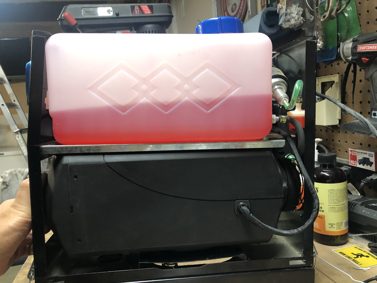

    5L
    Here’s a pic of the unit without the encasing.
    You can see that the fuel line isn’t at the bottom of the tank so there’s a decent amount of kero still in the tank that’s unusable. I mounted the unit at an angle so more fuel can reach the fuel line. I tilted the unit in this pic to kind of show this.

    do you know that even with it mounted in the middle (fuel line) that it doesn't have some form of tube or setup that pulls from the bottom? Now with your kid you see all these designs that focus on that so the kids moving it around still get all the goods.

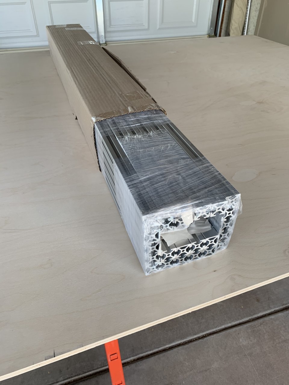

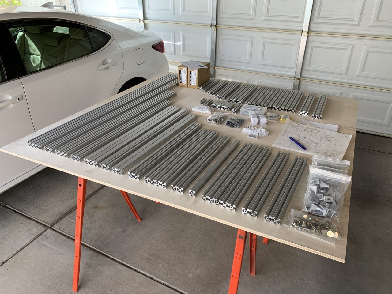

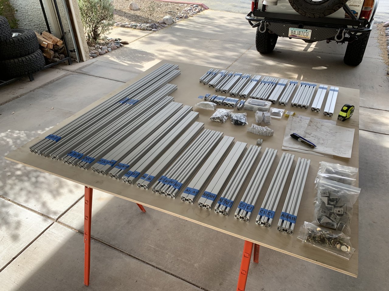

    The t-slot extruded aluminum arrived. About 70 lbs. worth including some hardware. I modeled all of the cabinet frames (Google SketchUp and cardboard mock-ups), made drawings, and then a coded and labeled inventory list. I had them all cut at the factory and oh man, I'm glad I did. Now it's a matter of connecting the pieces per the drawings.
