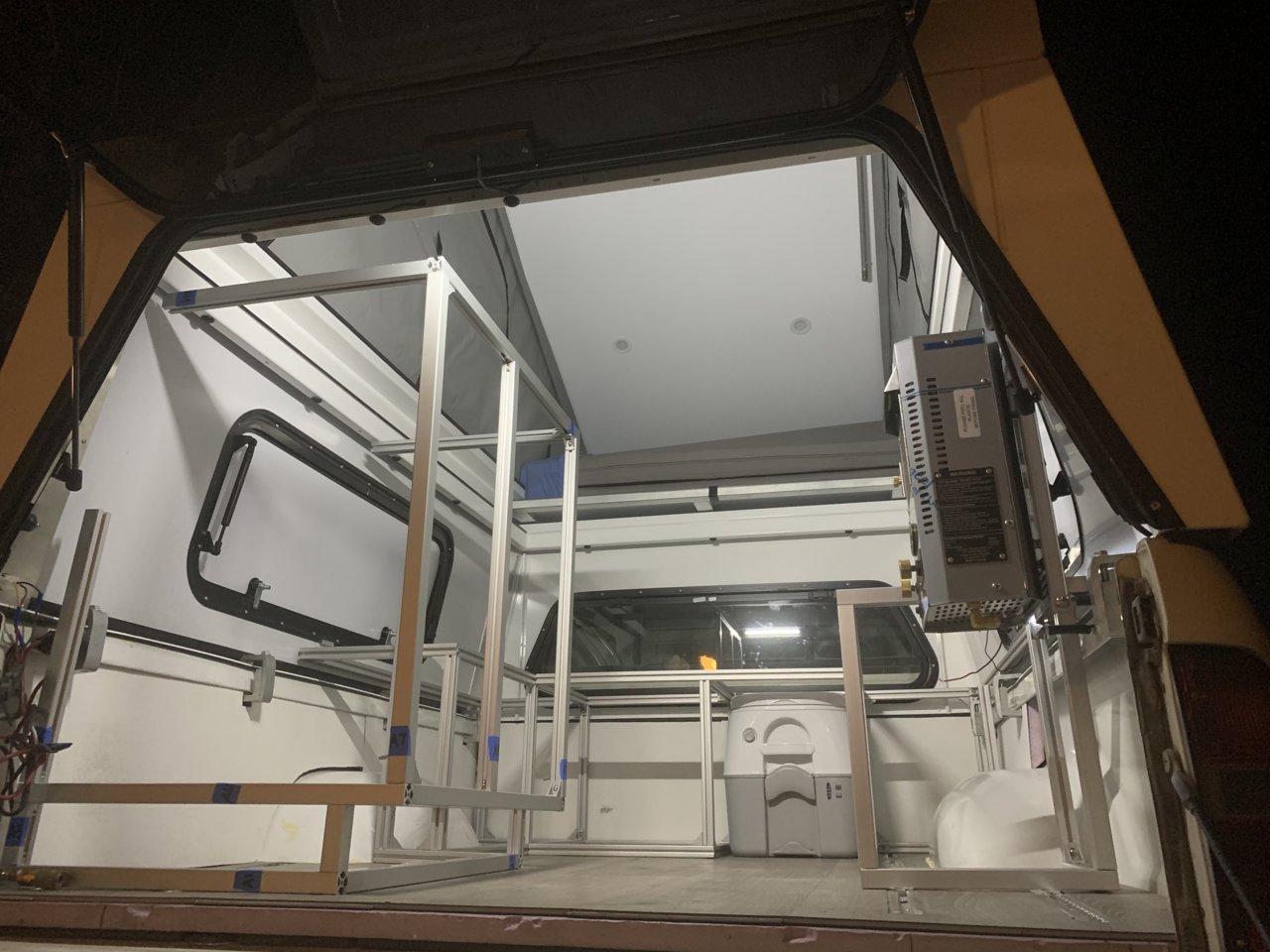

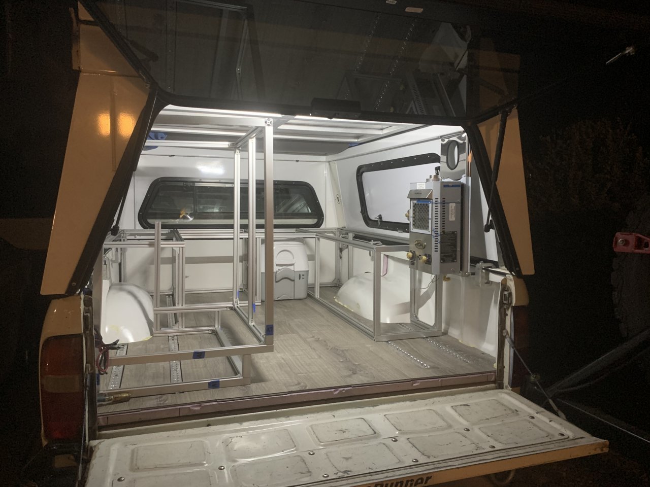

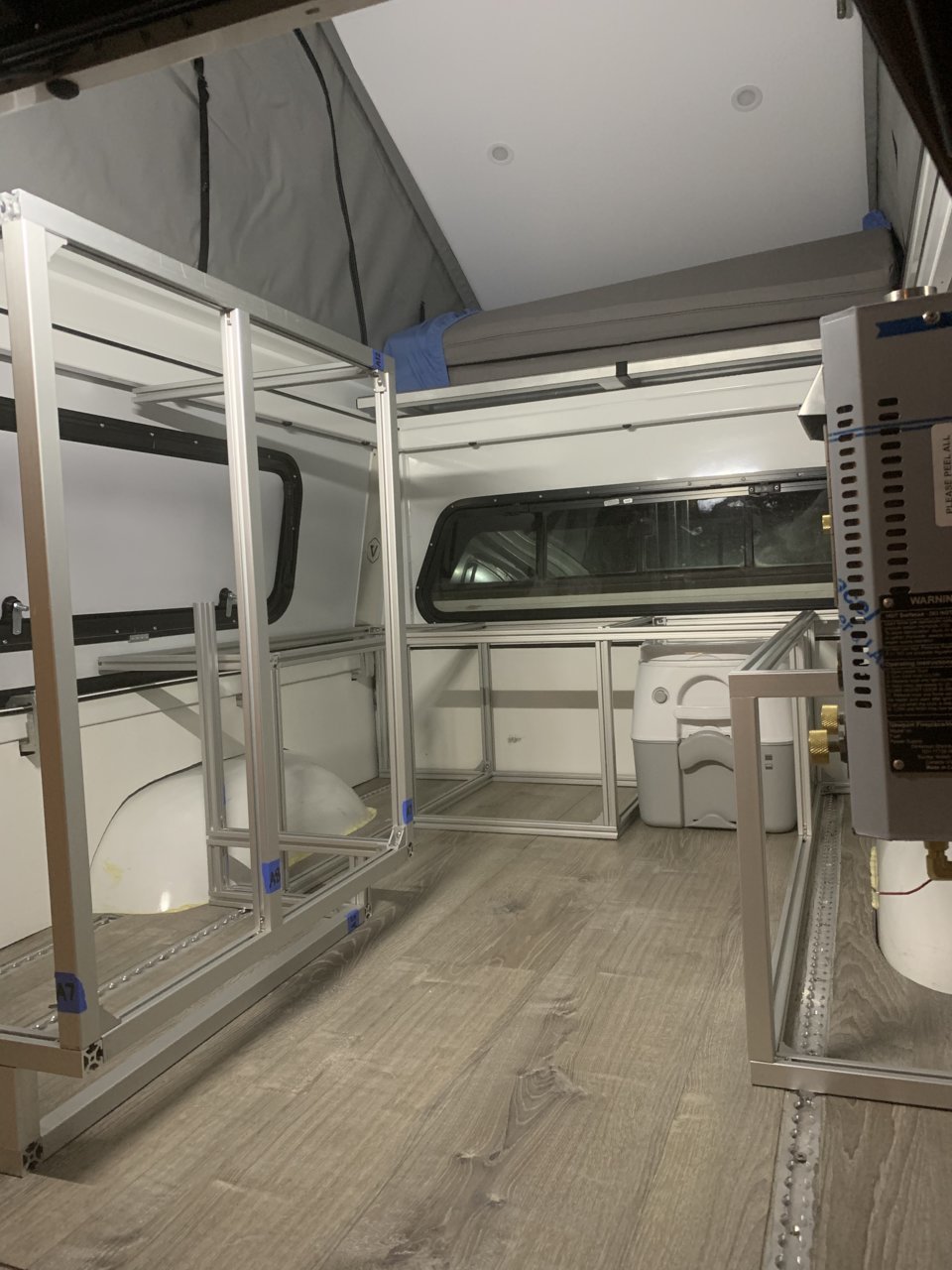

    The framing progress so far. The galley cabinet has a way to go. The countertop will be about 34.5" tall, similar to a standard kitchen. It will have a sink and one-burner stove. You can see the fireplace on the right (in progress). The concept with the floor plan is to be able to stand up comfortably and use the countertop/sink/stove and keep the remaining cabinets low. They will get covered with birch plywood, and there will be a removable piece that will fill in the center to make a fairly large platform. I want to have a place for two people to sit in some reclining seats if weather requires staying indoors. Having some room to hang out comfortably is a good thing. The fridge stays up in the cab (as I've always had it there).

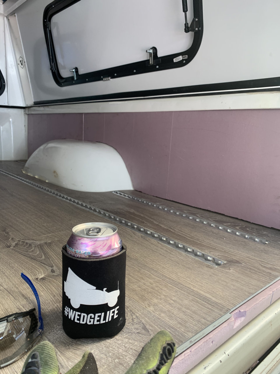

    I forgot to mention.... I also got the sidewalls wrapped with the 1" rigid foam insulation and finished with FRP sheet.

    This is looking great . I started with a tall cabinet like that at first, camped with it 14 different nights, then decided it was just too difficult getting my 6' 2" body in and out with such a large cabinet. So I took it back out chopped it up, rewelded and came up with something much smaller.

    Looking good! One thing I would suggest is to lift the toilet a bit so its level with the extrusion. That way you minimize the extrusion digging into your hammy while you’re dropping a deuce.

    I can totally understand. It's a small space to work with. We'll see how it goes... I'm not as tall as you and it seemed to be ok with the cardboard mock-up. But, the real life test will determine.
    Haha... that's a good one :) Toilet will slide out forward for use.

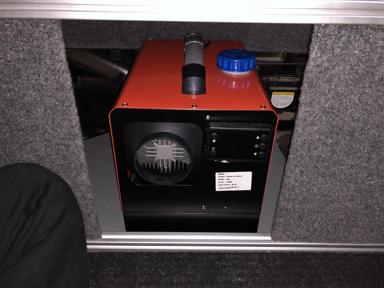

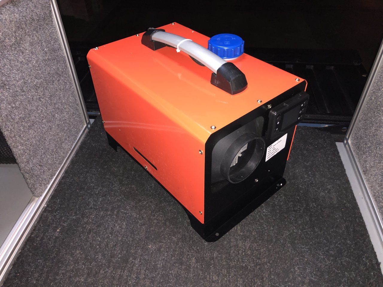

    5.5kw diesel heater. All-in-one unit, because I’m lazy.
    Planning on how I want to mount it to make it easily removable for summer months. So far, so good!
    Might use L-track with eyerings mounted on the outer shell of heater, and the ring attachment on the L-track.
    For fill, I’ll cut a hole in the upper cabinet shelf and use a transfer pump most likely. Not sure if there’s a better way.

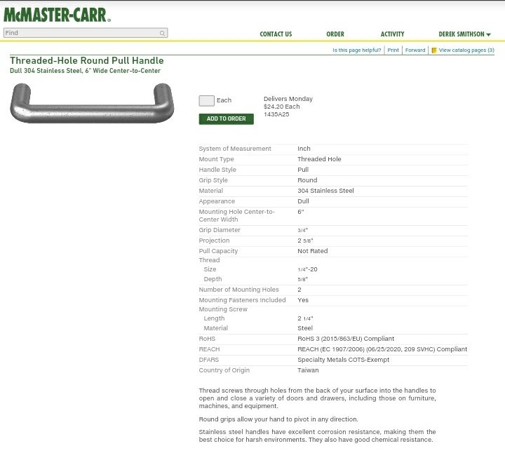

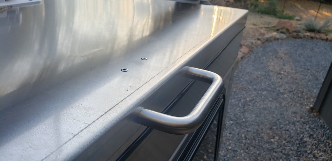

    Can you post photos of the inside where the bolts go through the Drifter lid and into the handle?
    Also - did you use the included 2 1/4" long screws or did you have to get shorter since the drifter is only 1/8" thick?
  15. Nov 24, 2020 at 8:01 PM
    #4675
    joeydurango
    joeydurango Nightfall Overland
    Sep 21, 2019
    #305951
    400
    SW Colorado
    Heavily modified 2015 TRD w/Drifter
    I just installed the same handle a couple days back. No photos yet, will try to get some this weekend. Easy install, <15 minutes. It's great!
    I didn't use the stock bolts, I had some 1" 1/4x20 bolts lying around I used with big fender washers.

    Did you get the McMaster Carr one or the eBay Don-Jo aluminum one you mentioned?
  17. Nov 24, 2020 at 8:05 PM
    #4677
    joeydurango
    Sep 21, 2019
    #305951
    400
    SW Colorado
    Oh, my bad - the Don-Jo. I thought this was that one, someone had mounted up a 10" Don-Jo from "doorhardware.com" or something. I did get mine from a seller on eBay.
    I like the aluminum one - matches perfectly - and I like the 10" wide version.
