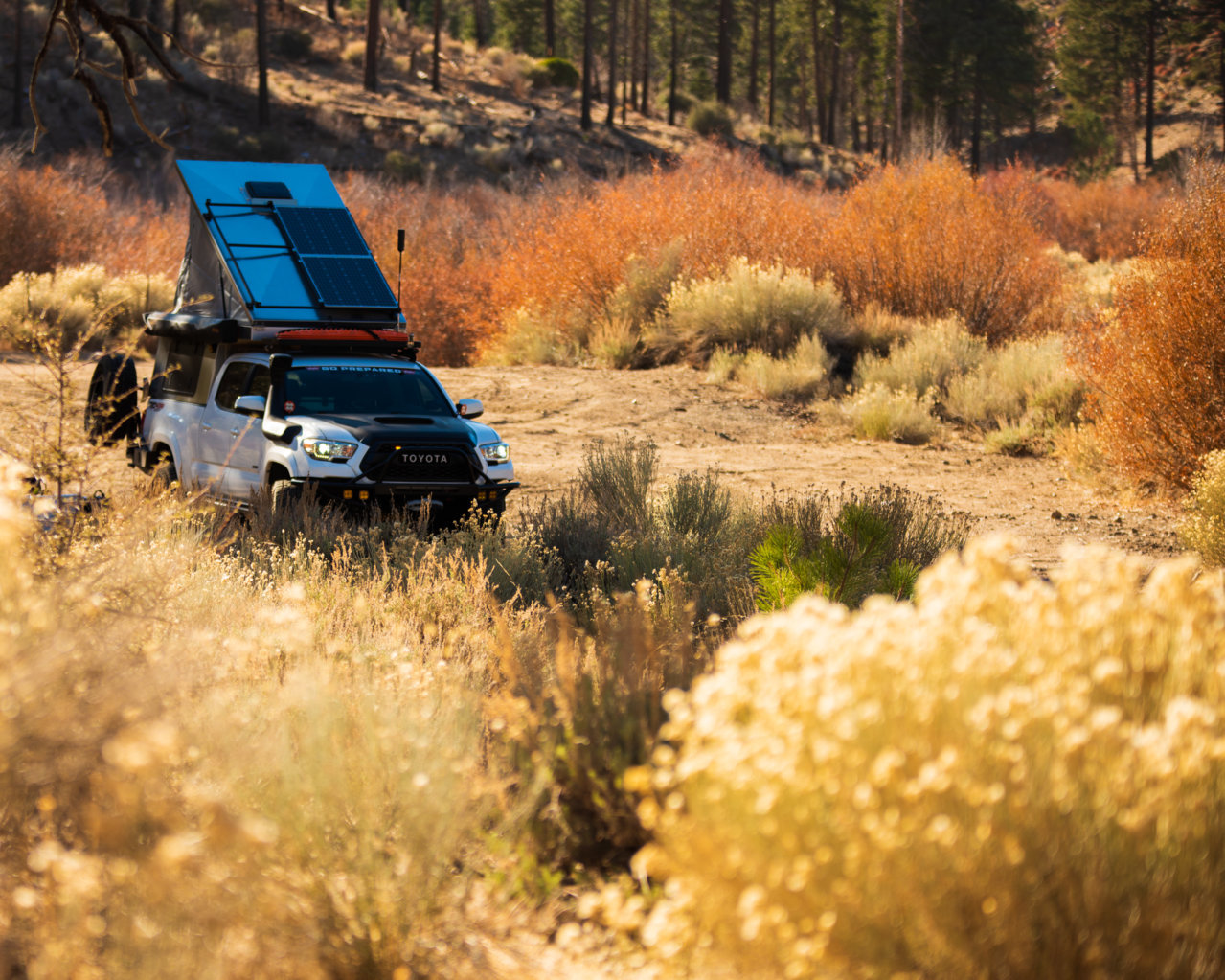

    2018 Toyota Tacoma TRD Off-Road 4x4
    2.5" lift, 4.88 gears
    Last nights camping spot was perfect!

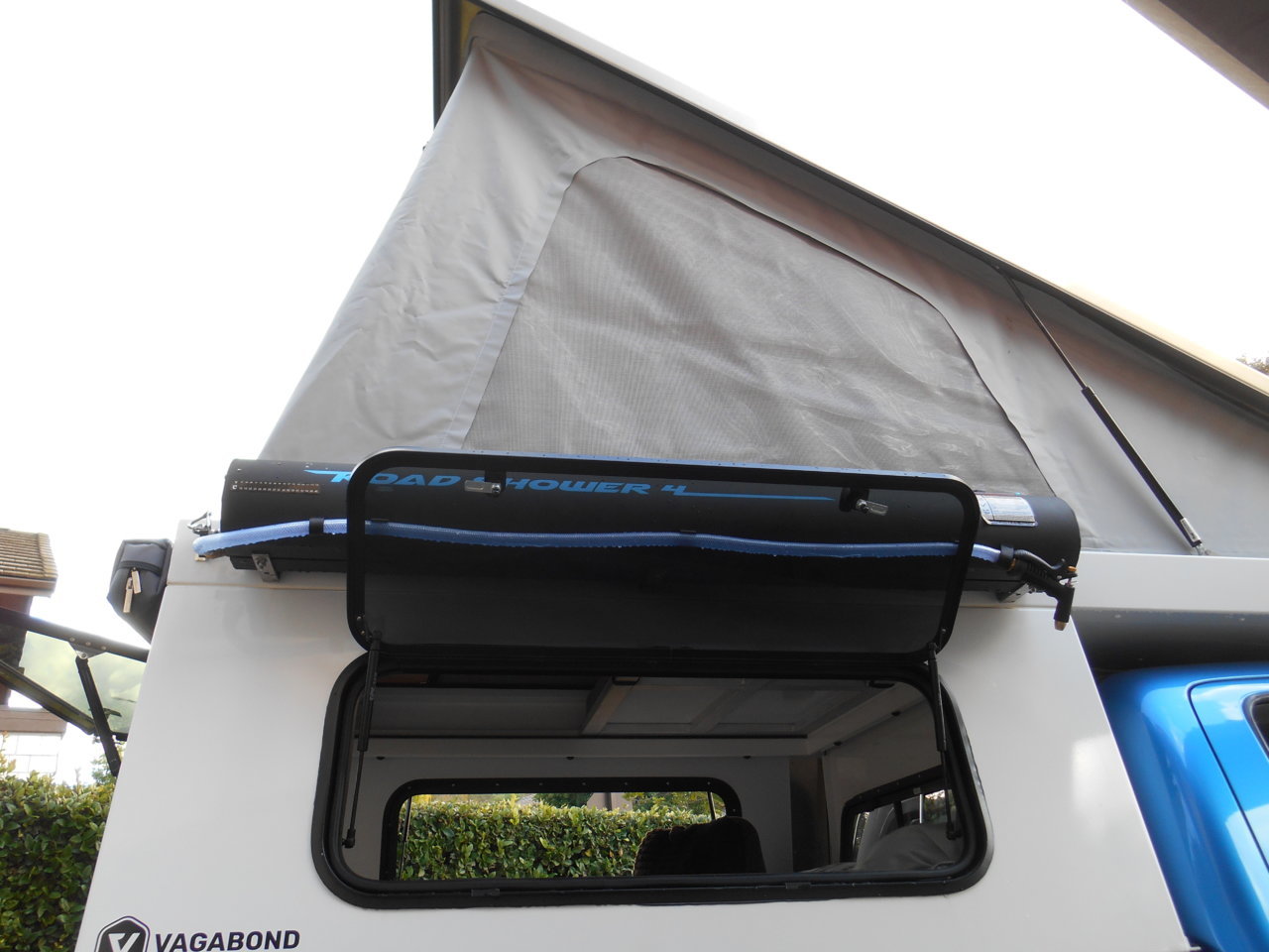

    Ah sweet I found these pics! Just bought a road shower and I'll install it the same way.
    @tyfoon11 , do you remember if those are just standard l-brackets or arb awning brackets that the road shower is bolted to?

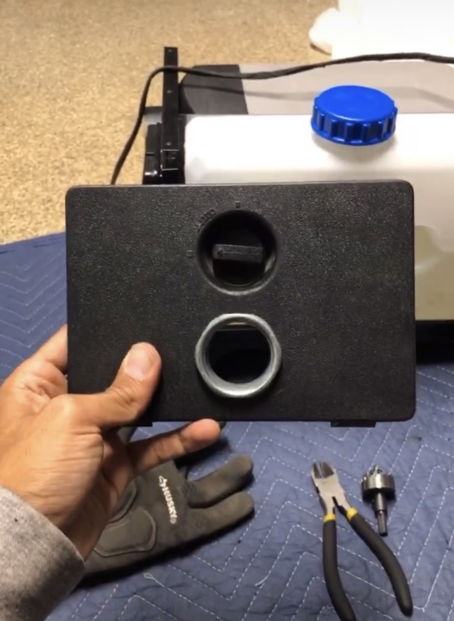

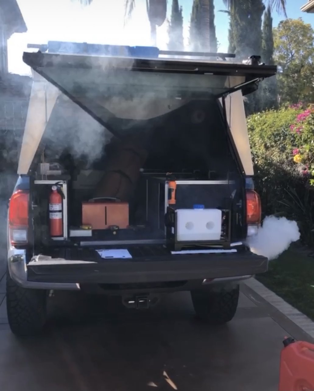

    Got the heater almost ready. New fuel lines, fuel filter, clamps, 1x2 mounted under front for tank to be at an angle, etc. Still need to tap the fuel cap and wait for the longer exhaust to come in. Took about 3.5 hours of work. I’m just slow.
    Forgot to take quality pictures, but here are some potato pics of when I started up the heater and the water from straightening out fuel line was burning out. Second picture is of the exhaust pass through.

    Looks like a lab test! That's gonna be sweet to have heat :)
  12. Nov 30, 2020 at 8:56 PM
    #4712
    OG_BajaTaco
    OG_BajaTaco Well-Known Member
    Feb 15, 2020
    #319377
    146
    1998 TRD Xcab
    24 years of accumulated mods
    The heat is on! Finally got it fired up today. I think she approves. :)
