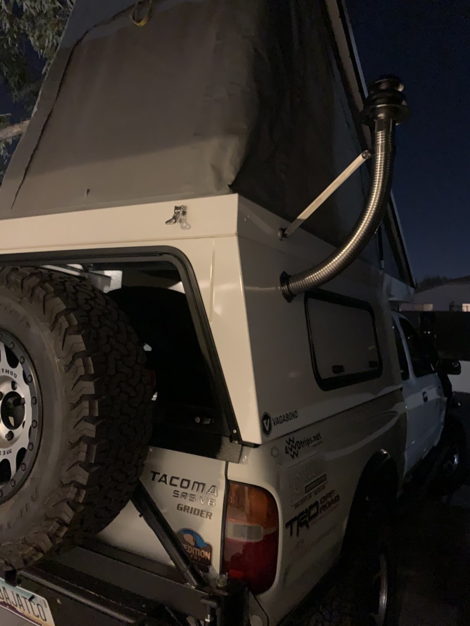

    It is a Dickinson Newport P9000. I will just say, to keep in mind this product comes with a factory direct-vent flue pipe that is meant to be installed through a deck overhead (think sailboat application) or at the least, through a wall at a distance far enough to accommodate the radius limitation of the factory flexible flue. In this situation that is not possible; The very tight / close exit point through the wall requires custom fabrication. You will also see the factory mounting plate was modified for this as well, with a different top mount and an opening created for the flue pipe.
    This is the factory flue pipe and cap with a custom brace that attaches to an L-track bracket on the Drifter. The flue is only attached when the heater is being used, and is removed for travel.

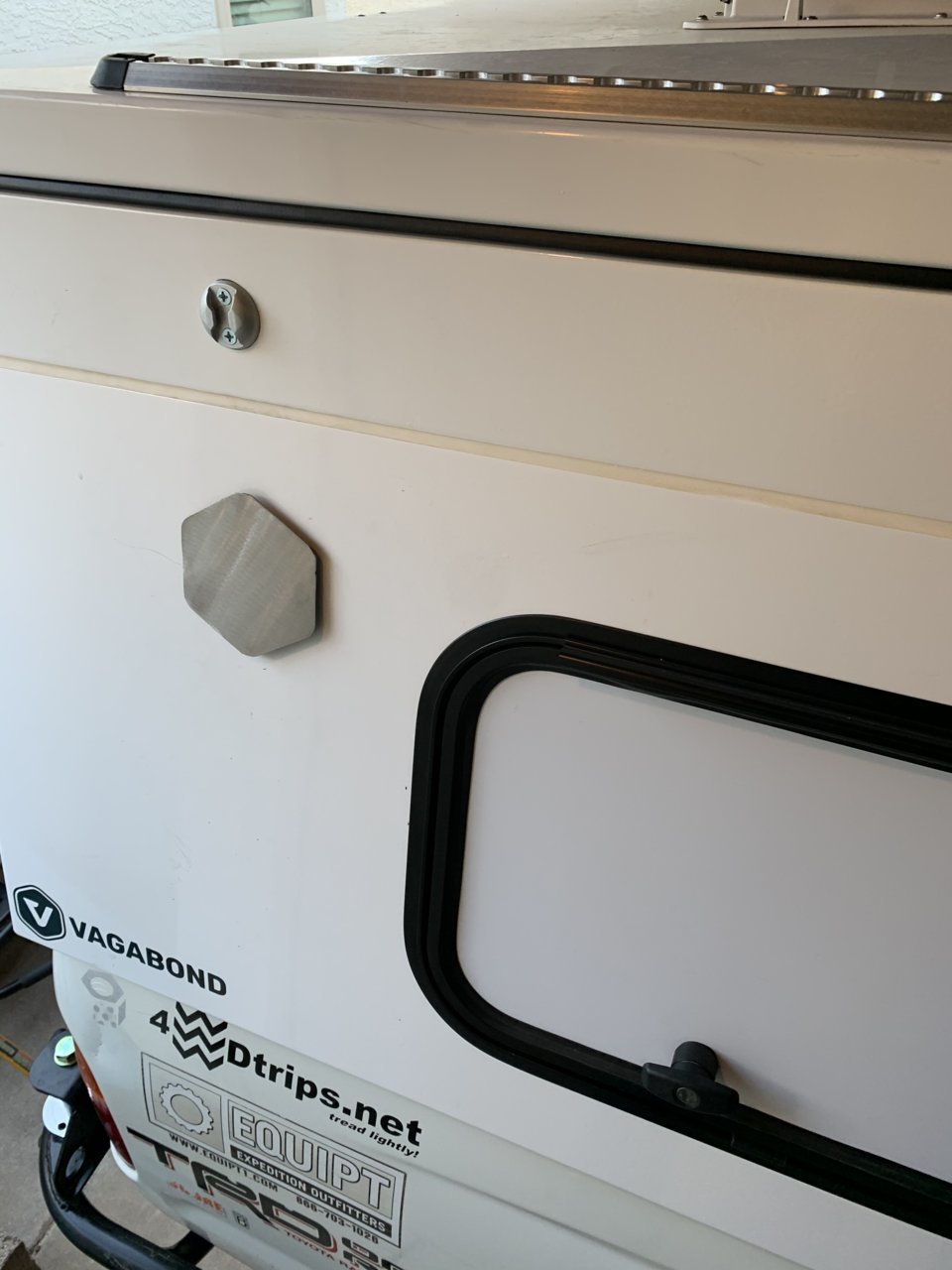

    Here is the stainless steel travel cover, but it's not finished. The edges will be rolled for aesthetics. It seals against the camper wall using a sealing system that incorporates latches on the inside that pulls a rubber o-ring on the outside tight up against the camper.

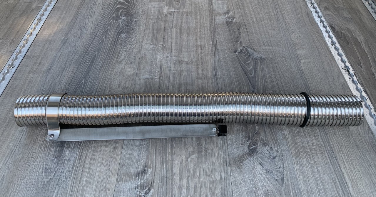

    Here's the factory flue pipe with custom bracket, as it will be stowed for travel.

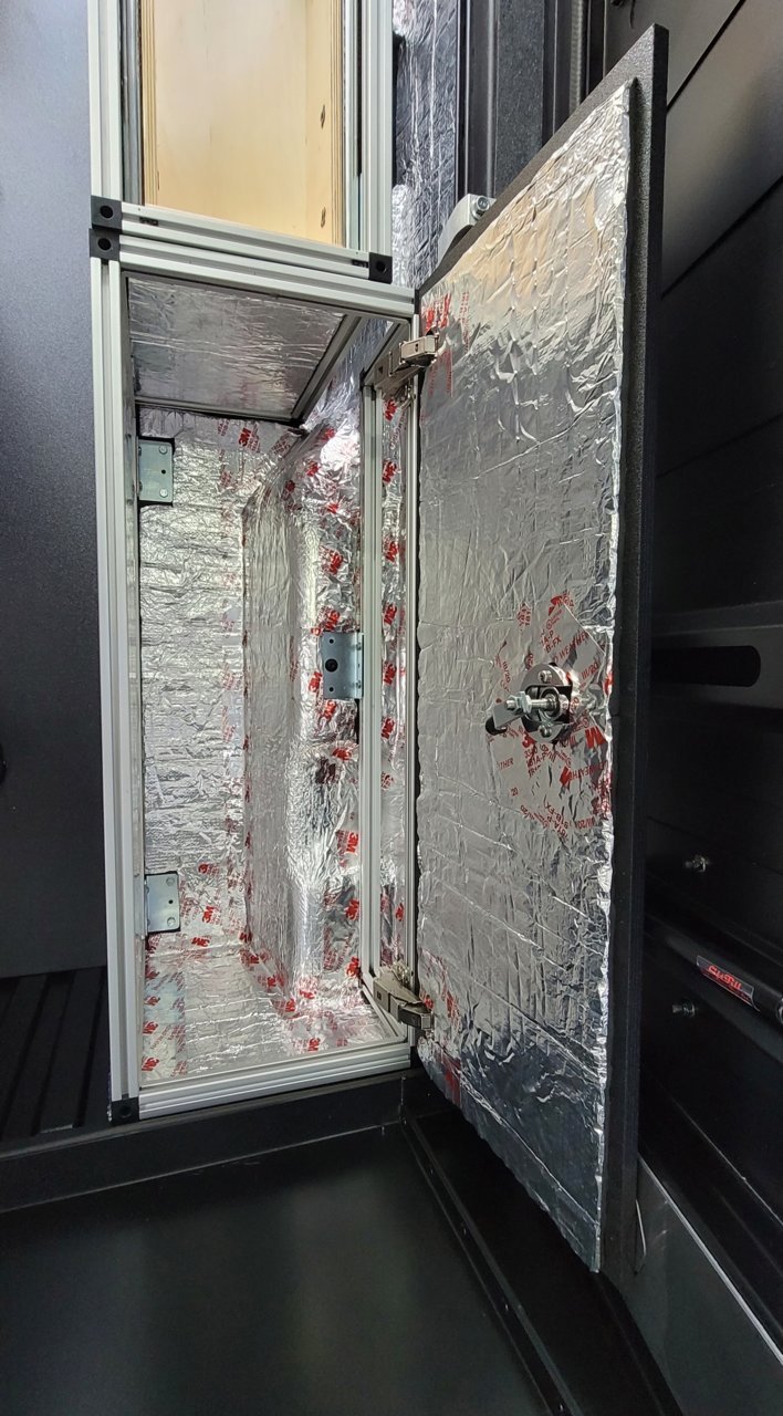

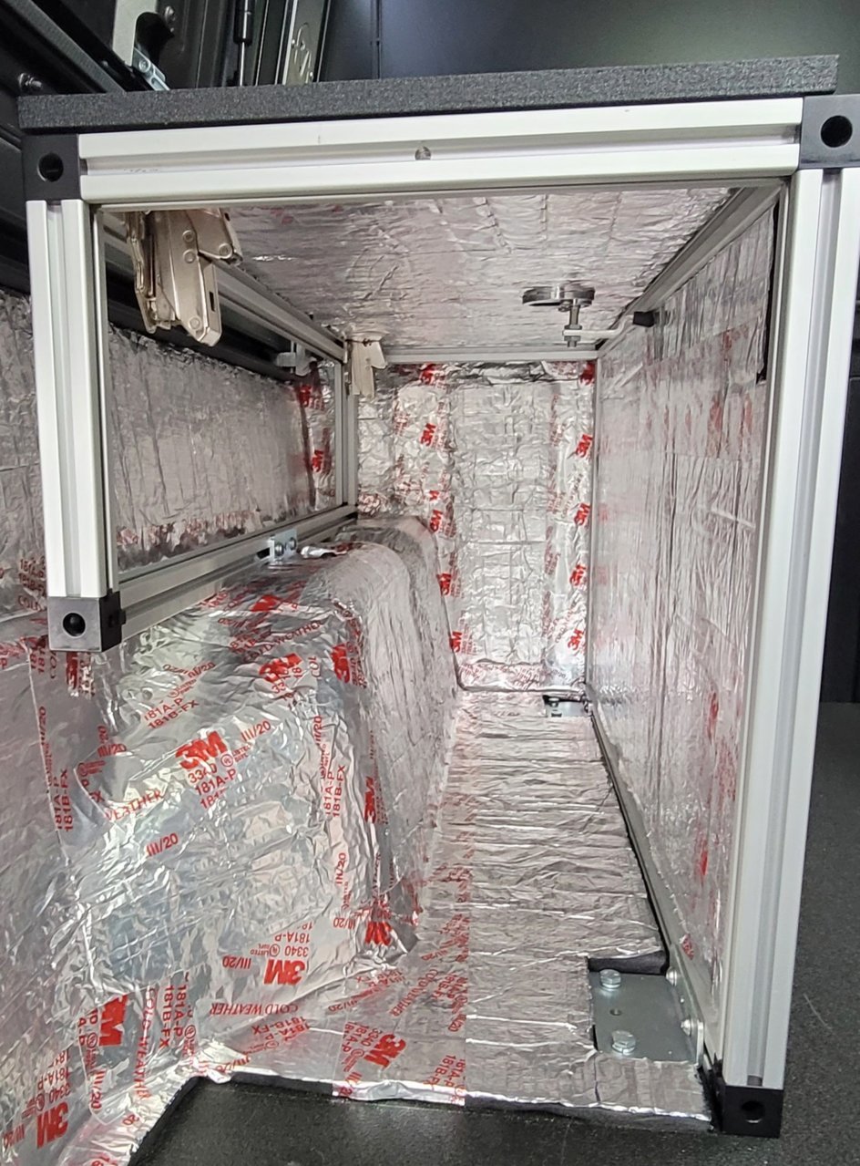

    What is the silver insulating material?

    I think the exhaust is a two in one design (double wall) that lets in fresh air for the combustion process and exhaust for the fumes.
    How do these operate in higher elevations since they are designed to be at sea level?

    Like any propane appliance, I expect it to be less efficient the higher the altitude is. (Typical 4% de-rate per 1000' elevation above 2000') Based on the specs at sea-level, and using a good dual-stage regulator, and considering the small volume of space to heat, it's a chance I'm willing to take. We'll see how it goes. This guy goes into some detail on using it in his RV; he doesn't mention high altitudes, but he seems to like it for heating his RV (much larger space).
