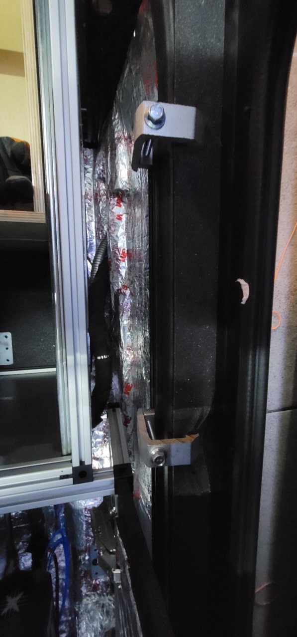

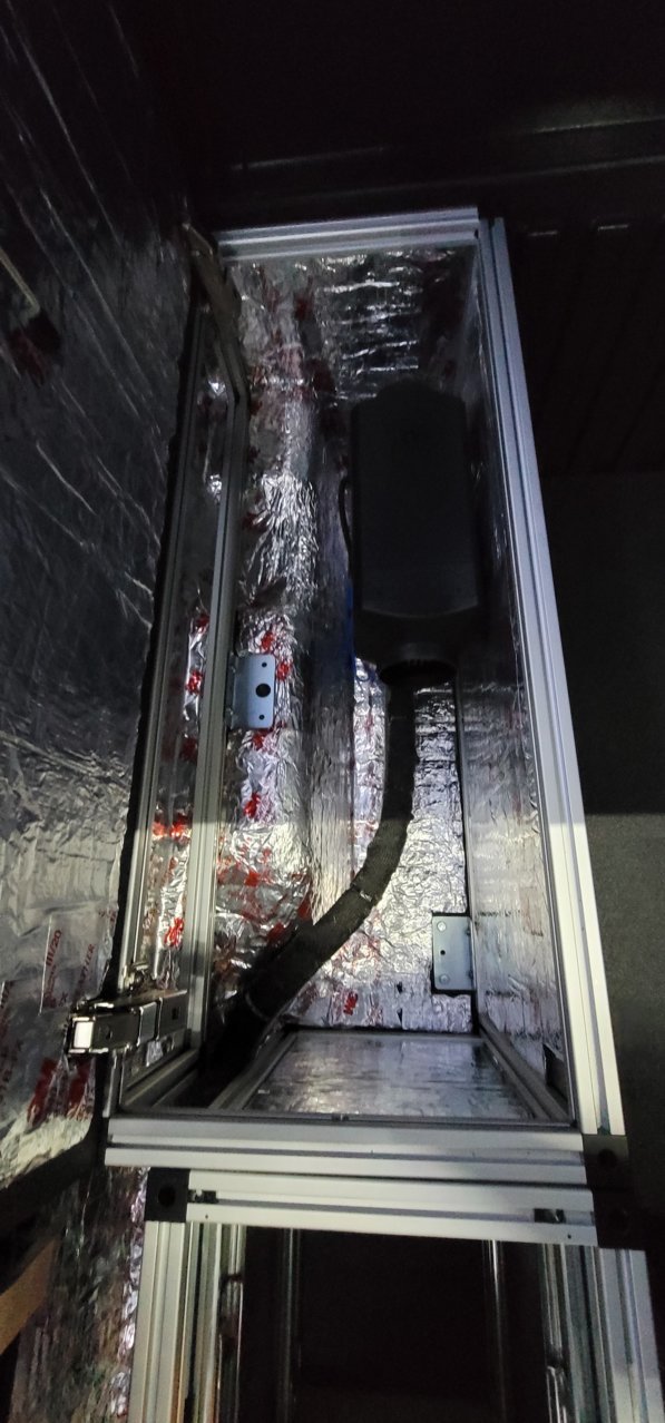

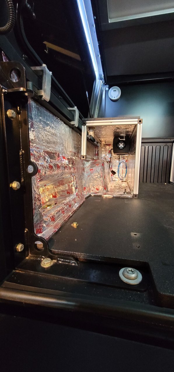

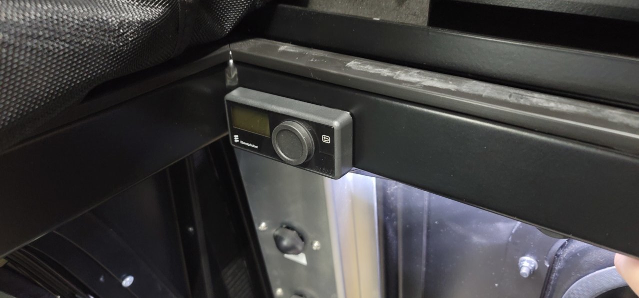

    Made a little more progress on the heater install. Got the heater mounted using an L bracket also insulated the cubby and made two thruholes for the exhaust and intake tubes. Plan tomorrow is to mock up the exhaust line and install the muffler. Progress is slow as i can only put in a couple of hours after work each day.

    I feel like I should put some insulation down for under my heater but I’m being lazy lol. Where are you running the exhaust and intake out?

    I made two holes in the cubby on the left. Haven't figured out where to mount the muffler yet.The insulation is also there to reduce noise as i used a sound deadning material that is rated for hot spaces like under the hood.

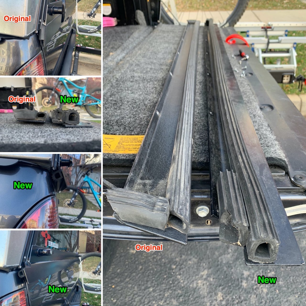

    It did, thank you! Sorry, I forgot to let you know. #11 is just like a brand new Drifter now.
    For others wondering what we're talking about, #11 initially came with a different rear window flap/seal interface which worked great on my 1st gen, but not as good on my 2nd gen. I now have the updated piece that fits better on the 2nd gen. The original was going to prevent me from installing my KBVoodoo tailgate reinforcement piece.
    This is one of the very few items that Vagabond has changed since the first production model, because they did their R&D before releasing the product to customers.

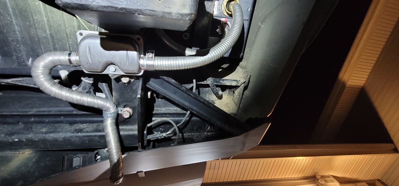

    Made some more progress today on the heater install. The exhaust line was tricky as hell being wrapped in fiberglass, my face is itching bad and glass dust is everywhere.
    Here is what the tubes look like running to the cubby:
    The muffler was mounted to the frame and the exhaust line goes out to the back:

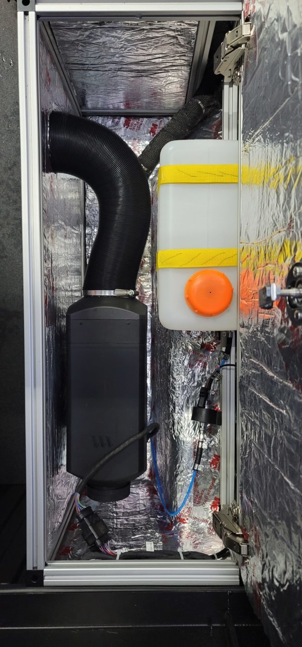

    Almost done with the project! Decided to leave the power on for tomorrow while I have not blown anything up. The tank is installed, got plumbing done, the pump is in, thermostat is installed, air duct is done, and the wiring is routed.

    Well the Espar heater started up on first try and been going for about 2 hours. So far everything seems to be working and the air coming out of the vent is hot enough where you cant keep your hand in front of it very long. The exhaust pipe i bought had oils on it, probably from manufacturing so the pipe has been outgassing pretty heavily. Also I read that the fiberglass wrap outgasses while it cures when hot. So I have been running the heater full blast and running a shop fan to evacuate the fumes.
    Edit: I ended up running the heater for 6 hours yesterday and the outgassing was pretty much gone. Today I will do another startup to see if the exhast tube smokes. Since I have a trip planned next weekend I want burn this thing in through the week so that i can use it while camping. In 6 hours the tank was pretty low so running full blast the heater will use 1.5gal in 7 hours. It will be interesting to see how much fuel it uses during normal operation.
