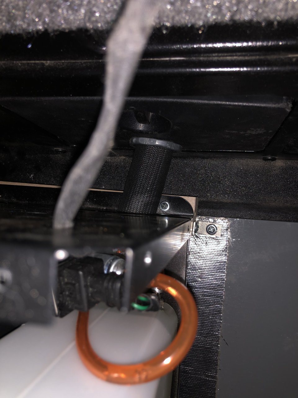

    Lastly if anyone is thinking of installing a fuel tank inside the bed then make sure to run a vent line outside!

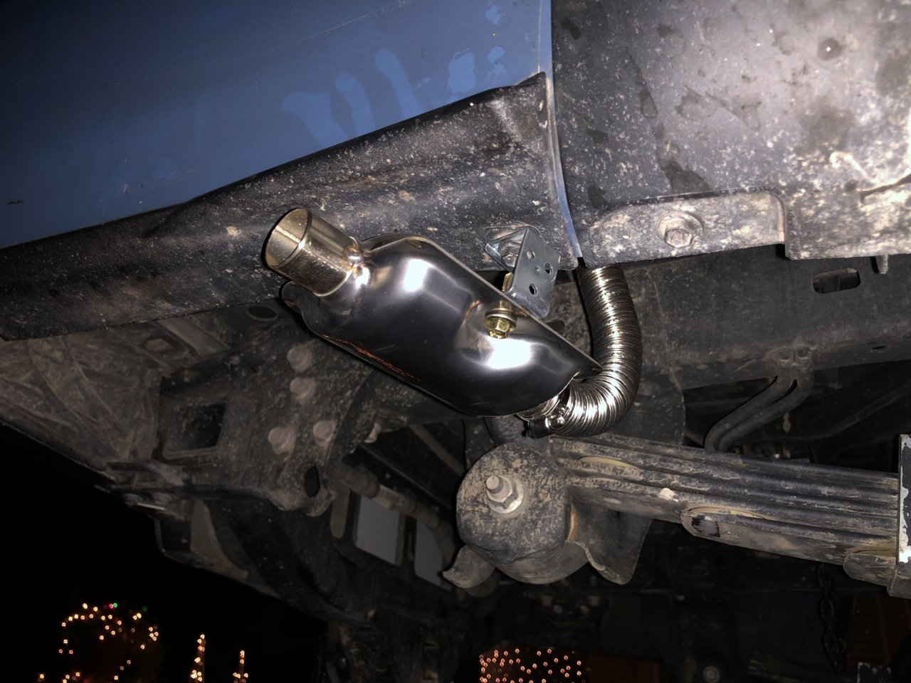

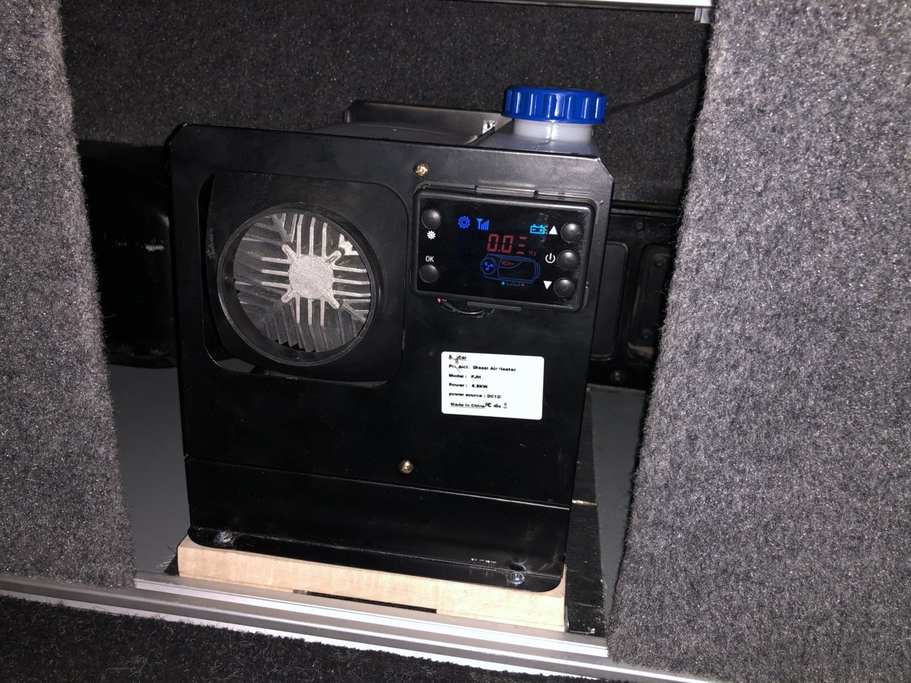

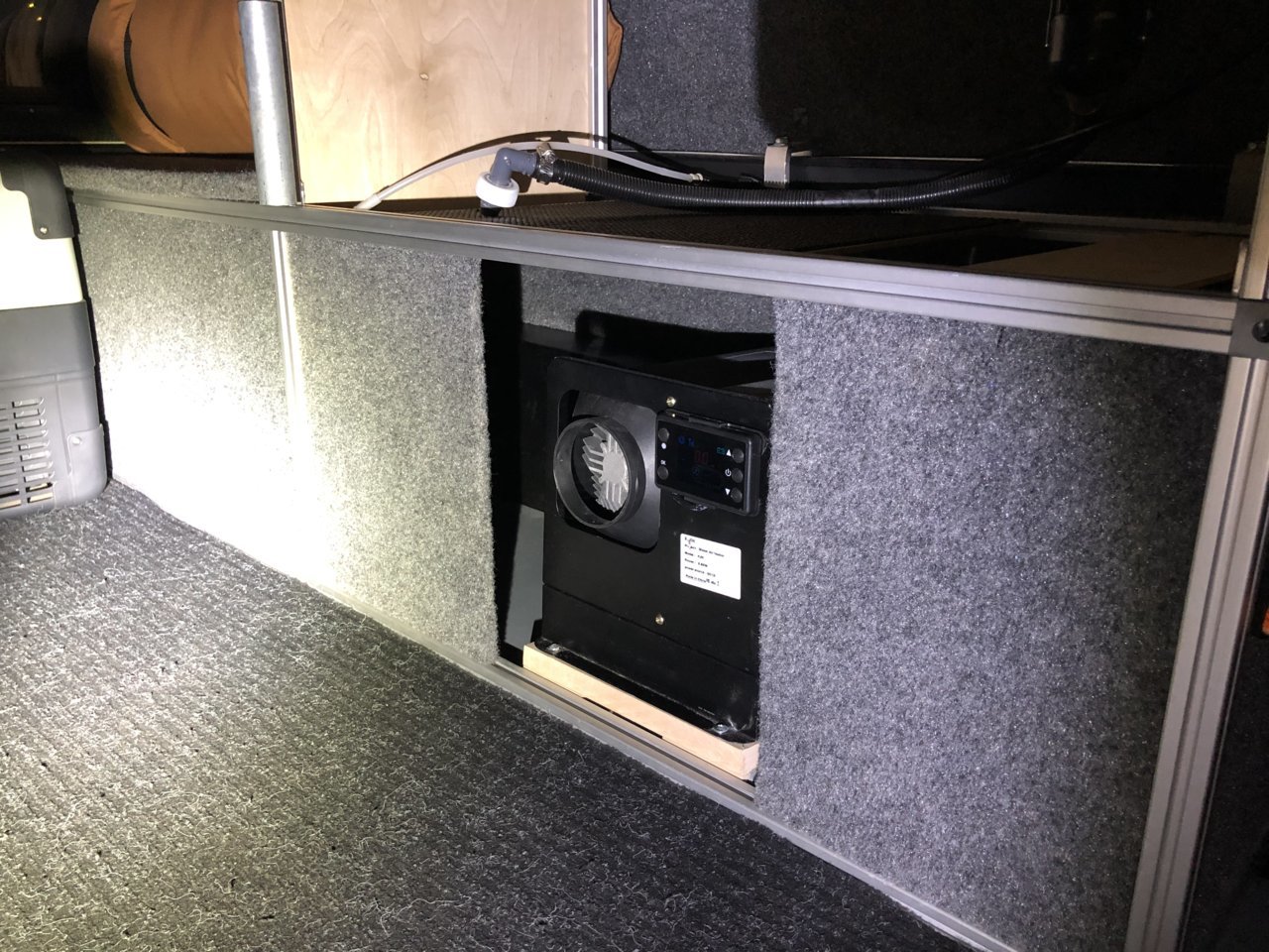

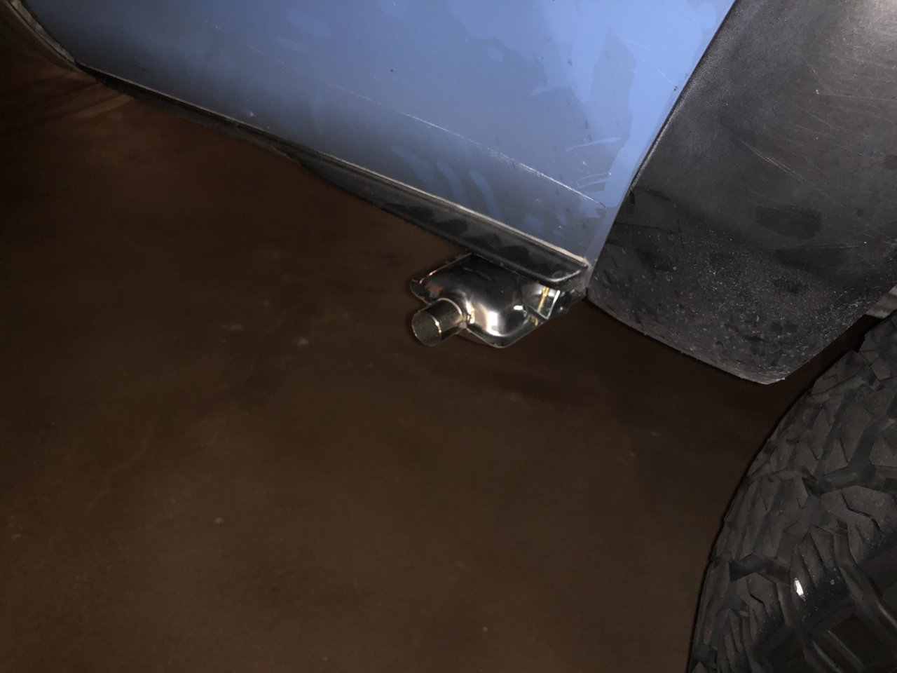

    Ah, finally...heater install is done!
    Here are a few pictures. I did make a video on it on my Youtube channel: socalexpeditions (keeping thread clean by not linking it). You can find that on your own if you’d like!

    Man you have to do a fender mounted GoPro to see the look on peoples faces when they see that exhaust coming out of a Tacoma :rofl:
    Clean install!

    Haha! Someone was already taking a picture of it this morning at a stoplight lol

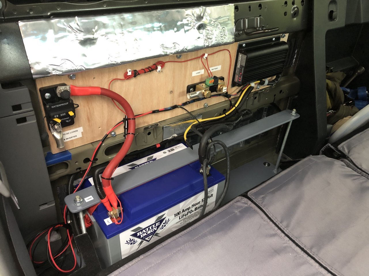

    Thanks for the details. I have the same charger but don’t have any loads connected the the battery yet. I have made one design decision that hopefully will help with cold weather issues.
    I’ve put all the electrical stuff behind the back seats. That way I can just warm the cab with the main cabin heater if needed.

    If the Espar has an hZ mode like the Chinese heaters, then I recommend using that mode. No cycling of any kind and it just keeps the fuel pump at a consistent rate.
    And YES have a breather for the fuel tank. I did mine pretty much the same way I did the read diff breather mod - even using the Toyota breather at the other end (below)
    Good work! Very similar mods to what I've done. Just curious, how come you didn't route the intake outside? Also, the one adjust that I still need to make on my set up is the positioning of the muffler. Mine is the same orientation as yours (I assume because it's best for ground clearance), but it shouldn't be. There's a drain hole on one of the long sides that needs to be pointed down to prevent any water build up

    I just followed what John Mck47 did on Youtube with his all-in-one haha. He put it under the heater, so I did too. That being said, mine is in a much smaller space. I'll eventually move it outside; too lazy right now to remove it.
    I'll try bending the U-Bracket to put the exhaust at an angle. You think that'd work? It looks stupid sideways haha.
