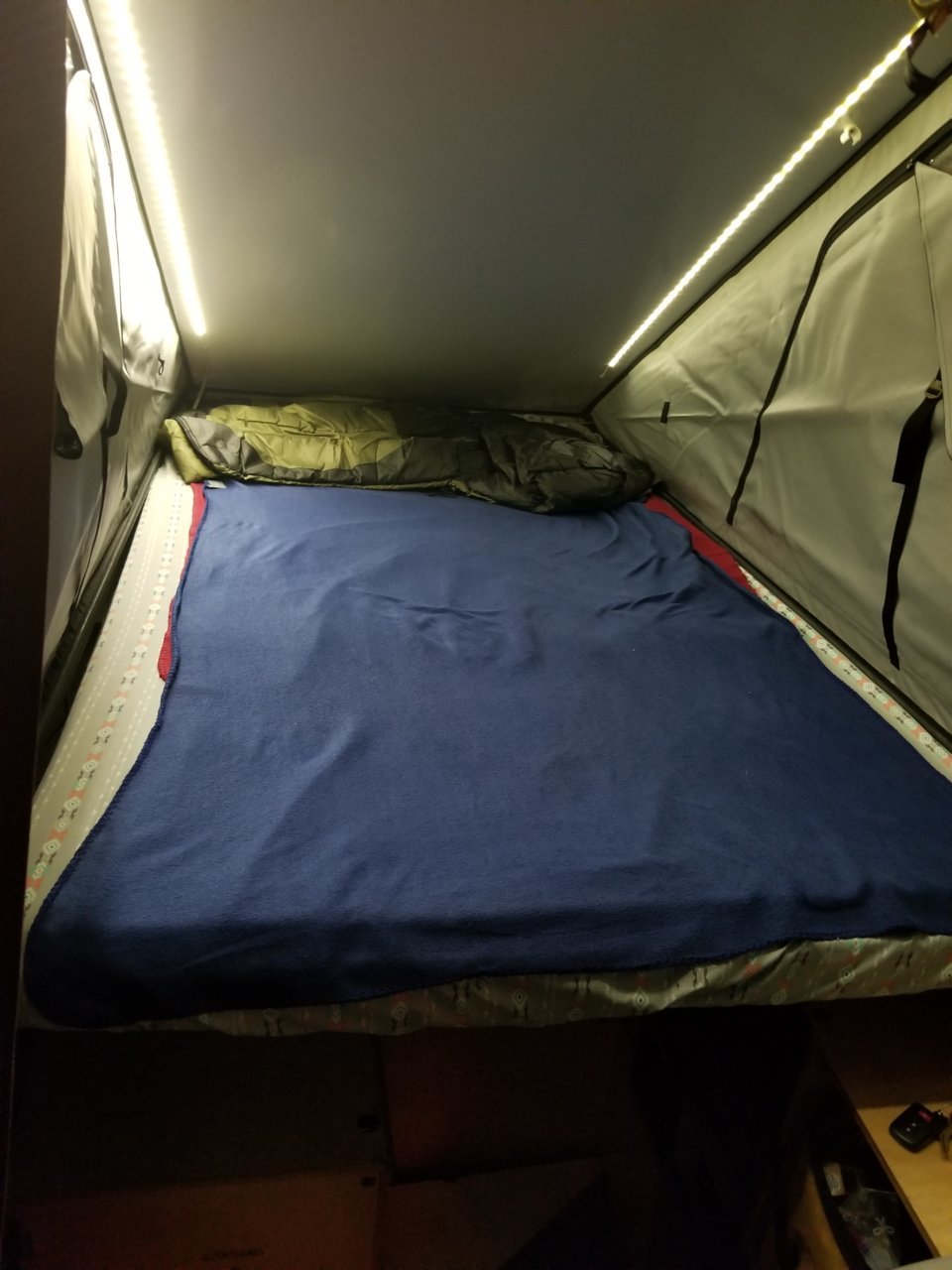

    I know I'm super late to the mattress topper conversation from a while ago, but for another reference point, I've got a 1" latex topper over the original Drifter mattress, and I've found it to be the best compromise.
    (I'll add the caveat that mine was in the first production batch, so I don't know if anything has changed with the mattress since then.)
    Sure, I'd prefer it to be thicker, but the extra inch already forces me to pull the mattress back 10-12" so I can stow the majority of the bedding up in front of it (pic below).
    Personally, I wouldn't want to go any thicker unless I really had to, because when I first added the topper, trying to shut the lid with my sleeping bag (opened up) over the whole bed was already pushing it.
    And it's already comfortable enough like this that I can sleep just fine.
    Here's how my bedding gets stowed with the 1" latex topper on. That's just a 10* Coleman mummy bag (probably ~1/3 of it laying on top of the mattress vs sitting in the cavity), and I've got the full-size pillow and an extra fleece blanket up there in the front too.
