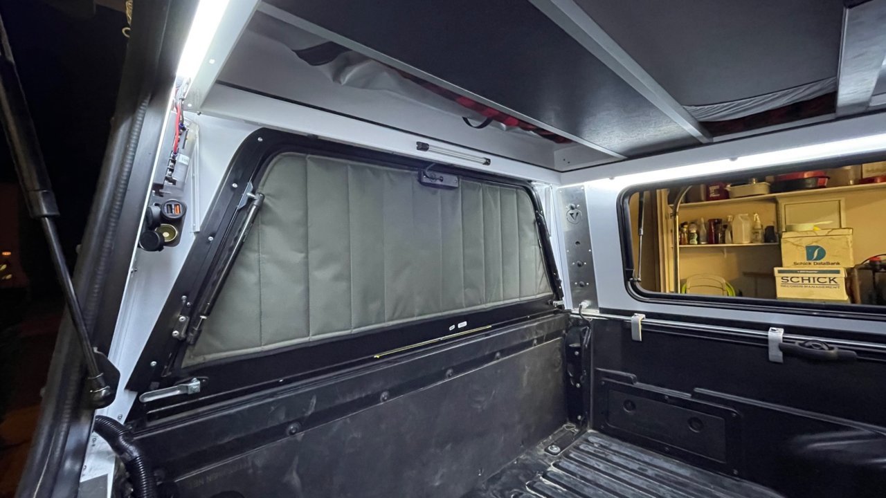

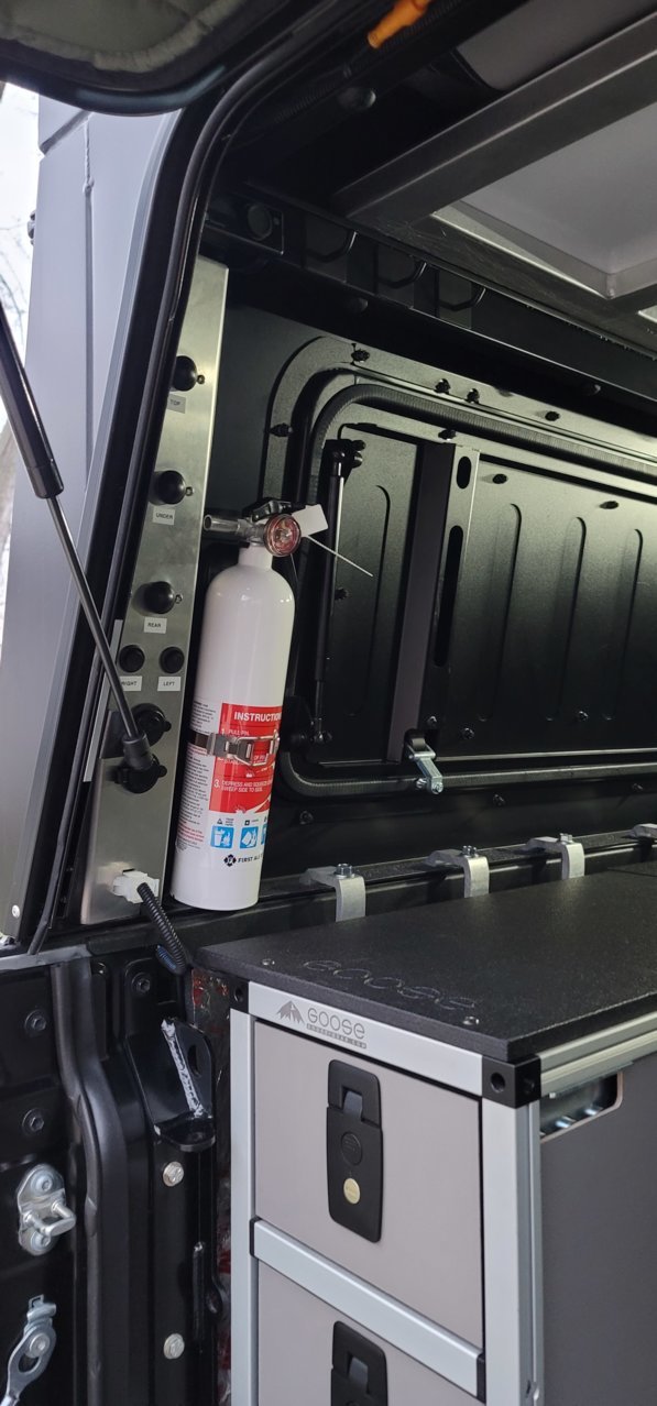

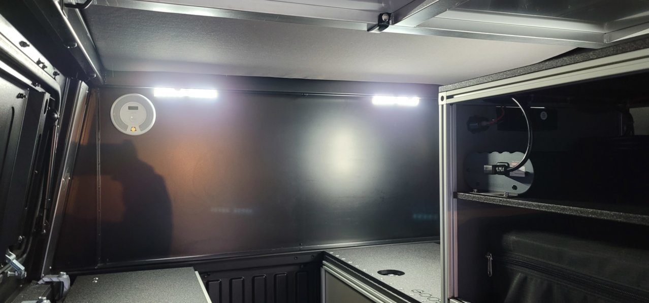

    Some quality of life improvements done today. Added a fire extinguisher as having a heater with a fuel tank is kind of dicey, this just lets me sleep better knowing its there. Also note the coat hangers along the top, now my pants and jacket have a place to hang!
    Another thing that I always struggled with was the lack of light on the back. Its always so dark there that I cant see anything in my packing boxes. Having a black camper doesnt help at all, but the lights are motion activated and turn off on their own. There are two in the back and one behind the fridge box.

    nice. How'd you attach the mount? drill a hole thru the exterior wall and nut + bolt it?

    I thought about it but decided that I couldn't let myself drill a hole. The fire extinguisher is supported on the bottom by sitting on the edge so there is not a lot of weight on the bracket. The sideways force is taken up by 3M double sided tape.

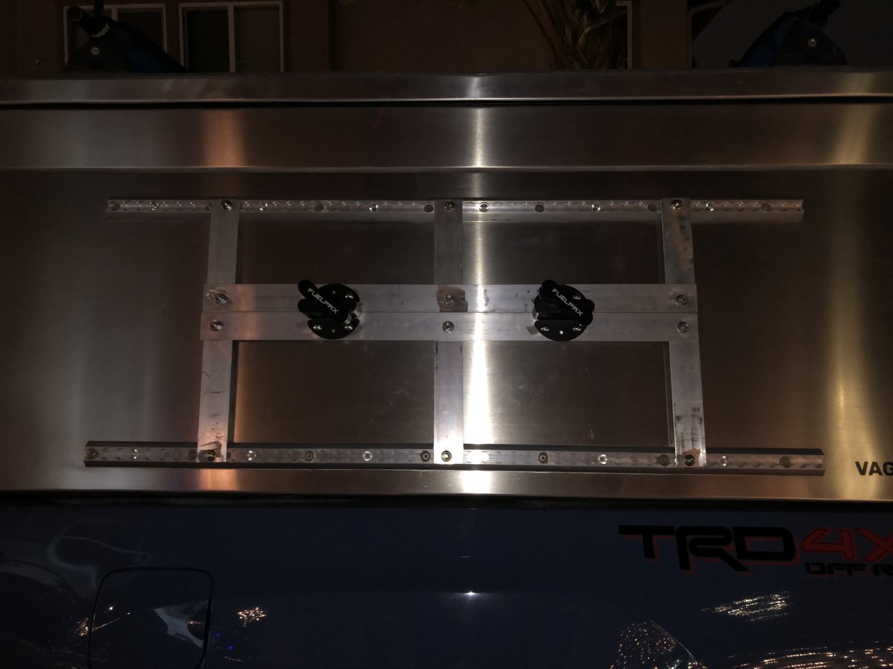

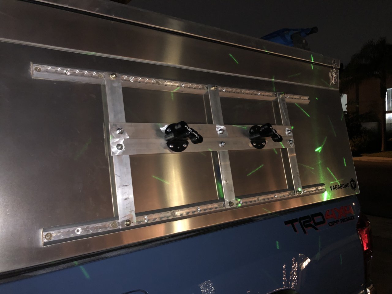

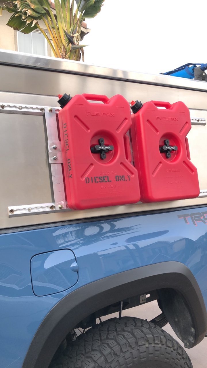

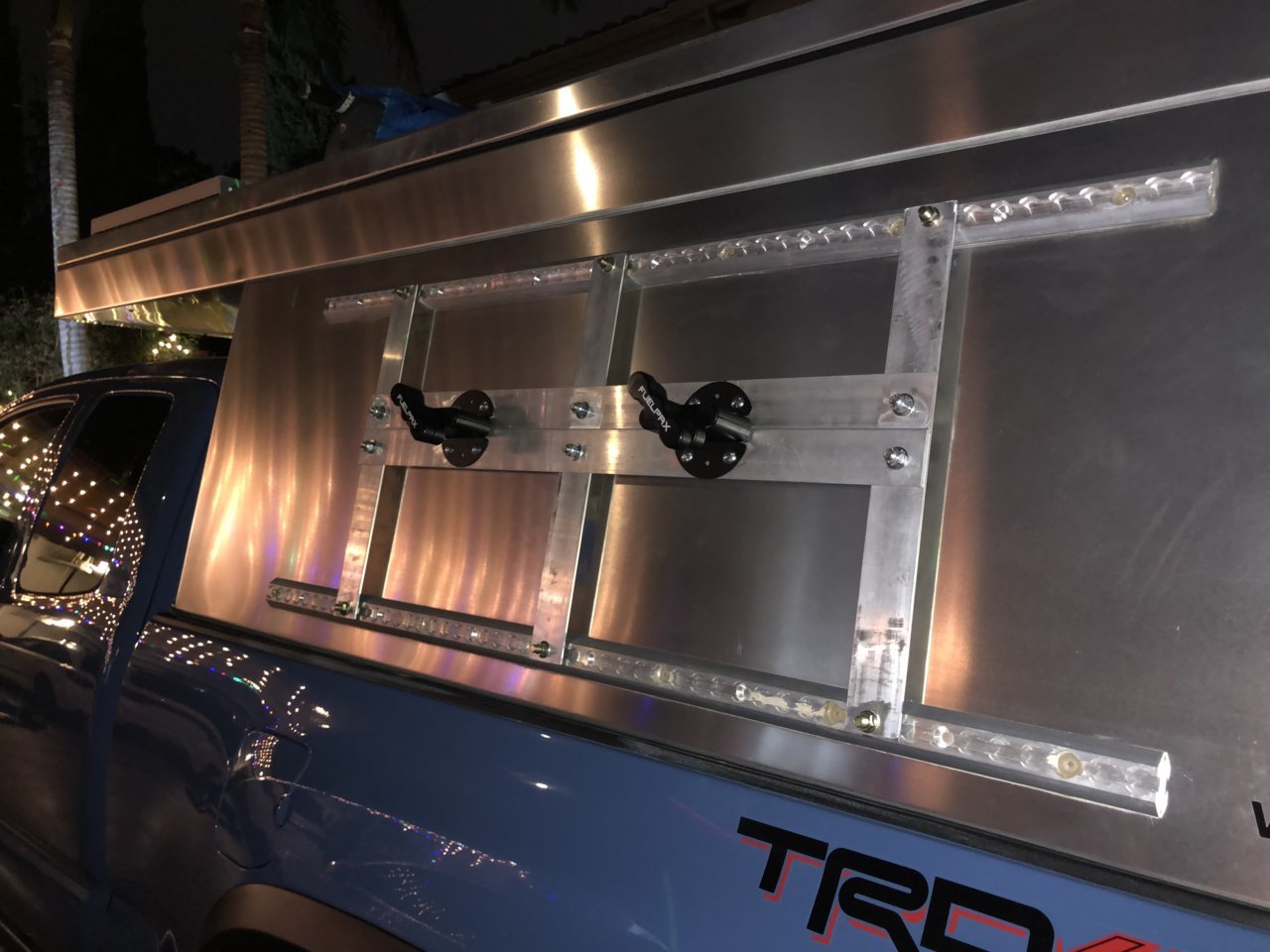

    I watched my battery last night and I ended up only draining to 72% with heater running at 1.5hz all night and fridge at 32°. Redirecting the air up top was a huge help. Battery topped off by 9 a.m. back to 100%.
    Also built a Rotopax mount out of 1/4x2” flat bar aluminum. Really simple.

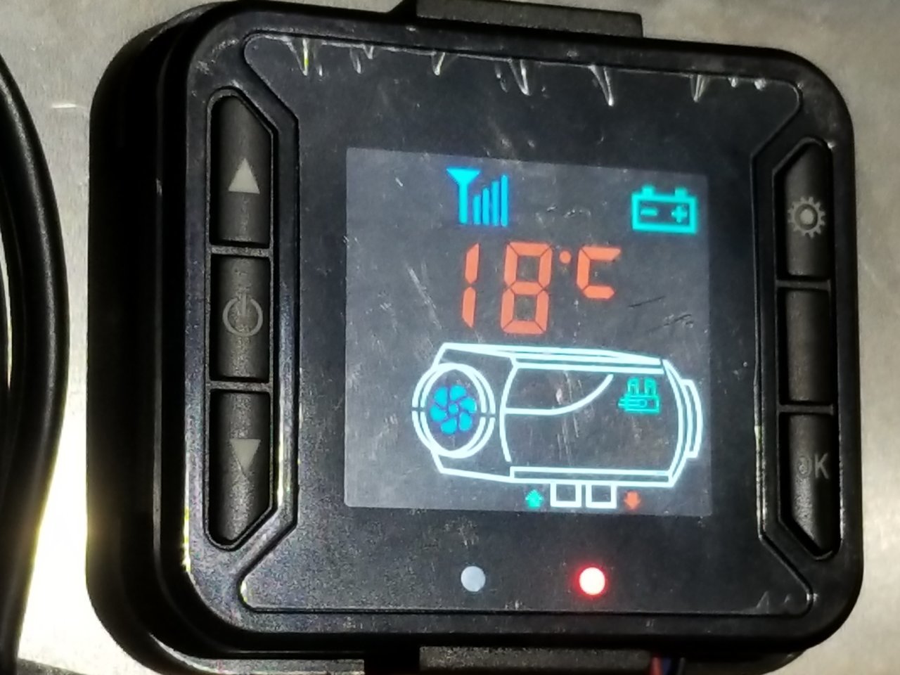

    Sharing some info on tuning the Chinese diesel heaters, for those who have them.
    I HIGHLY recommend at least knowing how to adjust the settings and the implications of how they affect the heater.
    Personally, I'd also say it's important for the sake of tuning them for different elevations.
    This page has, BY FAR, the best tuning guide/explanation I've seen. Look for "Tuning the diesel heater" way down at the bottom.
    http://www.thedoble.com/campervan/i...4ylLGQduZAdrH94cl738x062OvdhVpBbq_JPH46WzMbhg
    In order to follow this method, you've got to have a controller that will show you the burn chamber temp. Most of the controllers don't show this, unfortunately.
    The Afterburner will, but there's also a Chinese controller that is confirmed to have it.
    This is the one I use for tuning. Pay close attention to the buttons though, because this one looks very, very similar to the main black controller you see with these heaters.
    https://www.ebay.com/itm/Auto-Black...ing-Heater-Controller-Switch-12V/254808188759
    To give you a basic idea of why I think this is important, here's where my min and max settings ended up (5kW) after tuning just above sea level:
    Fan min 1450 (lowest available)
    Fan max 5000 (highest available)
    Fuel min 1.1 Hz
    Fuel max 4.5 Hz
    I think most factory max fuel settings are in the 5.0-5.5 Hz range, which seems excessive and increases the potential carbon buildup in the burn chamber and CO levels in the exhaust.
    Even if my max of 4.5 Hz is leaving some heat on the table, it's already more than I need in the Drifter.
    And at higher elevations, you'll obviously want to bring the fuel down even further to compensate for the lower oxygen levels.
    Oh, and the codes to get into the settings menu are usually either 1688 or 9009, as far as I know.
