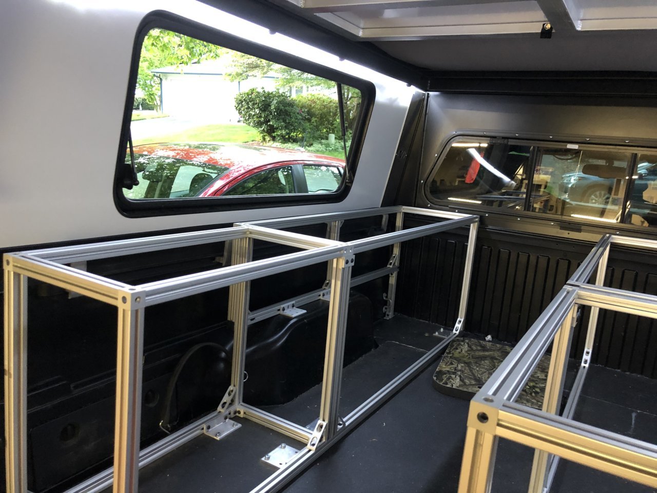

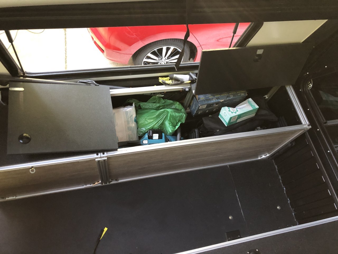

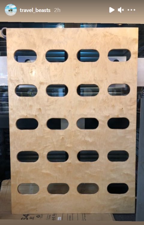

    Back on the everpresent baseplate conversation, someone is using birch for a bed platform on their Landcruiser build and cut a bunch of holes in it to reduce weight. I'd like to do the same honestly and so long as I plan where the 80/20 is going to bolt to it, I cant imagine there would be much downside? Still should be pretty rigid I'd imagine? Would just fill the holes with some carpet or something

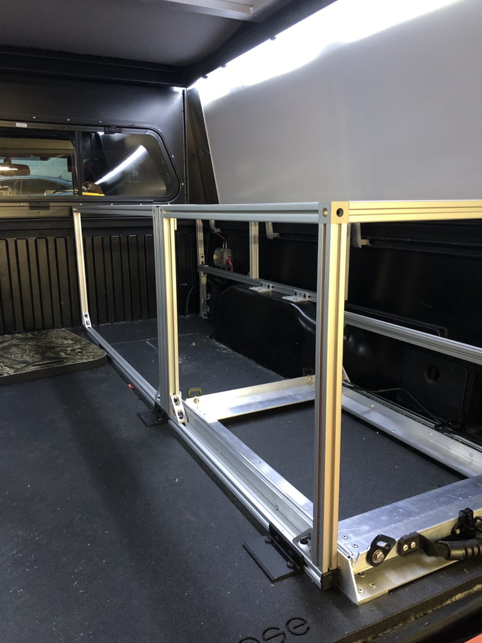

    How much would you guess you spent on just the 80/20 and wood build? What kind of wood and paint did you use? Any photos of the drawer?
    looks amazing! Hope to build one soon. Thanks!

    I'm making a similar build and my extrusion order was around $400

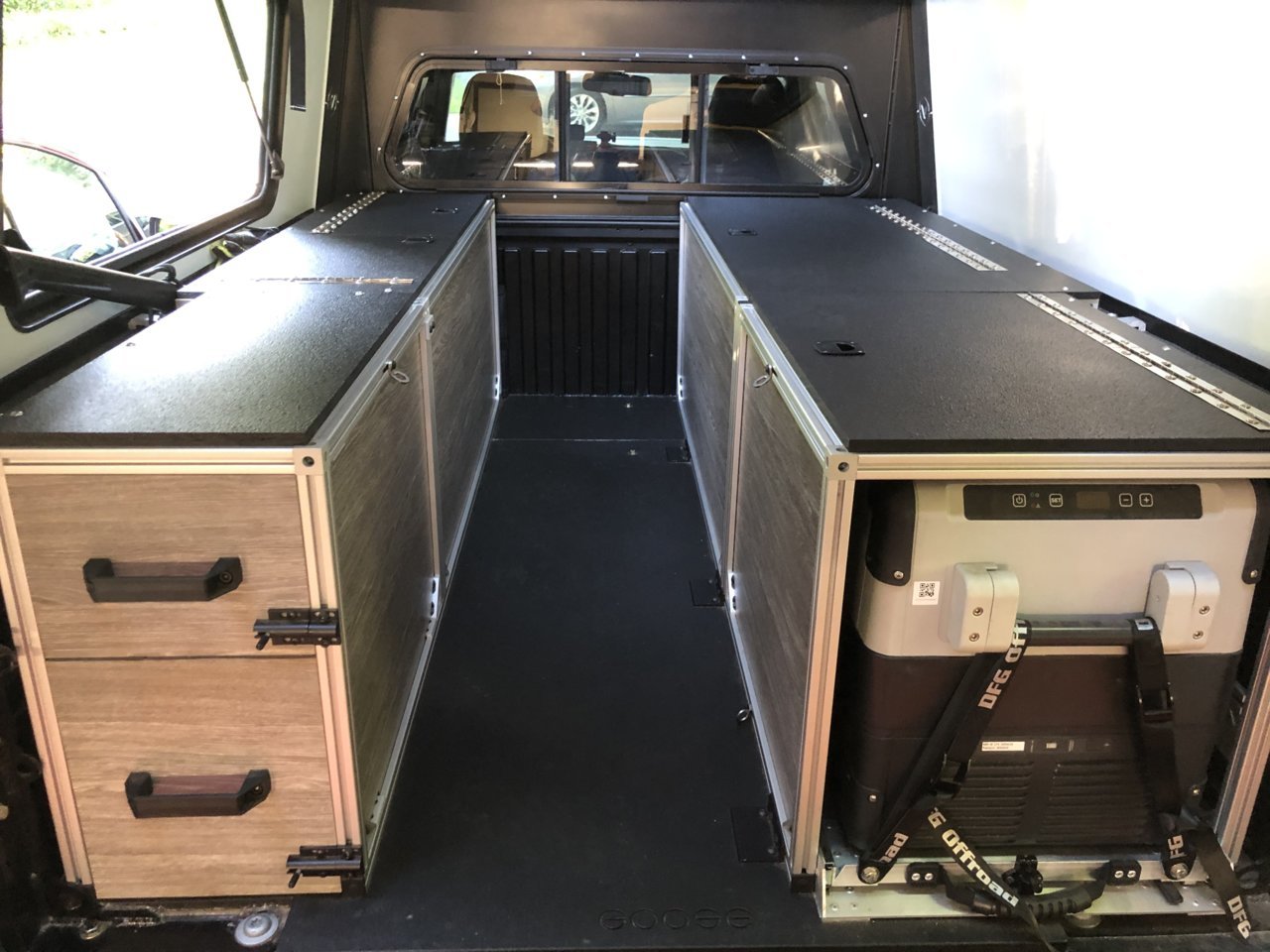

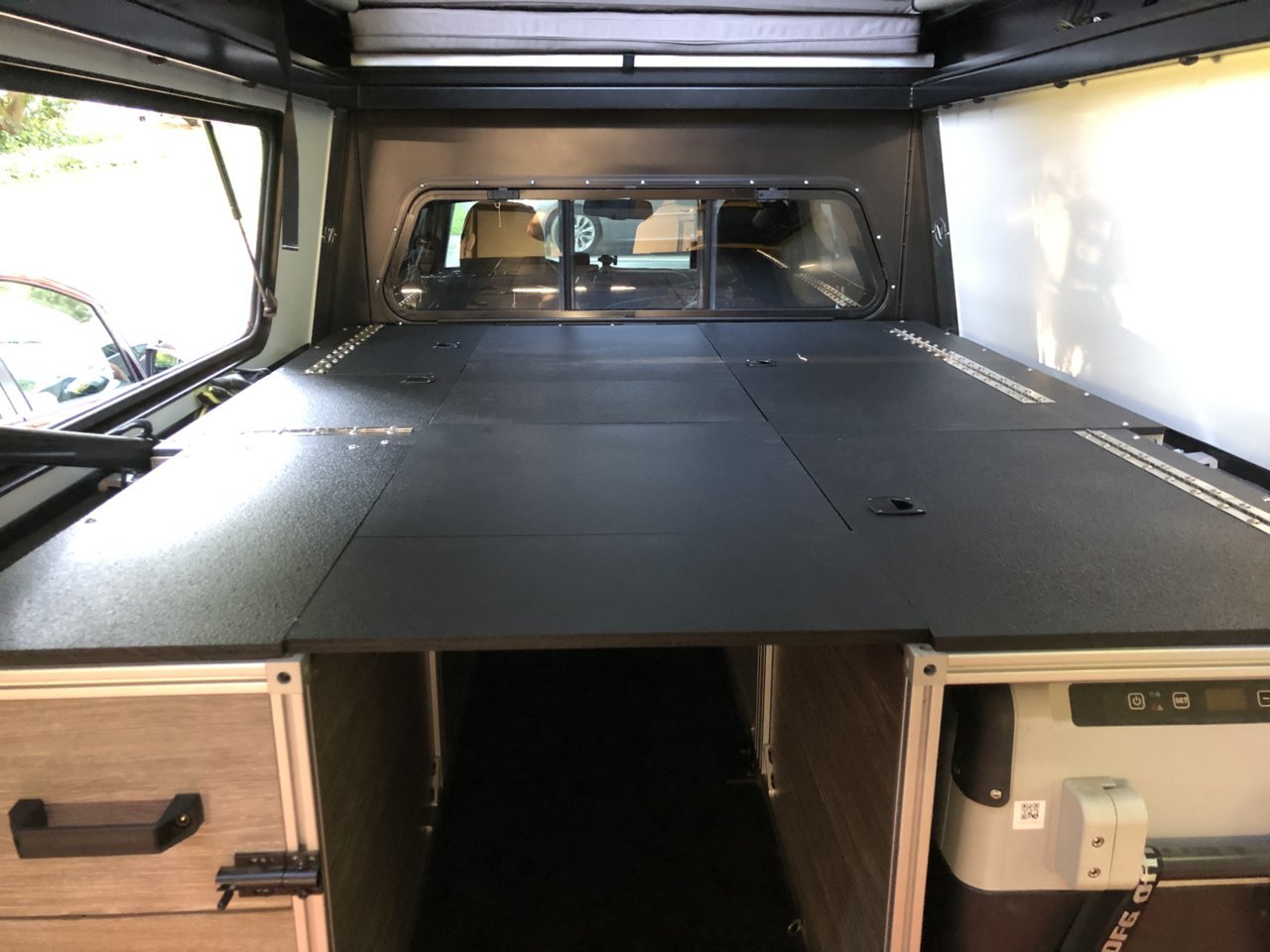

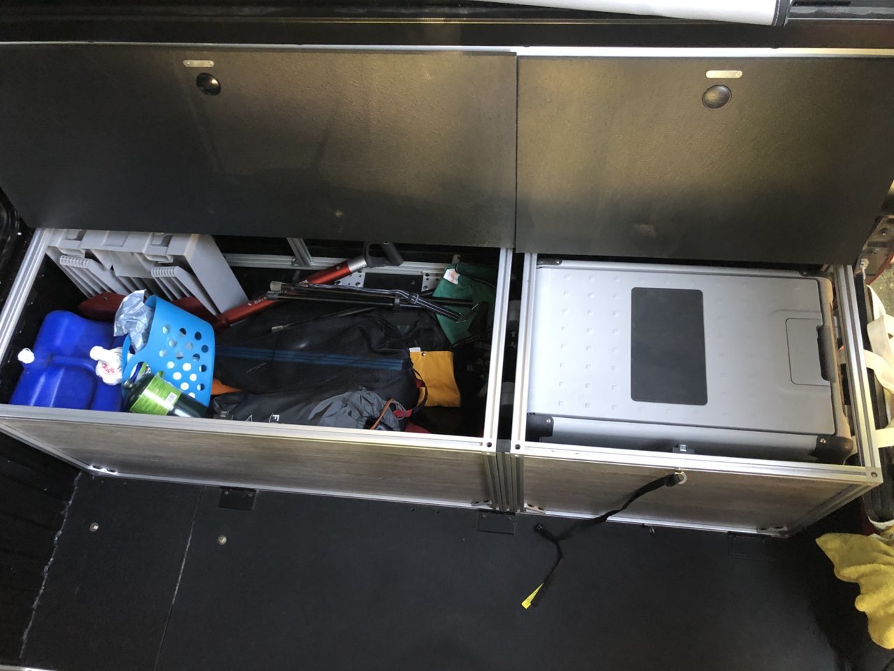

    More progress on the interior build. I got the cabinets finished and the deck / table piece done. The galley cabinet sink and stove are operational, but I have more work to do inside the cabinet. My design goal here was to have a comfortable standing height workspace for the kitchen galley, and space in the middle of the floor for two people to move around each other, but also to create a lounging deck for times when you just want to hang out in the camper. I didn't want to have to sit rigidly upright on a small bench seat for that. So I made a deck / table piece that allows two lounging chairs to be set up in "deck mode" and then it converts to both a tabletop or a countertop using the Lagun multi-position mounting system. When this piece is not being used, it just leans upright against the forward window. It matches the width of the center cabinet, so you can still open both side cabinet tops without it being in the way.
    Deck mode:
    Table mode:
    Countertop mode:
    One reason all this works is because I kept the fridge in the Extra Cab (where I've always had it). It stays cooler in there, doesn't take up precious space in the Drifter, and I never hear it.
    The galley cabinet with the epoxy design wrapping around it turned out pretty cool. I got the black flush slam latches for the doors, but now that they're on I like the look of just the wood and epoxy. Does anyone know of a good latch system that would remain hidden? Some kind of releasing magnet?
