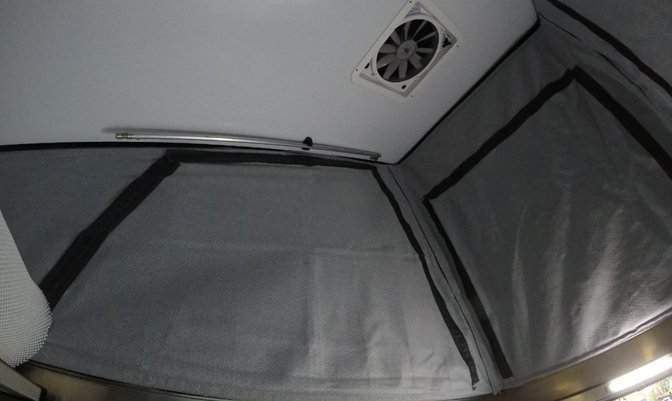

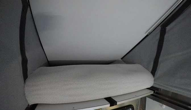

    For what it's worth we have this condensation mat: https://www.tochta.com/product/hypur-flo-moisture-protection/. It definitely has a more finished and softer feel & look than Hypervent to match the sexiness of the Drifter. It makes a complete mess when cut to fit, but once shaken out good we haven't had issues other than a few stray fibers around the camper. So far it seems to eliminate condensation & potential mold problems on the bottom of the mattress when cold weather/snow camping and we just have a little condensation on the platform itself to wipe with a microfiber hand towel, very minor. If we blast the heater at a high temp all night rather than turn it way down condensation would obviously be eliminated but we try to conserve propane and not have the heater kick on/off a bunch when we don't need it to stay warm or dry out our snow gear. The mat also added extra comfort to the mattress as an added bonus, score!
    There is going to be serious stoke once the Vagabond insulation pack is released, especially those that don't have a propex or diesel heater. Not sure what theirs looks like but so far our homemade insulation pack appears to retain heat pretty well and has a noticeable warmer feel inside tent than without it. The only downside to our insulation pack is we do see some condensation between it and tent wall when fully sealed up more so than without, as is to be expected I suppose. So long as we are able to keep the top popped for a bit in the morning or during the day and run the heater and/or fan, it dries up quick.
    Lastly, we added a removable clear vinyl window cut to fit the rear window inside the overlap flap using vinyl velcro, so that you can have the rear window open in cold/poor/dusty/windy weather to enjoy the views. Highly recommended!
