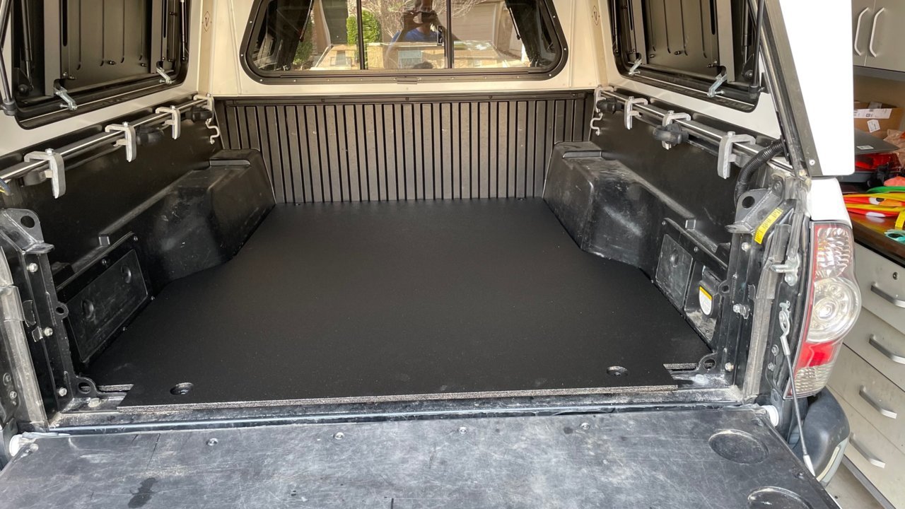

    I got my baseplate Line X'ed today. Quick 15 minute process. Found a place to do it relatively cheap for me, $70. Others wanted 2x more.
    I'm searching for a slide for my ARB50 fridge.
    Anyone know if this brand is any good? Thinking about purchasing this one since its competively priced and I do not want to pay an arm and a leg for a slide. https://www.amazon.com/gp/product/B...&pf_rd_p=5ae2c7f8-e0c6-4f35-9071-dc3240e894a8

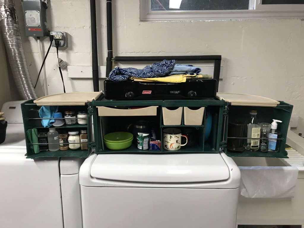

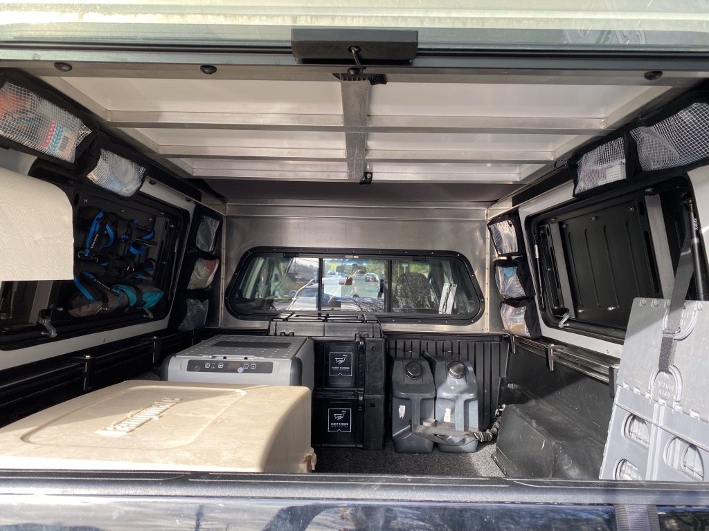

    @alldownhill Beautiful set up. I have something similar, with a wooden spin on it.
    Love the ideas of the Bungys. Where did you get the mesh pockets?

    I sealed mine with Flex Seal spray sealant/adhesive. Has a similar texture to the line-x but I bet that's way nicer. I'll be curious to hear thoughts on that fridge slide as well, the ARB one is just insane how much it costs.

    I got a few different velco mesh pouches from Amazon, just search that term and plenty should show up. I have since removed the mesh pockets as I didn't find them particularly useful and the velcro wasn't quite strong enough for day to day use.

    I used the existing drainage holes from the front and installed Rivnuts in them, and purchased 2 extended bed bolts for the rear.
    I did not want to drill any holes in the bed at this time.

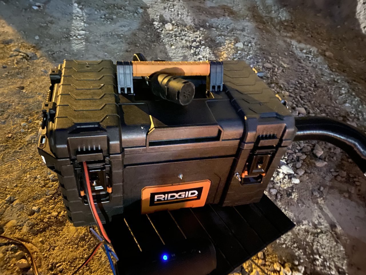

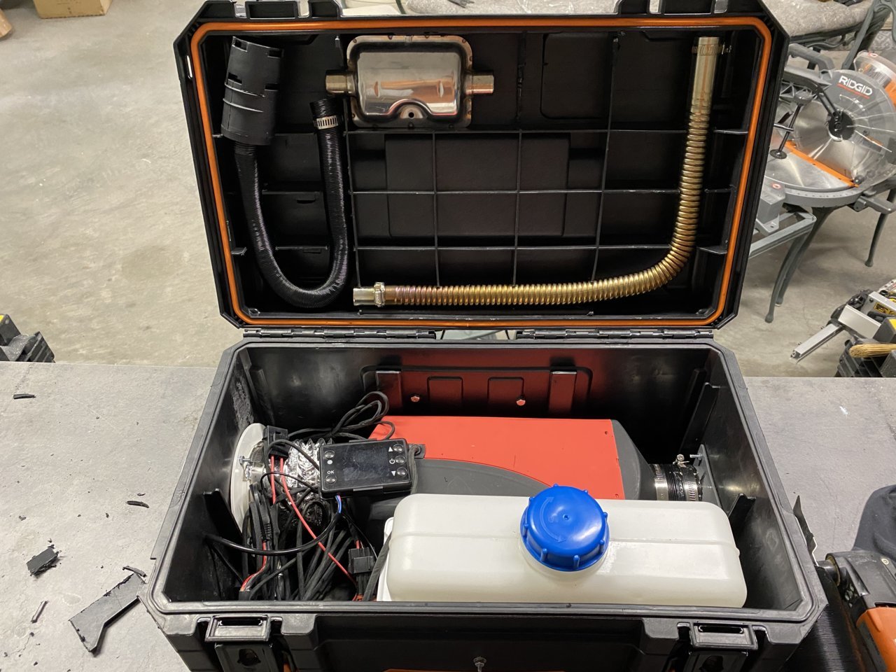

    About halfway done...
    Nice work
    Do you plan on recirculating the intake air from the Drifter? How are you running the ducting to your inside space?
    What's the size of that Ridgid box? Do you have a link?

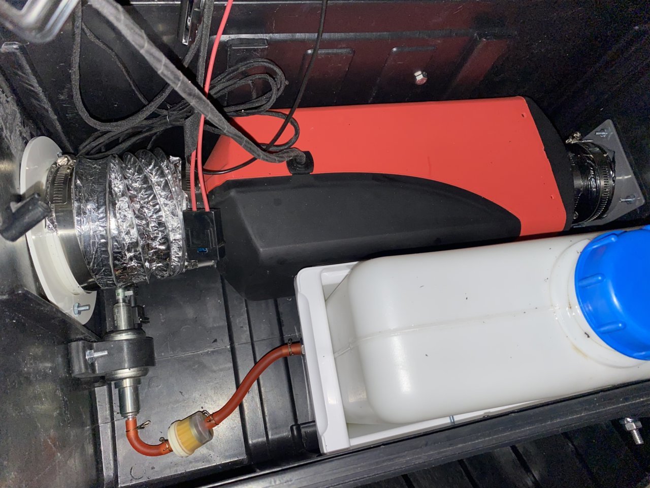

    Did you put the original fuel tank in another container for spill protection?
    It's an interesting idea to have all the noisy stuff outside (fuel pump and Fan)

    Currently I just have the box with the intake as well as the exhaust both outside.
    I only have the hot air going into my campershell through a dryer hose.
    I did put that extra fuel tank in another container to catch the spill. There is a way you have to modify the fuel tank so it doesnt spill but i havent been able to figure that out yet and this solution just gives me more peace of mind.
    Exactly, all the noise is outside. can still kind of hear it but I like that I didnt have to drill any new holes and I can use it when i have friends camp with me and we need to use a tent.
    Heres is the link to the toolbox:
    https://www.homedepot.com/p/RIDGID-...y8qdDNbYgbji5B1vMwhoC_b8QAvD_BwE&gclsrc=aw.ds

    Im not sure how to multi quote, i posted the details of the box in my other post above.
    As for the return duct, im thinking of running a longer hose into the camper so i can recirculate the air.

    That is a nice toolbox very well built. Unfortunately, my fuel tank is almost 16" tall with the cap (10Liters).
    Did you find a different smaller tank or did your heater kit come with the small tank you are using?
