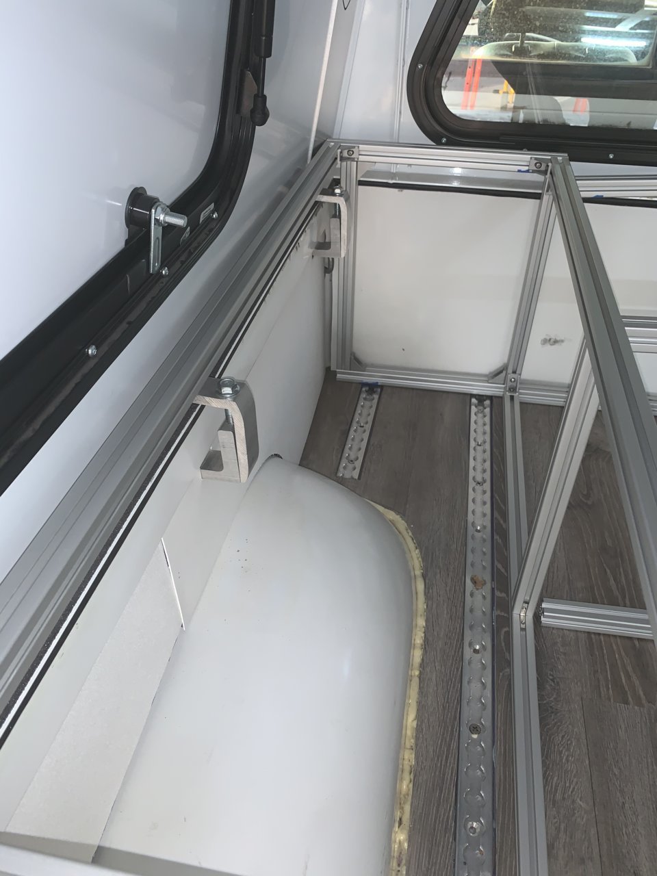

    It's a little tough for me to tell how much clearance there is between the top of your bedrails and the bottom of the window openings, but I'll post this just as some general input for dealing with the differences in width on the floor vs. width at the bedrails. In general, try to include vertical framing at the corners of the cabinet nearest the bedsides. If you have something in the way, then you might have to offset the upright and then tie it in with the top horizontal frame. If you have a wheel well in the way and there isn't any way to include an upright, you'll need to anchor the frame to the bedrail. You can see in the pics below, an example where I used a horizontal frame that ran parallel and just above the bedrail. It sits further out than the corner vertical upright frame posts. I found by placing the top elevation of the (bench) cabinet above the bedrails, I could conceal the camper clamps. Yet, they are still accessible for removal.
    At the fronts of these cabinets where the horizontal frames are closest to the truck cab, I had to shave the frames because the Drifter camper contours in toward the cab at this location. It's ugly, but it can't be seen once the cabinets are in place.
    Once the hinged lids are on, the top horizontal framing along the bedrails is barely visible.

    Apologies if you've answered it elsewhere, but how did you bolt that seat track down to your bed?
  13. Jan 29, 2021 at 1:44 PM
    #5173
    gnardoggie
    gnardoggie Well-Known Member
    Jul 20, 2016
    #192449
    1,330
    That's a super helpful write up. I didn't think about bringing it above the bedrail and mounting downward onto it. Then you could use a simple L bracket to get it in there.

    See post #4159 of this thread. It's fastened to the bed using plus-nuts and 1/4-20 stainless steel screws.
