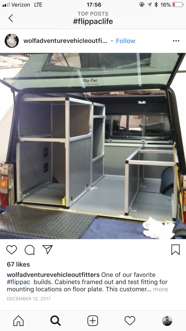

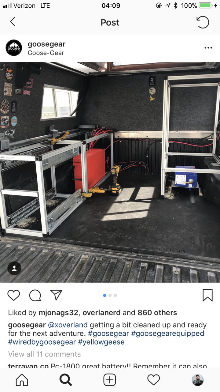

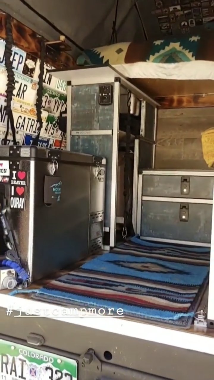

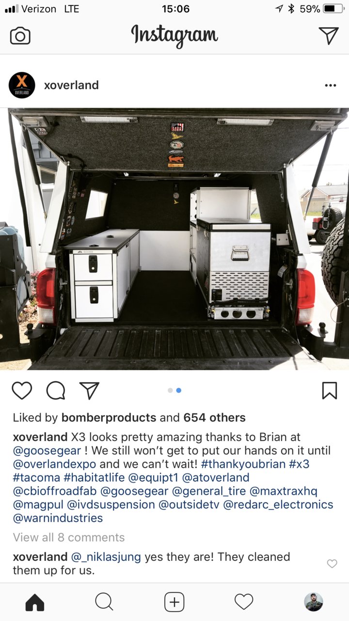

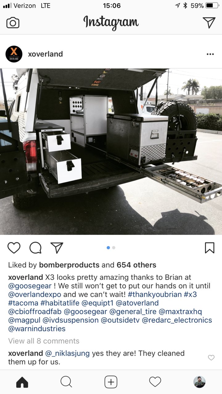

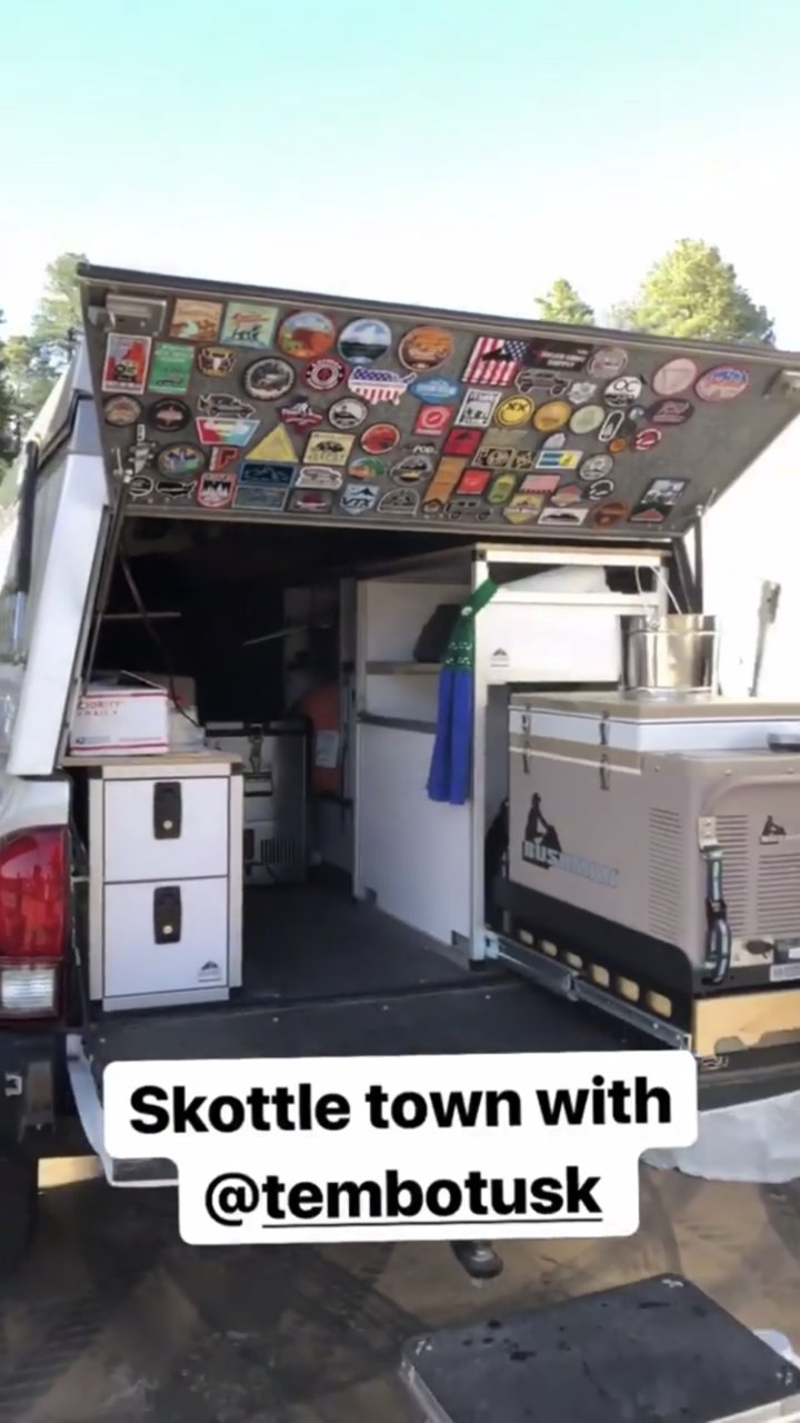

    Here’s a bunch of screenshots I have from IG showing completed and in progress Goose Gear builds. If you pay attention you can see how they are constructed.
    If you have the money the Goose Gear stuff is all beautiful and a work of art. Way beyond my skill level for sure, but unfortunately also beyond my wallet.
