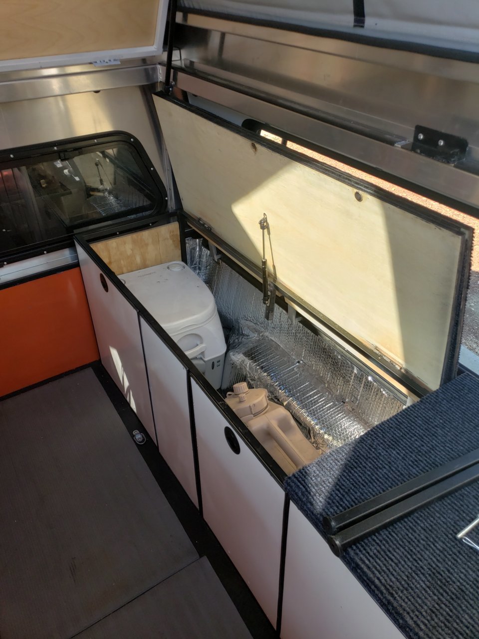

    What is the fabric called that you are using on the seats?
  3. Feb 13, 2021 at 5:33 PM
    #5203
    excav8tor
    excav8tor Well-Known Member
    Mar 1, 2016
    #179882
    154
    vic
    2016 Toyota Tacoma TRD sport 4x4 White
    I used an outdoor type carpet from Lowes that I attached using spray adhesive

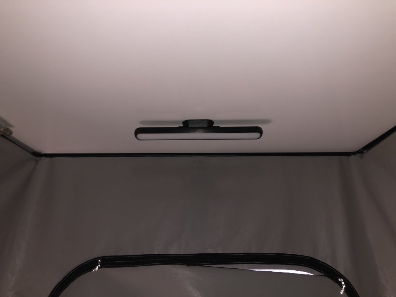

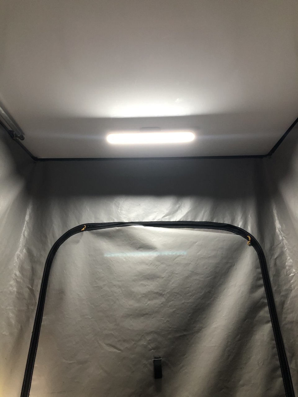

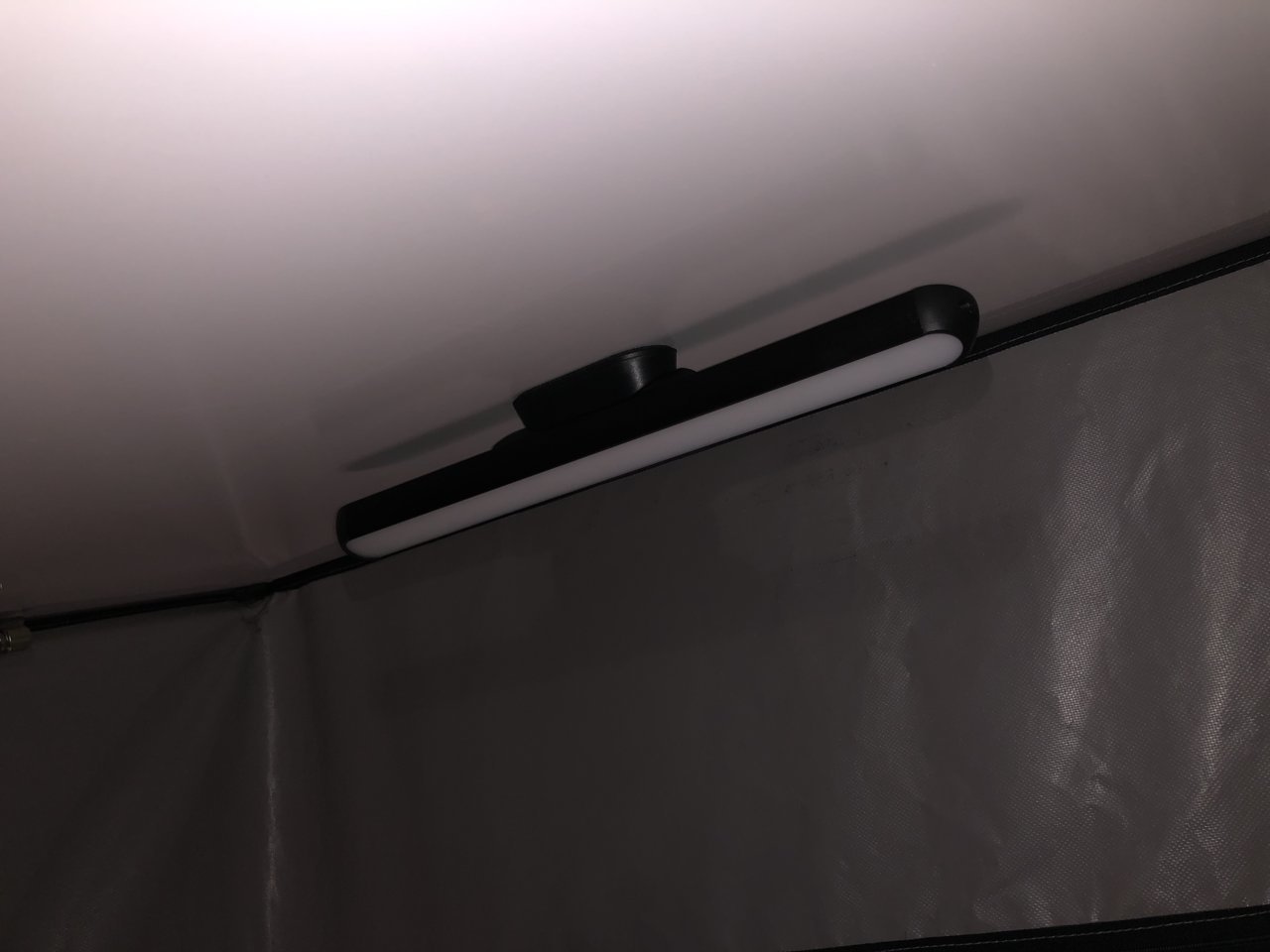

    Finally added a light! Goal was no wiring, aim-able, and cheap. Oh and its magnetic, so you can remove it and use it as a light wand.
    Link: https://amzn.to/37pamD8 (it an affiliate link btw, just what i have already copy and pasted)

    Got more details? That looks awesome!

    Ha I was going to ask that.
    Amazon link or it’s not real! Lol

    I put the link in the post. It's not an insanely bright light, but enough. You can also get the remote version too.

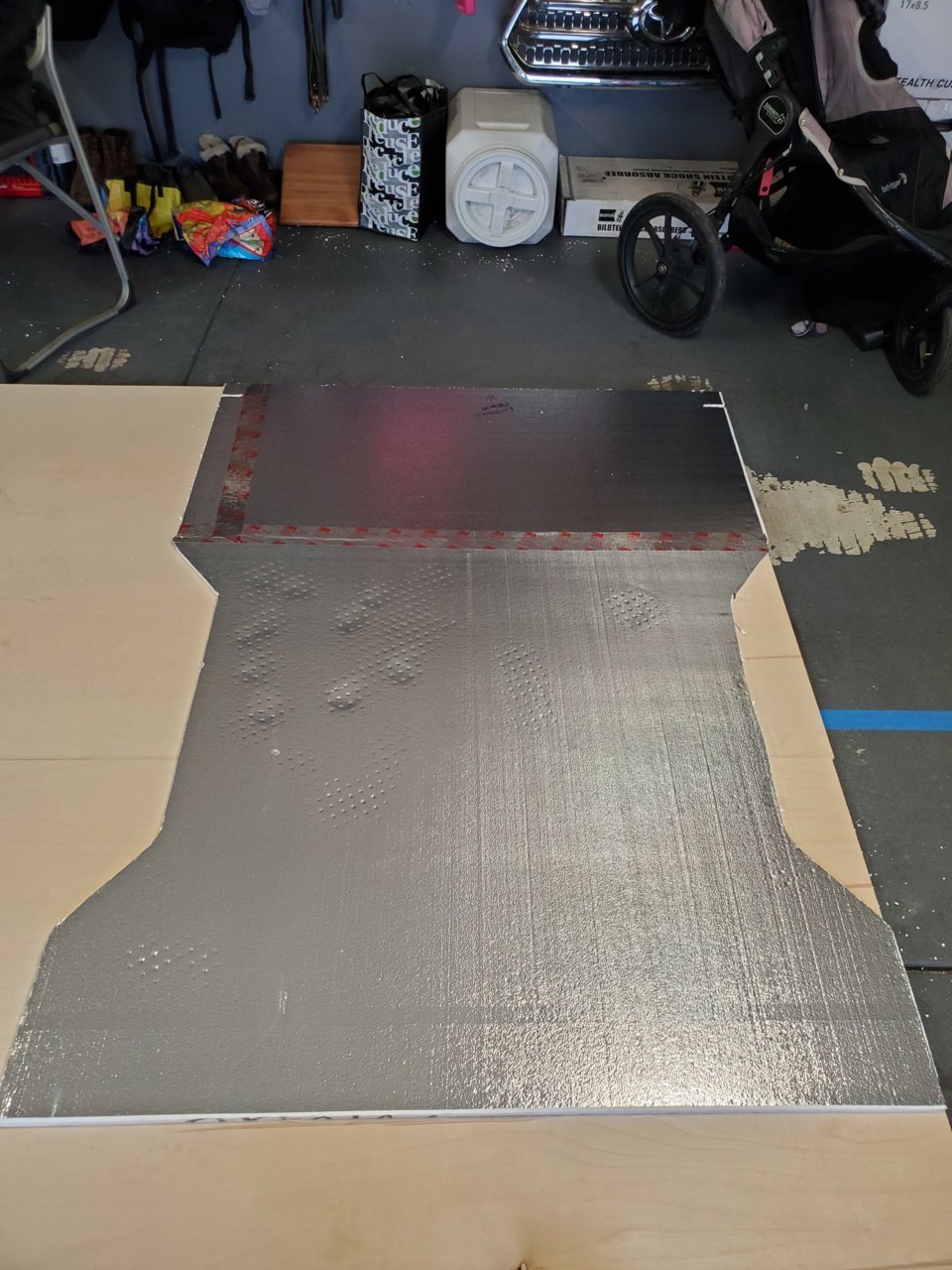

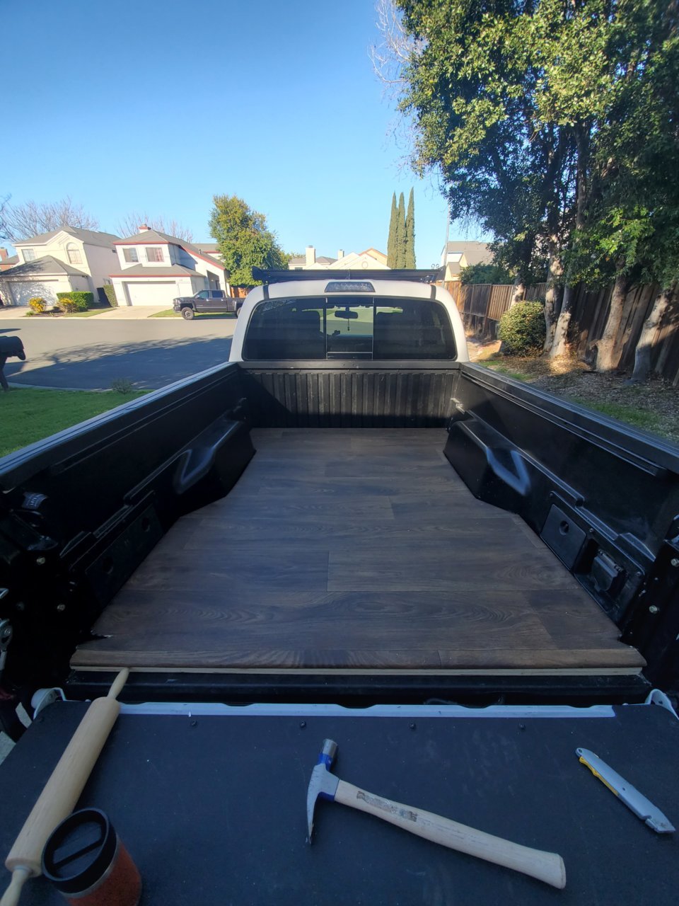

    20210223_152433.jpg 20210216_172026.jpg Base plate and bed sealing done! Really hoping that this inspires the wedge camper gods to speed up my camper due date.
    Half inch poly-insulation with half inch Baltic birch on top with sheet vinyl flooring on top. Bolstered the tailgate edge with wood instead of the insulation. Figured it's a high wear area. Going to add one of those metal stair edge protectors to the entrance at some point.
    I was nervous about the half inch plywood not feeling solid. But it feels good and saves weight!

    Solid idea with the plywood only in the back where most of the use is. I called around and one specialty lumber yard finally found a piece of 3/4” birch that would work as a single piece in a long bed but it was spendy!
    Do you have plans for any sorts of cabinets or fridge tie downs in the back? That is my major concern with not having a solid baseplate in the back. I have plans for a battery/electrical locker as well as fridge tie downs. Not sure about cabinets elsewhere so the partial baseplate may work!
