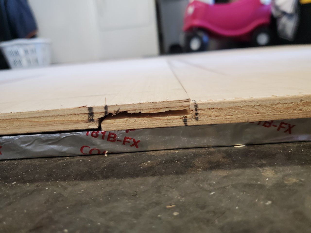

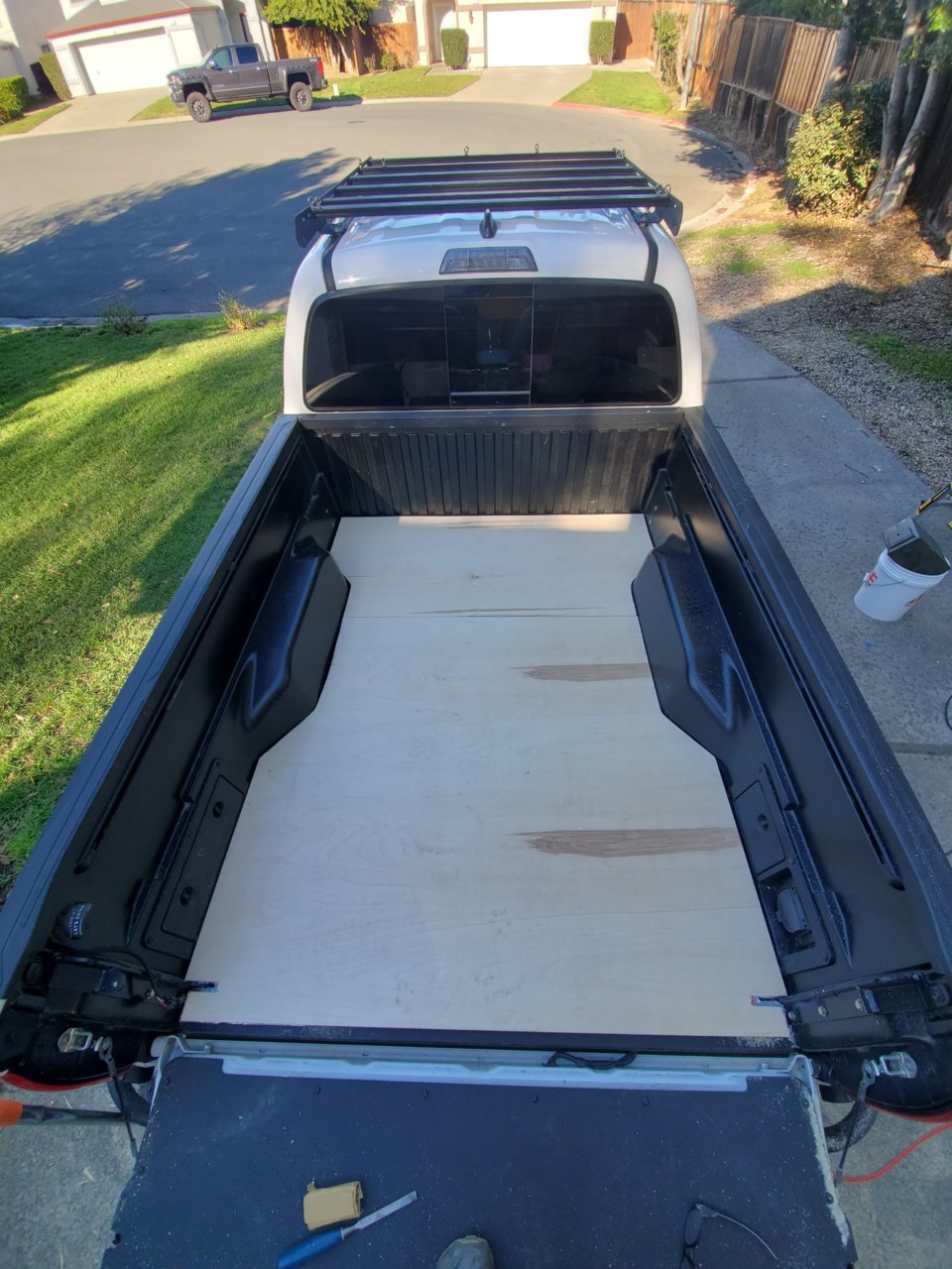

    I used two sheets and half laped them a few inches and secured them with wood glue. This was significantly cheaper than a single sheet big enough to fit. This is obviously not as strong as a full sheet of 3/4 inch but I'm trying to balance strength to weight.20210222_145421.jpg 20210222_150544.jpg
    I do plan on building out cabinets but want to wait till I have the drifter so I can fit it to those demensions too.

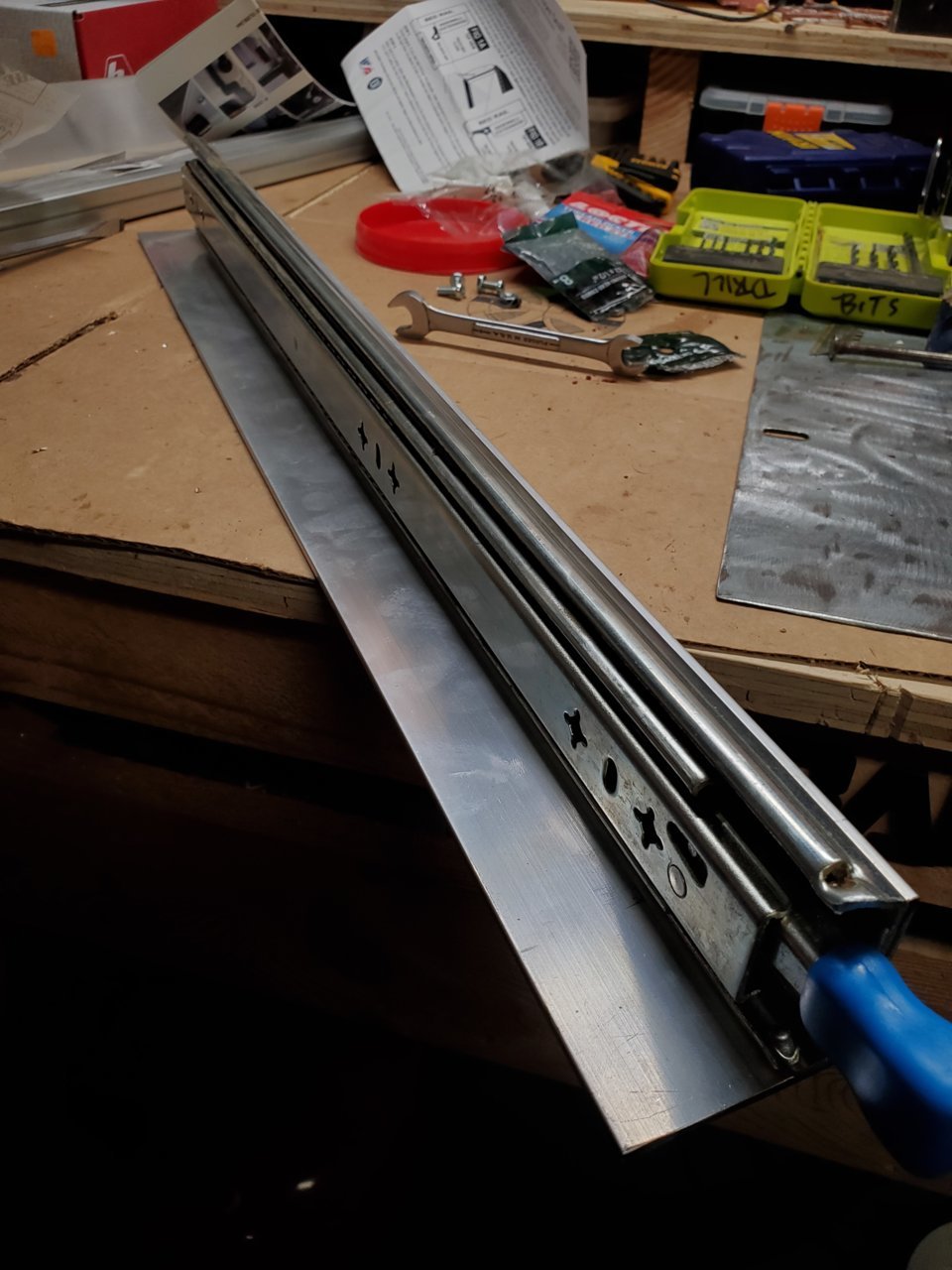

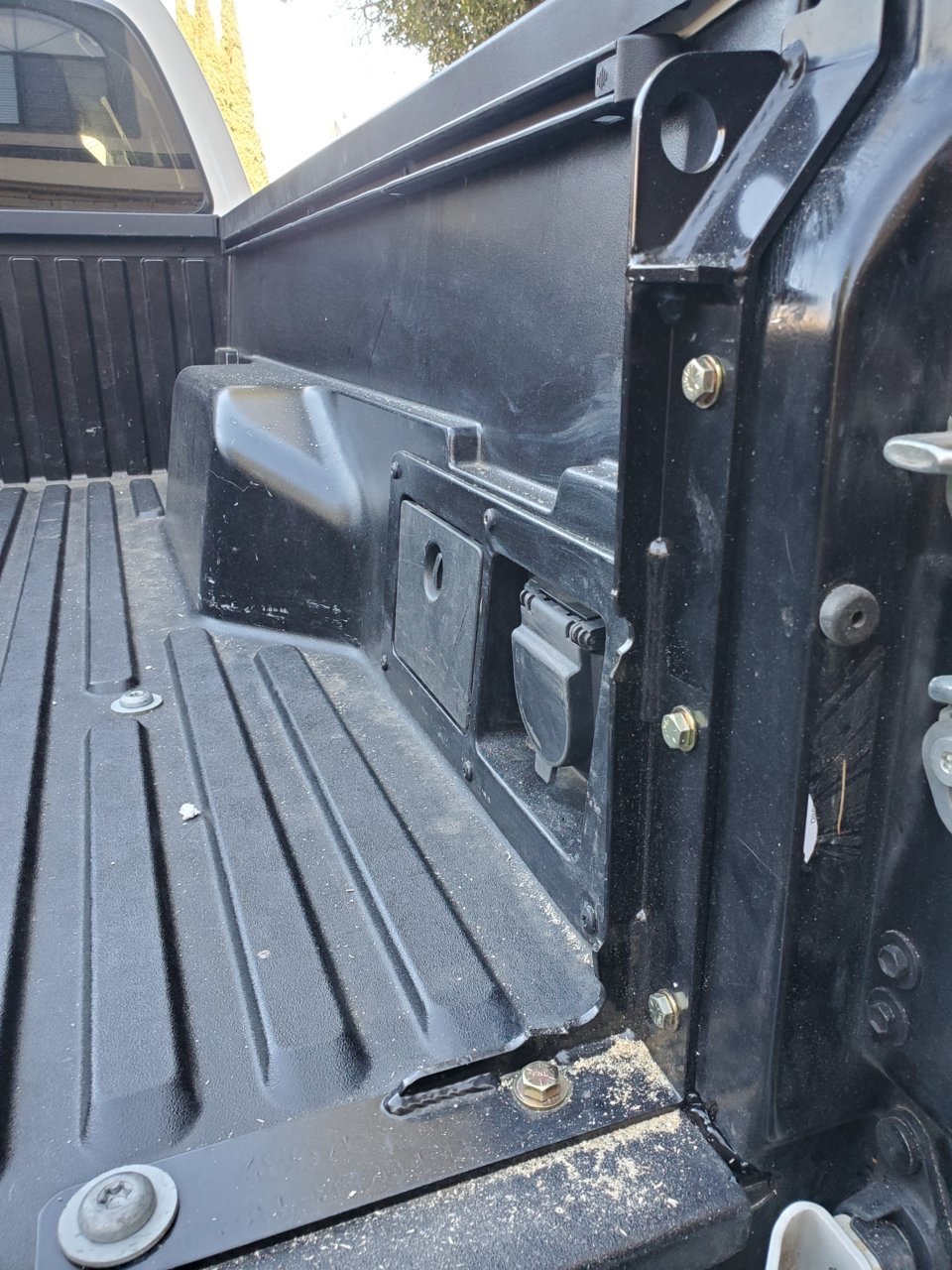

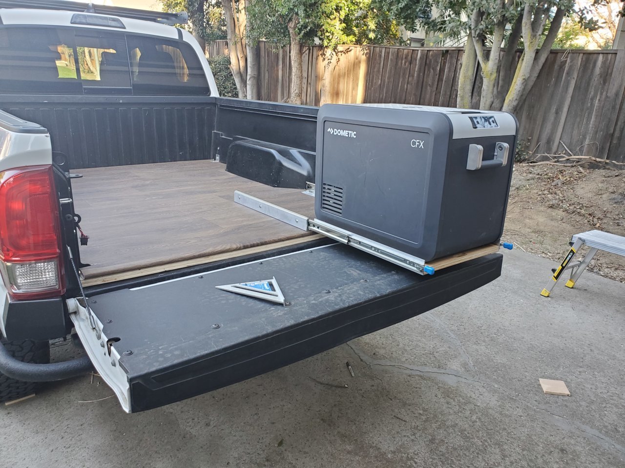

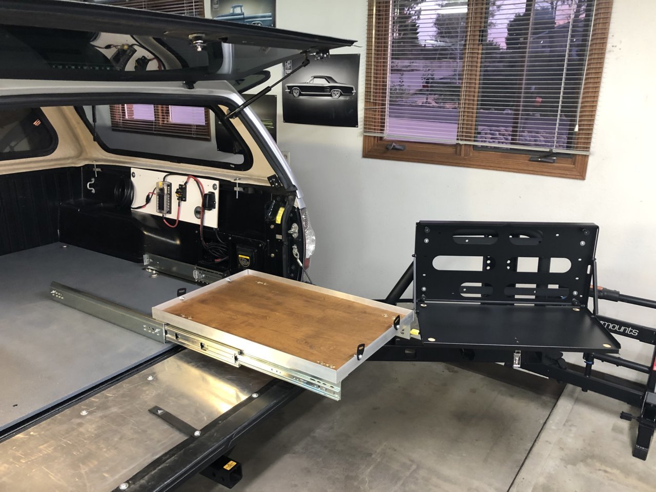

    Finished the DIY fridge slide. Aluminum angle, 500# locking drawer slides, and plywood. I cut the bedstiffiners a little to buy myself an extra inch. I went with the CFX45 to ensure it would fit behind the wheel well. All this to maximize floor space and my dumb ass cuts the fridge platform an inch too wide and loose it all. Someday I'll fix it.

    What is the best way to secure a slider to the baseplate? Surely not just wood screws, right?

    T-Nuts are your friend. Insert from the bottom through a drilled hole in the baseplate, and then you have solid metal threads to bolt anything to.

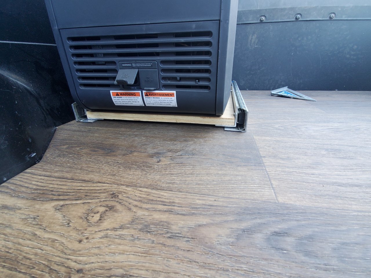

    Mine cost me about $300 to build, but I went a little crazier b/c my fridge was pretty big & I tend to overbuild things as well, like using the fancy mounting brackets for the slides instead of angle. Partly b/c I was lazy on that front.
    To secure the slides/brackets to the base plate I marked & drilled holes for 1/4-20 Tee-Nuts so I could bolt it down. Worked quite well. It's all in my build thread if you are curious.

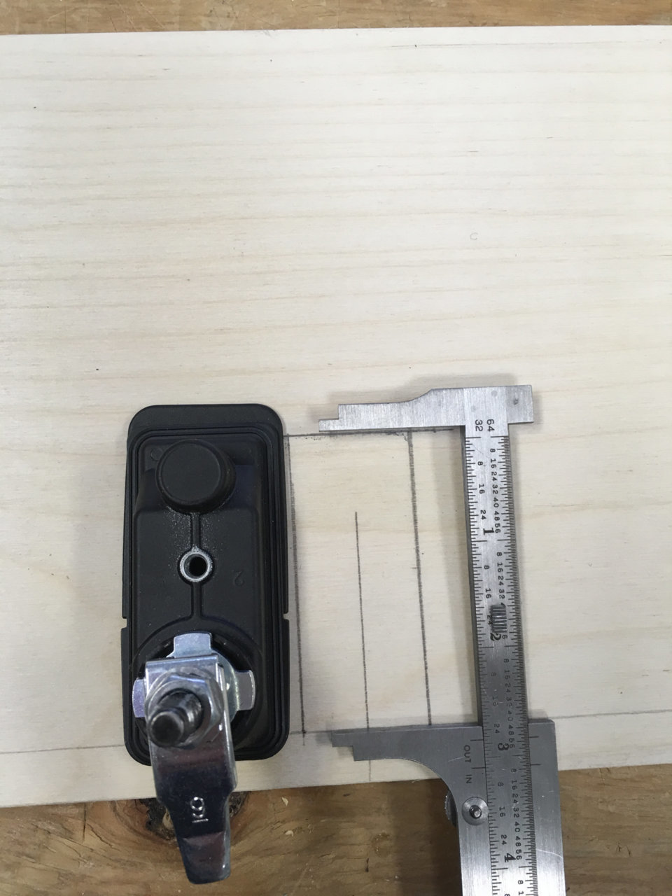

    I used SouthCo. Not much less then GooseGear. They work great, I have locking on the top and non locking on the front of the base plate. https://southco.com/en_us_int/latch...turn-latches/62-lift-turn-compression-latches

    Exactly my dilemma with stiffeners and fridge size. I got a really good deal on a CFX55IM but its massive(main issue is width). Doesn't fit in my wheel well at all so I have to adjust my plan a little. In order to get up and over my bed stiffeners I think I'm going to build a slide much like yours but maybe try to flip the angled pieces to add some height, or just have the sliders themselves mounted on some sort of feet.

    Fridge slide was about $140 not including screws and wood which I had in the garage.
    https://www.amazon.com/dp/B07HQMXZH...abc_0NT7J9YWVMTC93MFN415?_encoding=UTF8&psc=1
    https://www.homedepot.com/p/Everbilt-2-in-x-96-in-Aluminum-Angle-with-1-8-in-Thick-802637/204325579
    Right now I have it screwed to the plate with just wood screws, 4 each side. The other mentioned options are probably stronger.
    Edit: looks like I miss spoke on the weight rating on the slides. They are 210#

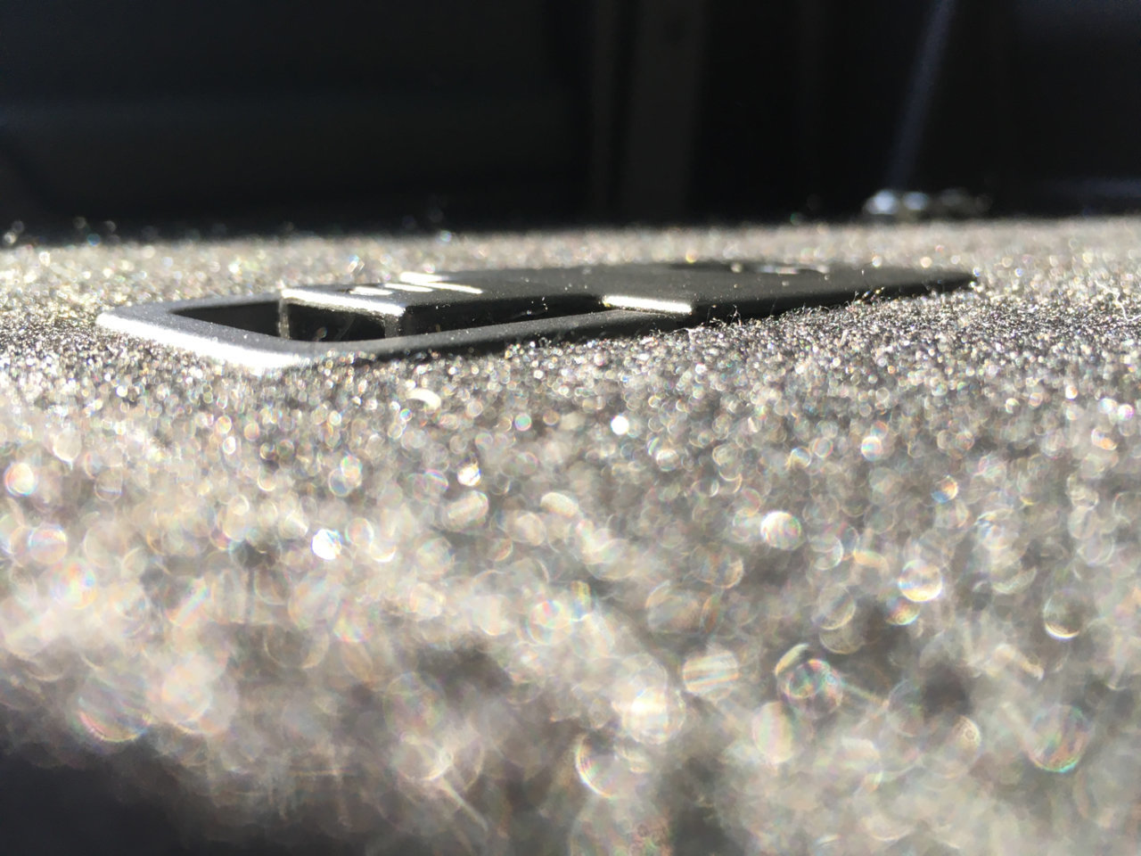

    What’s this under the bed platform, condensation?
