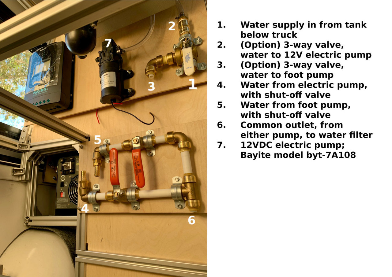

    Update to the galley cabinet: I started working on the plumbing and got the Renogy solar controller mounted in there. I mounted a 13 gallon water tank under the truck. I piped the supply up through the bed of the truck and into the galley. I decided I wanted the option to use a 12VDC water pump, or a foot pump. That way if the battery runs down or I need quiet, or I just want to conserve the water, I can use the foot pump.
    The pic below explains how I set up the water flow.

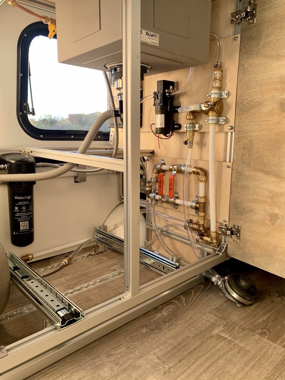

    With all the tubes hooked up; water filter seen on the left; foot pump on the floor. There is a (detached) copper tube with valve in the upper right which gets fastened to the framing, and has a quick-disconnect for aux. propane hook up.

    Earlier in this thread, I posted some pics of the multi-function platform piece that resides in between the bench cabinets. It normally is part of the platform deck, but converts to a table or a prep-counter using the adjustable Lagun mount. Well, now it serves a 4th purpose; as a shower platform. It's not totally finished yet, but I tested it out today and it works as intended.
    In the pic below, you'll see a pair of 250 lb. full extension slides that come out from the base of the galley. These will get fitted with a faceplate that has a flip-down hinged brace that will solidly support the outboard edge of the platform. You can see the flexible drain hose that also comes out from the base of the cabinet.
    The platform sits on top of the sliders.
    Then the pack-able shower basin comes out. It's a PVC pet pool for small animals. It comes with a drain on the side, but it's too high and in the wrong spot. So, I added a new drain in the bottom corner using a PVC bulkhead fitting. To that, I added a 90-degree elbow with a cam-lock male fitting.
    The basin fits perfectly between the galley cabinet and bench cabinet. The cam lock connector hooks the hose right up, easily done from inside the camper with the tailgate and rear hatch closed up.
    I blocked off the drain outlet below the truck and tested it with a bit of head pressure in the drain and no leaks. With the outlet open, it flows nice.
    Here you can see the drain, which has a line coming from the sink as well. It terminates under the truck through a bulkhead fitting.

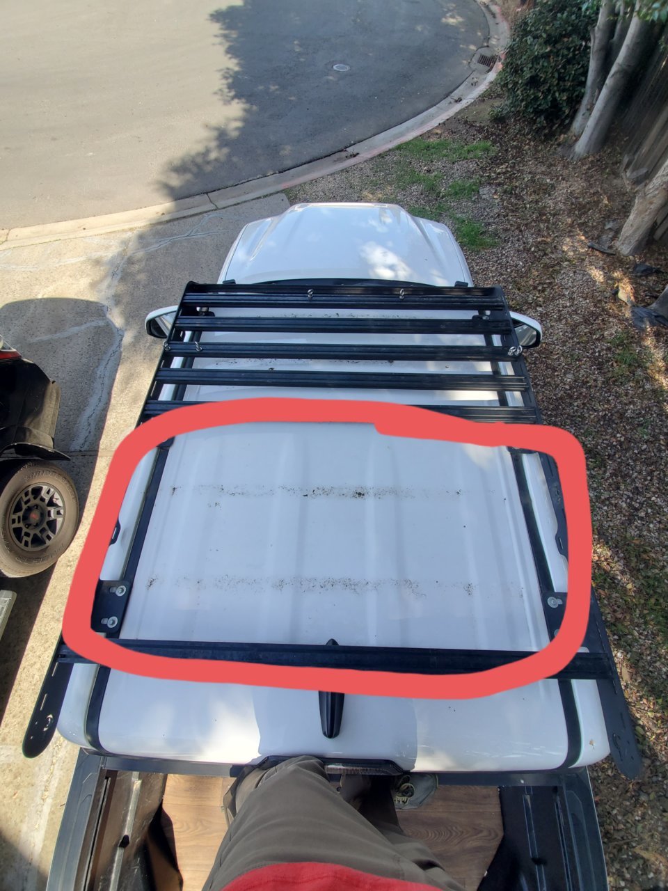

    Moved all the cross bars on my Prinsu rack forward. Figured they would be useless under the drifter overhang. I have been trying to think of something to fit in the now large vacancy. Anyone have any ideas?
    Obviously accessibility is going to be a major restriction.

    139
    2013 Tacoma
    Smittybilt 4x2 Defender cargo basket?

    Might be a good spot for foldable table or chairs depending on the envelope you have with the Drifter in place. Just a thought.

    Sorry, I meant this area. It will be under the drifter so getting to the space will be pretty limited. I thought maybe a tray that recovery straps could be snaked in and out onto.

    I don’t know dude. All the 3rd gens I’ve seen with a full prinsu it’s pretty snug. Don’t feel like chopping? And then you’ll have room for a table. I’m sure if you spoke to Phil he’d install one of those front runner table mounts. I’ve never looked how much they are though so...

    Check out some of FrontRunners stuff. They have some things that are meant to fit in a sliding tray. It may give you some ideas of a DIY.
