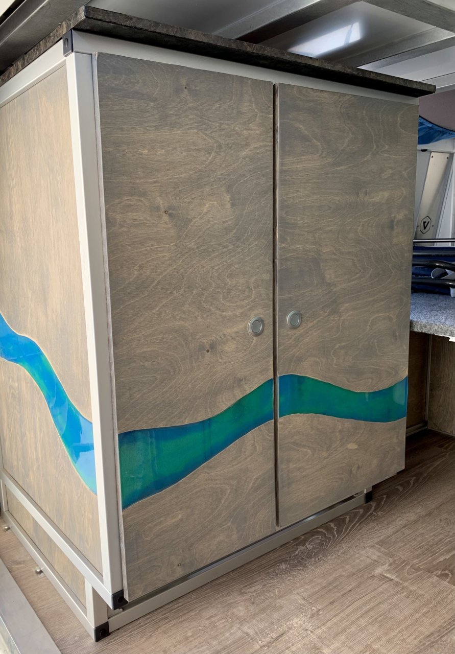

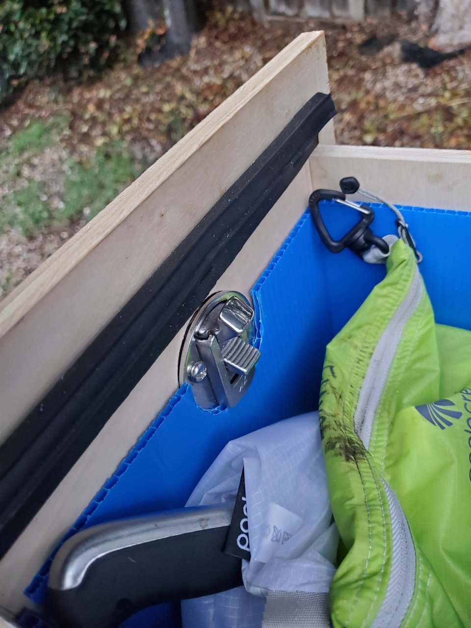

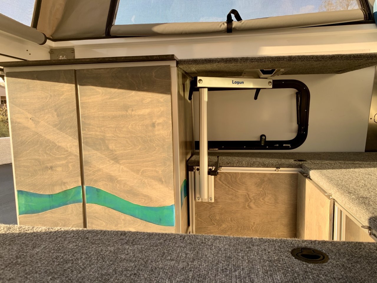

    So, I decided to just go ahead and install some flush cabinet latches. I wanted something that wasn't too imposing, would be flush when closed, and would match the aluminum finish of the cabinet frame. After a lot of looking and reading customer reviews, the best thing I could come up with was the Southco "Point Push to Close" latch with a satin finish. They are spendy at $50 for a pair shipped, and they are still plastic made in China. I'm hoping they'll hold up. Once installed, they satisfy the look I was going for, but the operation isn't as elegant as I'd hoped. They are noisy. But they work.
    Unintended consequence: My cabinet face with the epoxy design now sort of looks like a face. LOL.
    With knob out:

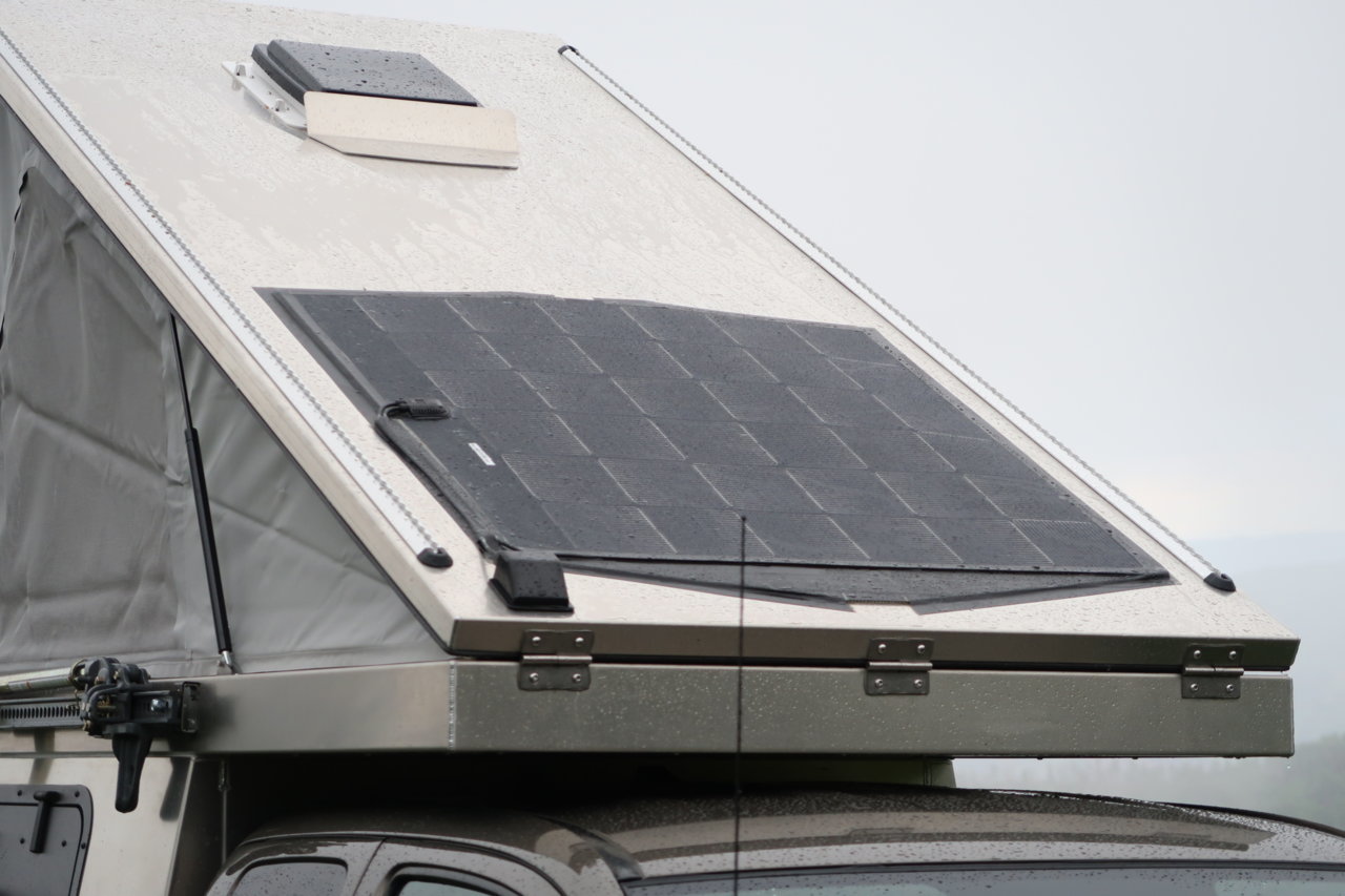

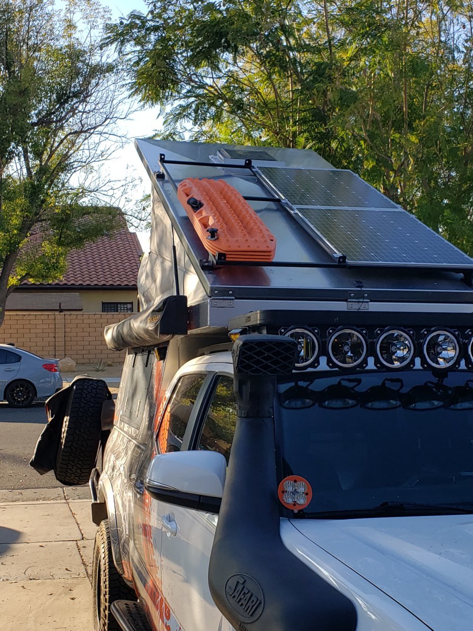

    Here's the roof on mine, I made a tube steel brush guard that the solar panels set into. Hopefully this will protect the edges of the panels from tree branches. The steel feet on the rack have rubber isolators between the feet and camper to eliminate vibration.
    d.shaw and Twizted[QUOTED] like this.

    Do you think the roof rack will reduce the output of the solar panels too much? Most solar panel output drops 50% if even 1 leaf shades the surface.

    One leaf? Whoa! I put mine under a Yakima wide bar thinking it would only degrade the ability to charge by the percentage covered. Here in midwest I need as much solar availability as I can get. That is the first I have heard of this. Seems I will have to reinstall it back on top. Thanks.

    It depends on what time of year you camp. In S Utah, tilting in the summer give you only 10% extra juice. However, tilting in the winter will give you 75% more power. I am finding in WA, solar in the winter doesn’t give you any power, no matter the tilt. Too cloudy. Even in Eastern WA.

    Panels only work if the juice is able to flow uninteruppted through the entire circuit. Most modern panels have at least one bypass diode - essentially two circuits in one panel - but if something is hard-shading even a small part of one circuit, that circuit won't be live. Hence, a leaf cutting the panel's output by 50%.
    Some nicer panels have multiple bypass diodes. Some cheaper ones have none. No shade is the best way to go regardless...

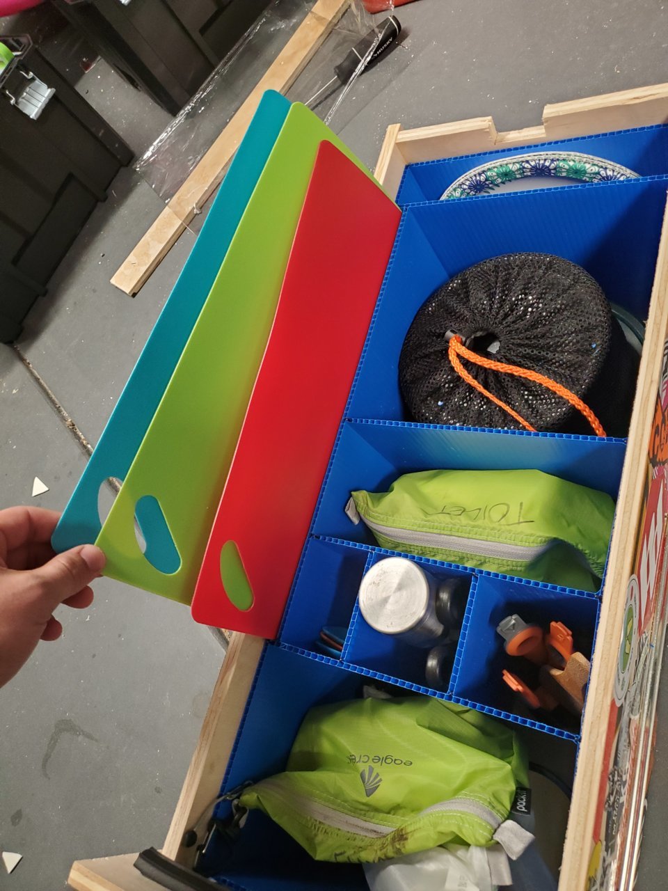

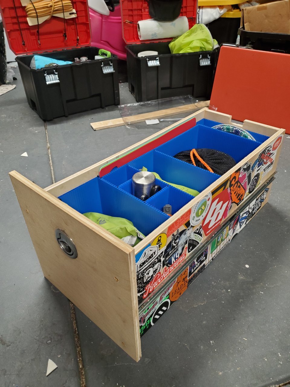

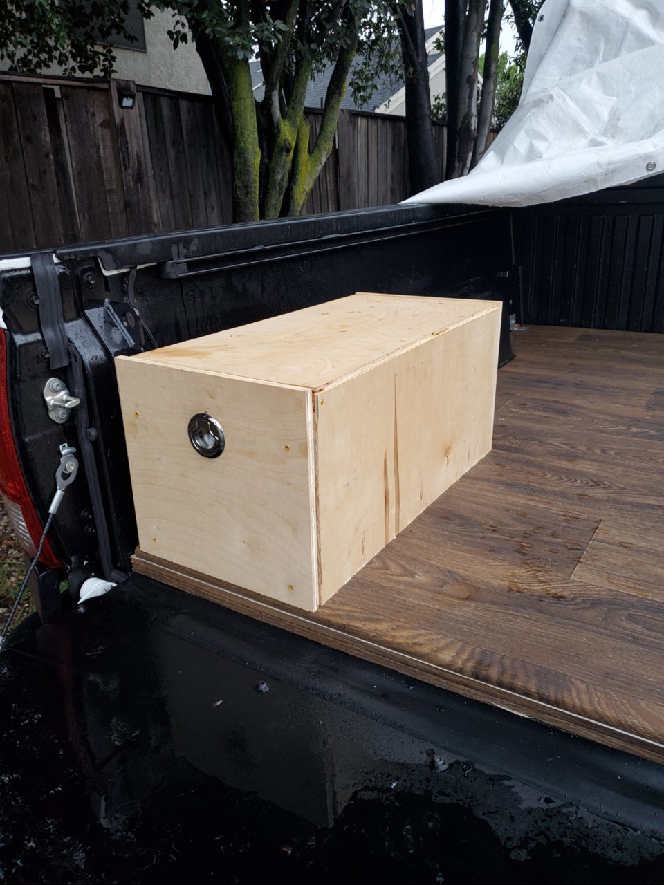

    Kitchen drawer project.
    I think this is the last thing I can build before actually getting the drifter installed. At least it's the only project that I didn't need drifter demensions for.
    I used 1/2 plywood to build the box; using the baseplate as the bottom side. I used a pocket hole jig on alternating sides to mount it to the baseplate. 1/2 plywood for the drawer itself. All with wood glue, Brad nails, and some screws to hold the thing together.
    I originally tried a plastic slam latch first but it broke the first time I closed it. The metal one is far stronger. The strip of tailgate seal keeps the whole thing tight and rattle free.
    The internal organization was home made copying TrekPack. I used corrugated plastic and Bobbypins. It was super easy and I highly recommend it. 20210318_185651.jpg 20210318_185658.jpg 20210318_185246.jpg 20210318_185302.jpg 20210318_185704.jpg

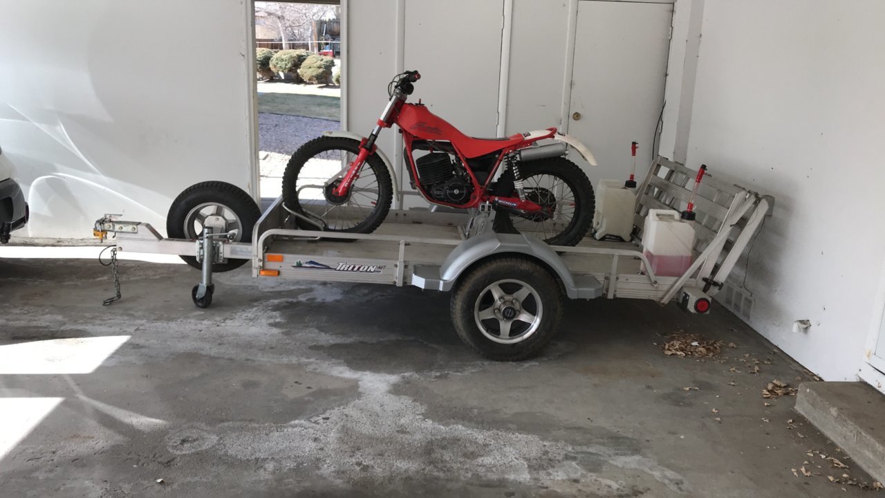

    ordered my drifter this morning :) Can't wait to out fit for weekends towing my Fantic to AHRMA Trials events around the country ! Time to warm up my drafting table and design my interior .BOBS1600.jpg

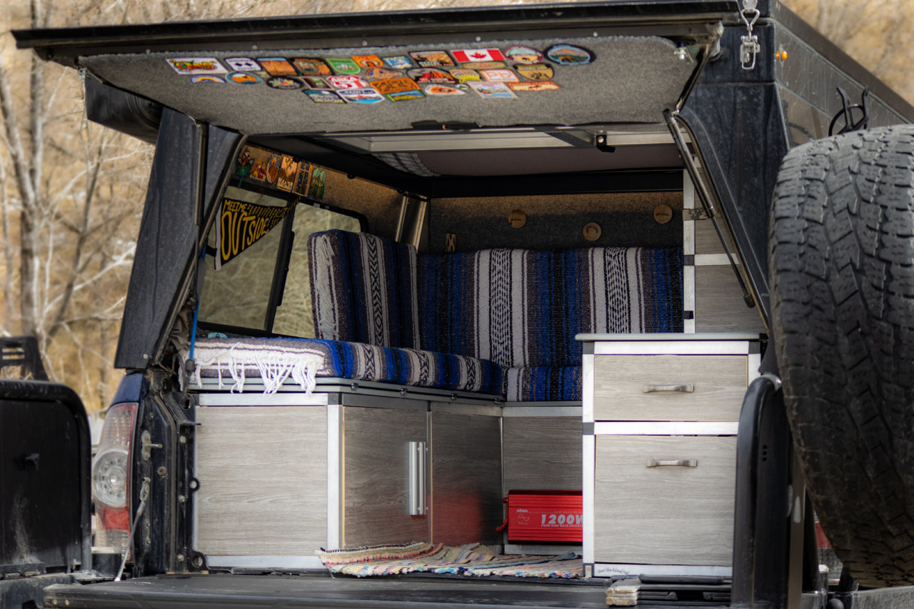

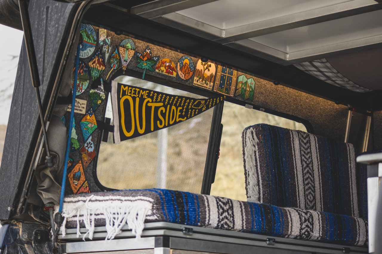

    Here are some recent photos of my homemade buildout.
