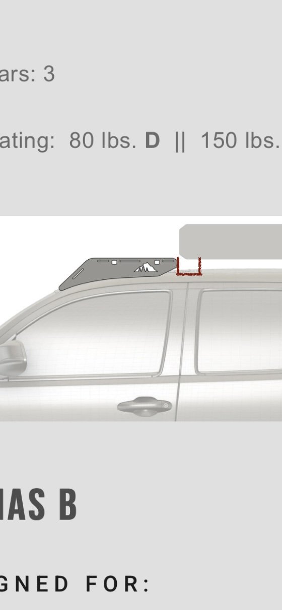

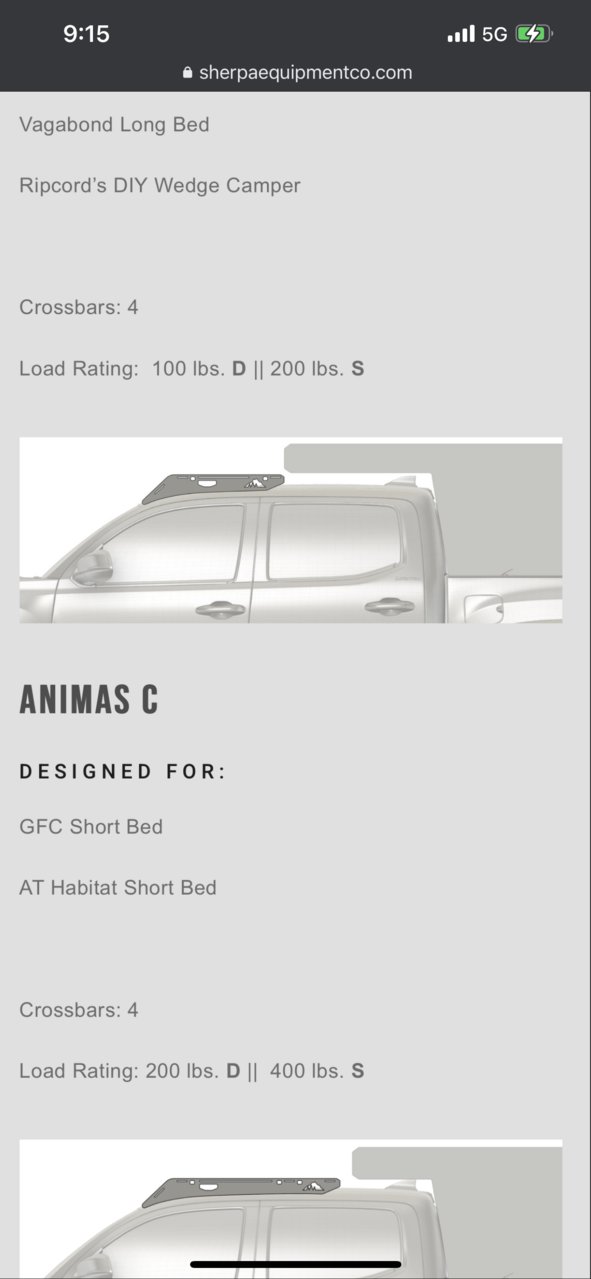

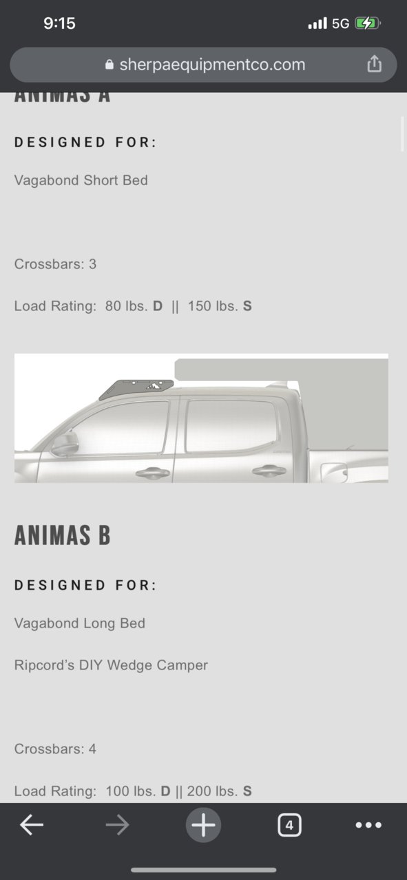

    Yea, but not a drifter from what my eyes tell me, Especially if a long bed has aftermarket bed rails.
    I mean I don’t have a drifter and won’t for who knows how long, but I did reach out to Sherpa, I like their mounting and design model the best. The Animas model is make for wedges but...
    Option B comes up short and leaves open space
    and option C is too long
    from what I can tell with long beds the wedge reaches to just where the front of passenger window is on the pillar for a drifter LB
    I reached out to Sherpa and asked if I could get option C bare and then cut it down myself. They said no problem, just send them an email with a request and then I would ask for the mounting hardware for option B
    again I don’t own a drifter yet, but seems like a good workaround, as they didn’t want to adjust the model B to make up for that extra space not covered, which I get.

    Here ya go...
    kbYW11R_R7GF-BeI8tM1eJZT2FC-WsATHIbNC-UW_4bf626b0b93b13977af13db8dc6eea782657b99a.jpg
    The angle is a bit off but it reaches to just behind the front doors. I think option B would fit.
    I've measured this out as well. It's 30" from the top of the windshield to the front of the drifter and it's 2" from roofline to the bottom of the drifter (that's with stock bed rails).

    Oh yea B will for sure work, just depends on if you care about losing this much space/leaving an aesthetic gap between your rack and wedge
    pretty much making it look like this

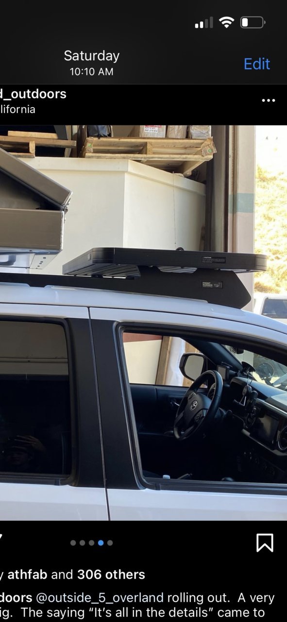

    Just a heads up for folks talking about roof racks with the Drifter. I recently installed my Sherpa rack on my DCSB. See pic below but I will be cutting off the back edge of the rack where I put the arrow. During flex, the rack contacted my camper and I'm pushed all the way forward.
