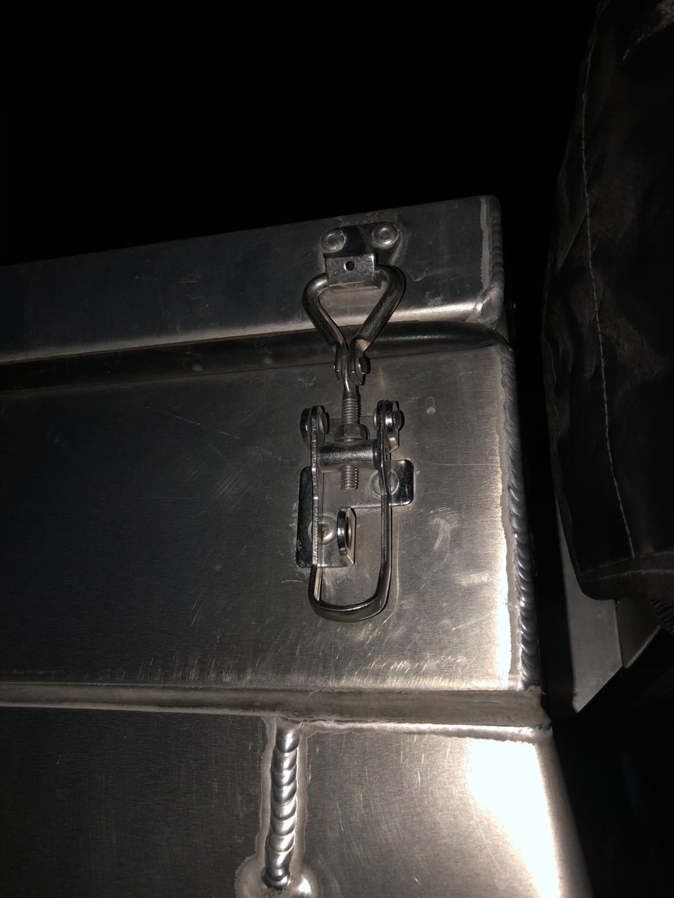

    I've seen some people relocate one or both of their latches on their Drifters. I am thinking of getting an Overland Vehicle Systems Awning. I will need to move one of the latches to the rear.
    These are riveted, what rivet tool or tools are needed to accomplish this. Any write up out there?

    Drill out old rivets. Remove latch handle and clasp.
    Place on rear, mark, measure twice, drill holes to match the rivet size.
    Install rivets. Peace of mind if you put a dab of silicone on there as well or some other type of sealant.
    You just want some blind, closed-end pop-rivets.

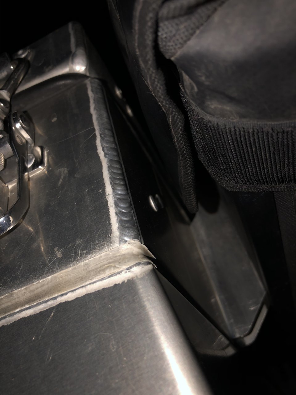

    @JasonLee covered it for you. Here are some crappy pictures of my camper, not sure if it’ll help you. Rivets to fill the holes.

    Issue is I dont have a rivet tool. Maybe I can borrow one from a friend.
    What size rivets do I need, or VB uses for their Drifter?

    Harbor Freight to the rescue.

    I got a rivet tool from Ace for $13 when I was moving my latches to mount the awning.

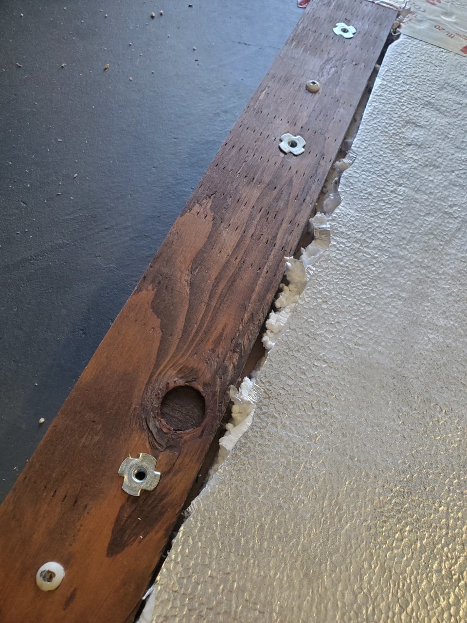

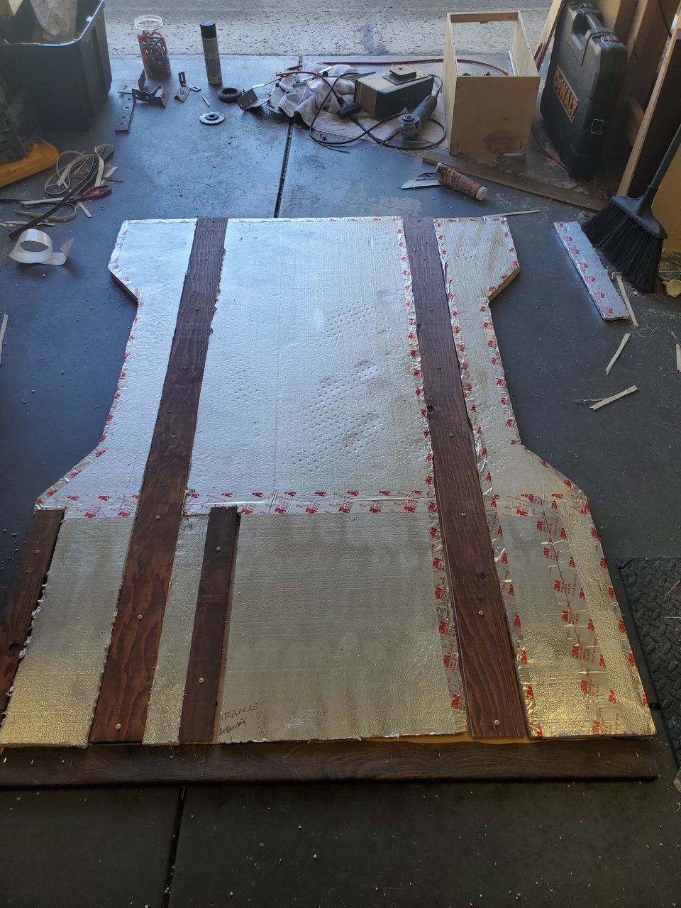

    20210427_145102.jpg 20210427_132227.jpg 20210428_130115.jpgWell, after my first base has been sitting out in the weather since February, I decided to tear it out and take some of your guys advice. T-Nuts and extra bracing for all the structural aspects. Peeled up the floor and re-adhered it with stronger construction adhesive.
    If anyone is using sheet vinyl for floor, steer clear of spray glues, mine wrinkled far too easily when I pulled a cooler across it.
