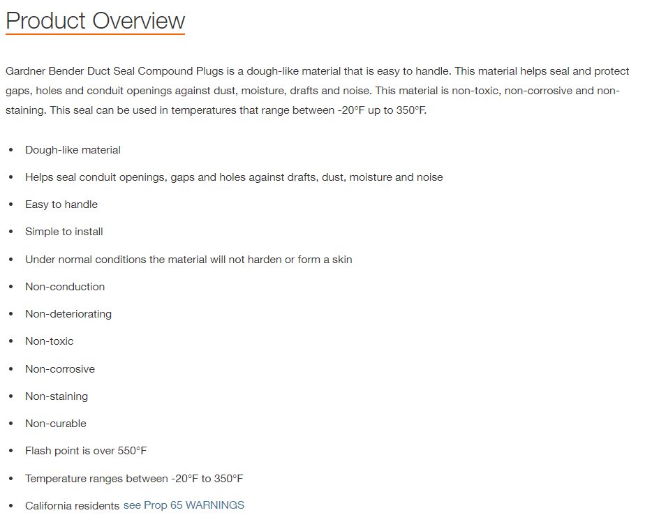

    I swear by this stuff. Just mold small amounts into gaps. Find a dark spot and a bright light or someone inside the Drifter with a flashlight to find the leaks. This has a consistency kind of like chewing gum. Home Depot carries it.
