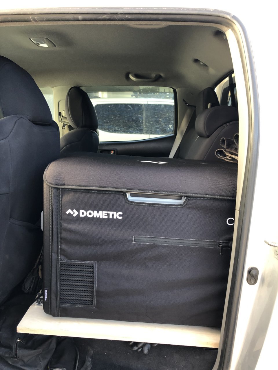

    i have the cfx3 55IM mounted in my back seat, the way its mounted i really can't easily see the control panel etc, and would rather have access to the power cords up front, as well as the compressor / venting - so for me the bluetooth is great. i also only run a single optima bluetop D31M battery so - as much as i have some 'fail safes' - i can monitor the battery off it to. works for me anyway

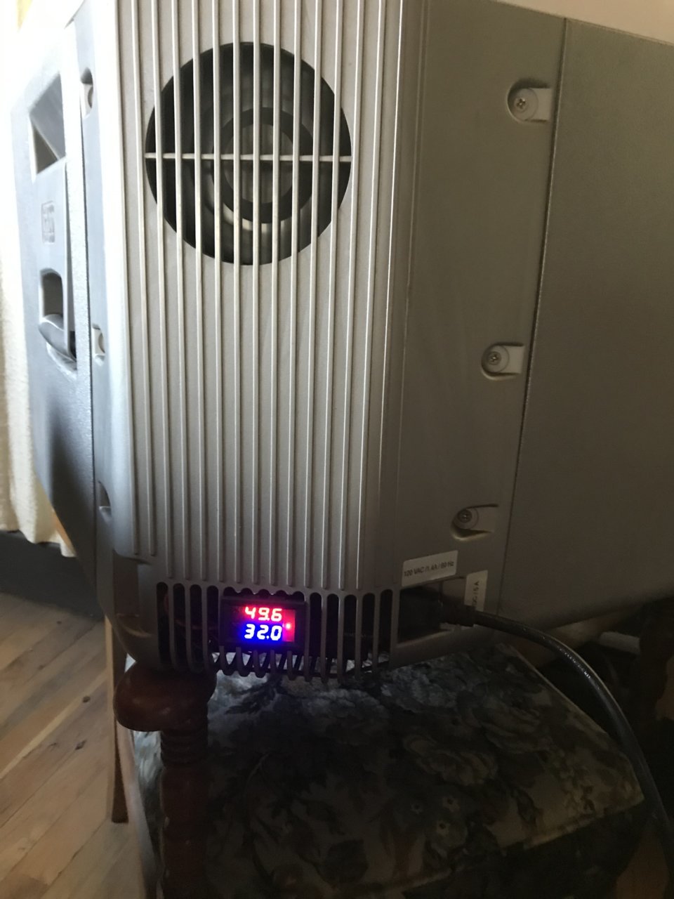

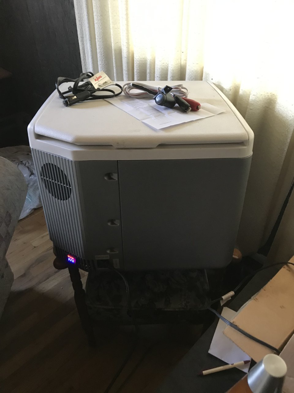

    IMG_1281.jpg IMG_1280.jpg as to the Fridge Debate ,I kinda lucked out ... Found this old Igloo iceless cooler out on the spring house , plugged it in and it works fine shows little to no use . but it never shuts off ! aka constant power drain ! So I did a little research & spent $11.00 on Amazon for a adjustable 12v thermastat ... figured out how to wire it in and it cycles and will freeze if needed :) ! So it'll be fine for awhile .
