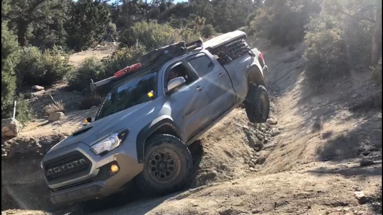

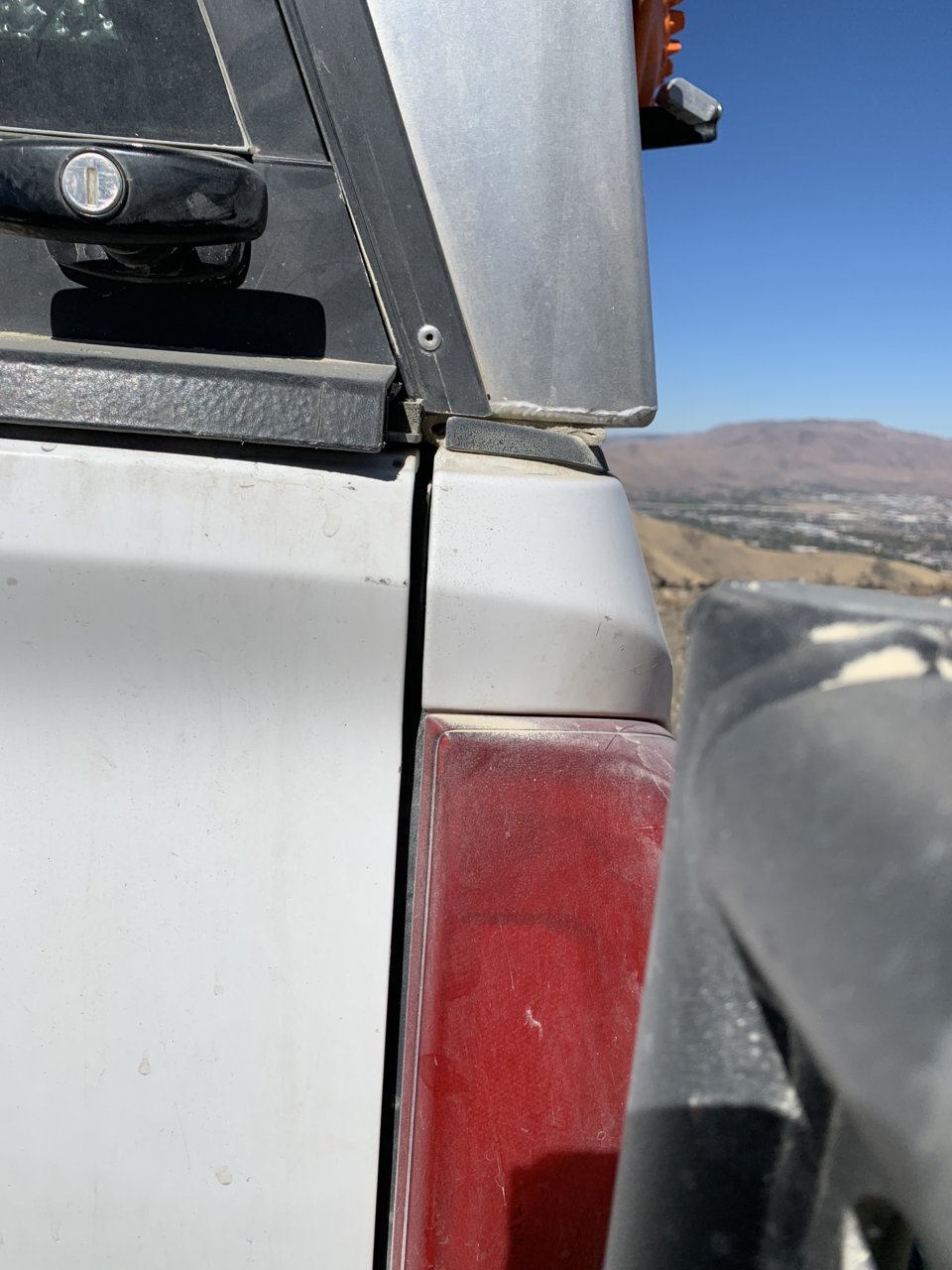

  13. Oct 12, 2018 at 2:17 PM
    #553
    danneskjold
    danneskjold Well-Known Member
    Aug 20, 2017
    #227402
    1,285
    Brian
    Shoreline, WA
    2018 F150
    Pictoral guide. First image is probably "normal" but my left side is starting to drift.
    I don't think it's a Drifter problem per session, I've been running a shell and RTT of some kind since I bought it and the Drifter probably represents, if anything, weight savings. But it's still an issue.
    I need to buy some stiffeners.

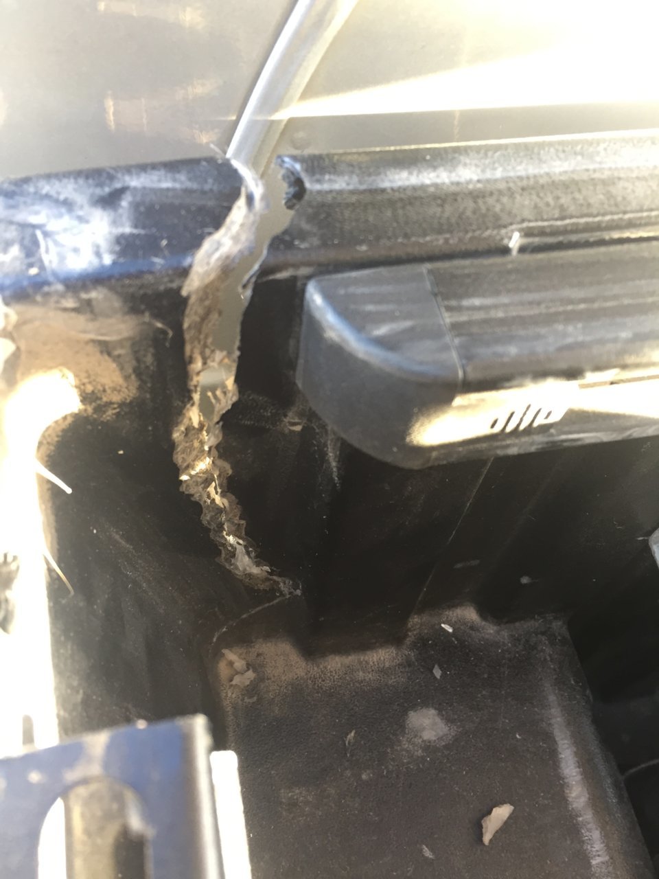

  14. Oct 12, 2018 at 2:22 PM
    #554
    tdubd
    tdubd Well-Known Member
    Jul 18, 2009
    #19843
    279
    Todd
    Grand Junction CO
    07 party mobile
    ready for adventure
    Depends on how much wheeling you do with your truck too. I wheeled with my RTT for years with stiffeners just to have the cab side of my composite bed rip! With stiffeners on the tailgate side and my own creation on the cab side, my bed isn't moving haha. And if it breaks after this, then I'm going with a whole flatbed buildout!

  15. Oct 12, 2018 at 2:31 PM
    #555
    MTNHABITOVERLAND
    MTNHABITOVERLAND [OP] Well-Known Member
    Feb 4, 2016
    #231542
    1,549
    2016 Tacoma Camper Build Instagram: @mountainhabit
    Vagabond Outdoors Camper
    I would never have done this without stiffeners...:D3B163876-228B-4DCF-94D0-CFAFE88DC585.jpg
