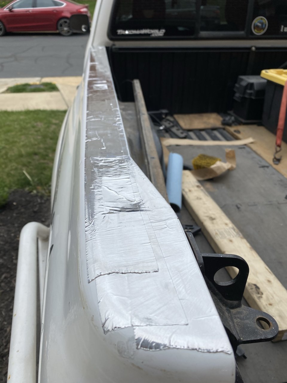

    I only had a little bit of scuffing. Cleaned it up with some light sand paper, touched up with primer then paint, and then put down tape

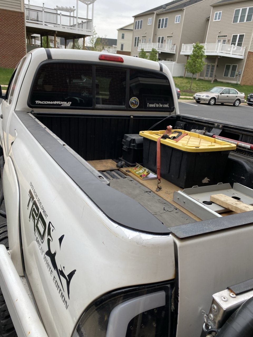

    Mine was pretty bad from the bed rack and RTT prior to Drifter install, but most of it is on there outside edge, which means it's still visible under the KB VooDoo caps. I should have gotten the Relentless ones, but got these used prior to the Drifter...

    I guess its harder to touch up another color besides white. I just used "gloss white" spray paint from HD. But also my attention to detail is low. I think Ive touched up my 040 paint with that same spray paint :anonymous:
    Plus I put the tape over the touch-up.

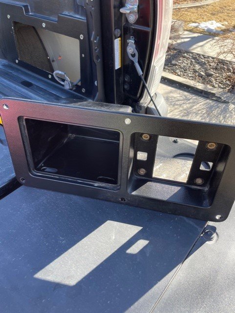

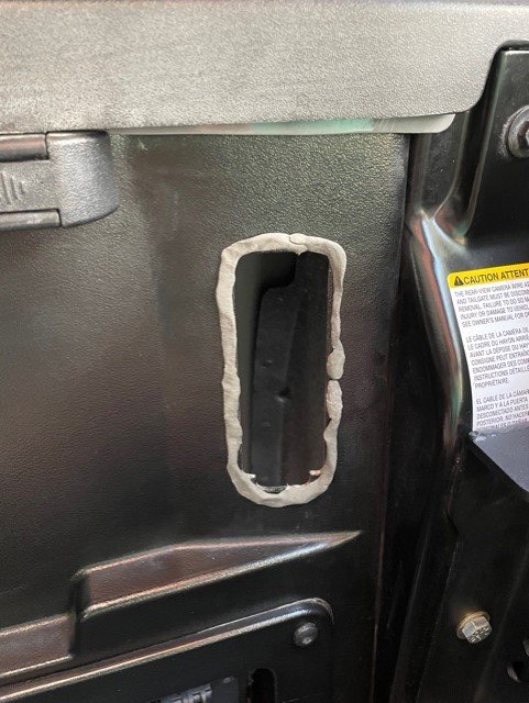

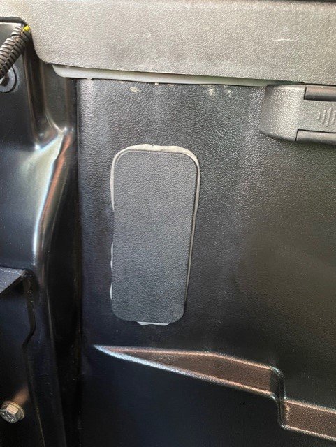

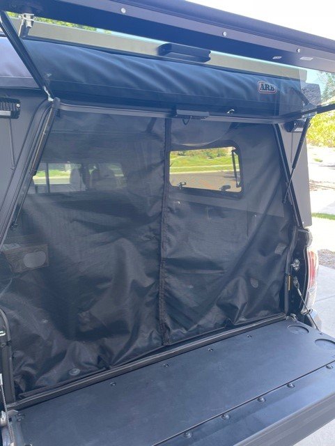

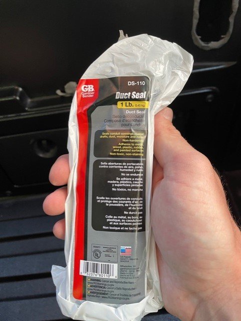

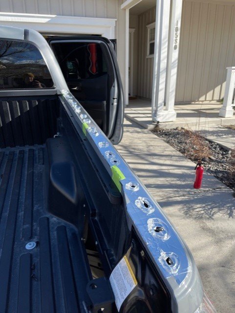

    The projects begin.
    Sealed up the bed rails with tape and silicone before the install.
    While I did that I also tore apart the 120v outlet box and the little storage box. Need to keep working on the cubby box. Hard to get it to totally seal.
    Drifter install last Friday.
    Immediate trip to the mountains. Our luck we usually camp in the desert during the winter so shorts and light sleeping bags were nice.
    First bath
    More sealing of the Drifter from various things.
    Bugs via a Strawfoot screen. Super easy to install and high quality. Very happy with it. Probably going to glue some magnets underneath the bed to hold the bottom in place since I added temporary seal material along the bottom.
    Also took someone’s advice on the forum to use electrician putty for temporary sealing of spots around the bed. Super easy to work with and easy to clean up.

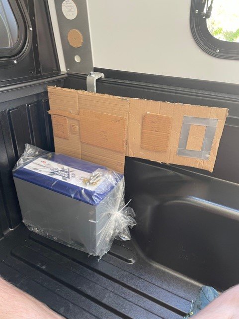

    Started laying out the 12v arrangement with cardboard. Only bought half a sheet of plywood so want to make it right lol
    Battleborn battery that I will build a tiedown baseplate and use the long bed bolt for anchorage, Redarc controller & some other fun stuff that I will use all thread to anchor to t slot nuts slid along the rails. Keep the buildout simple for now while we decide what we want longer term.
    As requested, Vagabond ran all the wires to this corner (with plenty to spare) for the solar as well as light/fan power for the Drifter.

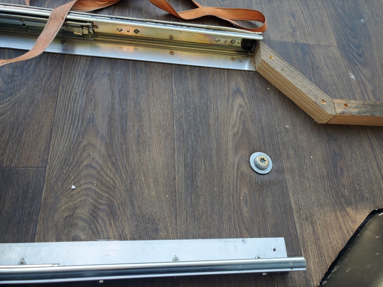

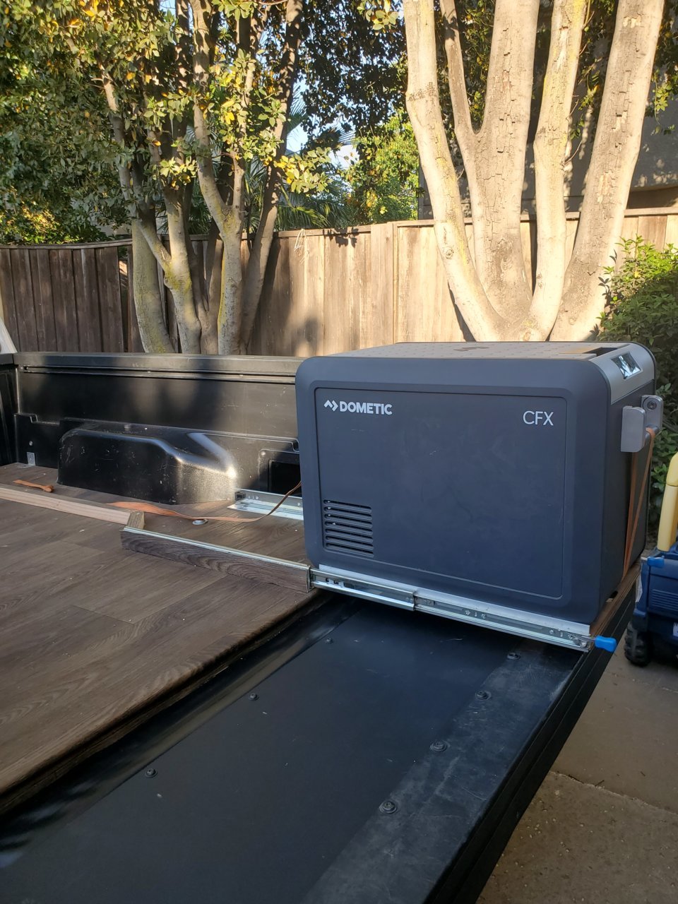

    Lessons learned...... use the bed bolts if you want a fridge slide....... pretty sure I'm the only one who thought I could get away with it. 20210512_182321.jpg 20210512_182334.jpg
