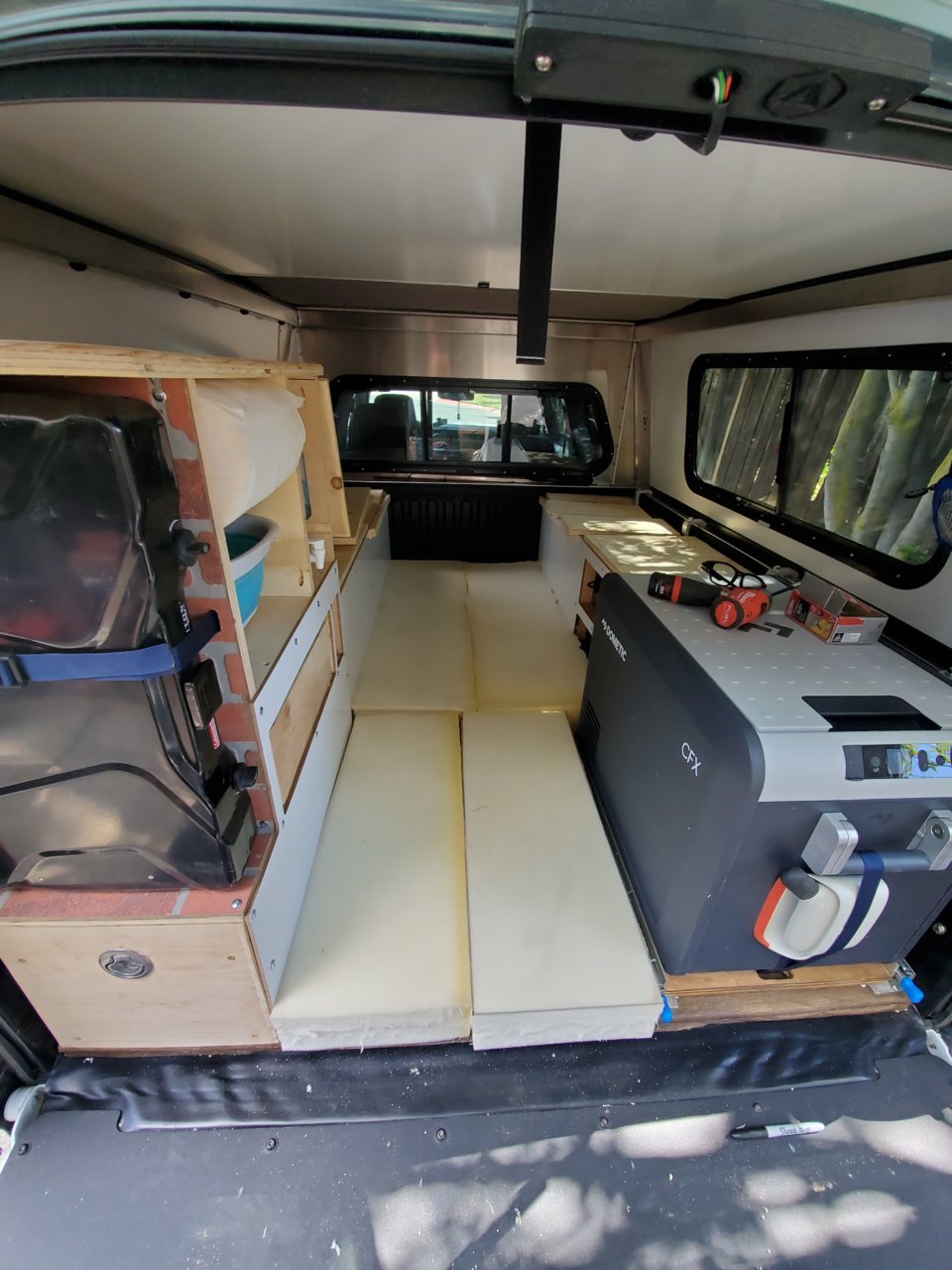

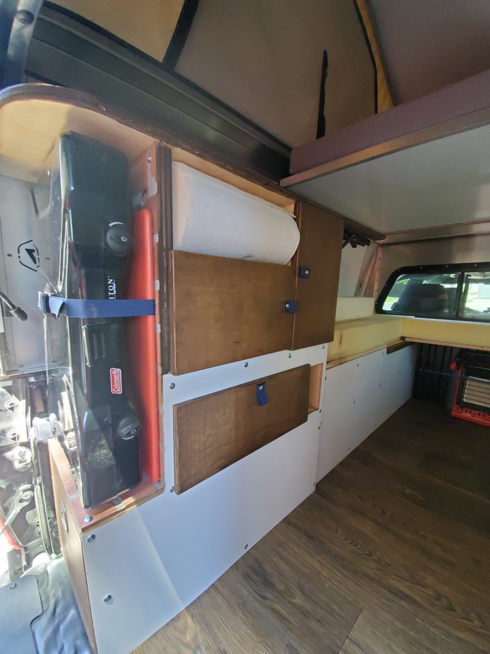

    Let me preface this buildout based on two things:
    1. I want to do a buildout with 80/20, but want to make sure I get the design just right before I invest that much money. This is simply the prototype to try for a while and tweak the design.
    2. I went to buy lumber and found the prices to be unconscionable! So this build was done completely out of scrap wood around my house (I even had to disassemble my corn hole set) and the white board material(which was cheap and super easy to build with).
    The stowaway bed is for my 1 year old daughter. I still need to work up some sort of guard rail to keep her in.20210525_152536.jpg 20210525_152622.jpgThe cushions are cut from the Amazon trifold mattress that I was using under my fiberglass topper before I had the drifter. They need covers, but sowing is not a skill I have attempted yet. 20210525_152639.jpg 20210525_152738.jpg 20210525_152748.jpgThe kitchen is a tower design. The water is 2.5 gallons (small but I don't use much) and pulls out for full ups. The drawer is made to hold everything I need to make coffee in the morning without leaving the rig and not moving the bed platform. The collapsible wash basin just happened to friction fit perfectly there. I will eventually add cabnet doors to cover all the holes. 20210525_152758.jpgThe sink is super simple. Not good for much more than washing hands and face or brushing your teeth. Its a rechargeable faucet designed to go on top of those big office blue jugs. I bought a cheap stainless steel bowl and cut a drain in it. It drains to the outside of the truck. Very simple.20210525_153022.jpg 20210525_153012.jpgThe stove spot was a last minute design change but is easily my favorite part. I was originally saving this spot to hang my daypack but didn't want the stove deep in the rig as I always use it on the tailgate. The fake brick was leftover from a project my wife did years ago bit I think is a nice touch.20210525_153113.jpg 20210525_152843.jpg 20210525_153132.jpgThe kitchen drawer and fridge both slide out. There are some accessorie bags velcroed yo the wall above the fridge to utilize the space. I run the fridge off a goal zero X500 the sits in the cubbies behind the fridge. On the drifters maiden voyage she ran the fridge for 2.5 days with no input ( no solar yet) no problem. The truck inverter plug in the back charges the battery.
    There are lots of things I already want to tweak on the design but for the most part very happy with it overall. Still more work to do....
    Happy Drifting

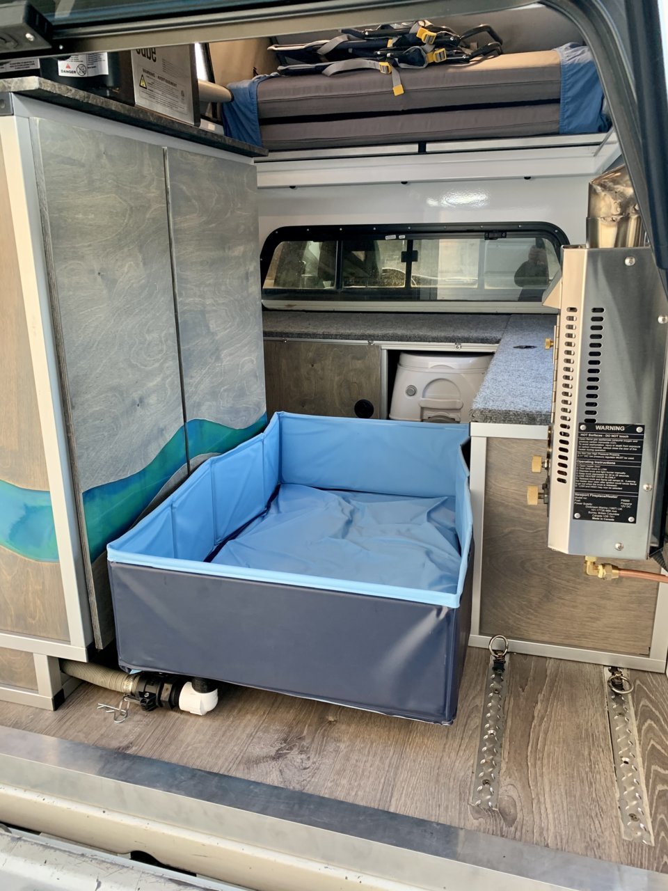

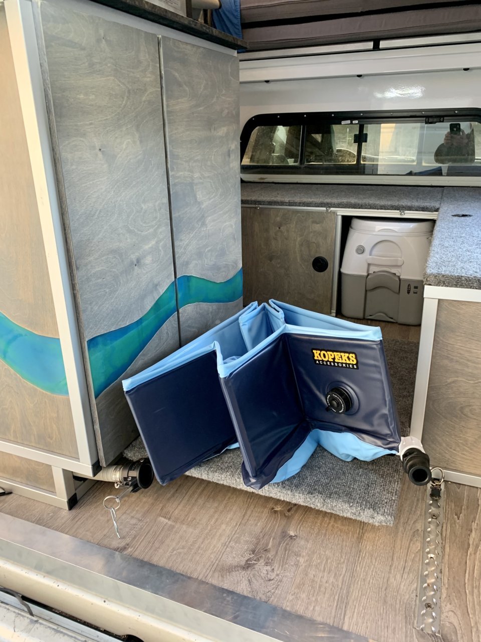

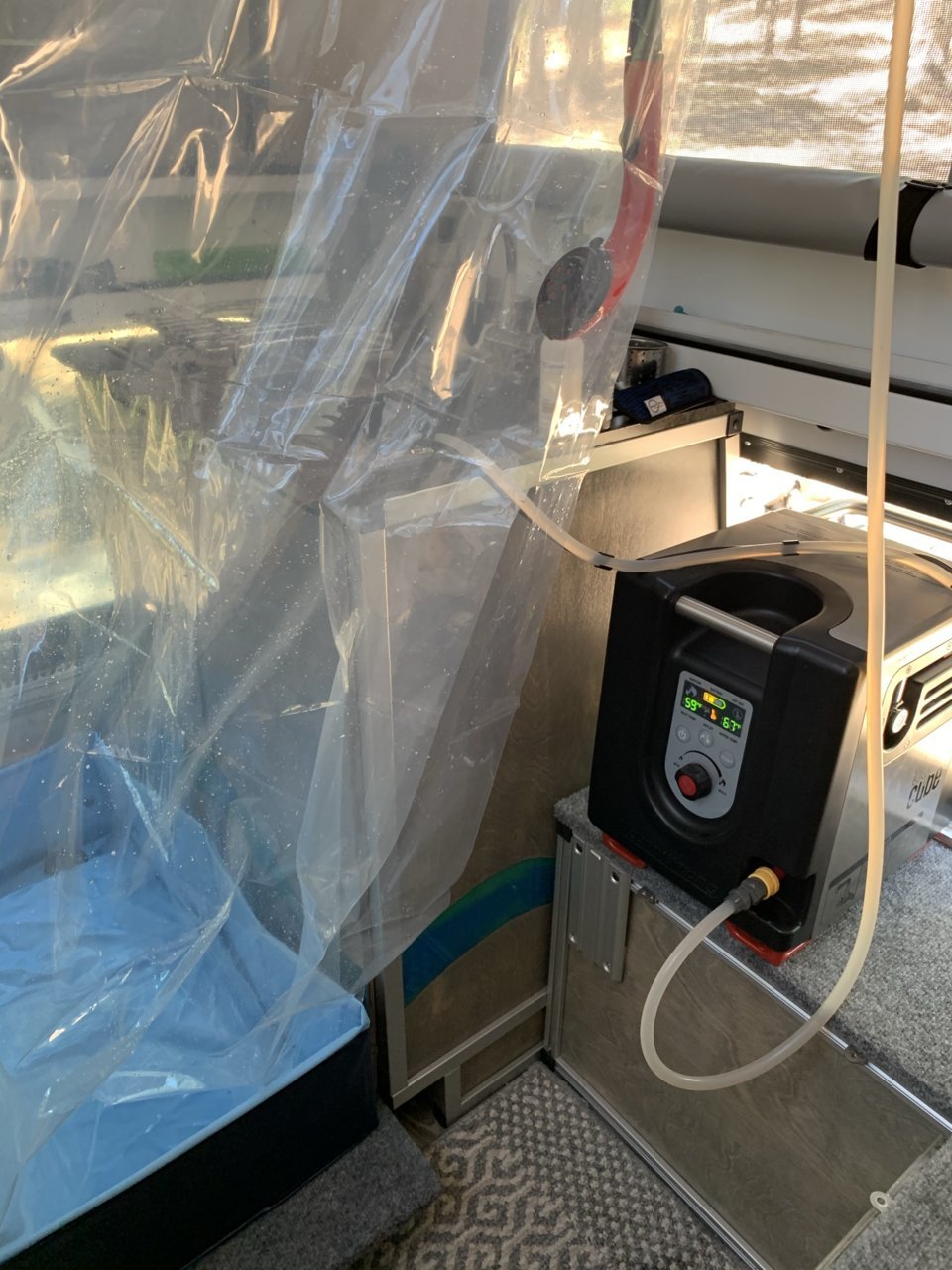

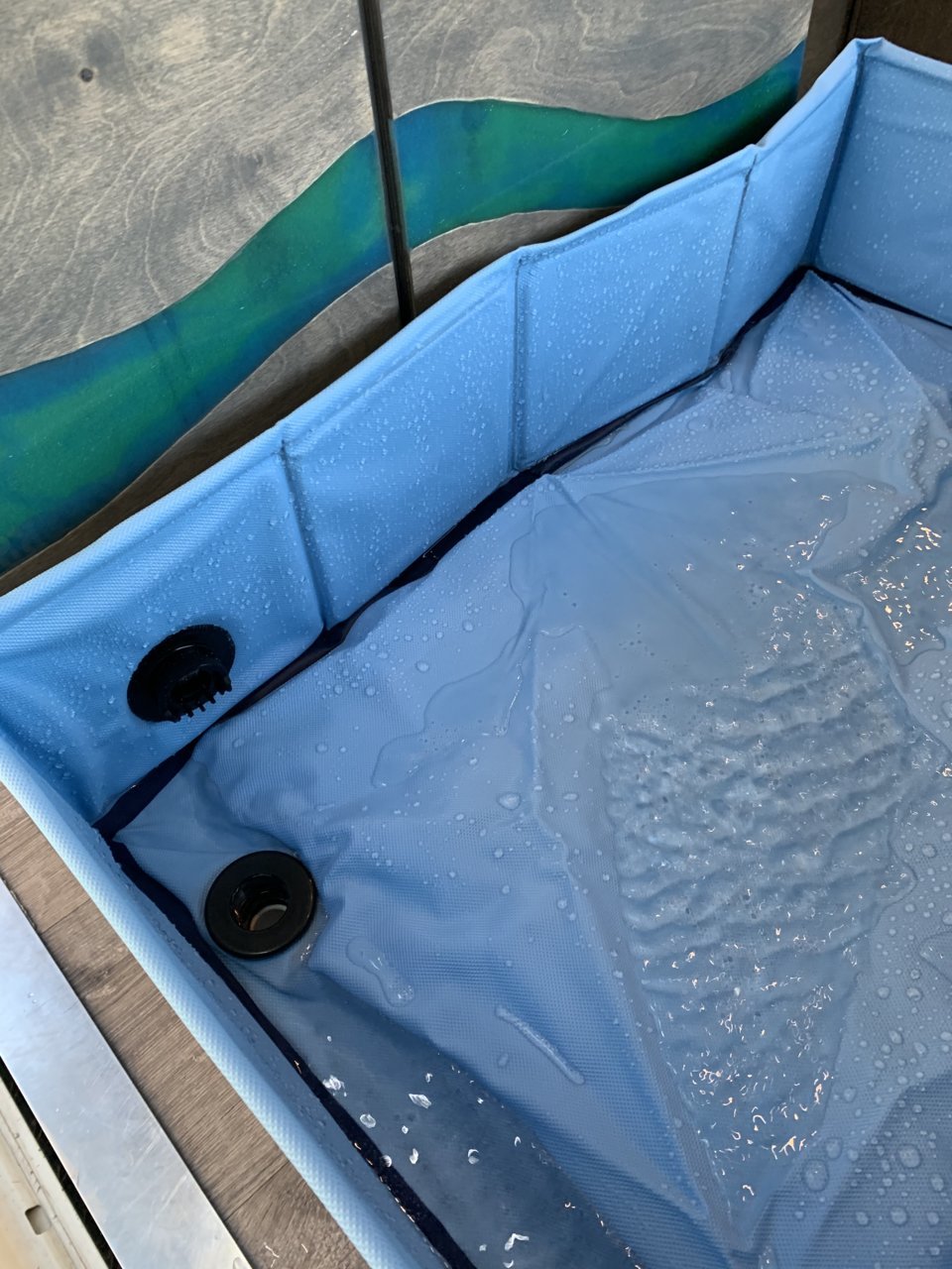

    UPDATE: I had my first shower in the Drifter this past weekend. It was super windy the first day of camping so I spent the time sewing up the shower curtain support straps. I just got some black nylon straps with adjustable cam buckles and sewed to a patch of hook / loop material and fastened to the Velcro strip that Vagabond includes around the top perimeter of the tent for the insulation package. I connected the straps to the shower curtain with carabiners. It worked great and no water escaped from the shower at all. Very happy.
