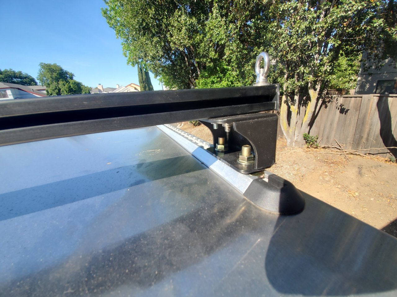

    Does anyone have recommendations on mounting cross bars to the roof L-track? I'm looking to support up to two canoes or kayaks.

    They will sell you front runner bars for the l track for like $300 they are pretty solid and awesome cause they take standard bolts. I had a Thule aerobar on my taco before drifter. I looked into adapting them but just said screw it and went with their front runner option. I think they can handle quite a lot of weight, so far all I’ve had on is a cargo box.

    Does front runner make the feet that go in the L-track?

    I believe the feet are a VO custom supplied option.
    Formed and powdercoated. Very stout.

    BAMF custom makes them for VO so you know they are strong. They can be ordered at different heights depending on your needs. VO will mount Frontrunner crossbars too if you want. I added my own 80/20 crossbars to match the Prinsu rack. Easy and strong. 20210601_170954.jpg

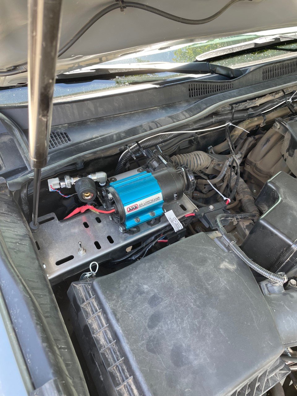

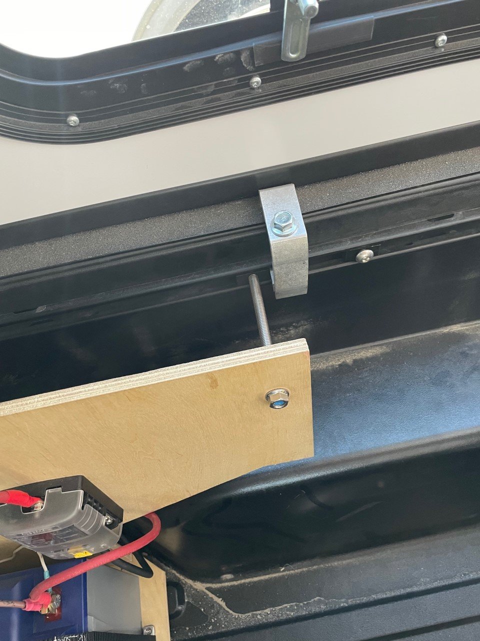

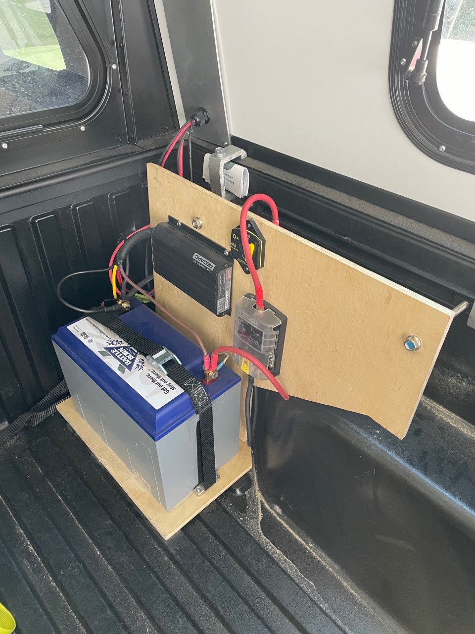

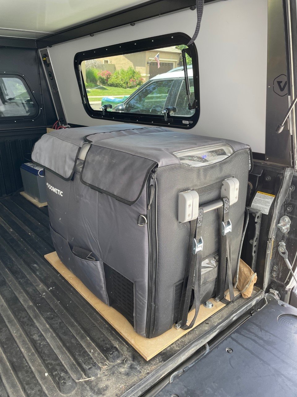

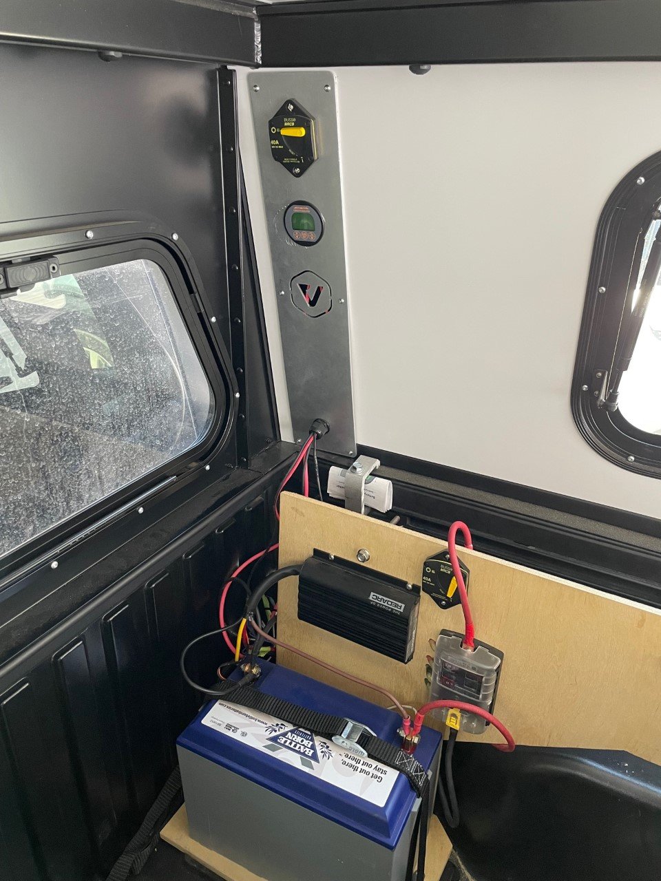

    Finally got most of the Drifter functioning...not done, but functioning lol
    This has been a two years in the making build.
    Just in time for a family trip out to High Rock Desert in Northern Nevada. Raining & 70 the last time we went, sunny & 103 this time.
    In the bed there is a Redarc controller & Battleborn battery hooked up. Super happy with both. Set it & forget it. Only ran my truck for about 20min/day to charge up the Battleborn & had power for the fridge all day & fan all night. Very happy with it.
    The 1/4" plywood needs some stiffening & tie down to the corner bed anchor for stability but overall it did well on the trip. The t nuts & thread bar is a solid anchorage option from the sides. Now if I could just be a good craftsman...or electrician. Lots of loose wires to organize, wire runs to redo & other odds and ends but I got a fridge, lights & thankfully a fan for the 100 degree days to cool off the camper at night.
    One part that didn't work is the battery monitor. I think the inexpensive Amazon one https://www.amazon.com/gp/product/B07CTKYFTG/ref=ppx_yo_dt_b_asin_title_o00_s00?ie=UTF8 I installed just has a quirk in it and needs replaced. Shows charge while I am drawing power with the fridge & lights. Yes I did reverse wires to check but am open to other suggestions. Replacement is on its way just to check & see. Hope it works since I already drilled out the hole in the corner panel and I generally like the size, function & price of the unit. 40A breaker above is for solar input/future upgrades. Need brackets made before I can mount that on top - 160 Renogy unit recommended by @socalexpeditions. (Thank you for all the help)
    The fridge mount is great. Nice & solid. Couple straps https://www.amazon.com/gp/product/B01KP24GMK/ref=ppx_yo_dt_b_asin_title_o05_s00?ie=UTF8
    Bimini anchors https://www.amazon.com/gp/product/B07V9NKM26/ref=ppx_yo_dt_b_asin_image_o05_s00?ie=UTF8 off Amazon, some nuts & bolts from HD along with an extended bed bolt someone on here posted and I was good to go.
    Power was ran outside the bed to a BlueSea 12V cigarette adapter I drilled into the little bed light cover. Wish it was a little more solid mounting but good enough for now. Has held together this whole time. Fridge continues to be one of our favorite purchases. The replacement Mountain Hatch tailgate cover has been solid as well.

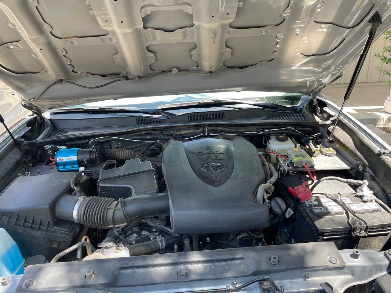

    In the front I have a @Mr.PowerTrays blank tray that I modified for an engine bay six circuit fuse block fed by a 40A breaker along with a 40A breaker feeding the Redarc/bed. There is plenty of space on it for something else if needed. I also added new battery terminal & main ground cable for more connection options. The single white cable running along the back is an ignition on circuit cable for the Redarc.
    On the passenger side is a SleeOffroad ARB bracket and single stage compressor. I wish I was handy enough to build my own bracket but I am very pleased with this one. I Use the compressor for blowing off some dust before opening everything up in camping & airing up all the tires at the end of the weekend. Solid unit. May look into a remote tank somewhere in the future.
    Next up is reinforcing & insulating the tailgate to try to keep some heat away from the fridge. Definitely tinting the Drifter windows too. Both the gf & I noticed sizeable temperature drops in our cars when we tinted our windows.

    I have the same battery monitor. Mine would only show discharge and how many amps were being discharged. It would not show charge going into the battery.
    My issue was that I had the ground going from the battery to the shunt plus another ground at the battery. When I moved that second ground downstream from the shunt it started working.
    I think I just got the same dcdc/solar charge controller. I had a ctek but it crapped out after almost 3 years. I'm really hoping the redarc works longer. They have a great reputation.

    Thanks. It was a super solid start and worked great on its first trip. Next power mods are installing a switch for the Redarc charge profile so I can force it out of lithium mode in the winter and can keep charging when it gets cold. Will also be adding some small stick on 12v heat packs run off a temp controller to try to keep the battery & Redarc warm enough to keep operating on the colder days.
    I have a ground bar on the back of the panel with all grounds on it-truck, solar, blue sea fuse panel etc which then goes through the shunt (short small wire) and to the battery. Little white wire is a small positive run to the battery.
    Will try just plugging in a new screen to see if its just that or the cable which I nicked running it through the cable gland. Hope it's that easy.

    I hadn't thought of adding a switch to the Redarc so you can change the charge profiles. That's an excellent idea.
    Good luck with the new screen!

    Partial success testing a new screen. Showing discharge and more realistic power draws with everything on. Battery is also probably dead from running the fridge for days without a charge. Now to just rewire it all back together, reprogram it with a full charge and test it out. Will also check the cable and try to find the root cause of the BO monitor. Hopefully just the cable and I can sell a nice, gently used (sans cable) battery monitor for cheap ;)
    As for the switch I saw that idea a while ago in the thread so I will give credit to this thread and the people on it. Some great ideas out there.
    Read on from around here for a bunch of good info from others and some great ideas regarding the cold. https://www.tacomaworld.com/threads...ildout-and-mods.540940/page-244#post-24778500
    Edit: It was right under my nose. @joeydurango worked with Redarc for the charge profile switch if you are running Lithium and need to charge below 32 degrees. FYI Redarc is extremely helpful setting up their systems and I used them along with a few other electrically inclined folks to design my system.
