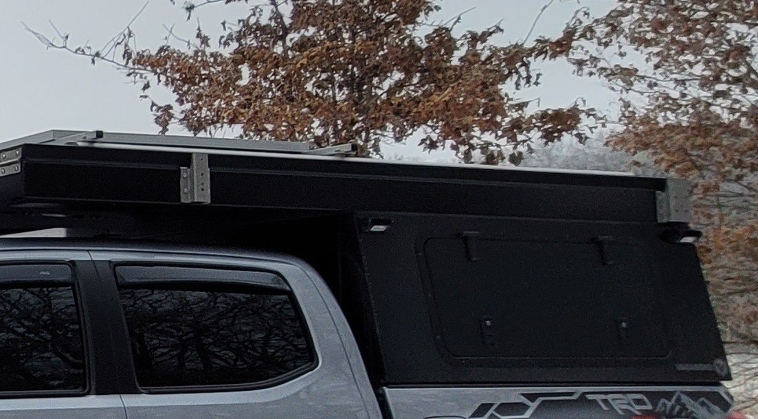

    Anybody have pictures of their 270* awning brackets? I have tried to search but am having trouble finding previous posts.

    Here is what the ones that VO installed look like. This is before I installed the awning.20210110_085837~2.jpg

    thanks! Looks like they stick out ~1.5in? Is that just for access to the back for nuts or does the awning need that space to open?
    I haven’t been able to get a response from Vagabond about ordering brackets.

    You have to get in behind the bracket with a wrench and a nut. Make sure you have someone with you that can hold the awning in place while you do the tricky nuts and bolts. My wife gave up after a few tries and i used straps to hold it in place, the L track on top worked well for that.

    Yeah seems like a two person job. Seems like you could have the bolts loose in the brackets and just slide the bolt heads into the awning extrusion instead of trying to feed the bolts into the bracket holes but I'm not sure which method would be better.
    Any idea how much the vagabond brackets cost?
