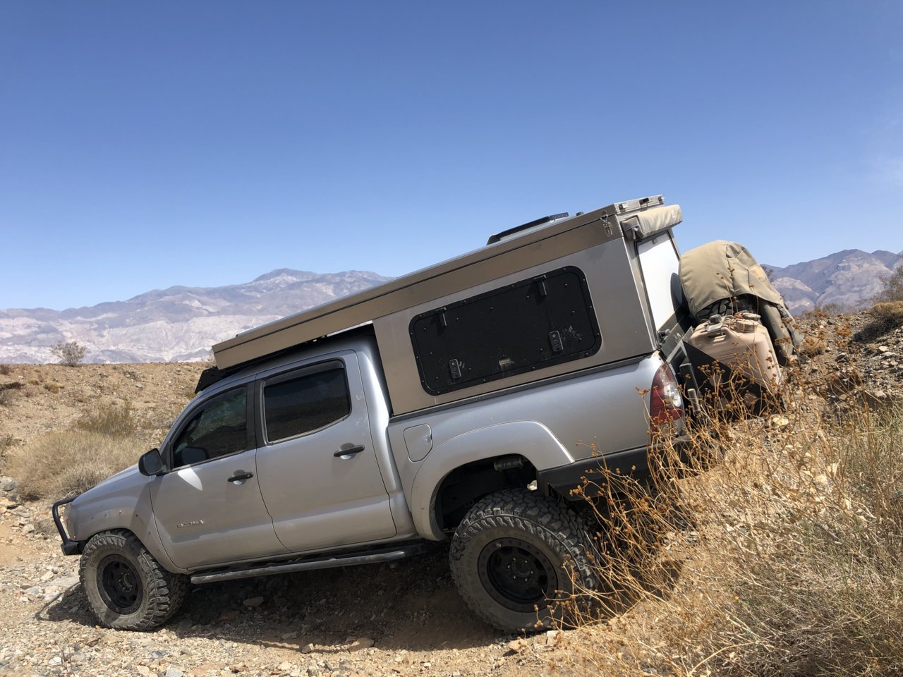

    STS brackets are not a great idea for 270 awnings, the rear most mounting point bears a lot of force when the awning is open. Also, 270's are side specific so it's not like you can switch sides on the fly anyway.
    I'm in agreement with most... personally I prefer the 4' hard mounted on the rear and 6-8' side awning on STS quick release brackets so it's switchable from driver to passenger sides

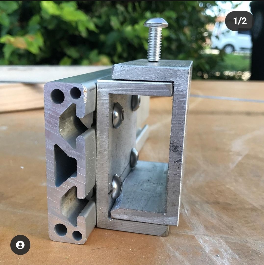

    I'm looking to diy mount a 270 as well. This is the option I'm leaning towards but with a pin down the middle linking the 2 c channels together. It would be quick detach by removing the pin. I wouldn't do the 80/20 though. Just straight c channel sections to the drifter. Screenshot_20210706-033036_Instagram.jpg Screenshot_20210706-033105_Instagram.jpg
    anomalyTRD likes this.
  12. Jul 6, 2021 at 7:38 AM
    #5732
    alldownhill
    alldownhill Well-Known Member
    Sep 20, 2018
    #266862
    163
    As is, I think that's going to be pretty "flexy" on the back corner. When freestanding, there can be a lot of load on that back corner. You could potentially do two of the brackets as you show and then the back corner rotated 90* so you have better resistance to the bending.

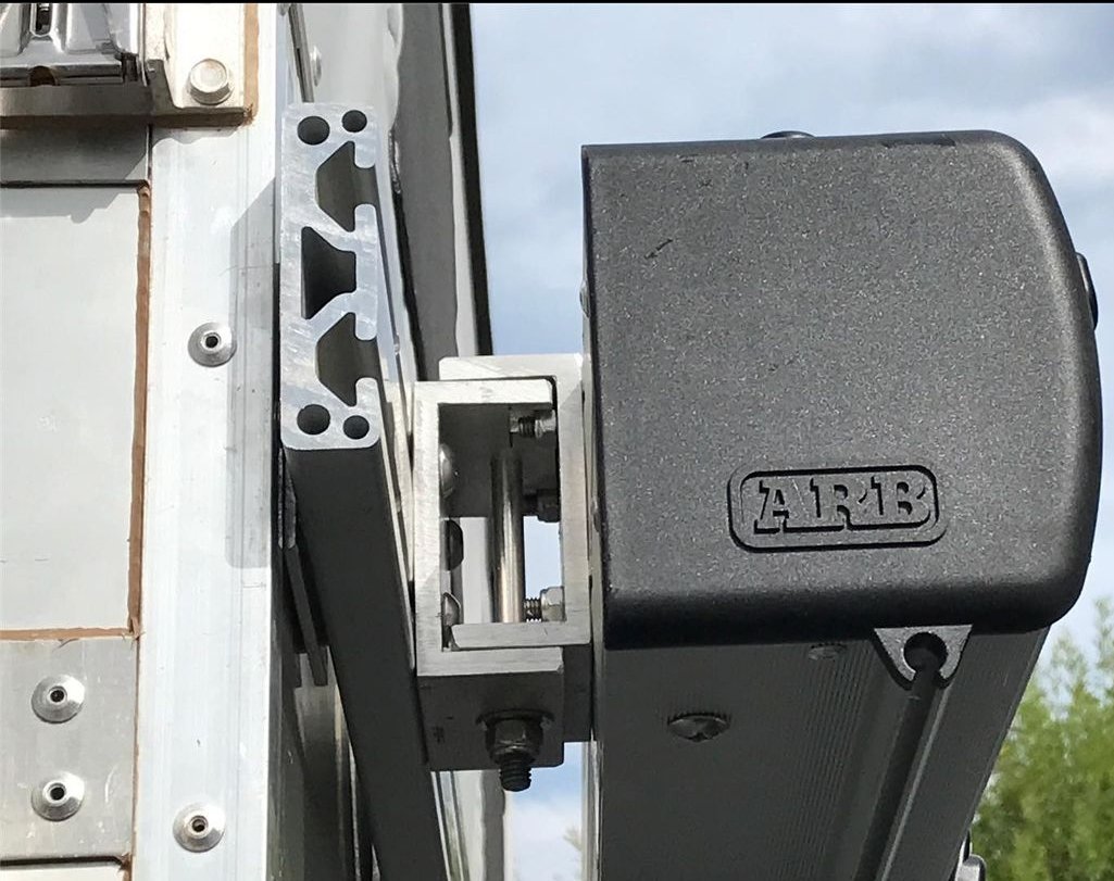

    Here is my 55” CVT hybrid awning with walls (excuse the driveway pics - gotta practice in suburbia before doing this in the dirt :D)

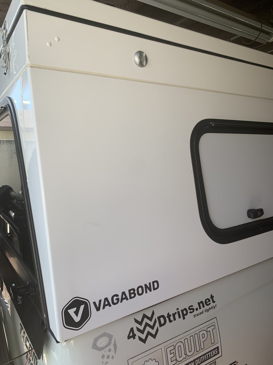

    Can you take a photo with it all closed up and zipped up in the storage bag? I'd like to get a visual on where I'd have to relocate my latches, etc... Bonus points for holding up a tape measure or ruler on the vertical and showing depth...
    Website states closed dimensions are 61" (W) x 7" (H) x 5" (D) but photos are worth a lot more than text.

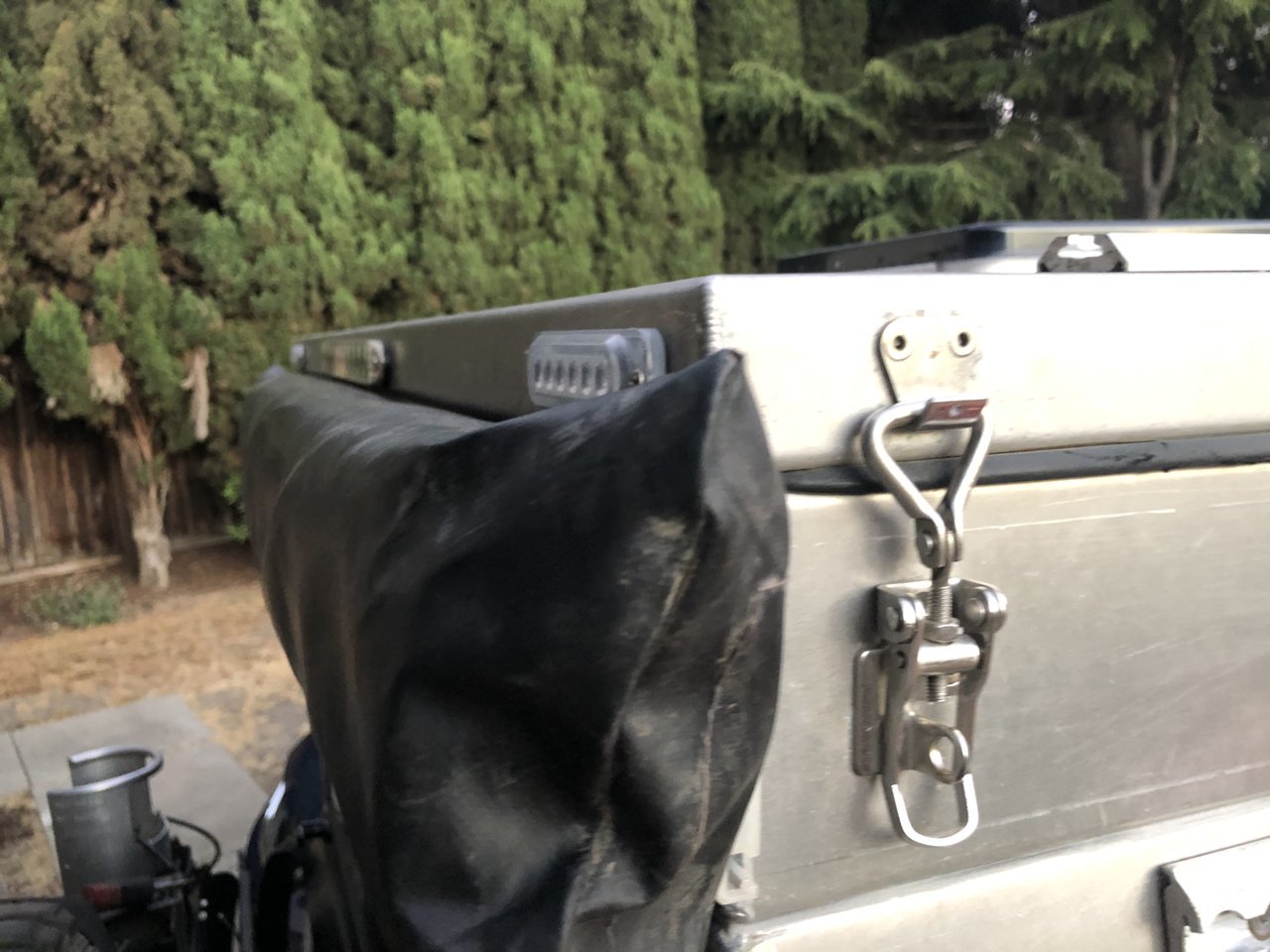

    While not a CVT, it is a 55in awning:
    Latches are in the original location from Vagabond.

    Looks like a handle on the lid would still clear as well. :thumbsup:

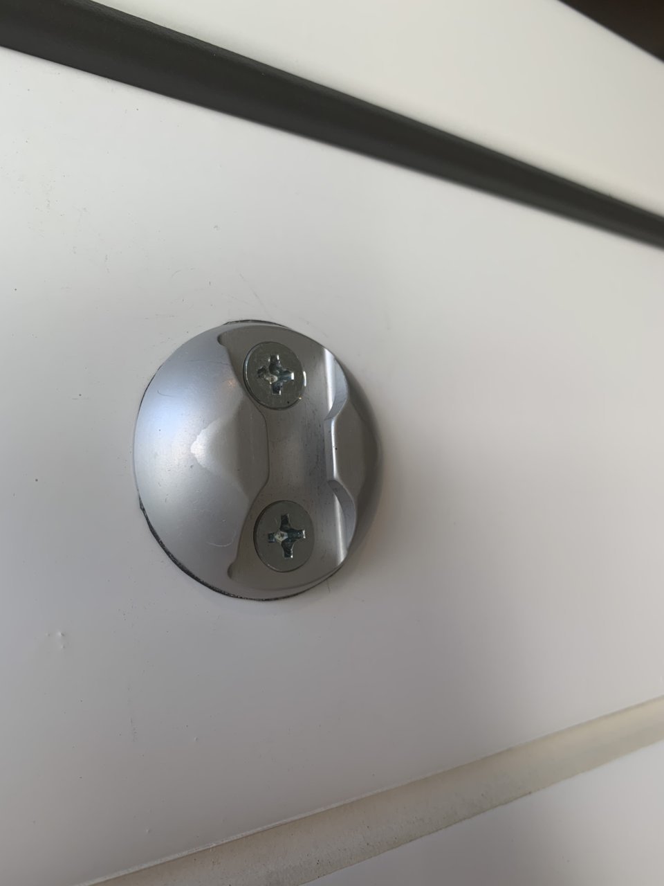

    Yeah, I just open from the inside and never bothered with putting a handle. Now, I'm switching to a 270* awning so will have to move my latches. Seems like you're in CO so you're welcome to check it out while I still have it mounted.

    I still open the lid from the outside. A little awkward of an angle, but nothing too serious - been doing it this way 3+ yrs
