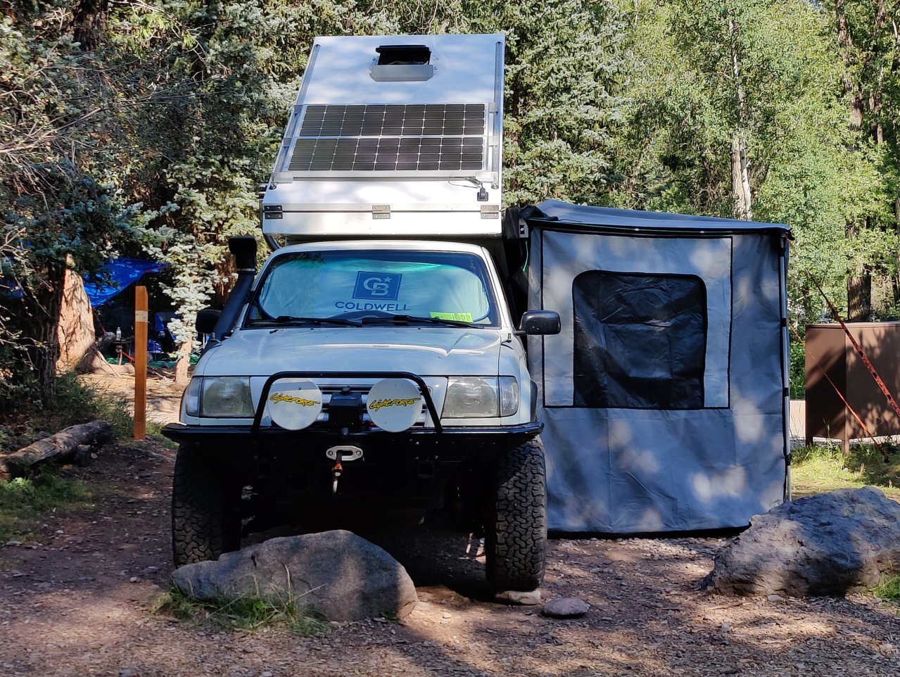

    I've only set it up once, so not practiced yet, but I'd say it was approximately 15-20 minutes with staking. It's worth doing if you are camping for at least a couple nights and have a need for the additional shelter/privacy. It will be great for doing outdoor showers when in a group setting. I know from experience using the wall kit with the Oz Tent setup that it's also great for when the weather turns wet / windy/ cold, or you want extra shade when the sun is getting under the awning.

    You may be better off just setting up a ground tent near your awning. The rooms are definitely great when setup but it's just one more thing you have to take down before you can move your vehicle. We have a inexpensive instant cabin tent that we setup if we're going to be anywhere for a while. It's easier to setup than an awning annex and can stay put at camp.

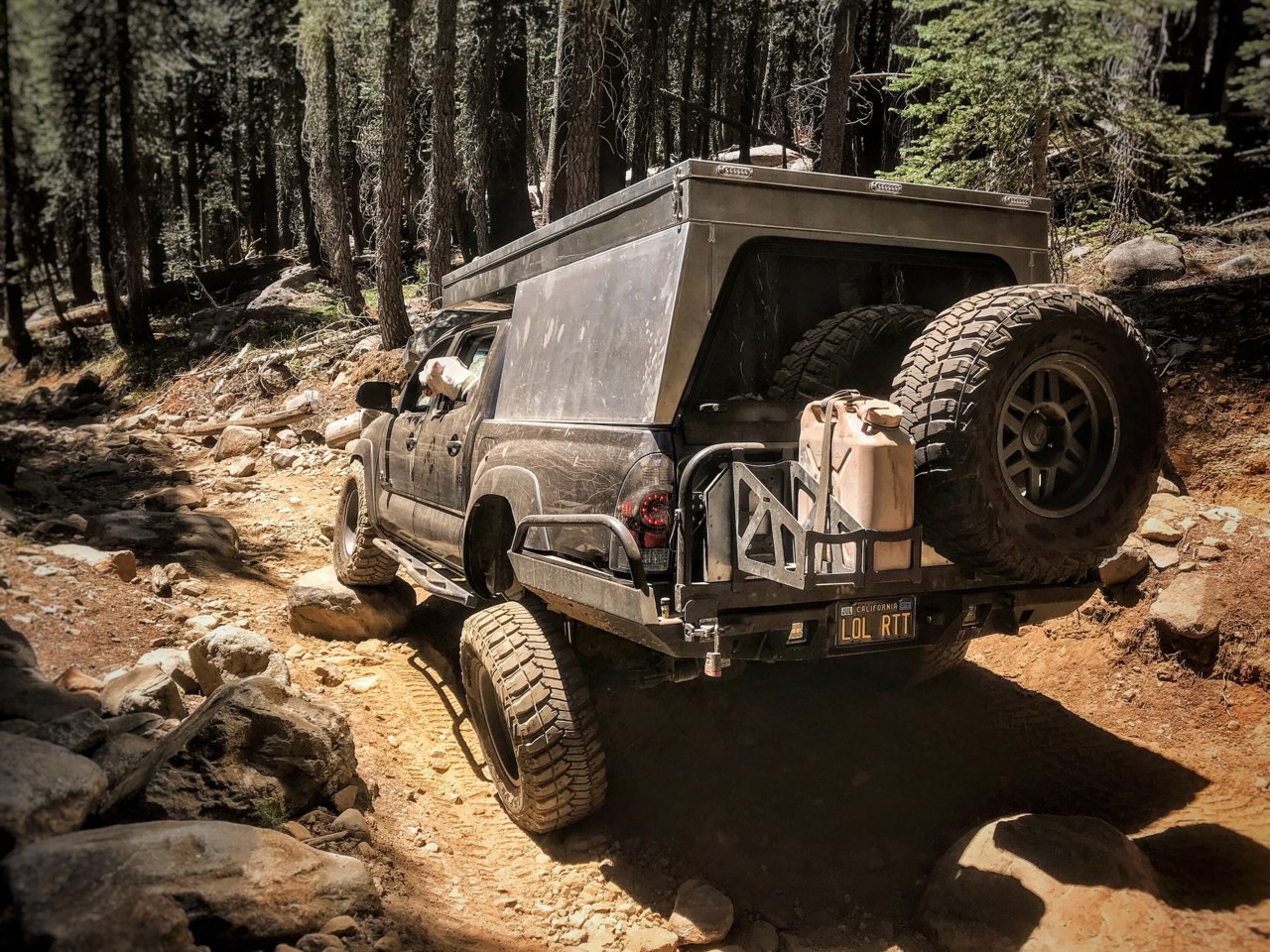

    so I'm still breaking in my drifter but I'm starting to realize it's not so fun wheeling with this thing on my truck. has anyone figured out a solid way to remove them for trips?

    it can be done with the help of some friends. 4 people should be able to do it.
    2 drifters have been rubicon tested. ;)

    Haven’t noticed any difference wheeling with or without the Drifter. I was really expecting to feel the difference in off camber spots, but it wasn’t the case.

    Trips are exactly the times I want my Drifter on the truck!
    I don't wheel hardcore, but for the high country 4x4 roads and passes I do, the Drifter is a huge improvement over the old FWC.

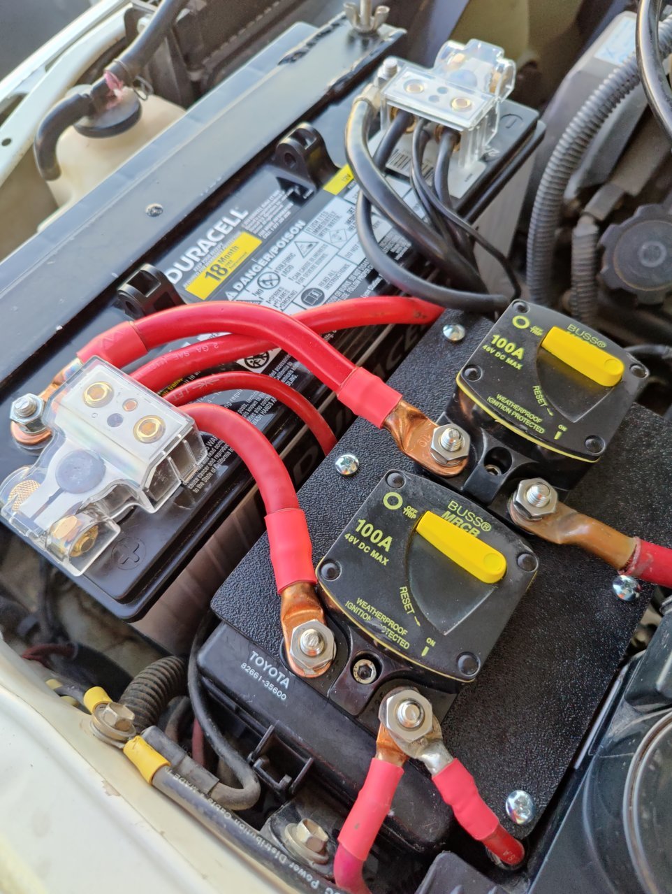

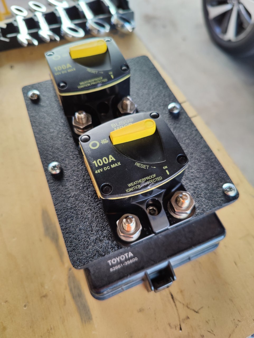

    I finally got a lot of the electrical work completed. I still have more to do, but this is a good start.
    The aux. battery sits up front in the engine bay where the starting battery used to be (it was relocated to the right side). I wanted to add a couple circuit breakers and clean up the cable connections to the battery. The best (only) place I could find to put the breakers was right on top of the OEM fuse box. So, I made a mounting plate and fit them into that spot. One of the breakers is for the connection to the isolator / combiner and the other is for the power lead to the camper.

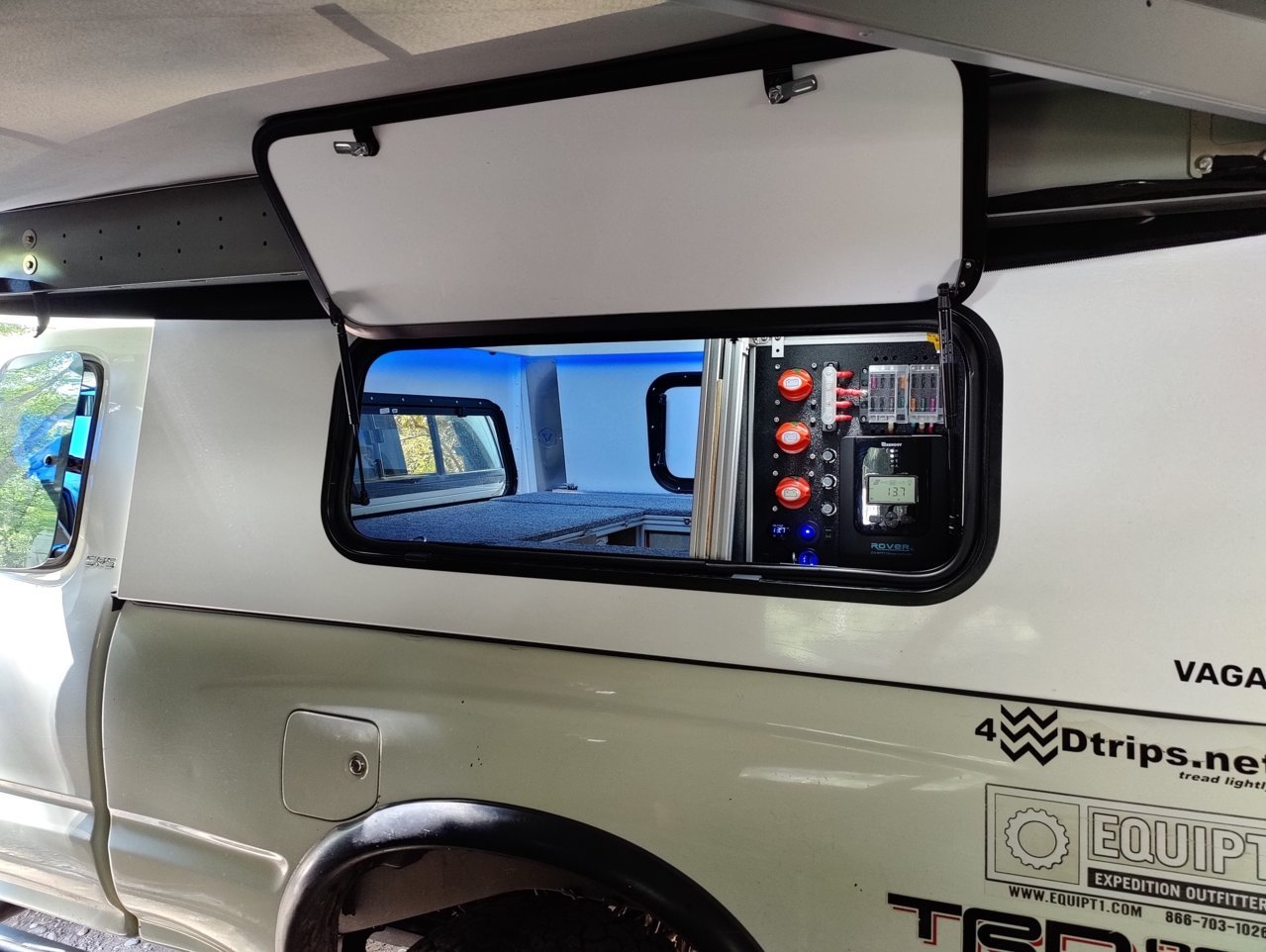

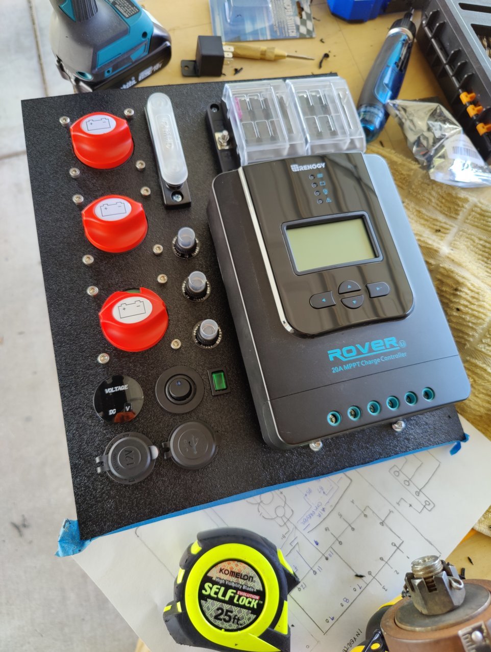

    I built a "power hub" with disconnect switches and circuit breakers for the solar, inverter/charger, and aux. battery. It also has the solar MPPT controller, bluetooth module for the solar controller, a relay and switch for the air compressor, a couple fuse blocks for camper circuits, a negative bus bar, and some USB / 12V charging ports.
    I got the solar panels (100W each) mounted up on the roof. I had Vagabond pre-wire the roof for this, and I highly recommend you have them do it because the cables are neatly hidden and routed inside the fixed overhang that is above the cab, and then routed down into one of the access panels inside the camper. This made hookup super easy.
    Some of you may recall that little space I had when you flip up the Drifter window on the driver-side, that was just inside the back of the galley cabinet. I thought I might use that space as a place to store easy-grab items. But, that ended up being the most logical place for the power hub to live, so that's where I put it. I also mounted my air compressor in there just below the panel.

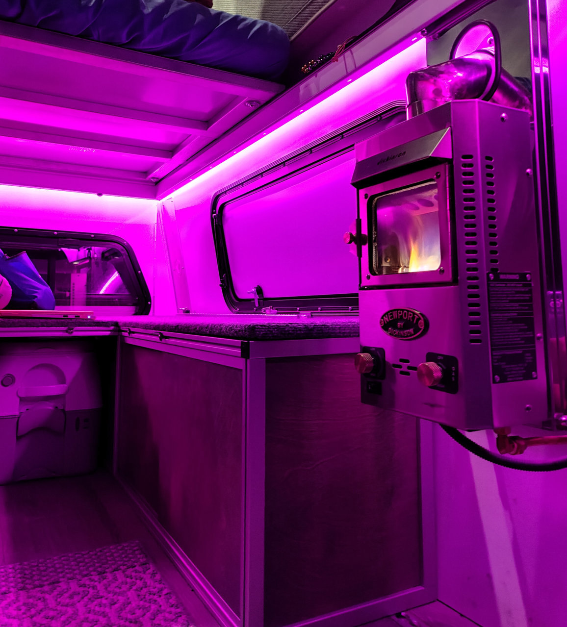

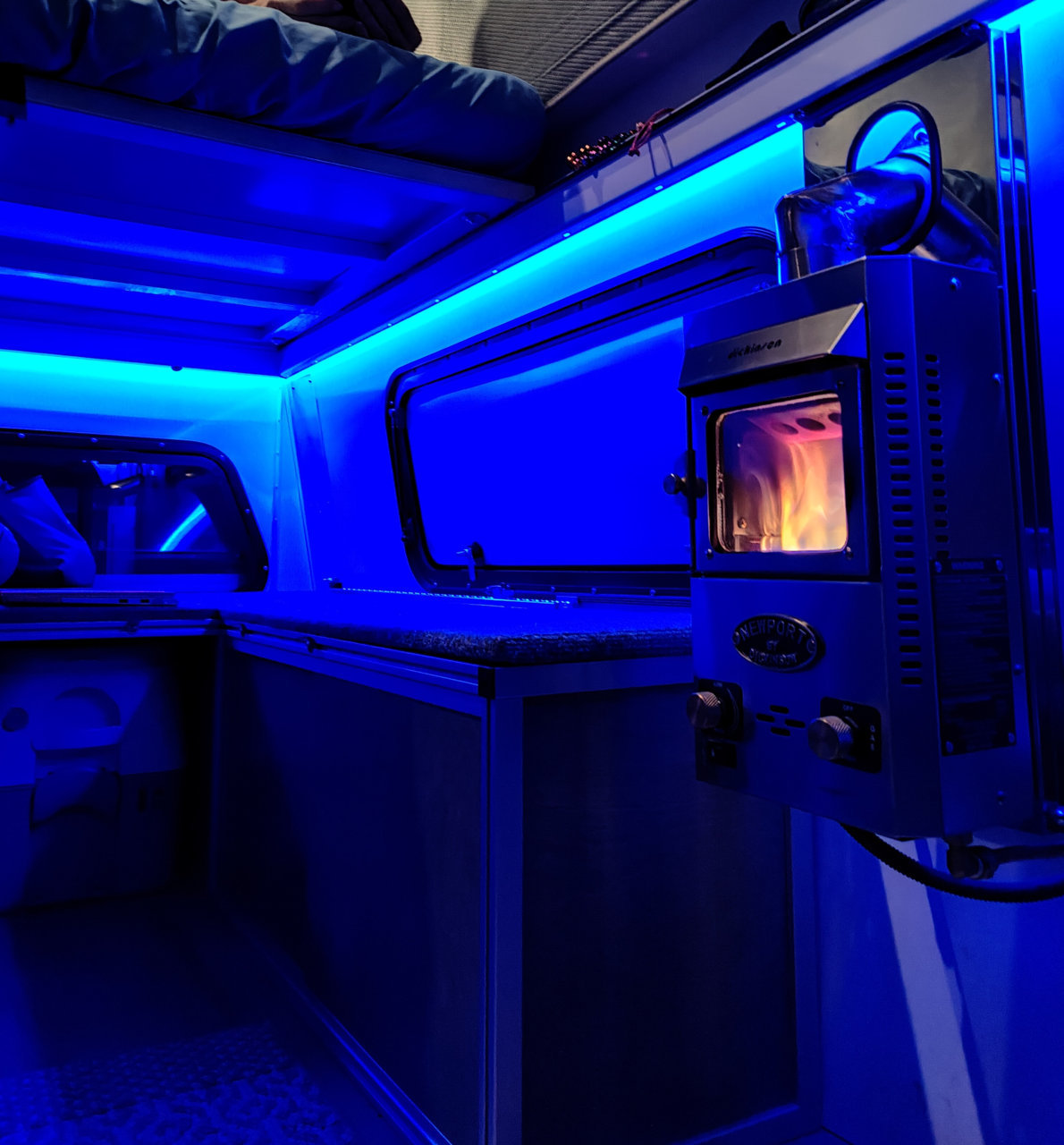

    I also added some dimmable RBGW LED lights inside the channel that wraps around the lower part of the Drifter. This is super nice, both for function and ambiance. You can dial it in with a wireless remote to suit the need or mood.
    I still plan on adding a switch panel with more charging ports, probably at the back of the Drifter, in the channel just above the rear hatch. I'm going to add another dimmable LED light circuit and put them inside the cabinets and under the toe-kick. The lights in the cabinets will operate with door switches, and then the idea is to have a master switch for those on the switch panel.
