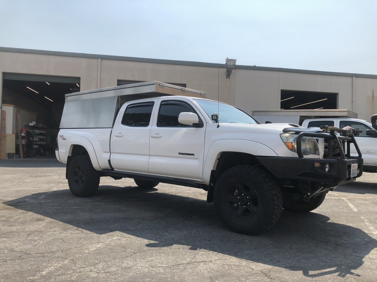

    Well I was summoned for jury duty and so far am not getting out of it so I’ve got some time to throw out some build updates!

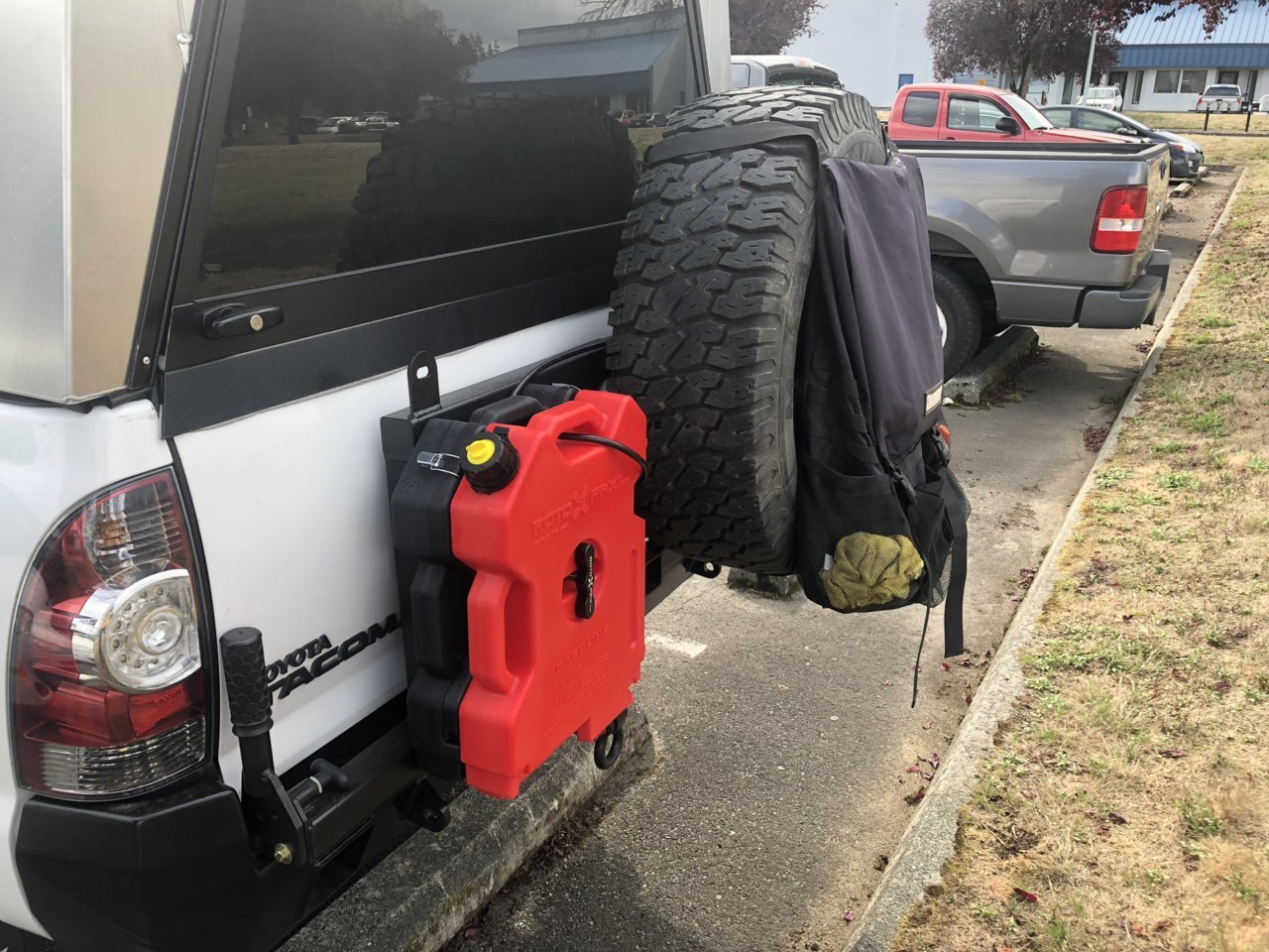

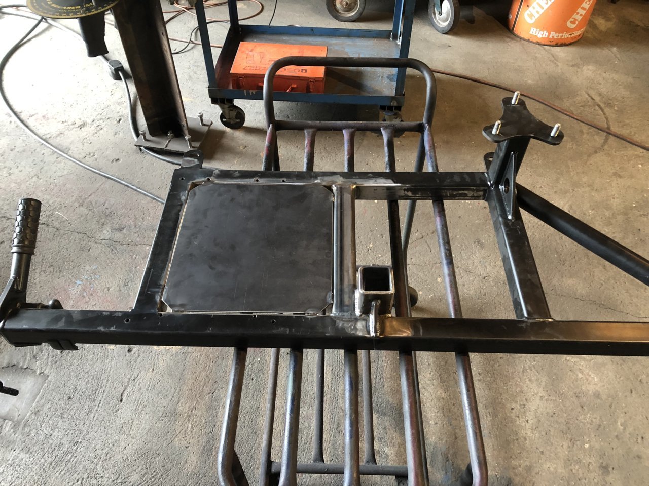

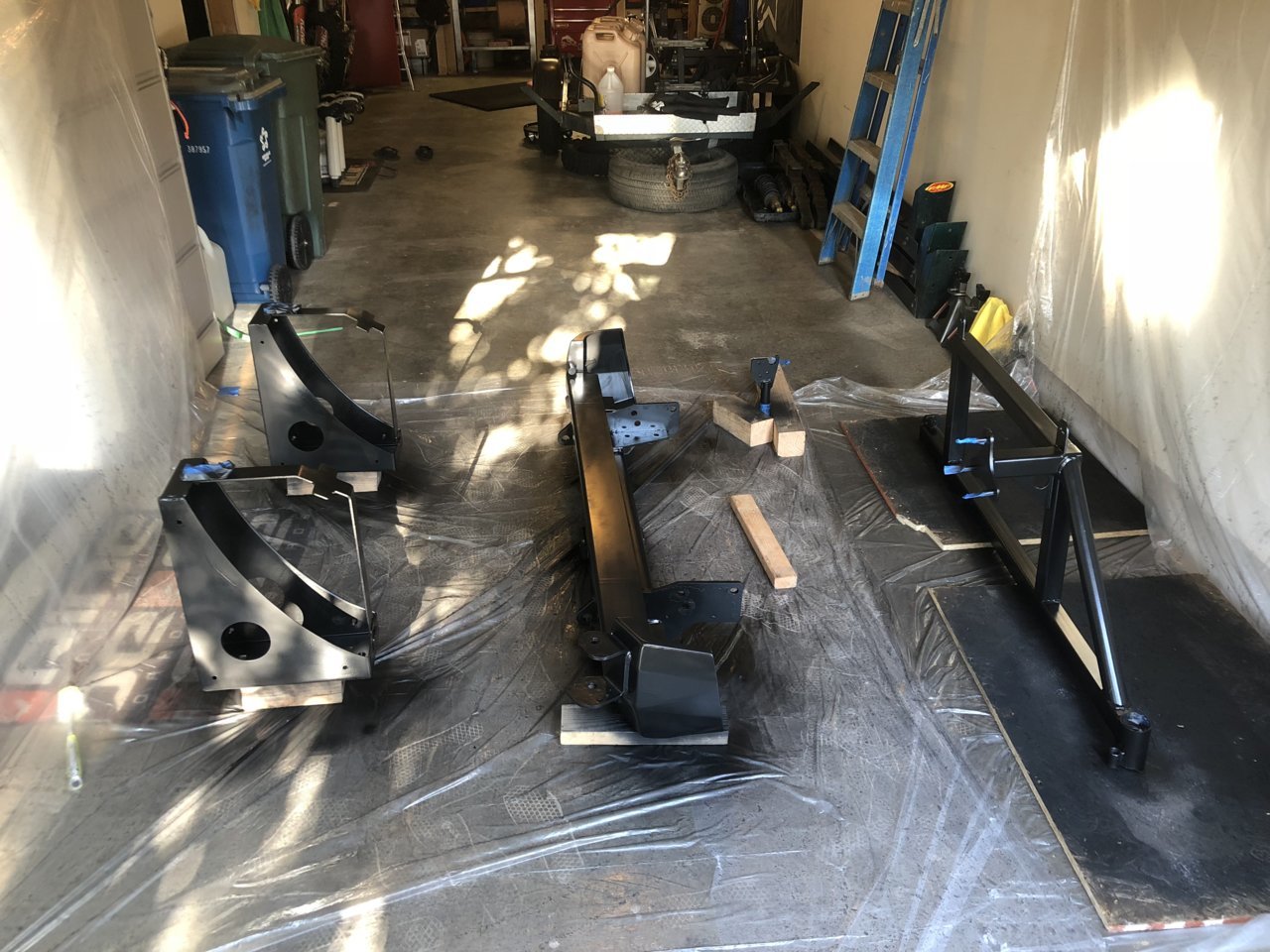

    We picked up our drifter Labor Day weekend and I cannot believe over a month has gone by since then. My ambitions of getting everything build back out ASAP took a lot longer than I thought. I guess I didn’t consider the time I spent on the Flippac build which was done gradually.

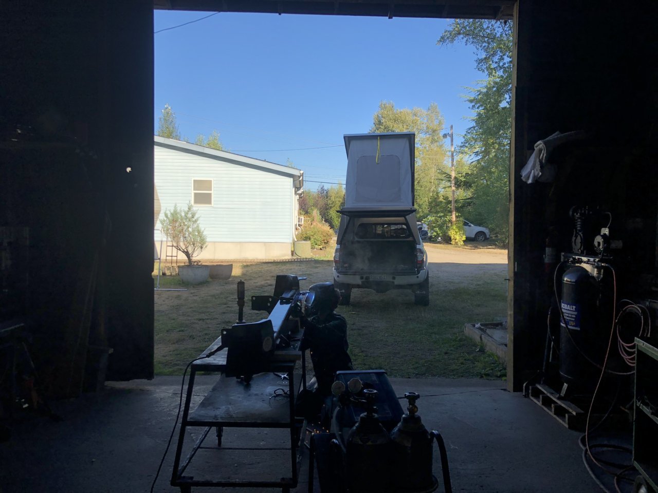

    While in Benicia Phil was kind enough to let me store a mother little item I was picking up from another member in the area...

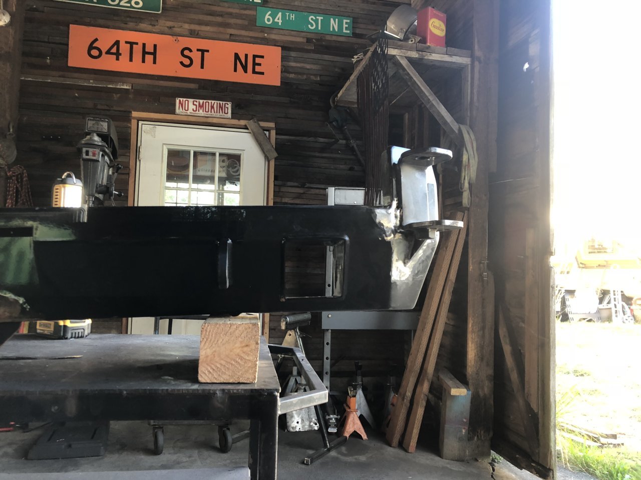

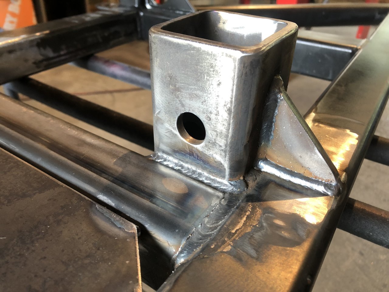

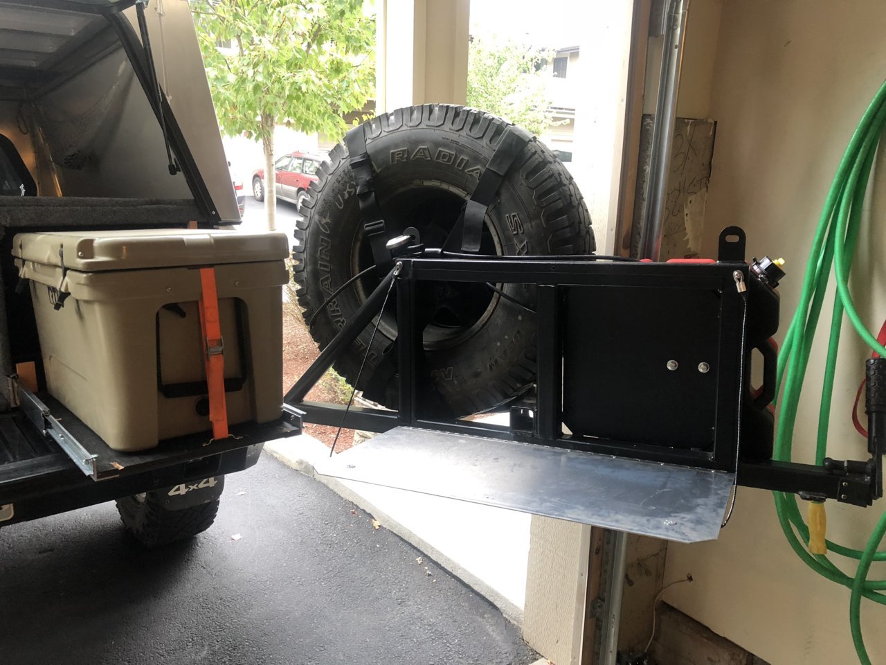

    The new to me bumper was going to take first priority but after getting it home doing some swing out configuration changes and a little TLC it was on

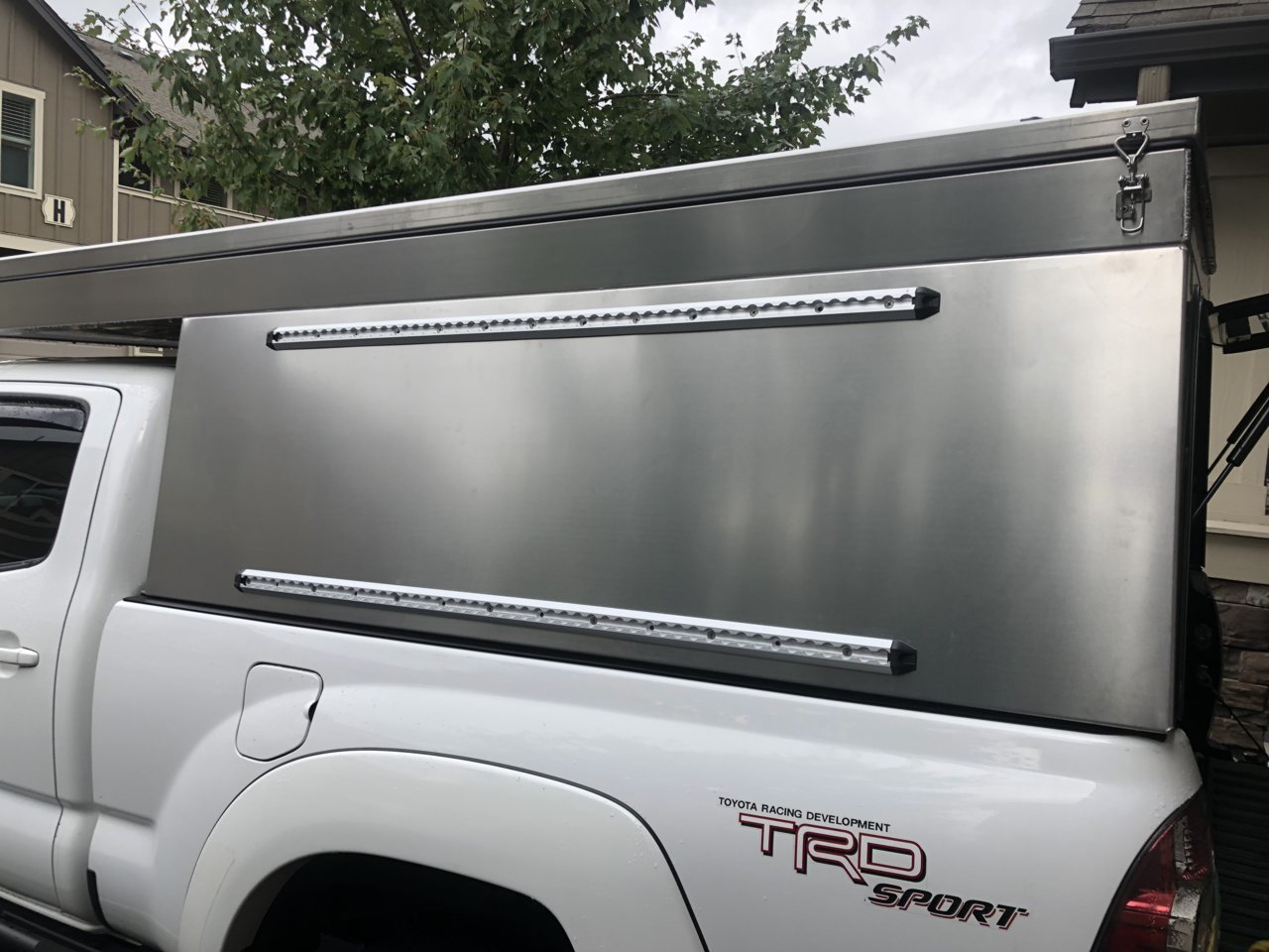

    Some time between then and now I also got my table fabbed up which has been a welcome addition.
    Before building out the interior there were a couple more things that needed to happen. One was adding L track to the safe walls since the insulation and wall panel had to be removed as to not squish the insulation, and to make a cleaner appearance.
    I added L track to both sides and have more detailed photos of the process if anyone wants to see them. I will say it was way less nerve racking drilling holes in the drifter than in the Flippac.
    Next I needed to stiffen up the bed sides which has been a topic of conversation lately. I fabbed up some basic rear bed stiffeners and am in the testing phase of a top secret front bed stiffener.. more to come on that in the future.. :p

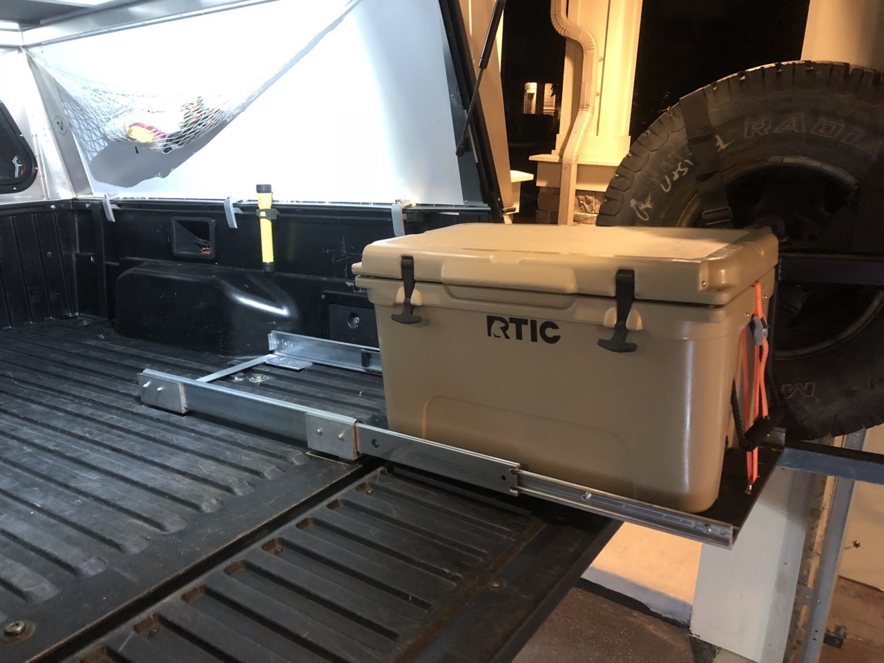

    Now that I had that’s stuff done the next step was to make my cooler/fridge slide. A stop to my local steel shop and some 500# drawer slides and we were in business.

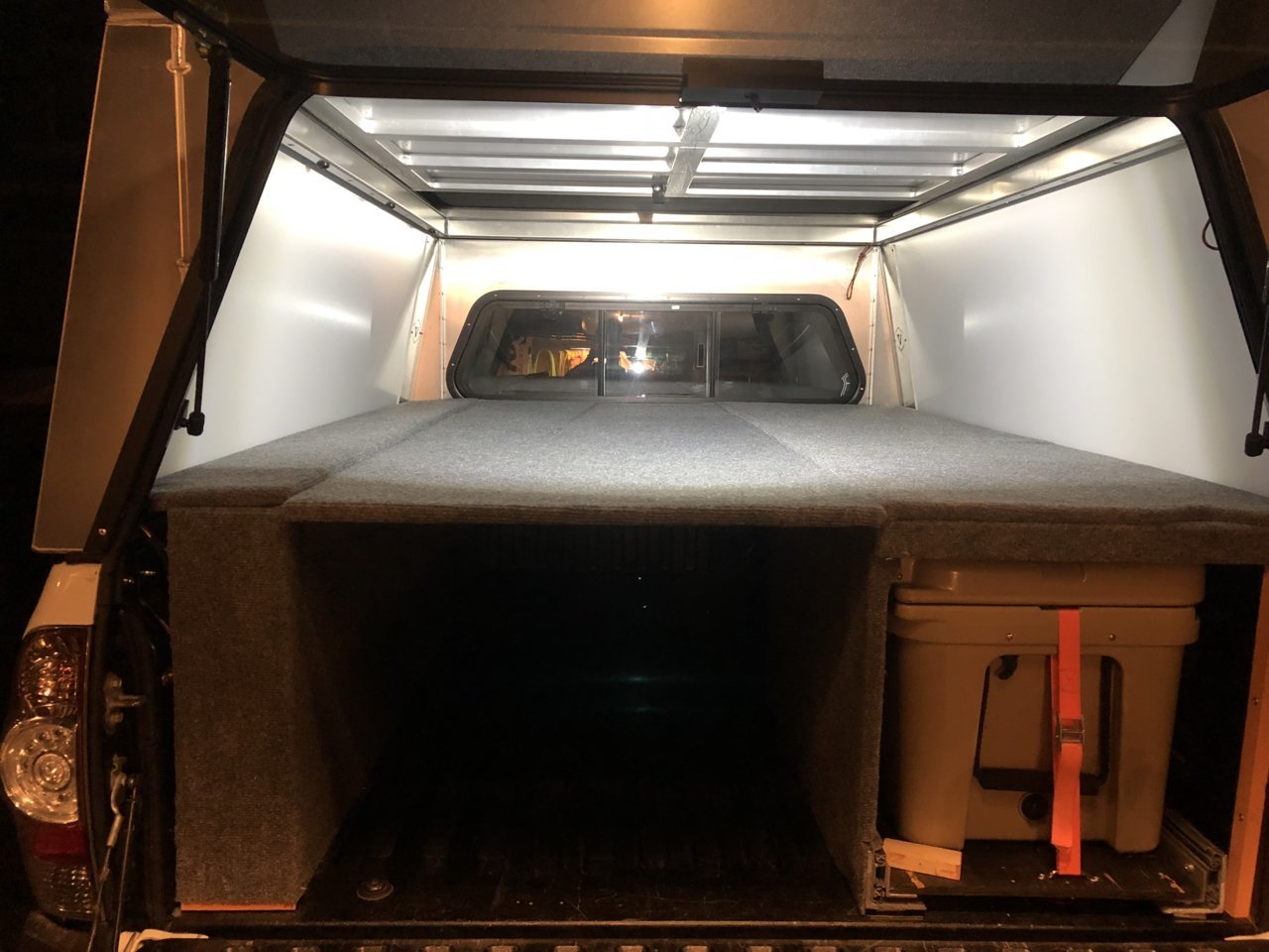

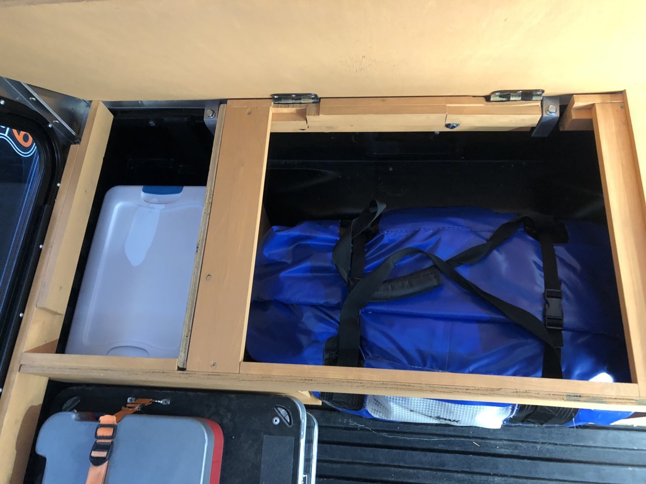

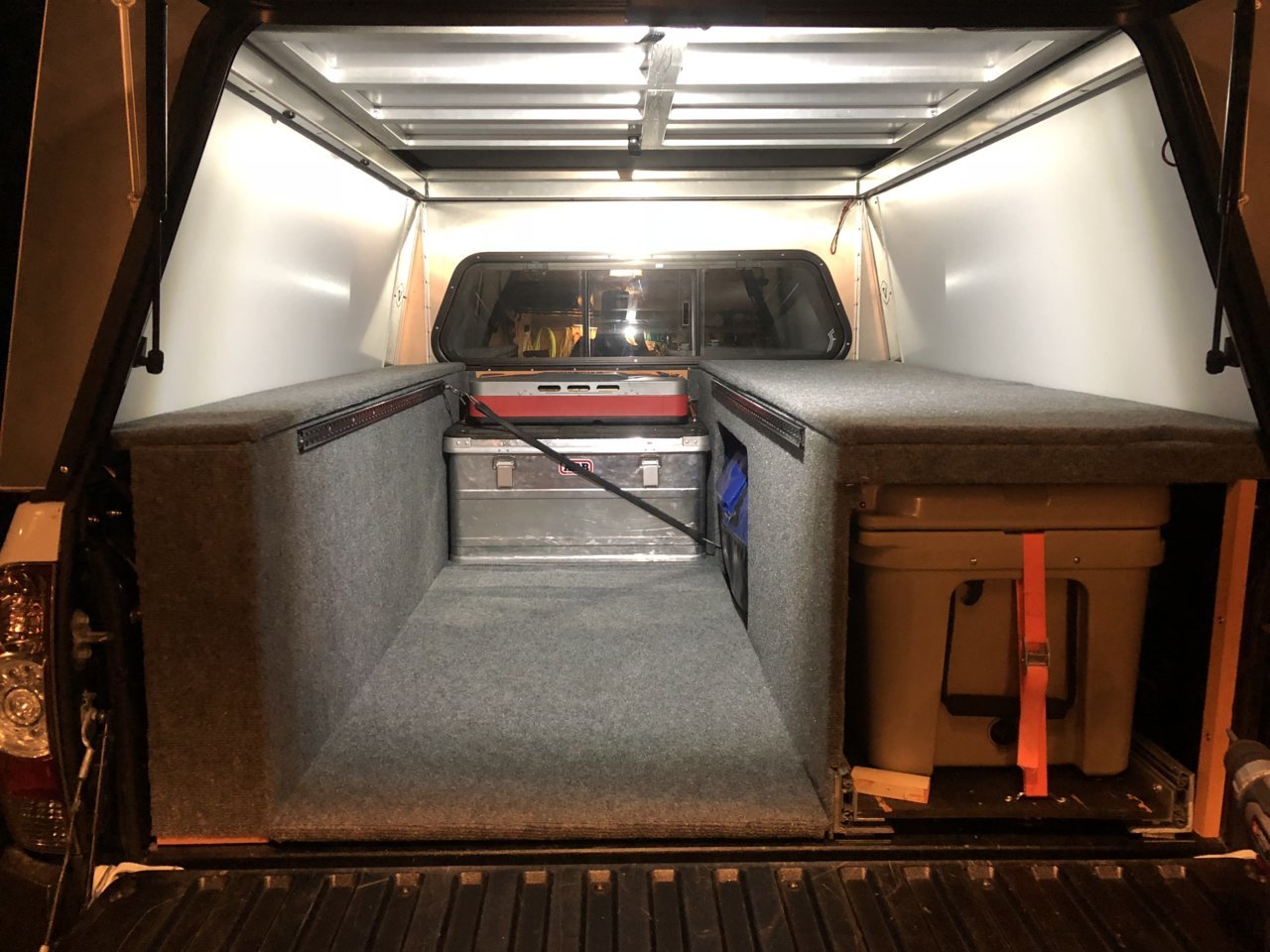

    I had way too much time to get the plans thought out for the interior. We planned to keep the interior lay out pretty similar to what we had in our Flippac because it worked so well for us. Having said that we did have a few changes that we wanted to make.
    42E8CC61-33D3-44BB-ADBE-18D99123776B.jpg CDFC3039-A64E-47FE-9C97-F021BBAA57A0.jpg
    The skinny cabinet on the side houses my house battery and electrical, our table, axe, fire extinguisher, and some stadium chairs that we use for whe we have our bed pull out in “sunset” mode.
    The right side has two lids; one for acces to the cooler from inside, the other for access to our big dry bag that hold all of our sleeping gear as well as a separate cubby up front that had our little camp chairs and a couple totes.
    Realizing now that this photo was taken during fitment check before we carpeted.
    We decided to leave the cut out on the wall connecting to the sleeping gear storage. Whe the bag is not in there it makes it feel a little more open, and we also wanted access to bedding even when the lid could not be opened.
    Also not pictured in the any of my photos apparently is the tool box. The last part of the build was constructing a two drawer box that fits between the benches at the fron of the bed. It has a shallow drawer on top and a deep drawer on bottom for larger tools.
    It can be removed and brought outside if needed near a rig and can also be secured on top of the passenger side bench giving more acces to the front for standing as well as crating a standing height table top for what ever you need. Most likely for my wife.
    Underneath the box is another “floor” panel which can be placed at bench hight on top of some L track that’s in place to maintain the bench when the toolbox is removed or to create the full platform in case you need to stealth camp or sleep 4. The passenger bench itself can sleep one as is.

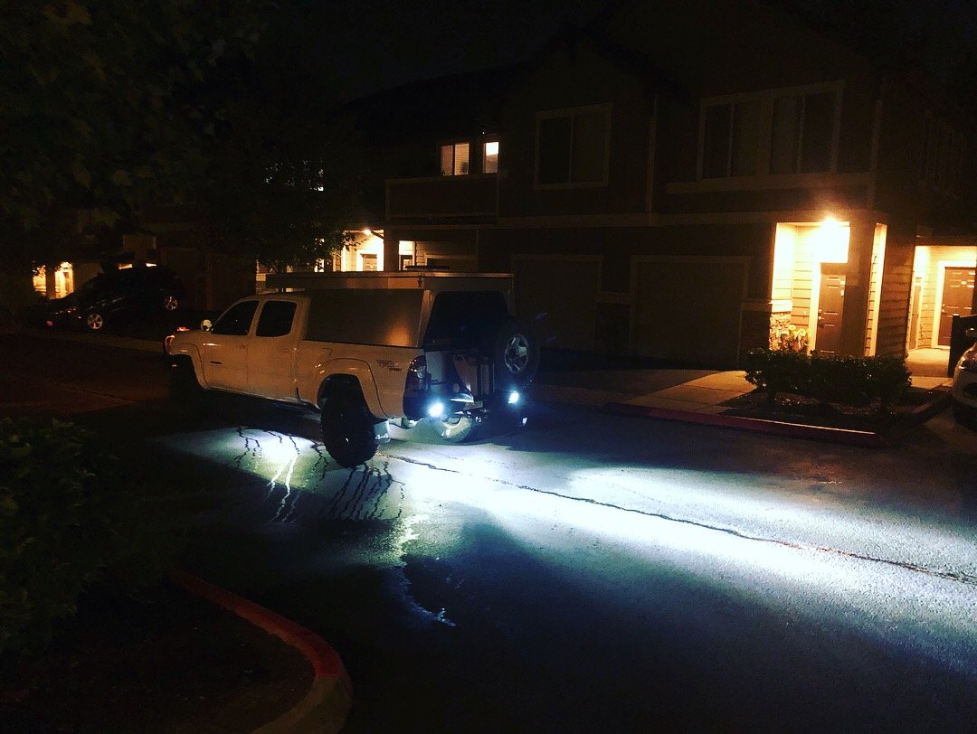

    One of the last big items was installing my electrical.
    I am running a smaller battery for now in the back connected to a circuit breaker and 6 bank bluesea terminal with grounds.
    I ran strip lighting (which I may have to redo as the adhesive was sub par) on the roof and under the

    Just installed the same bumper looks great! What's the cut out on the bumper for?
    Eazy.E[QUOTED] likes this.

    Pod lights
    Slashaar likes this.

    They need to get swapped for floods tho
