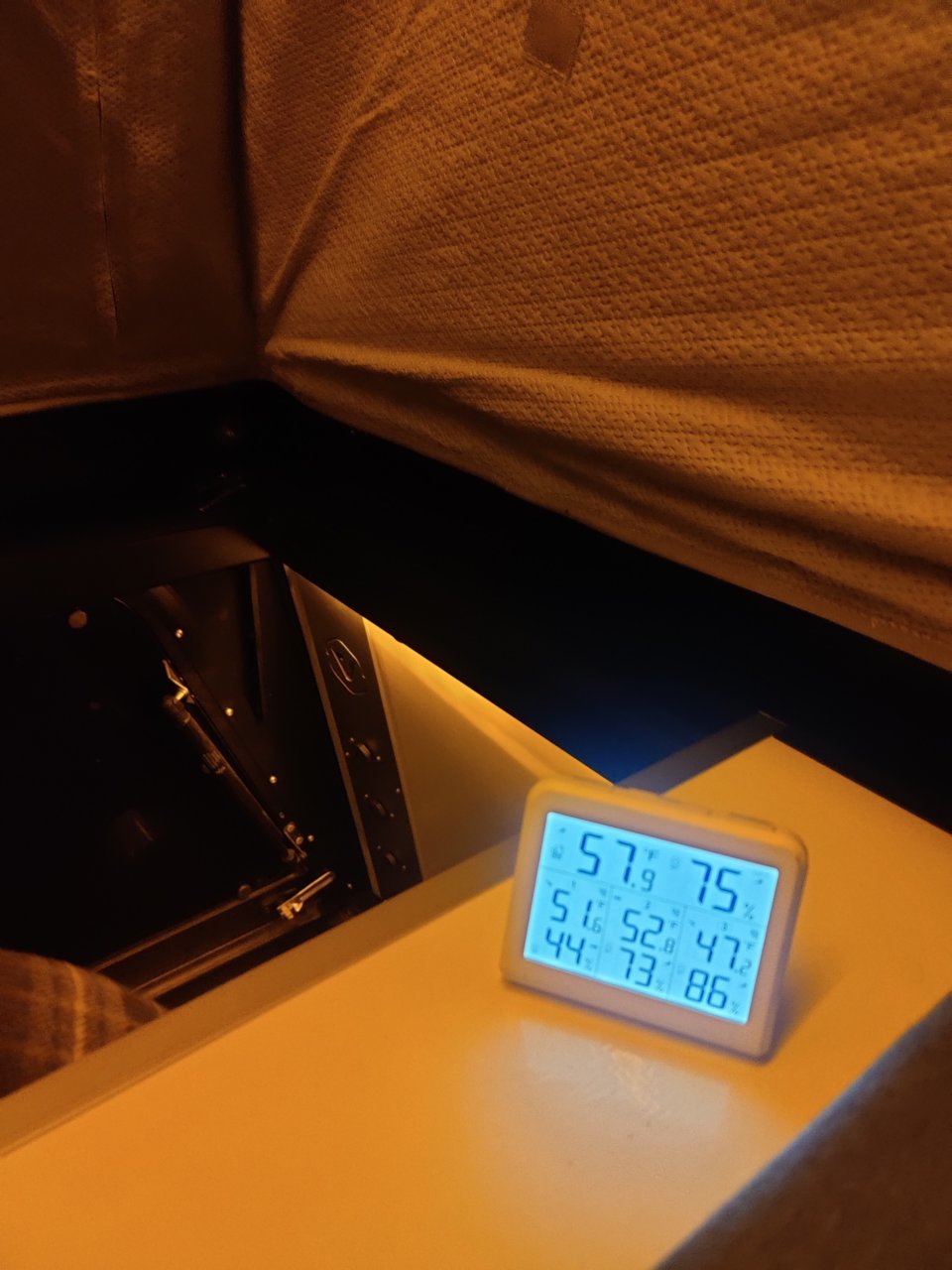

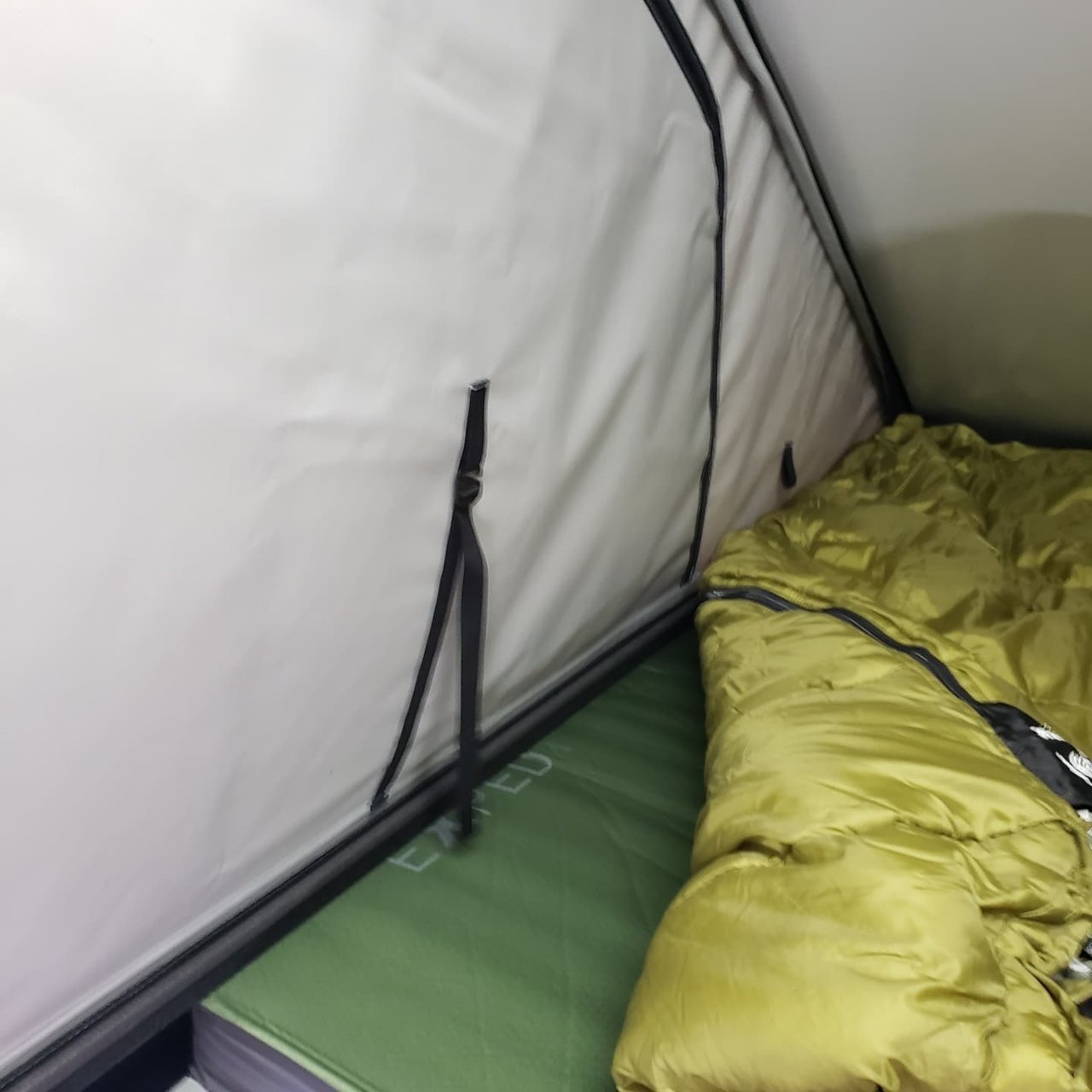

    stock af, but hover if you think you disagree... RV living: Vagabond Drifter (6' bed) Custom bed cabinet buildout 175w Renogy solar panel 40a Rich Solar MPPT solar controller 1000w Wagan Pure Line inverter Lavaner Pro 2kw diesel heat exchanger Suspension/wheels: Toytec Aluma 2.5 front shocks with resis 13x700 coils (soon 14x700) Toytec Aluma 2.5 rear shocks SPC UCAs Deaver Stage 3 rear leaf springs Wheeler's 3 degree axle shims Wheeler's U-bolt flip Wheeler's Super Bumpstops 18"x9" XD Monster (x5) 275/75/18 Cooper ST MAXX (x5) EBC Stage 3 pads/rotors Electronics: Kenwood DNX773S iDatalink - Maestro RR Stubby Antenna No-name Switchback LEDs Hella Sharptone horns (no relay) Relocated backup camera w/DIY bracket Armor/recovery: BruteForceFab Rear HC w/swingout BAMF Sliders (DOM, 10 degree w/kick out, rattle-canned) BAMF IFS Skid (BAMF powder-coated) BAMF Mid Skid (BAMF powder-coated) BAMF TC Skid (BAMF powder-coated) BAMF LCA Skids (BAMF powder-coated) BAMF Rear Diff Skid (early model, powder-coated) BAMF CMC Plates US Offroad Winch Bumper Smittybilt X20 10k synthetic rope winch Total Chaos Bed Stiffeners ARB compressor w/air-up kit DIY cowl snorkel ARB rear air-locker Interior: Husky Floor Liners (F&R) Rear 40% seat-delete Hinged fridge platform in place of rear seat Exterior: CaliRaised Low-profile Ditch Light Brackets CaliRaised Side-projecting LED pods CaliRaised Faux TRD Pro Grille Morimoto amber LED fog lights One-of-a-kind 1GRFE plate (second iteration) Removed: OEM Bed Mat CaliRaised bed molle panels
    One night this past weekend:
    57.9 at my head
    51.6 at my feet (in the wedge)
    52.8 on the floor of the truck bed
    47.2 outside
    No fueled heat source.
    Vagabond installed lower insulation in addition to their tent insulation package.

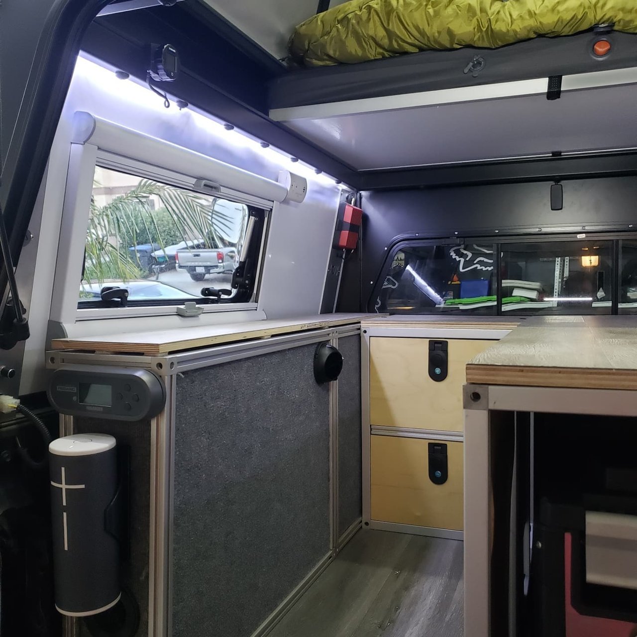

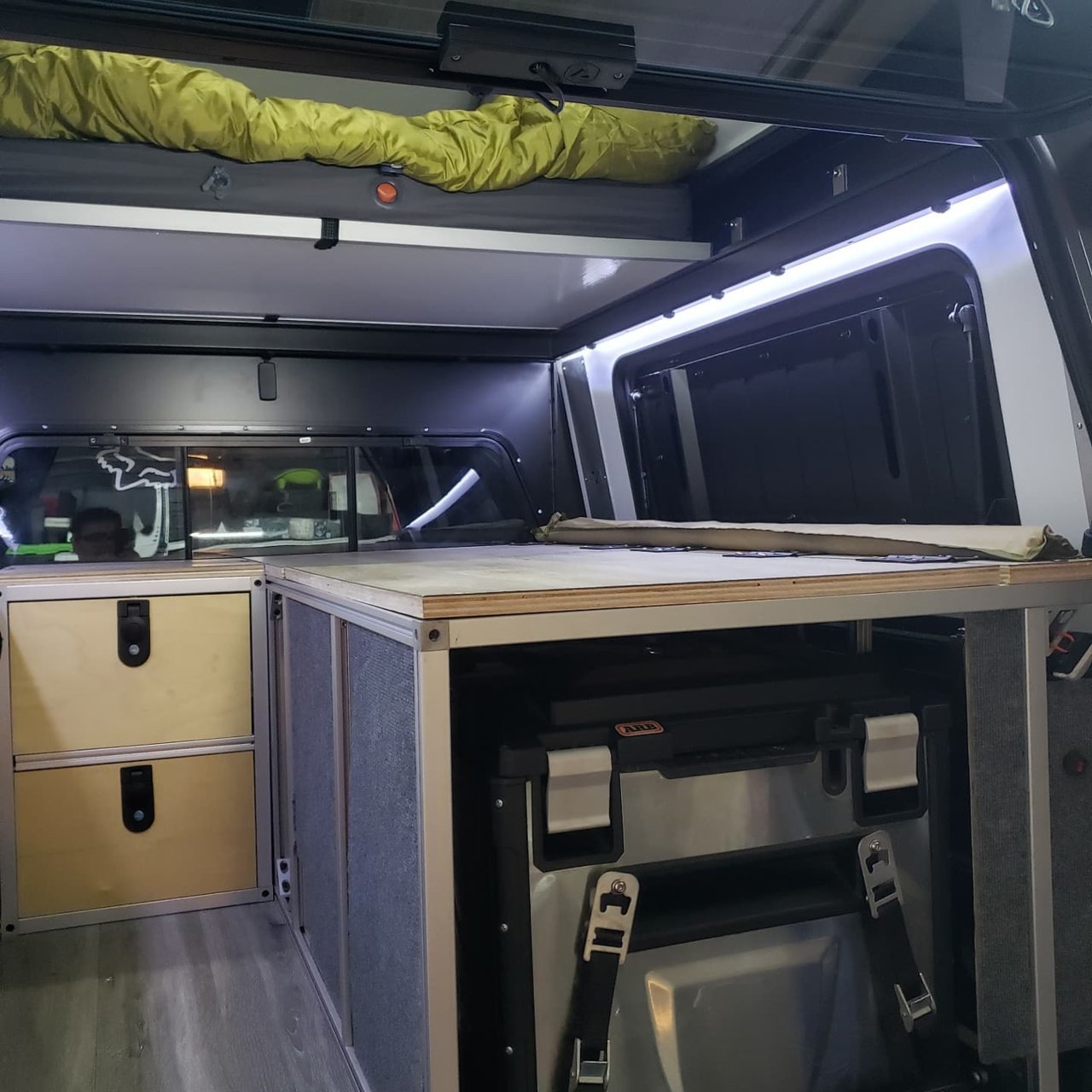

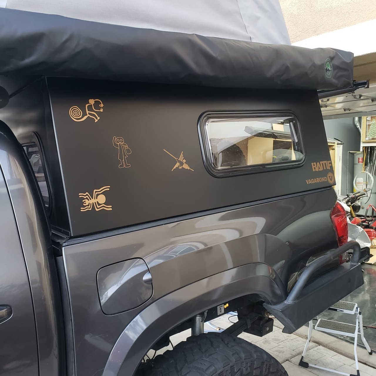

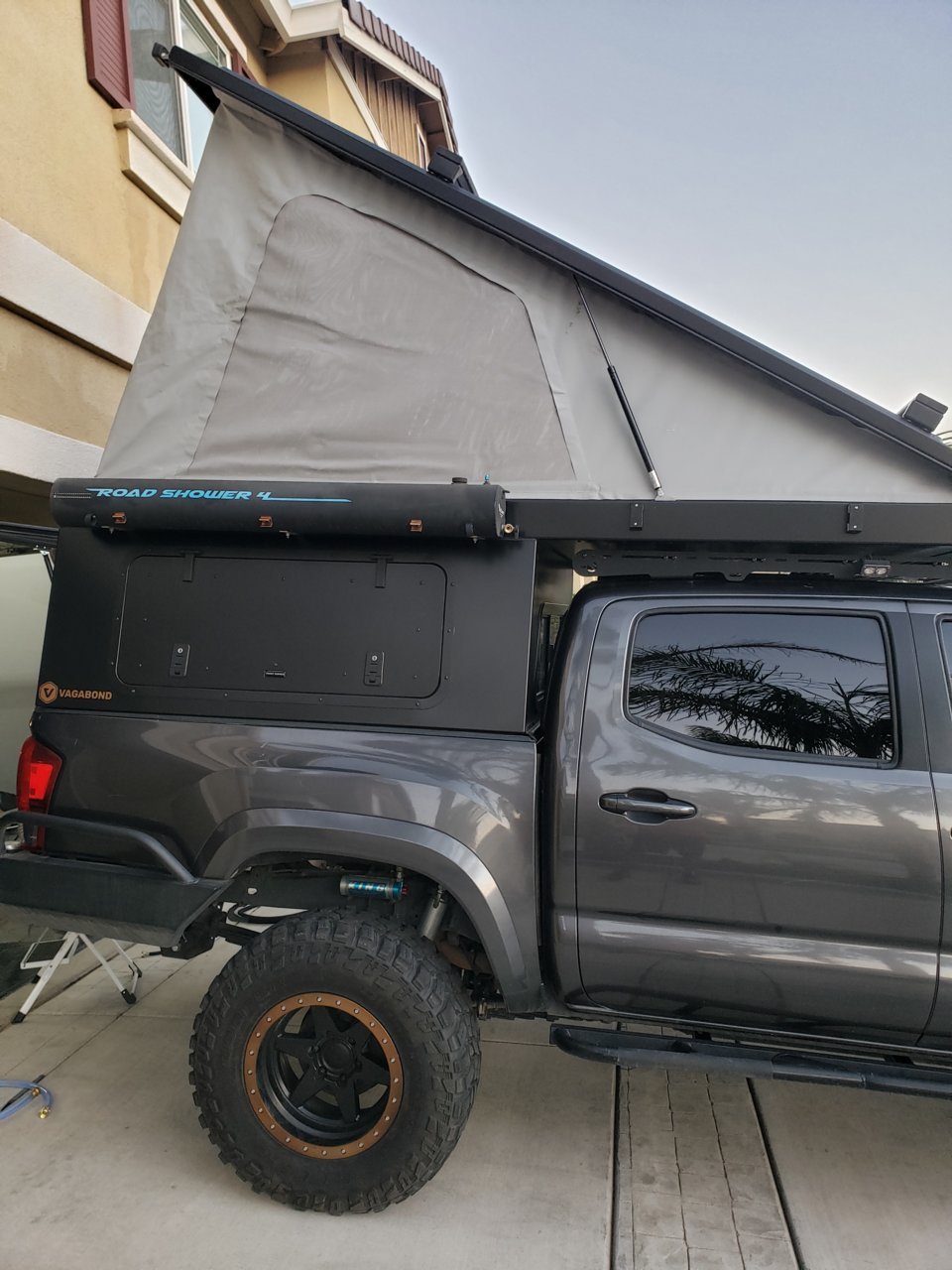

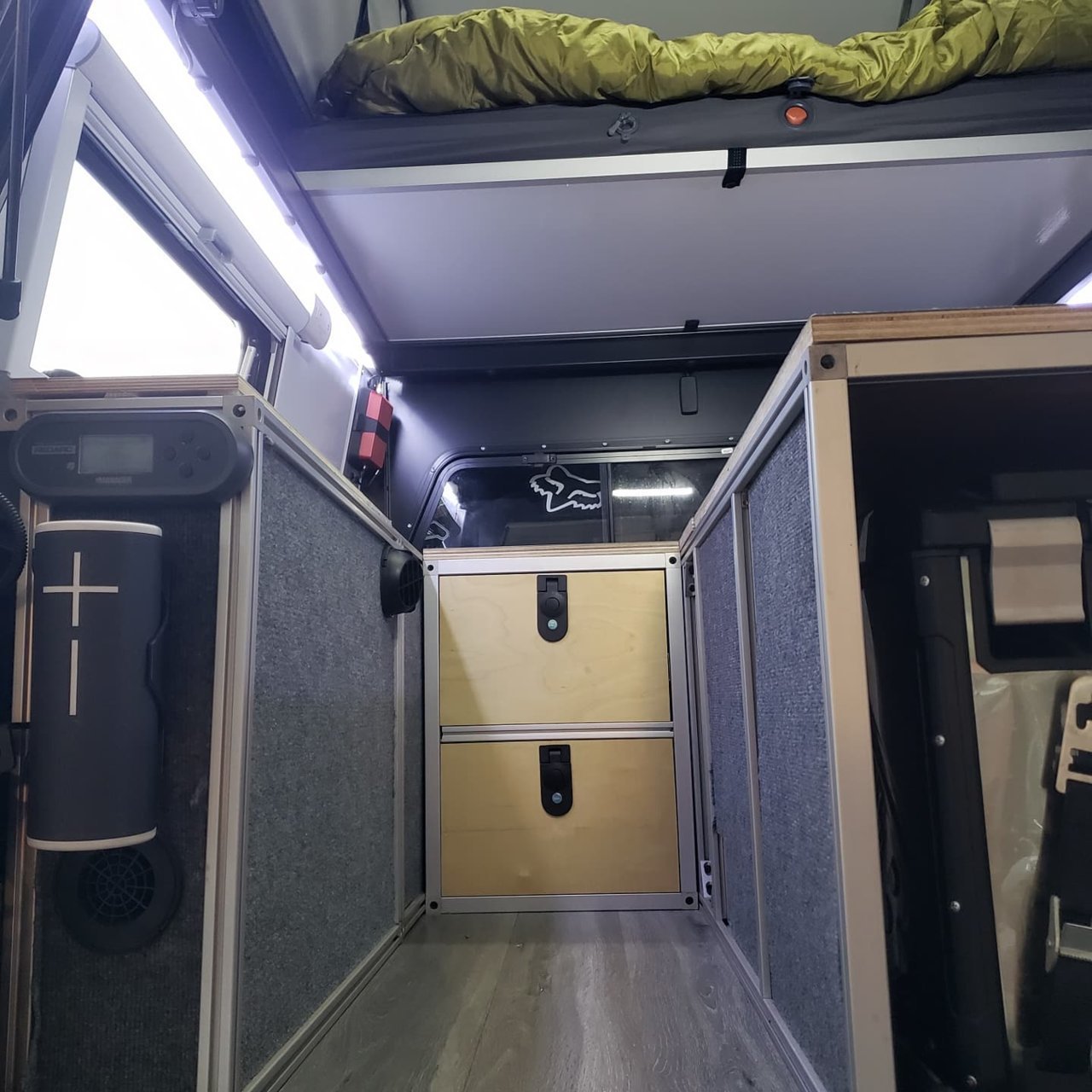

    It's been a while since my last post.... let's start with owning a drifter from @vagabond_outdoors is a game-changer, I don't know what I was thinking before, why did I wait this long? I liked my old setup but..this is something else. Set up time 4 secs, insulation, light, fan, etc. It was well worth the wait for it. Thank you @Overlanerd @MJonaGS32 @trdnugt and my homie Ricardo GreenApple for helping me with ideas and build #happycamper...about the decals: those are the Nazca lines from Peru (Google it) #CHIMPUN!!

    bad ass! :cheers:

    Looks sick. How do you like the megamat? Does it ever get annoying to fold back since it isn’t two pieces?

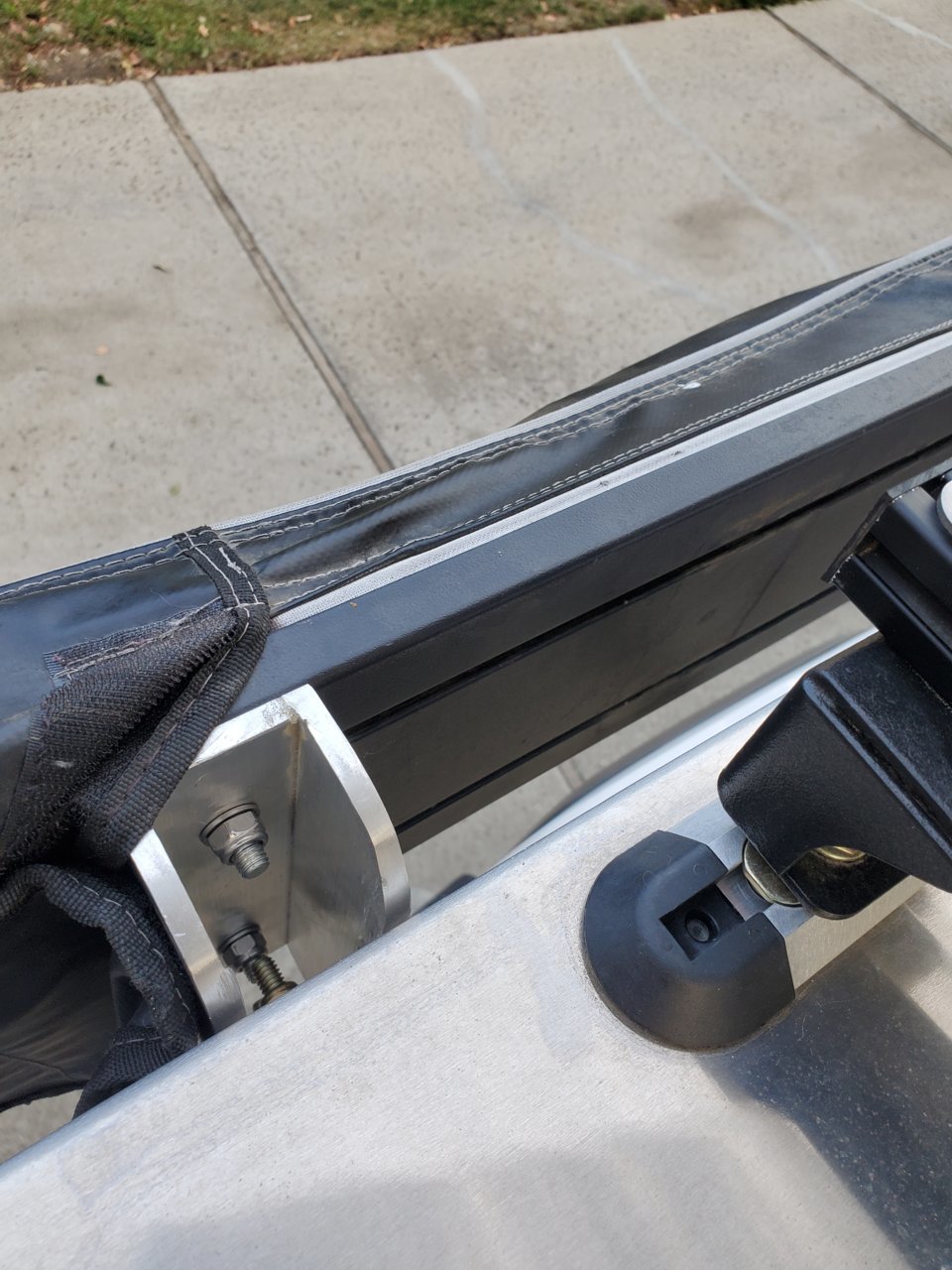

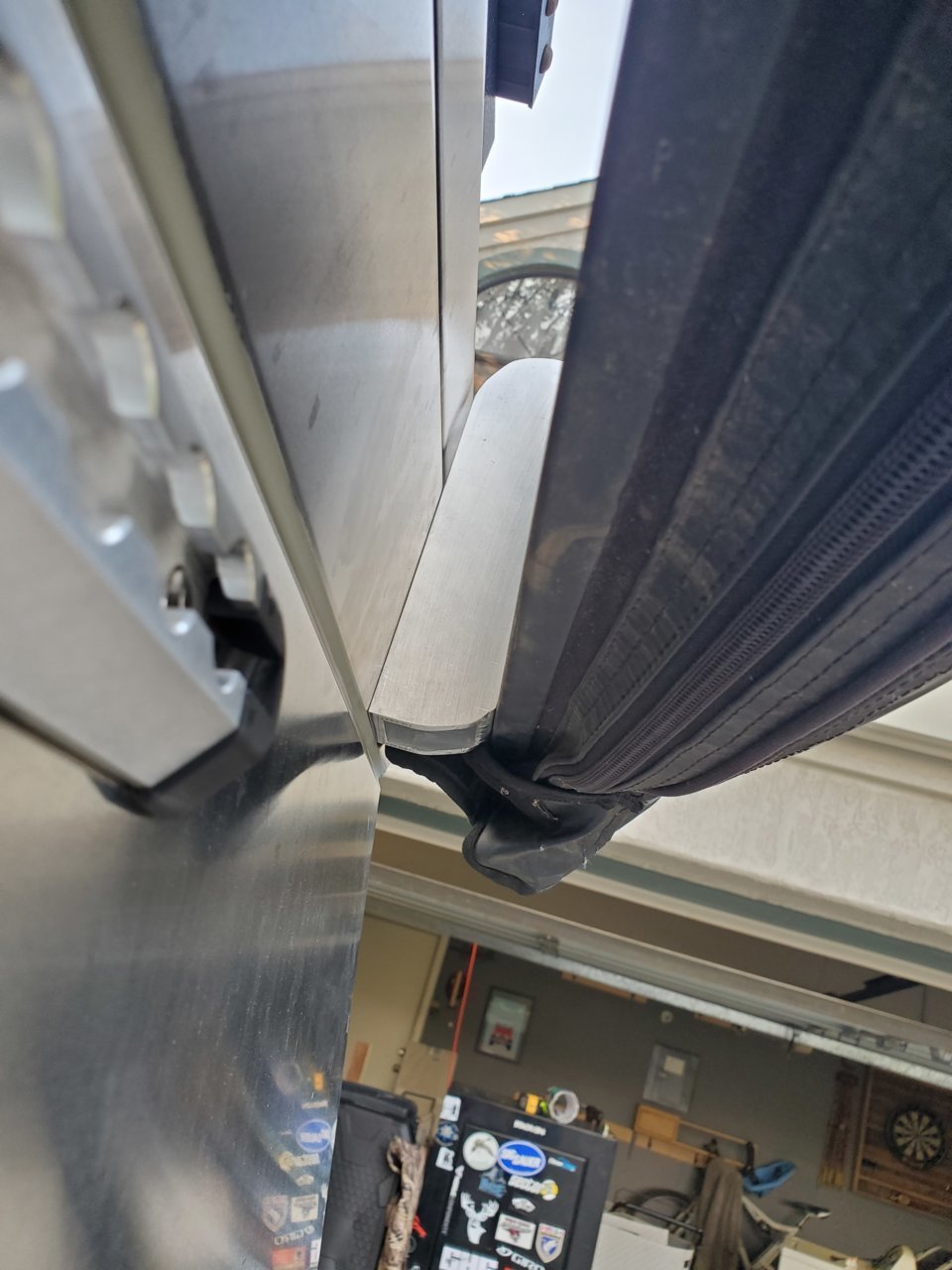

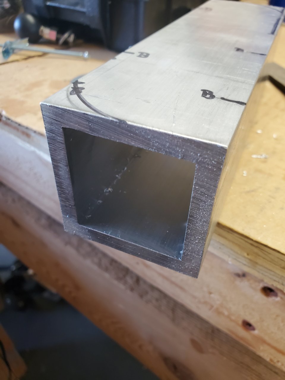

    A little crude but cheap, easy, awning mounts. Worked great on the most recent trip.20210809_160906.jpg 20210809_160926.jpg 20210915_080426.jpg 20210915_080437.jpg 20210918_113727.jpg
    Note to anyone making their own. Mount the rear one far enough forward so the bag closure at the back of a 270 has space.
