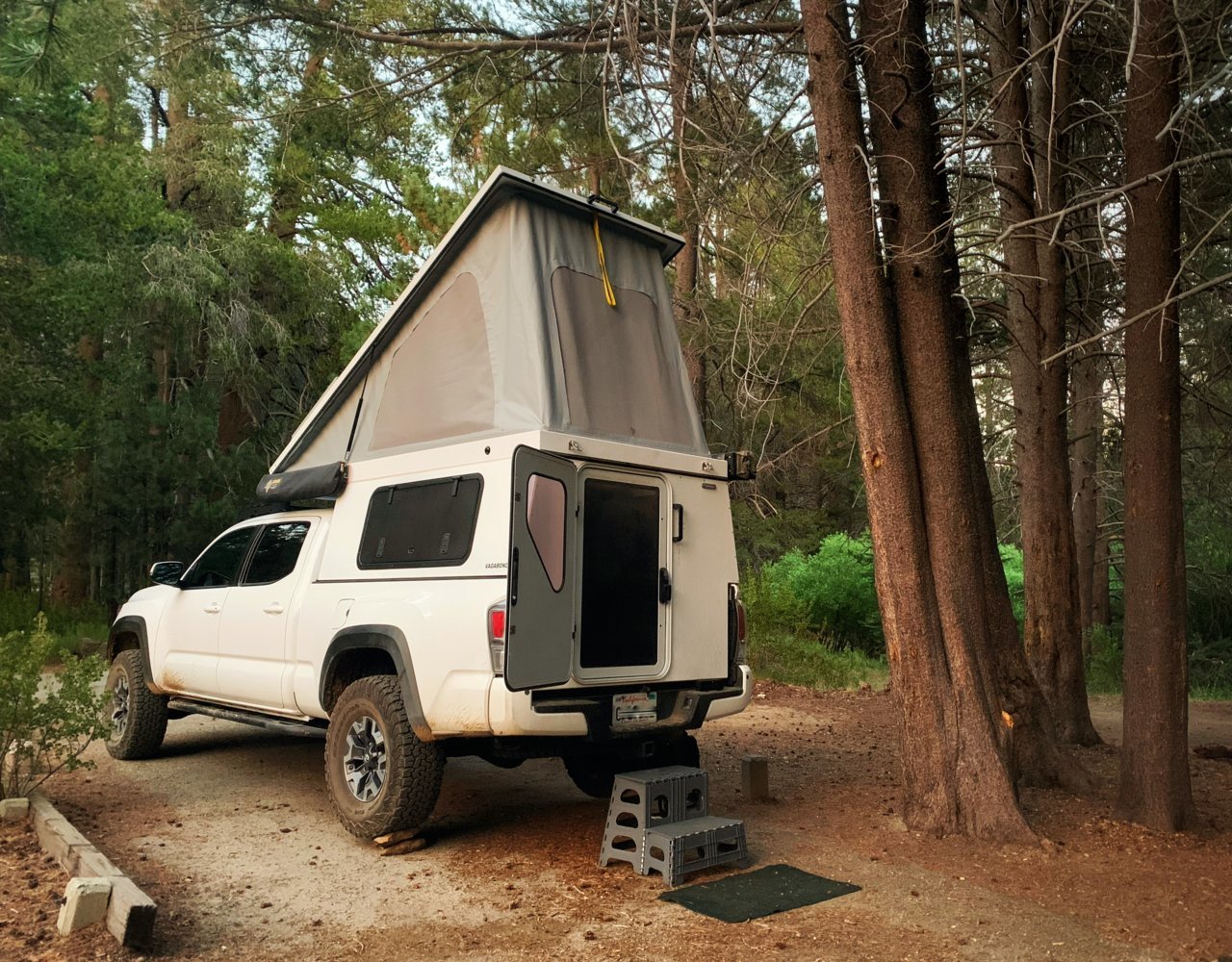

    How have you enjoyed having the tern back door? Do you find it blocks most air coming in (is it sealed well to the truck bed)? I'd love to see more pictures of it if you get the time!
  12. Sep 22, 2021 at 10:50 PM
    #5832
    jimlangfordphotography
    jimlangfordphotography Well-Known Member
    Dec 1, 2018
    #274423
    225
    2020 TRD OR LB
    512C854E-851D-4D47-BB15-4BD117FCA197.jpg Love the door, had to make adjustments to make it seal. Super easy to get in and out of. No crawling over the tailgate at night. The screen is killer! We’ve camped in some high heat lately and with the door, windows and hatches open and the fan running it sure helps. Don’t miss the tailgate or rear window. After sealing the back and adjusting the door I haven’t had much dust in the Drifter.

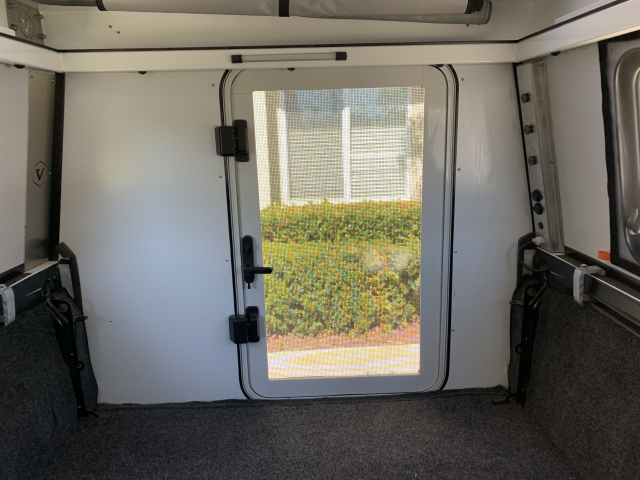

    Back locks with two dead bolts and very secure while traveling.

    Do you know if the door can be offset to the passenger side?

    I do not know. View from inside with screen closed.

    From what I've seen and know from photos posted, this is able to retrofit existing Drifters.
    The Arctic Tern door is tall enough such that what is currently 1/8" aluminum above the rear window will need to be cut into, so choose your door position wisely.

    Thank you for the extra pictures. Helps me make my choice!

    You can also retrofit later. It's a single piece of metal that is riveted to the existing Drifter body and a small piece cut out above the rear window so that the Arctic Tern door can fit since it's tall. (plus the sealing and attachment to where the tailgate was)
