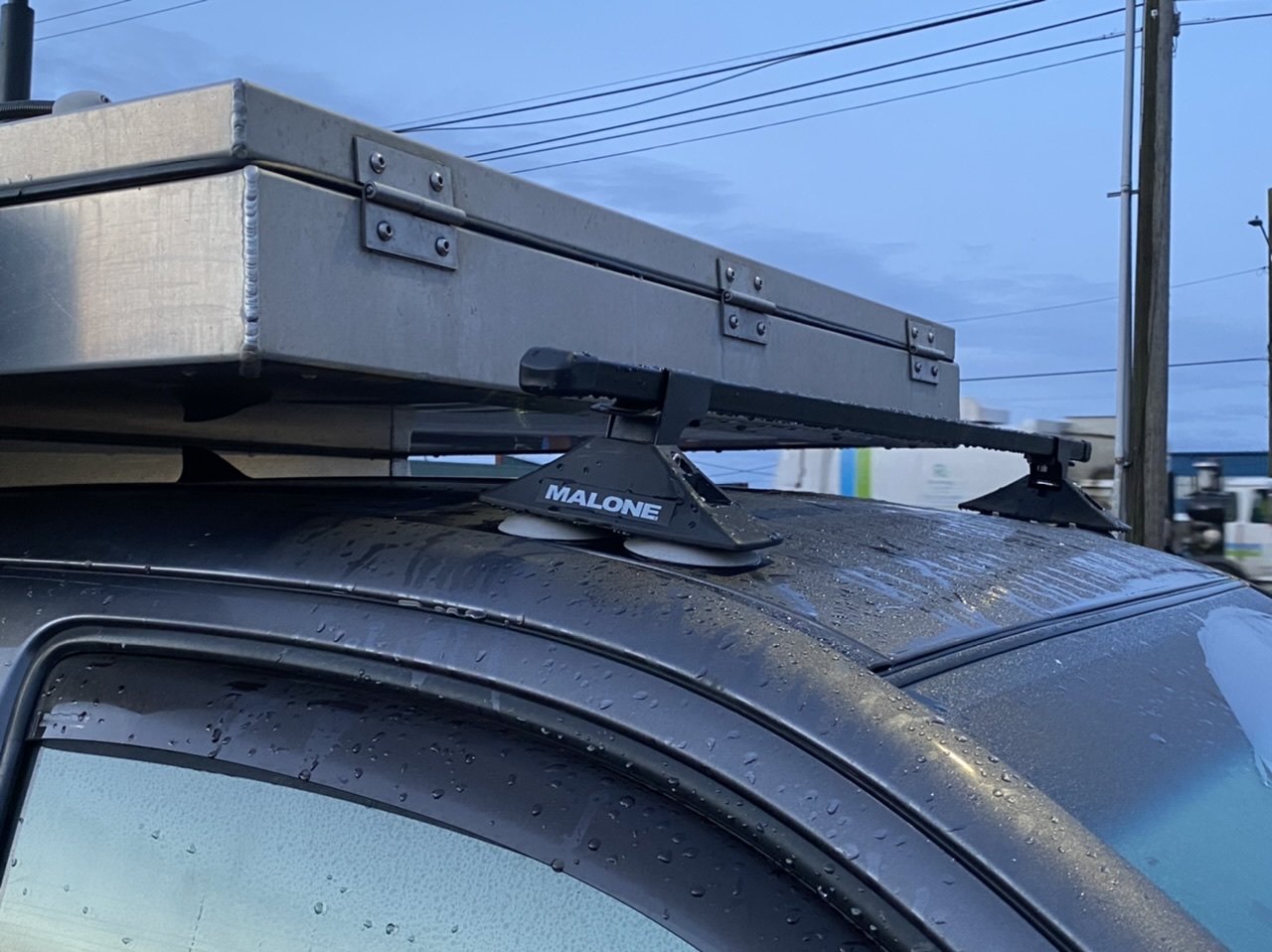

    I bought a set of suction-cup-mounted roof bars to hold a wind fairing (like the fairings made by Thule or Yakima.)
    We only need one, so I’m selling the second bar, $45 plus shipping from Seattle. The set cost $135 + tax on Amazon.

    Do you have a picture of the wind faring installed? I have the access cab and have found that there are no mounting nuts for racks on the access cab. I am curious to find out how the suction cups work. I hope they don’t lose suction in hot weather.

    My wind fairing comes on Wednesday. I am also an access cab, and the other rack options were way too expensive, incompatible with the roof or camper, or not desirable.
    If you install the suction cups in hot weather, they should hold in hot weather, of that temperature or cooler. Think of canning: the lids go on while the jars are hot, and the cooling of the jar causes considerable suction.
    It’s cold here in Seattle and they are holding fine, but I am planning to re-stick the rack when I drive to Mexico in a few weeks — or just heat everything with a heat gun to stick them hard beforehand.
    Another option is to fab or modify a fairing that works with the existing screws on the underside of the Drifter’s front edge. I decided not to do that because it requires leaving a gap under the fairing (or using a really flexible fairing) to account for frame flex. The suction cup rack seemed like the least work.
    Note my primary goal is to deflect air that is rammed down between the cab and front of the camper, which is where all the wind noise comes from. My partner needs to take phone calls on the road.

    You could always rivnut it... https://www.tacomaworld.com/threads/prinsu-access-cab-install.422290/

    Just the feet or crossbar as well?

    crossbar included
