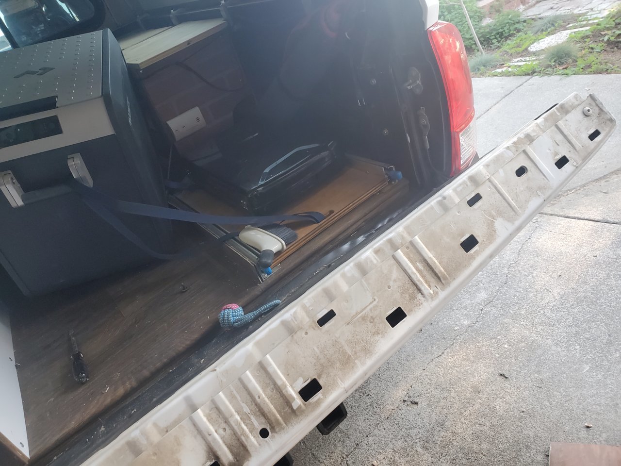

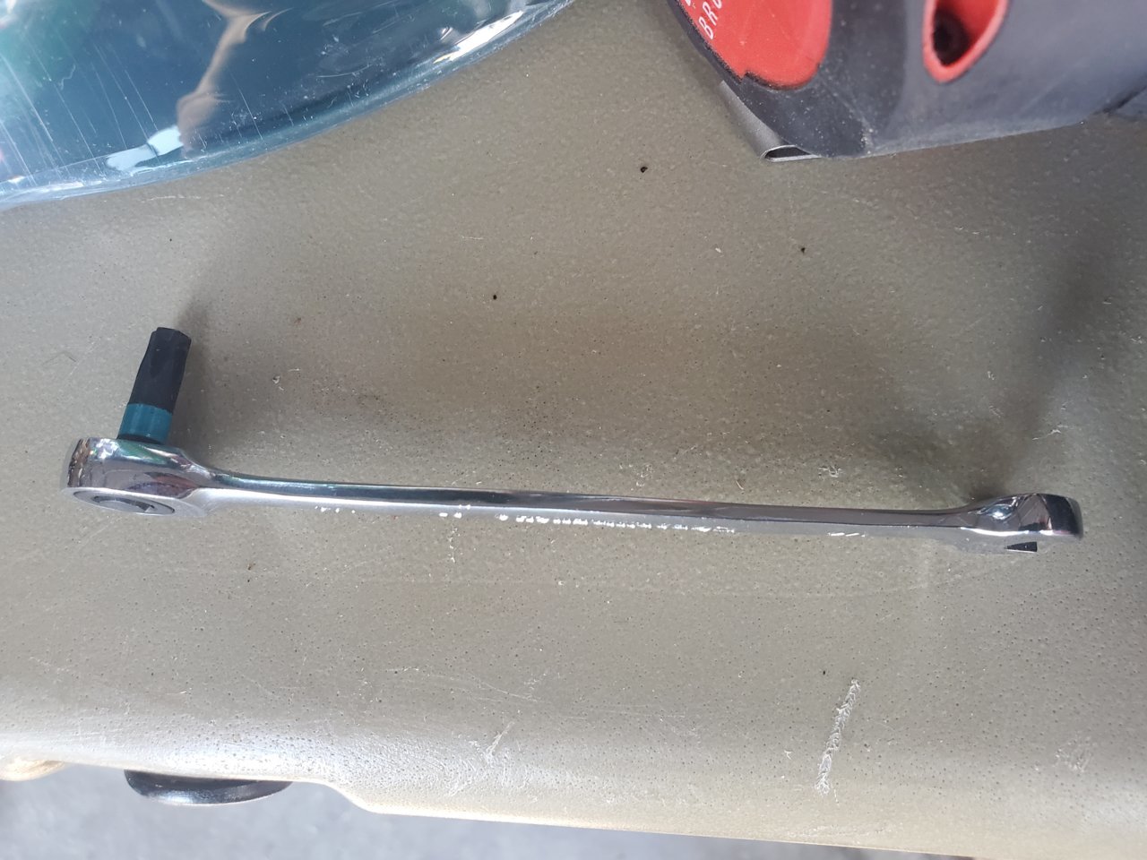

    If your PopNLock gets miss aligned and won't unlock..... the buildout really gets in the way.
    Got in with this torx bit ratcheting wrench combo and using a long screw driver to reach inside to actuate the lock after removing the tailgate cap.20211130_133234.jpg 20211130_133140.jpg

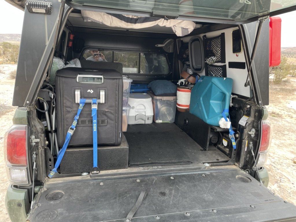

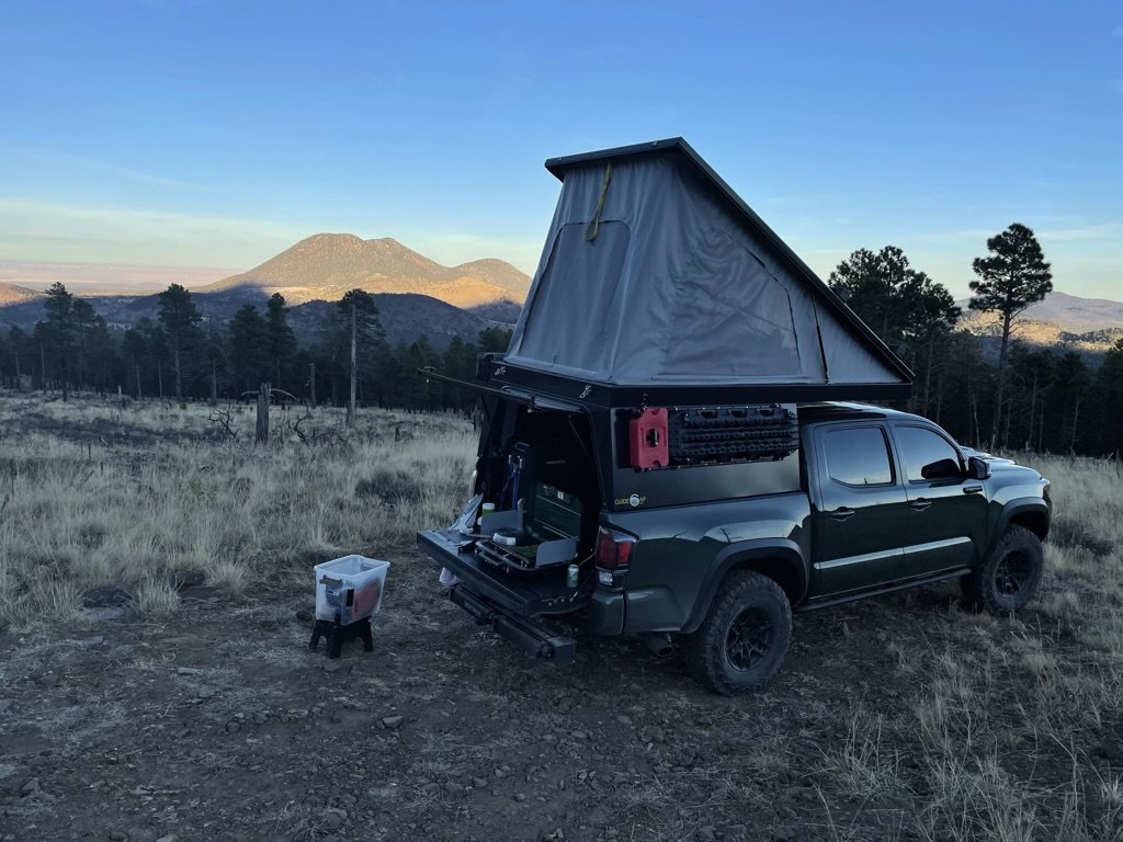

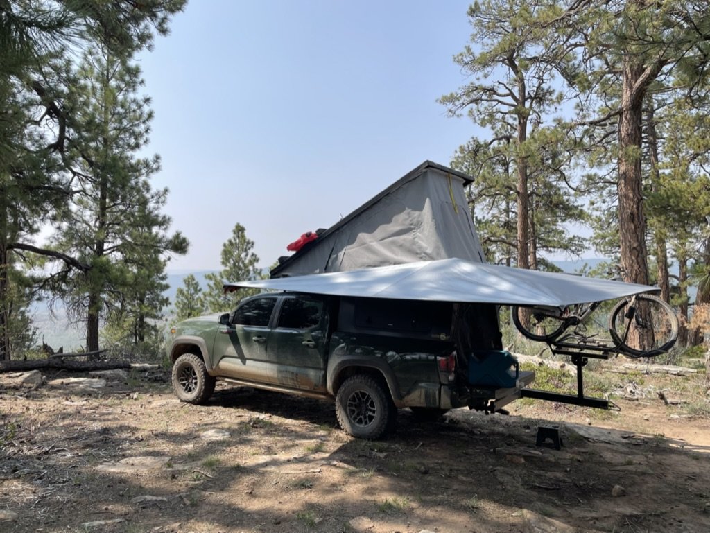

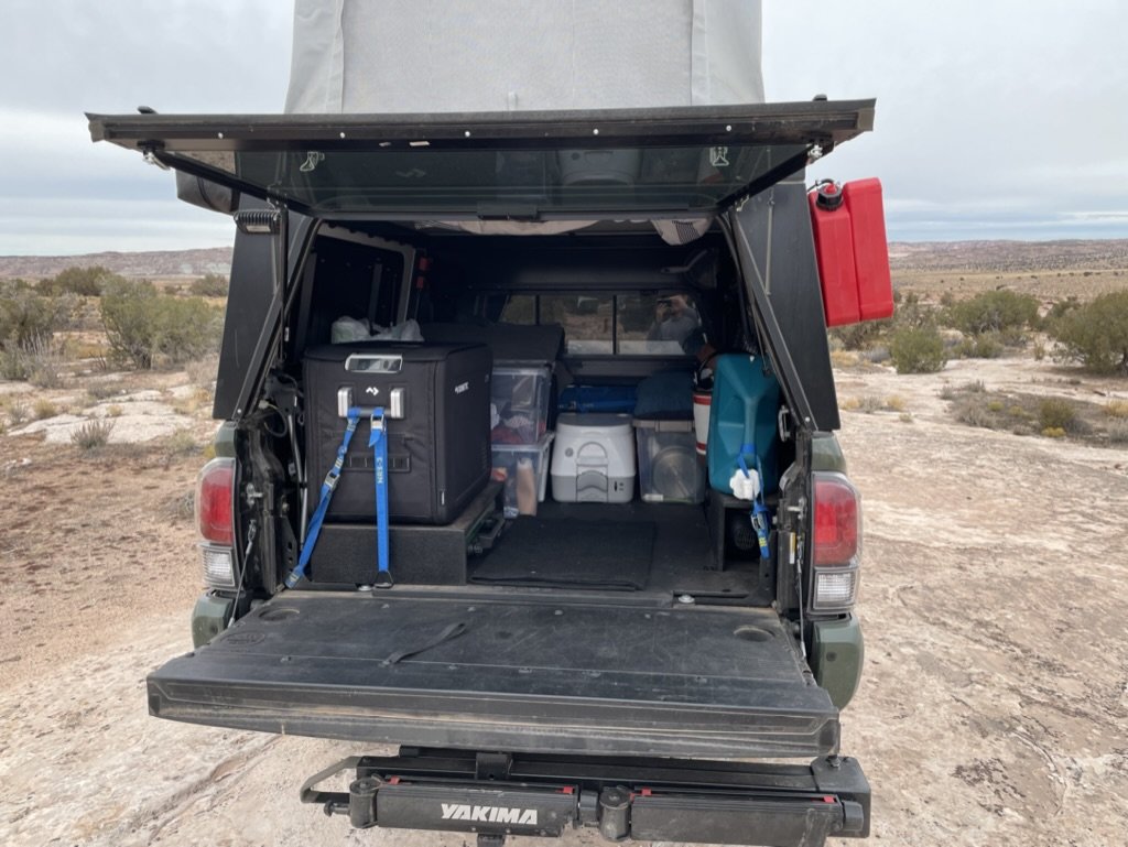

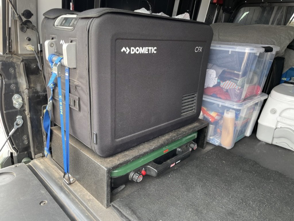

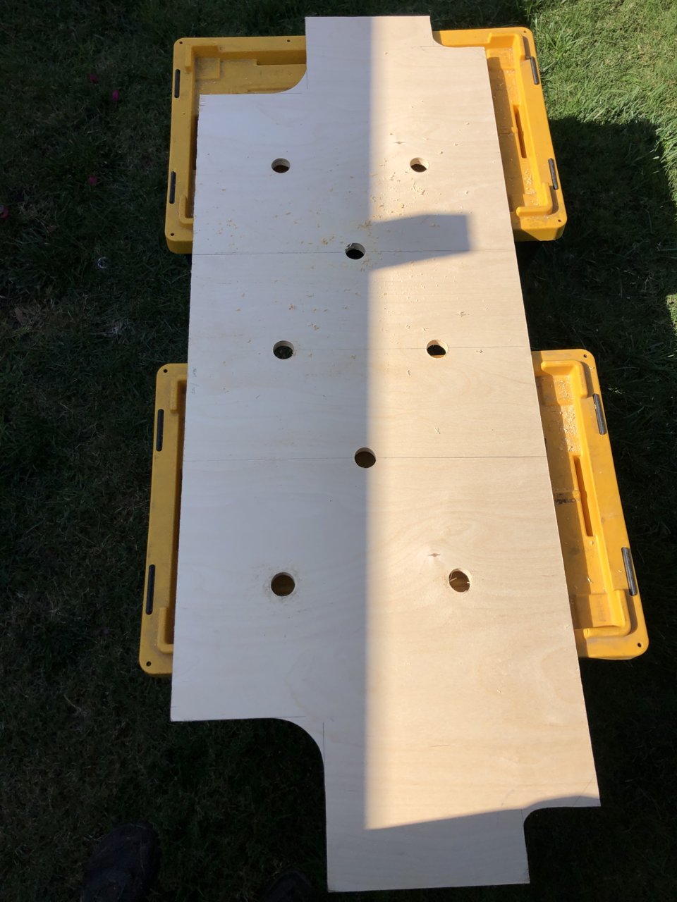

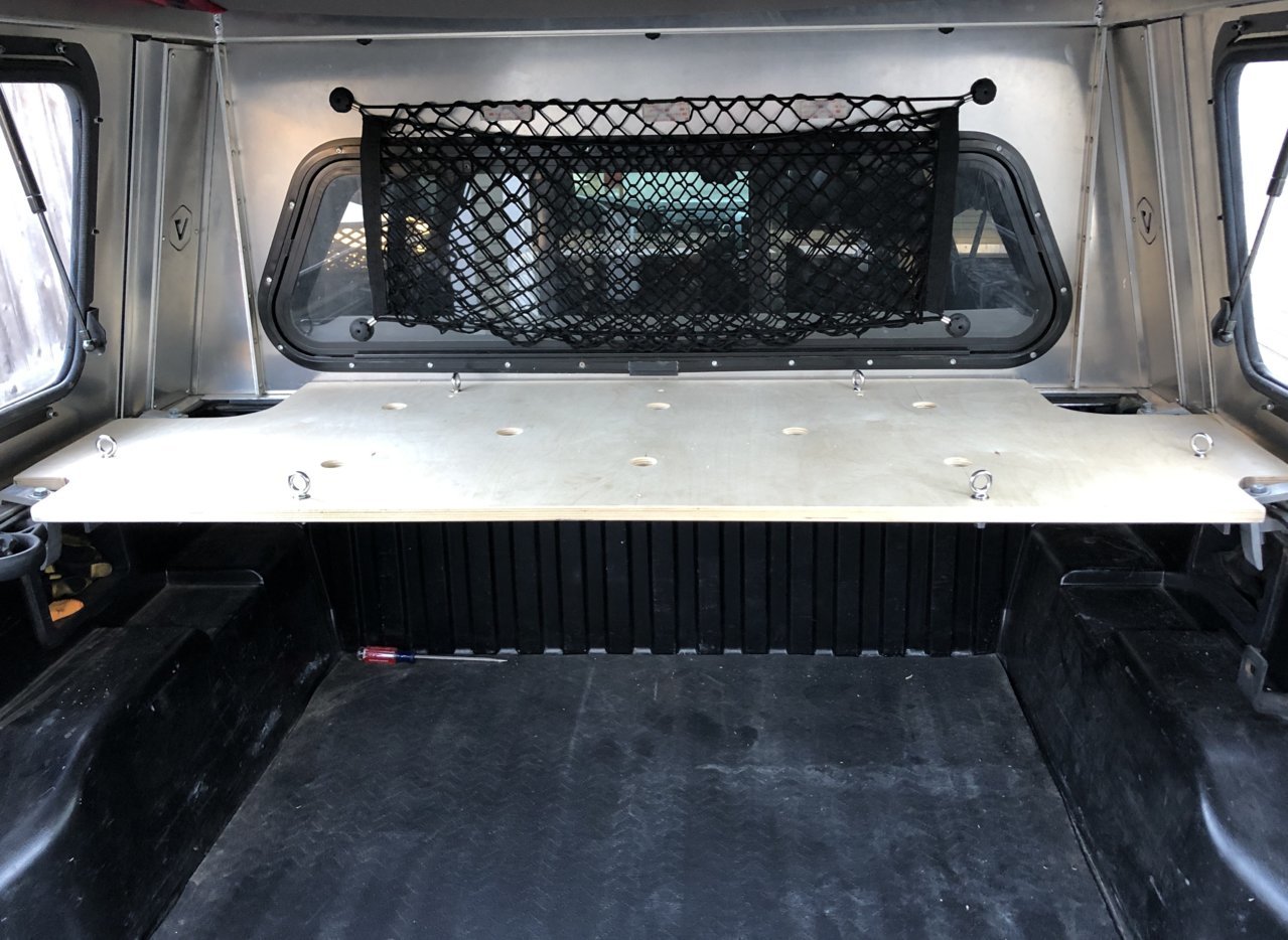

    Hey All,
    It's been a while since I posted but since then I've been working on the Drifter slowly trying to figure out how to make it better all the time. I live in an apartment so I don't have many tools which limits what I can do. O, I really don't have much craftsmanship ability. I'm actually working on an indoor/shower which I'll give you all updates on.
    My build will reflect my limited craftmanship ability but damn it is all very functional. I've spend 100+ nights in this thing already. Enjoy
    1) Must do!!! Upgraded bed to a Hest full size bed. Night and day difference that still allows you to easily close the drifter. https://hest.com/products/dually Thank you @badasbrunnette for the suggestion. Its $$ but it solves everything bed wise. Get the long
    2) Webasto heater install! I went with a Webasto diesel heater. I went with diesel over gas because it handles altitude better. If I could do it again I would probably go propex but I just didn't want to cut holes into my truck except at the spots I could easily replace. I have an external diesel reservoir on the outside mounted by my maxtrax. In the photos you'l see a rotopax on the outside of my truck, that is connected to my heater. It works great but even though I have the insulation and tent insulation package really... on super cold 10's and below the truck does not keep heat in well. However the heater just runs all night and I sleep with a blanket and shorts. There is a lot to setting the altitude adjustment on these things and sadly I know one day it'll need to be cleaned but yea. I do a lot of things in the winter and this was a must after struggling with the buddy heater for a winter.

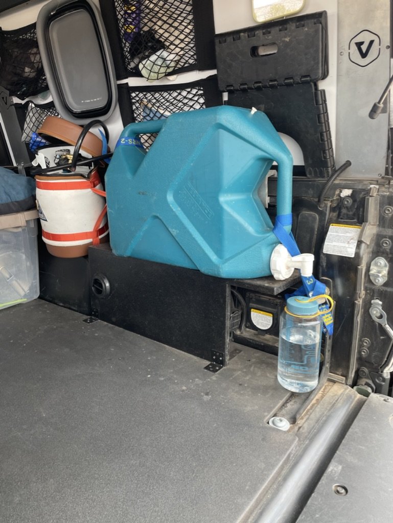

    3) Shelving - dang this helped really clean up the truck and now allows 4 people to sit in it if we need to. The shelving that protects my webasto acts as a shelf for water. The nice thing about this is I can fill my nalgenes now without having to move a container to fill the water bottle. It's just a spout, put water under and fill up. The other shelf under my fridge stores my stove. It's a big stove but at one point I lived out of my jeep and have grown to love the stove real-estate. For everyone asking if they should get a stove slide out... I opted not to. I use strawfoots bug net in the summer and that would make a slide out difficult. Additionally, since I have a frontrunner door I can easily access it from that so no need for a slide out. This also allowed me to store a water rotopax between the frontrunner door and the fridge. So now, my water jug stays just to fill bottles and then I use the rotopax water container when I want to wash my face outside of the truck or have any outside water needs. I just grab and take it out from the frontrunner door. I put a gowesty water spout on the rotopax that works great.
    4) Velcro shelves - $12 for two should have done this before

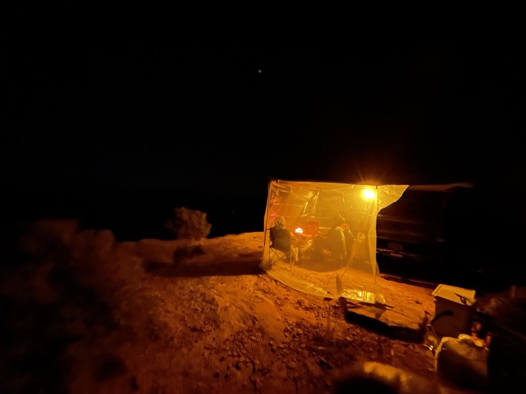

    5) 270 Awning I finally got to try my plastic heat trapper for large groups. It worked great with my propane heater
    6) I strapped all my heavy shit down. Goalzero, fridge, water jug. Nothing moves when I off road now.
    O and I still love my toilet.
    It's been a slow, never ending process. This week I'm beefing up the insulation which I'll share.
    Also I'm putting in an indoor/outdoor shower but simple style. Geyser water shower, and just purchased an xplr shower. http://xplroutfitters.com/accessories.html
    I'll pair that with a https://www.amazon.com/dp/B07HS7GRSX/?coliid=I12JJK9TT8629U&colid=39PDFHOM5XIKQ&ref_=lv_ov_lig_dp_it. and https://www.amazon.com/dp/B07GZ9BXTG/?coliid=IU6WT3QZEQ0W5&colid=39PDFHOM5XIKQ&ref_=lv_ov_lig_dp_it I have an indoor outdoor shower. For outdoors I'll just hook it up to the 270 awning. I usually shower in gyms/rec centers/rivers but a heated shower was always a nice thought so I'm giving it a try for the times a gym is not available.
    My next and most difficult project is to make storage and a bench toward the cab section. I'm still trying to figure out the perfect set up for that.
    Drifter still works amazingly I've logged over 300 off road miles to it. Still holding up like a champ.
    Cheers all and thank you for all the ideas!

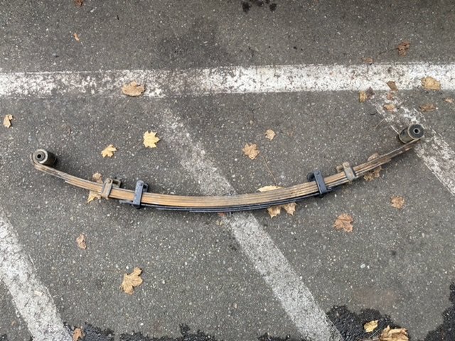

    Partial list: Vagabond Drifter OR rear axle 4.10 gears Bilstein 6112s and B110s. Dakars with OL leafs replaced by Deaver 3-leaf AALs 265/75/16 Ultraterrains eBay front bumper (I hit a deer and needed a fast cheap replacement) 3rd Gen TRD Pro clone skid
    Here is another possible (budget) option for your rear suspension:
    I bought some old used Dakars and replaced the overload springs with 3-leaf progressive AAL’s. I spent $300 total, and got a fully progressive pack without the harsh ride of overloads. Poor man’s RXT’s?
    I get 2.5 inches lift in rear with a fully spec’d, lightly loaded Drifter. This gives me plenty of room for a heavier buildout, the option to remove the third spring for a more level ride, or install the OME AAL for more support.
    The ride quality is both supportive and pleasingly smooth, due to having no overloads.
    The rake in the lower photo is due to currently having only 1.25 inches lift in the front. 265/75/16s.
    (Related question: How many people are running 600lb. springs instead of 700lb. springs in front? I bought some 700lb. springs but I enjoy the ride quality of the 600s well enough, and am ambivalent about upgrading. No anti-sway bar installed.)
