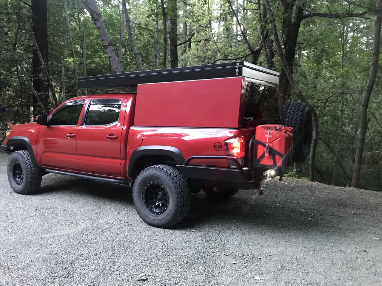

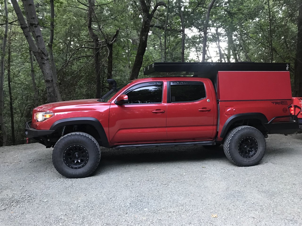

    Drifter....ARRIVED!
    tdubd - Thanks for sharing. What rail system do you have on there? Is that L-track? What crossbars are you using and how did you attach them? Thanks! -C

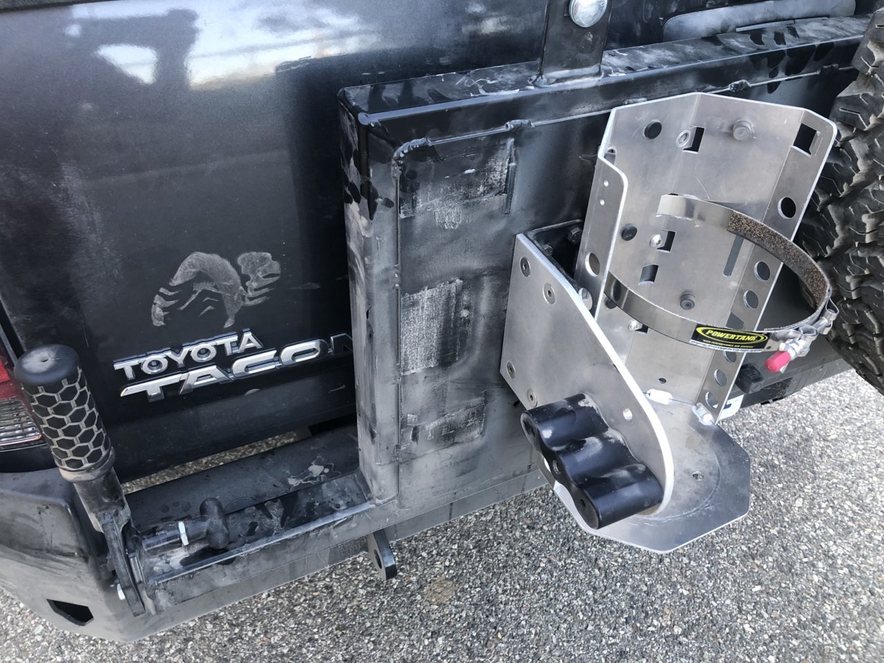

    Nice dude! I just saw your photo in the specs thread, I am actually re configuring my swing out to rotate the two rotopax 90 degrees outward to fit my propane tank next to the tire. Looks like that's what you did as well. or maybe that's CO2

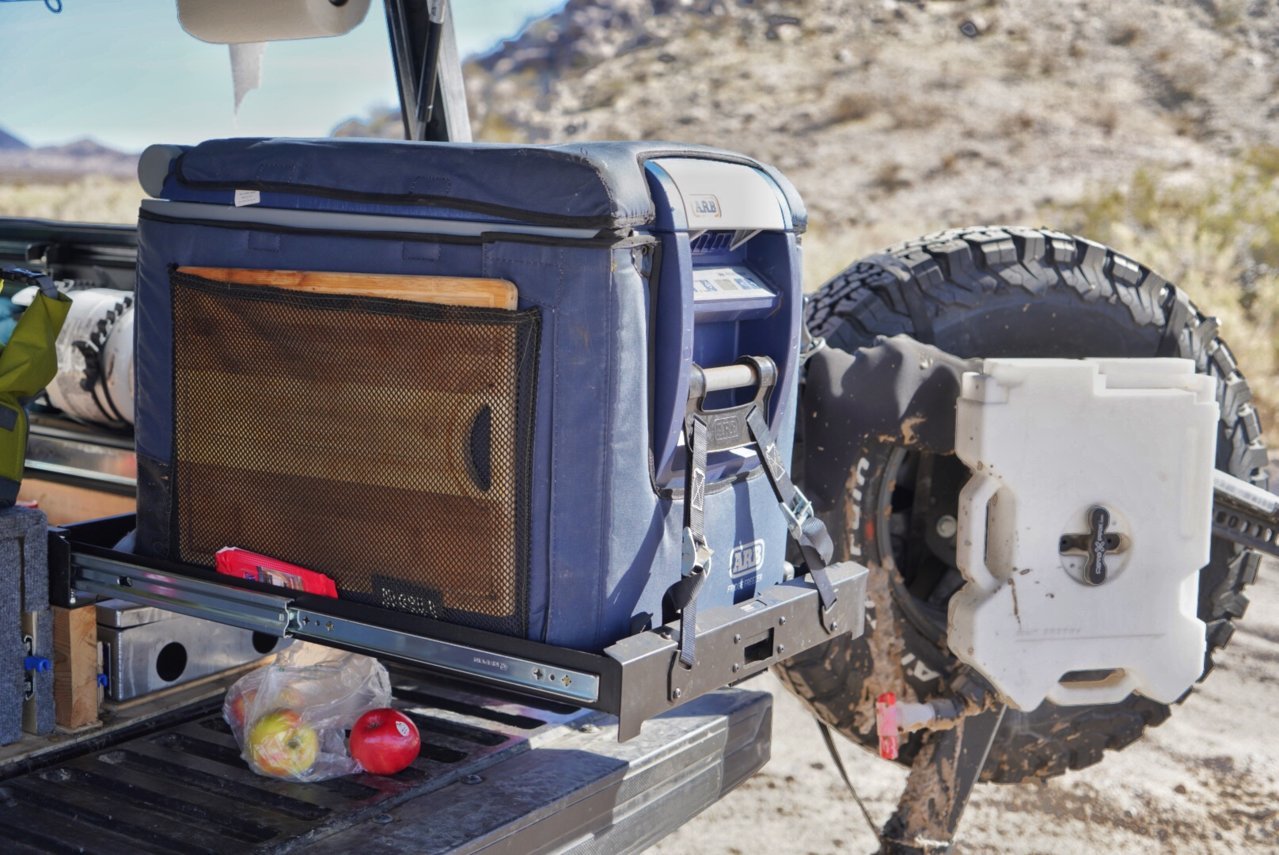

    Thanks man! It's a 6lb propane. I also made a stronger bracket to hold the rotopax, which was positioned to make use of this. The spout stays nicely protected when the swing out is closed.

    Nice! Looks good, I have the bracket to rotate mine outward already made up. Just need to drill everything out and boltnit up now. I have a 2.5 gl fuel and black storage pack I keep on the swing out. But I have 2 2.5 waterpax mounted on L track on the passenger side.
    I looked at that little spigot from Go Westy (I really just want the aluminum collar) but I am going to make a hose attachment to gravity feed to a spray handle. I’ve been kicking around the ideas of adding an inline hand pump bulb to see if it would prime the rotopax long enough to get some more pressure.
    You have a straight on photo of the back?

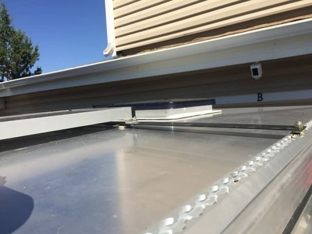

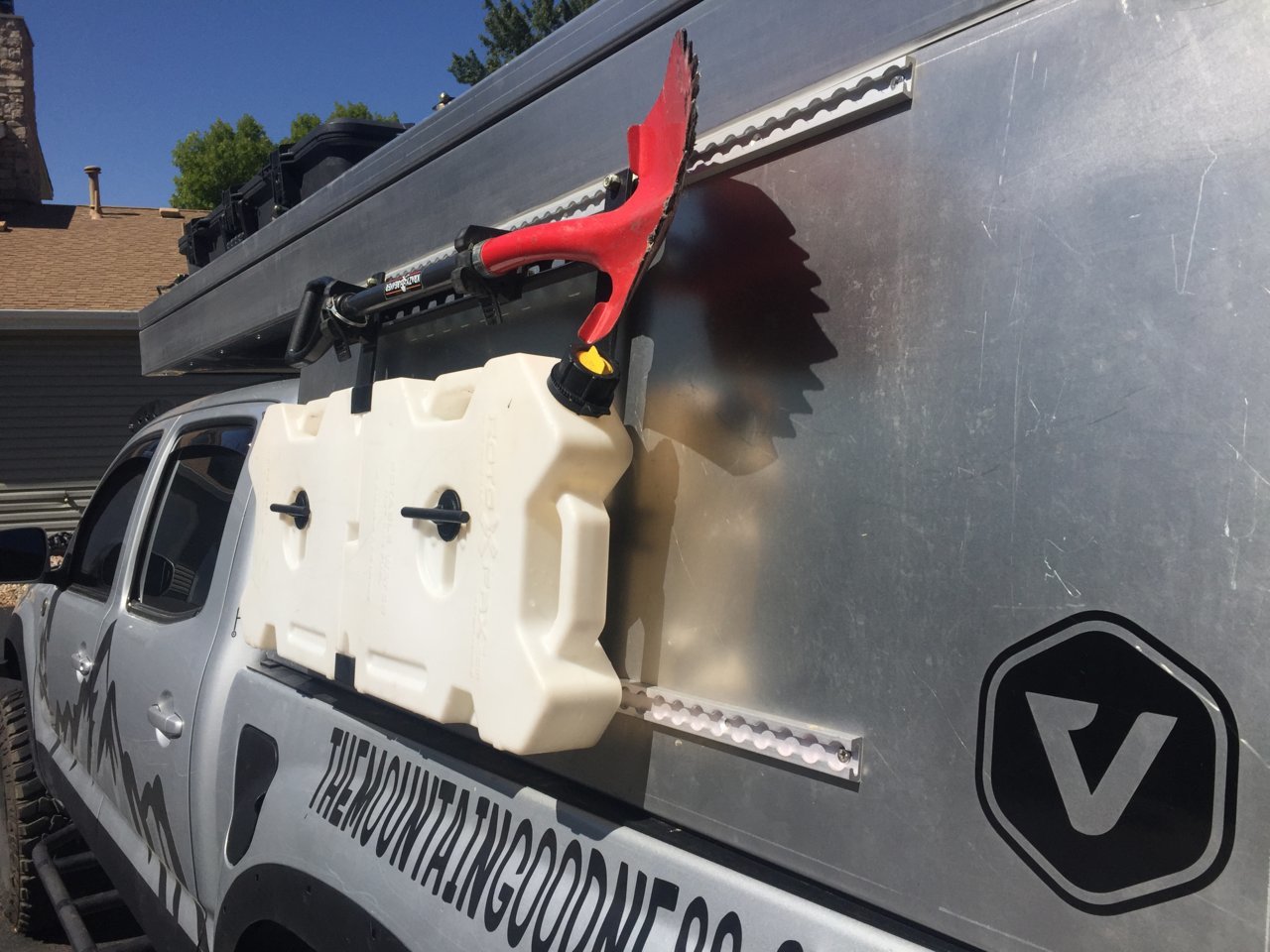

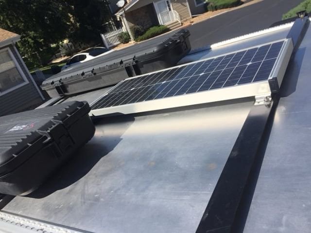

    I have L track mounted on the roof and also 2 strips on the drivers side. I just took some flat stock to run across. Then drilled a couple holes in my Plano boxes, ran the bolts up through so with nylocks on the inside of the box so they can't be stolen. Siliconed everything so its sealed. Here is what the roof and side look like. The side, I mounted some half strut so that way I have the versatility of mounting whatever I want there.

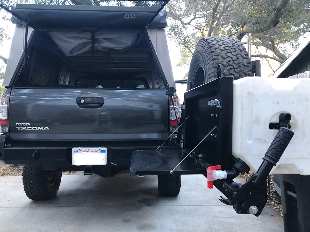

    Sounds cool! Yeah water is a bit slow coming out (due to it having to ventilate itself from the nozzle), but it works for drinking/cooking.
    Here is a shot of the mount. It’s aluminum, but some heftier angled steel behind it. Make sure to drill for departure angle and don’t line up to the swing arm.
    This trip I didn’t need gas, but eventually will do a dual 4 gallon flat against the spare.
