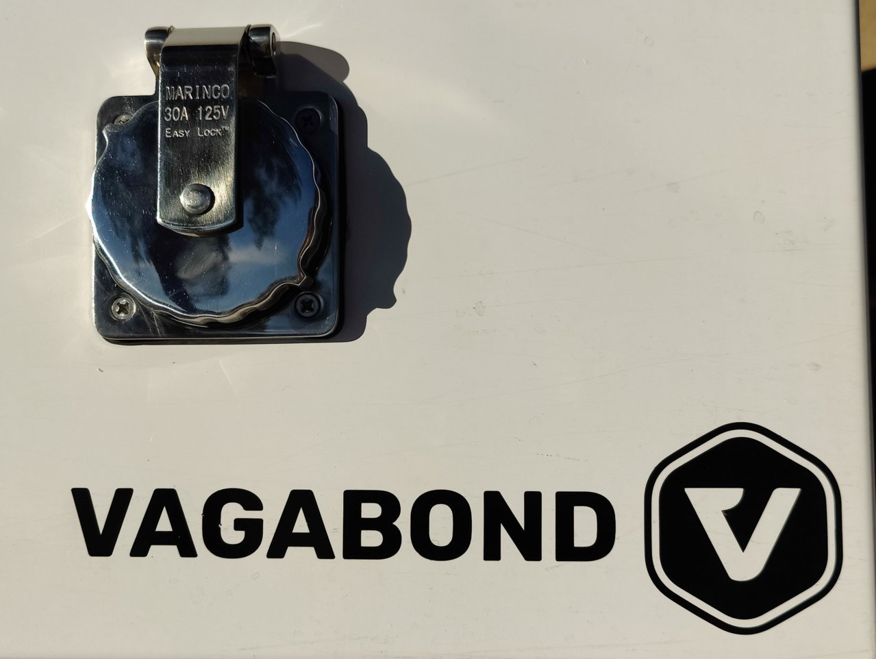

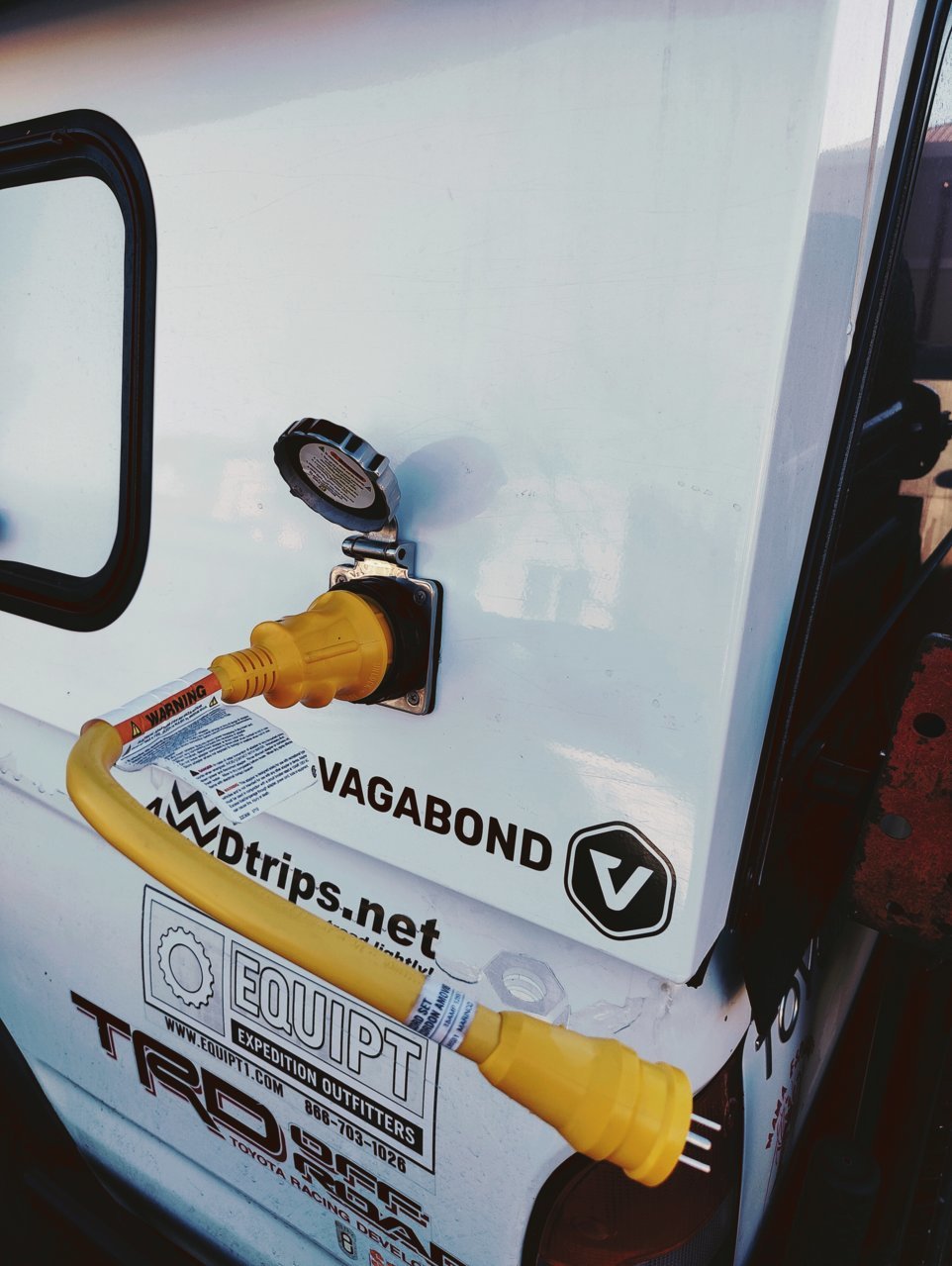

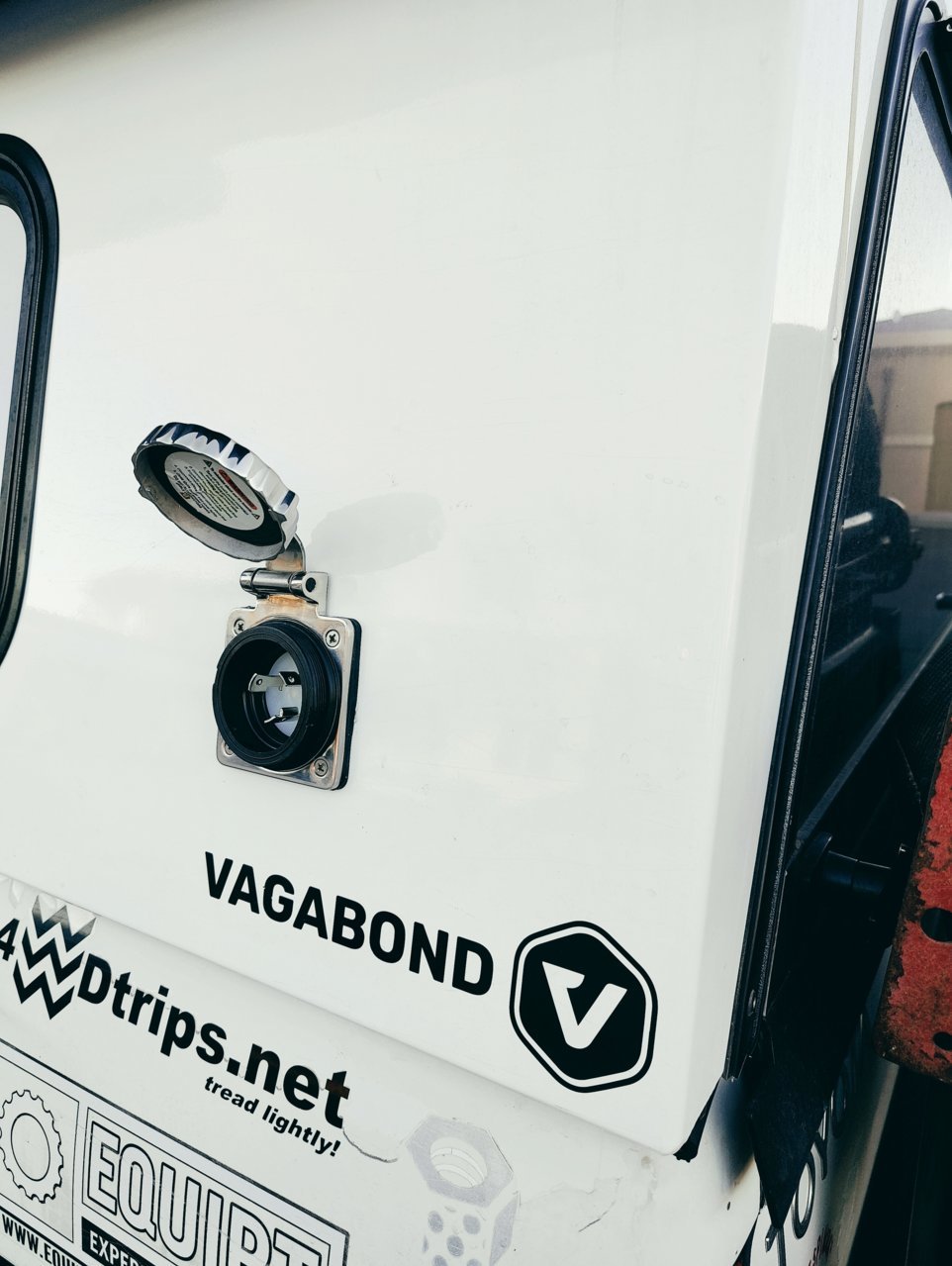

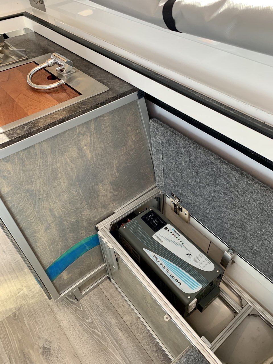

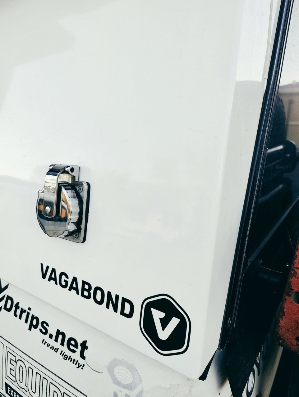

    Another item checked off the list...
    Shore Power

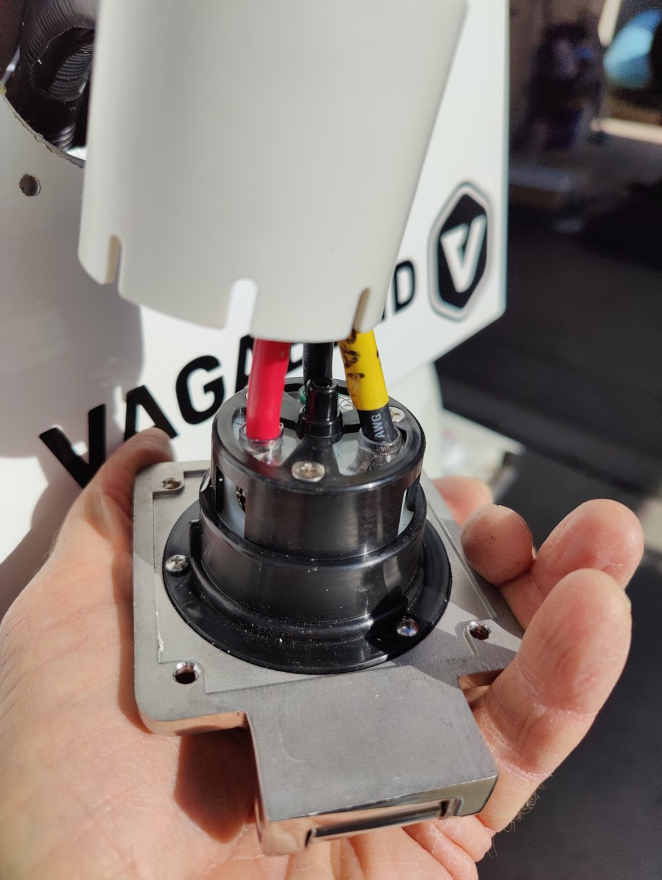

    Marinco 30A 120V AC receptacle, stainless steel with weather-tight seal. Marinco pigtail adapter with threaded positive-locking weather-sealed connection and LED status. It won't come loose (the only flames I want to see in the camper are from the fireplace). This allows me to plug the truck into 120V AC power and is connected to the Renogy inverter / charger so it will automatically charge the starting and auxiliary battery, and allow any loads to be run in the truck and camper without using up the battery reserve.
    IMG_20220110_094714__01.jpg IMG_20220110_074706__01.jpg IMG_20220110_074656__01.jpg

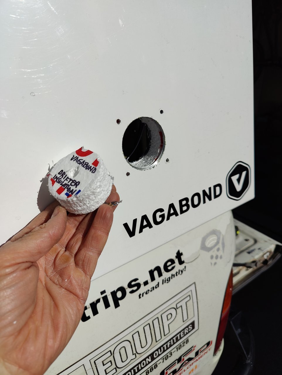

    Insulation sample; just to show what's inside an insulated Drifter.
