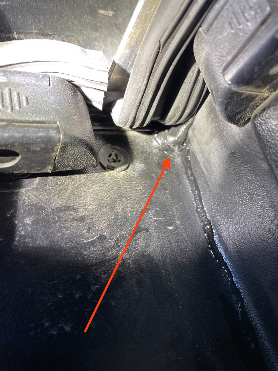

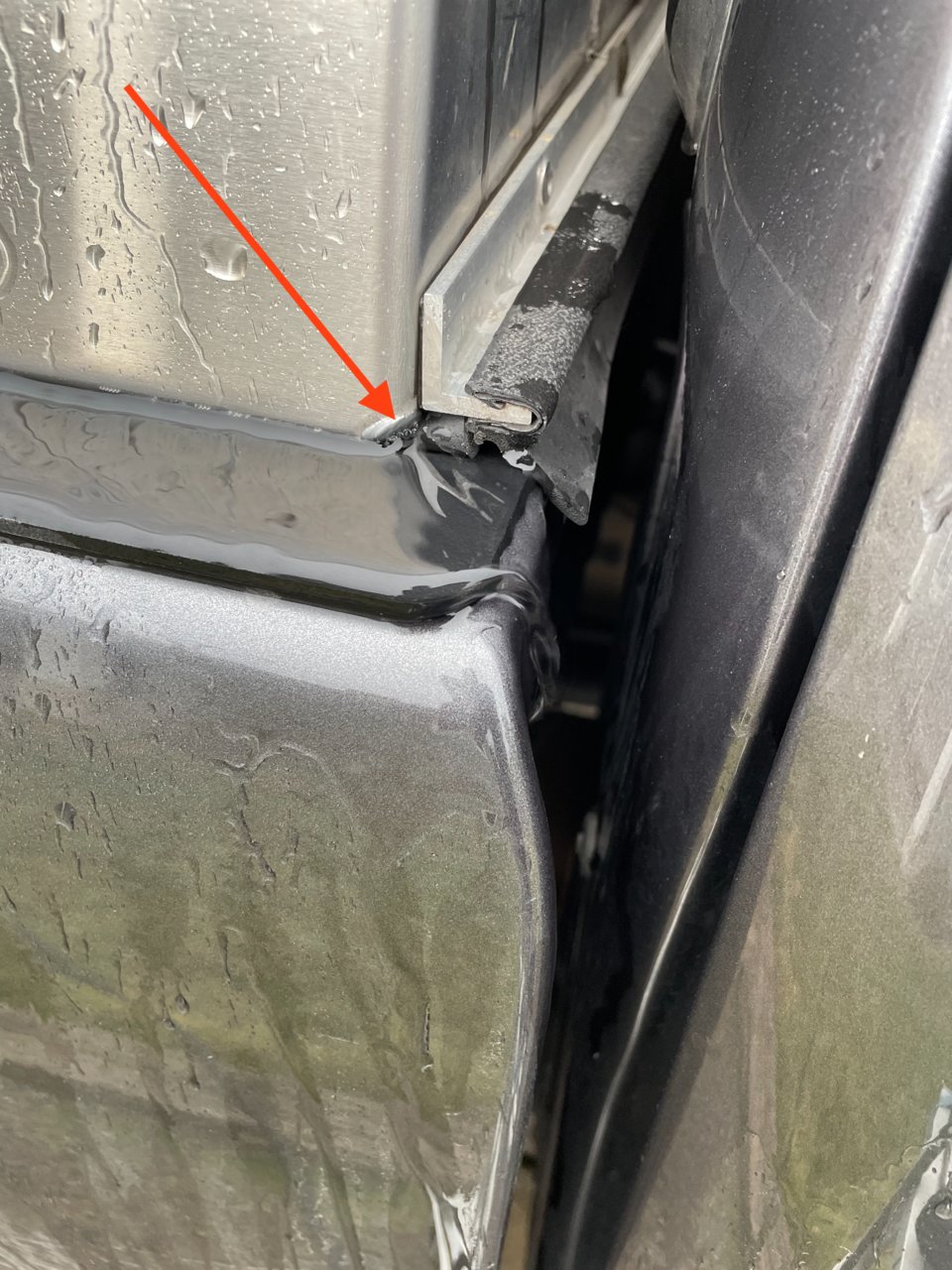

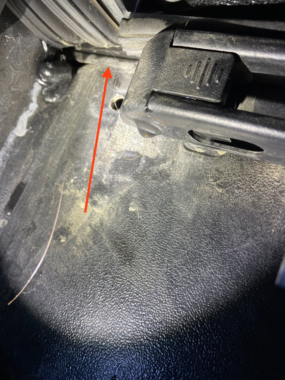

    Does Anyone Have 100% Dry Front Corners?
    Have you found a way to 100% seal the front corners of the Drifter / Bedrail Cap? If so, how did you achieve this?
    I have had my Drifter for 2 years now, and thought I didn't have any leaks. I have had a BedRug installed the entire time, and never found any wet spots, even at the front two corners (near the cab). When I installed my Drifter, I followed manufacturer instructions for the install of the KB Voodoo Aluminum bedrail caps: Aluminum tape, but no adhesive or silicone. Now, I am finding lots of water is coming in the front corners.
    In the last heavy rain we had in Eastern Washington, we had 1 inch of rain fall in less than 3 hours. I was parked in a location that left the truck tilted toward passenger, and the front. So, all the water drained down the sides of the camper and funneled it toward the corners. I found perhaps a quarter cup on each corner. The water had seeped through the BedRug all the way to the rear.
    Do you have any ideas for solving this problem? Has the Drifter slid forward (toward the cab) over the years? Am I just now experiencing "Real" rain?
    I would prefer not to get my wood build wet with each rain.

    This is the reason I haven't or won't do a build other than fridge slide and bedrug on mine. I added silicone to the front corners and have left my drains open with a one way plug to let water escape. Even with silicone I occasionally get water, but it's mainly due to me power washing and always seeing where and if I can get water inside lol.
    I'd be curious too if anyone has done more work into sealing

    snwbrdr852
    snwbrdr852 Well-Known Member
    Apr 1, 2012
    #76081
    479
    Utah
    '17 DCSB OR V6 AT 4WD
    Yep, that's exactly what I did too. Super cheap, easy, and comfortable.
    I think it's been a combination of luck and Southwest weather that has prevented me from having much water intrusion, but my biggest issue has just been the bulb seal along the front of the bed working its way backwards into the bed (mainly from the corners) and obviously hindering the seal there.
    But other than that, I haven't had any issues.
    Before the Drifter install, I pulled the 3rd gen bedrail caps and siliconed under them, pulled the front riser bar and siliconed behind that and then in the huge gaps it leaves at the corners, siliconed up underneath the bed rails (from inside the bed) and back in the rear corners towards the tailgate where there are some seam gaps, etc, etc.
    There's always an answer, but I think it just becomes a question of deciding where your preference is along the spectrum of keeping the Drifter easily removable and having some leaks vs mounting it more and more permanently and eliminating all the leaks...

    Is the Drifter centered? It looks like a there's a fair amount of room on that bedrail but I guess it could be the camera angle.
    I still get a little water near the little side cubbies but I never put silicone around those. I've also noticed that I may need to unclamp my Drifter to readjust the seal Vagabond put on, it looks like it worked its way out a little even though all the clamps are still tight.

    The Drifter does look off center in the photo.
    It may be time to fully remove everything and seal it up all good if you're planning on at least another few years of Drifter+Tacoma.

    I have zero leaks - 2nd gen, KB voodoo alum rails. The only part I have a potential water entry is at the rear hatch corners where it meets the tailgate, but that’s probably because I was Drifter #2 or #3 (@916TacoTruck and I picked up on the same evening) and I have an old design. And that area doesn’t get wet in the rain, only if I take a pressure washer to the Drifter, but I always stuff it with some rags from the inside when I do this so it’s really a non-issue. Also, keep in mind that I live in CA and don’t have to deal with crazy PNW rain.
    The only thing I kinda regret is not insulating the floor, bed walls, and tailgate (which I still can do but lazy). However, even that isn’t really an issue because the Chinese diesel heater has been awesome.

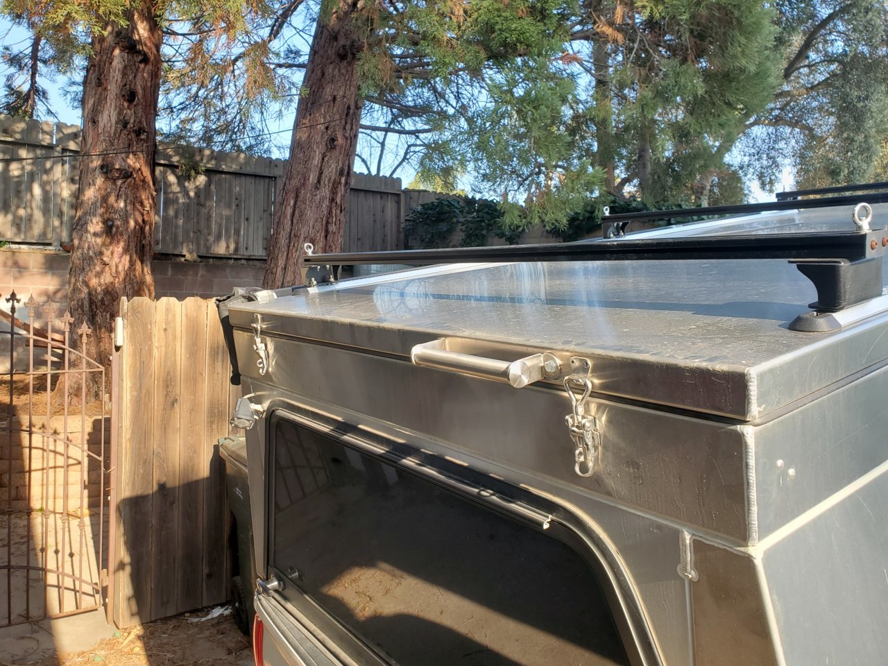

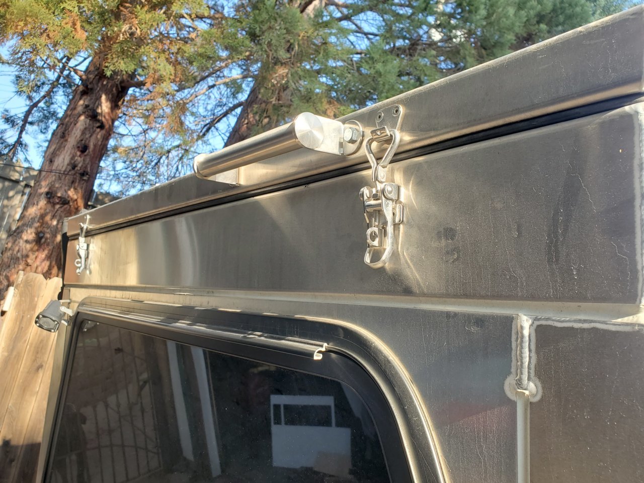

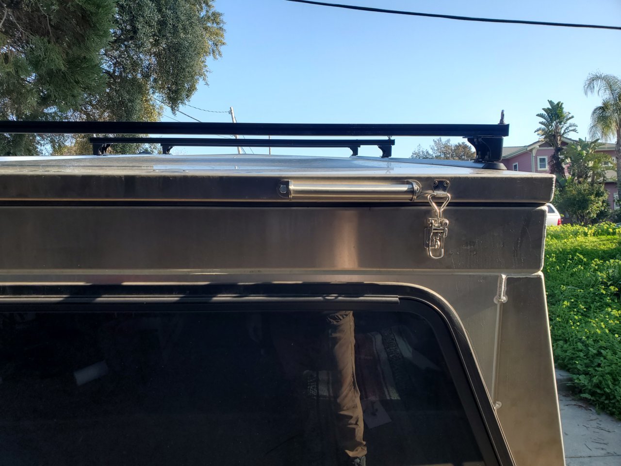

    Couple updates:
    After camping with the full buildout multiple times I have reconsidered my floor plan. With the wife and kid and one more on the way I need more floor space. 20220124_152026.jpgSo much more room for activities.
    My wife also had trouble getting enough grip on the lid edges to get the top open on her own,, so I added a handle. This one seemed to go with the drifter design.20220126_143458.jpg 20220126_143455.jpg 20220126_143503.jpg
