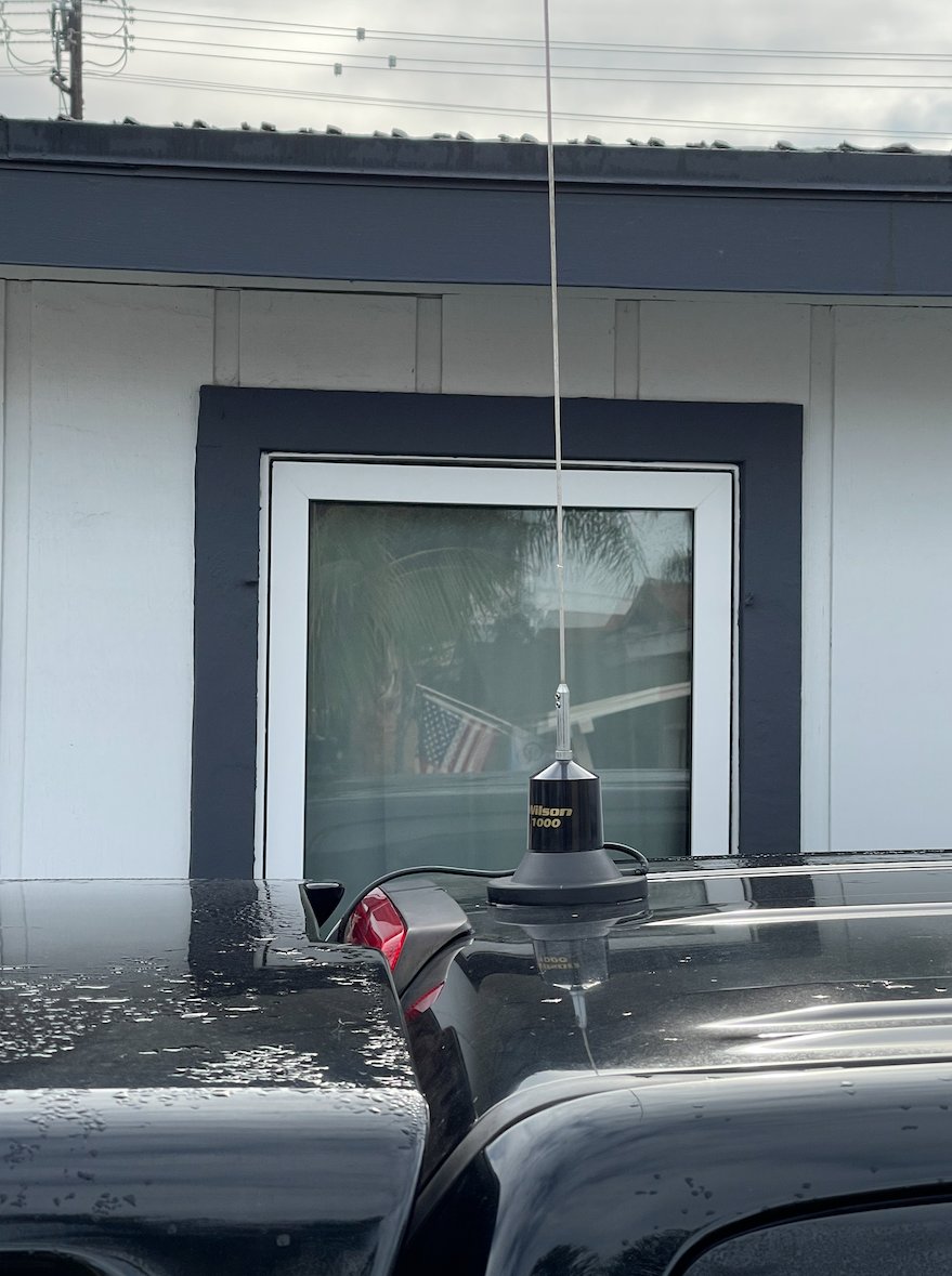

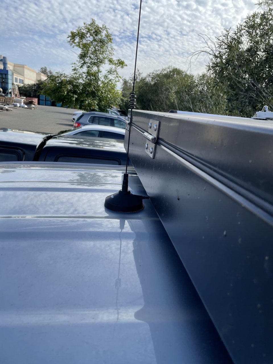

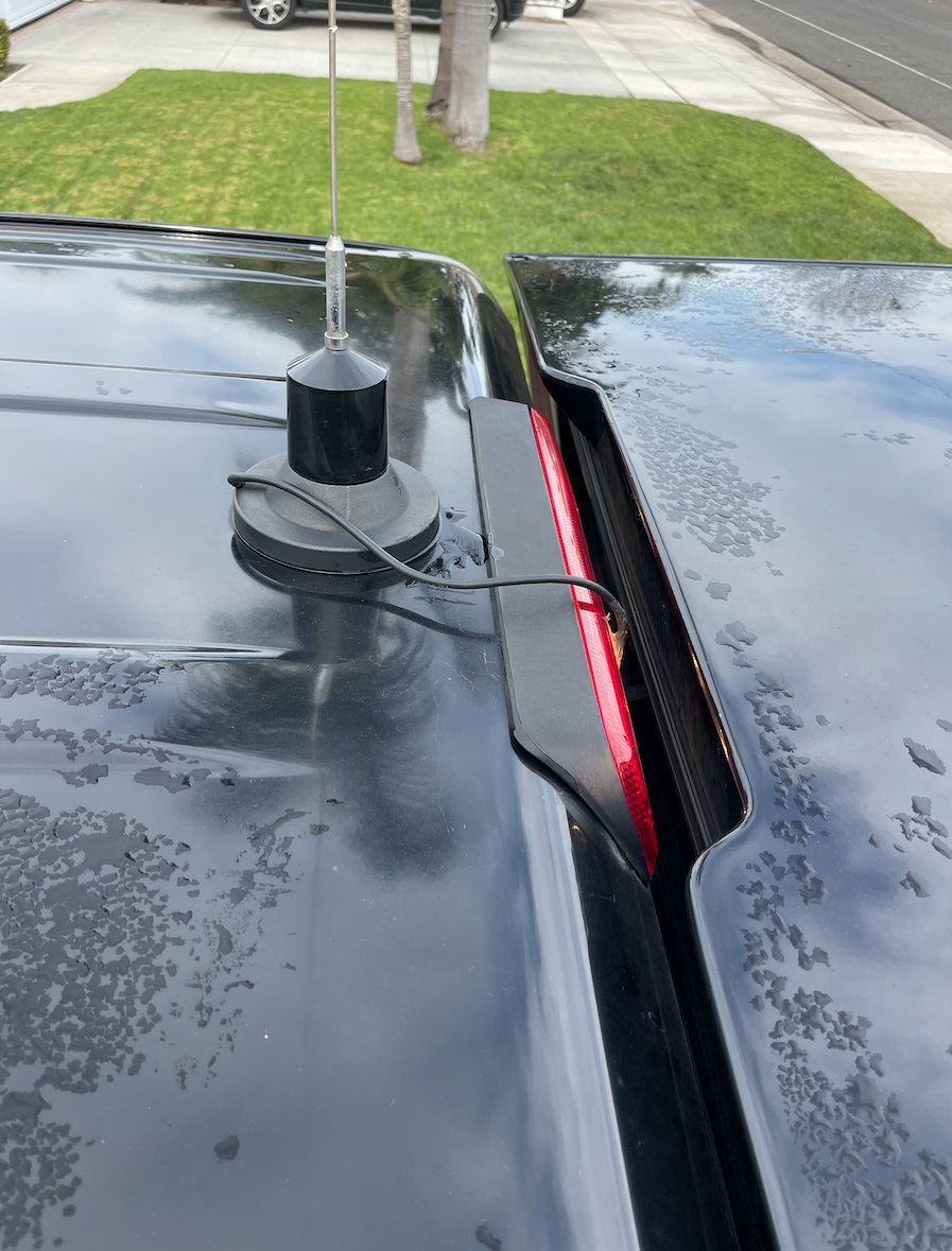

    mine is in a similar location but in the drifter. I stick a steel disk to the top and mounted a magnetic antenna to it.
    SliMbo4.0 and Spacegoth[QUOTED] like this.

    Great idea as well! Would love to see where that cord runs from? Thank you!

    Mine is just mag based to the roof of my truck and the cable runs down the cab wall and enters through a grommet in the floor.

    This seems Very easy for me to change to, thank you!!

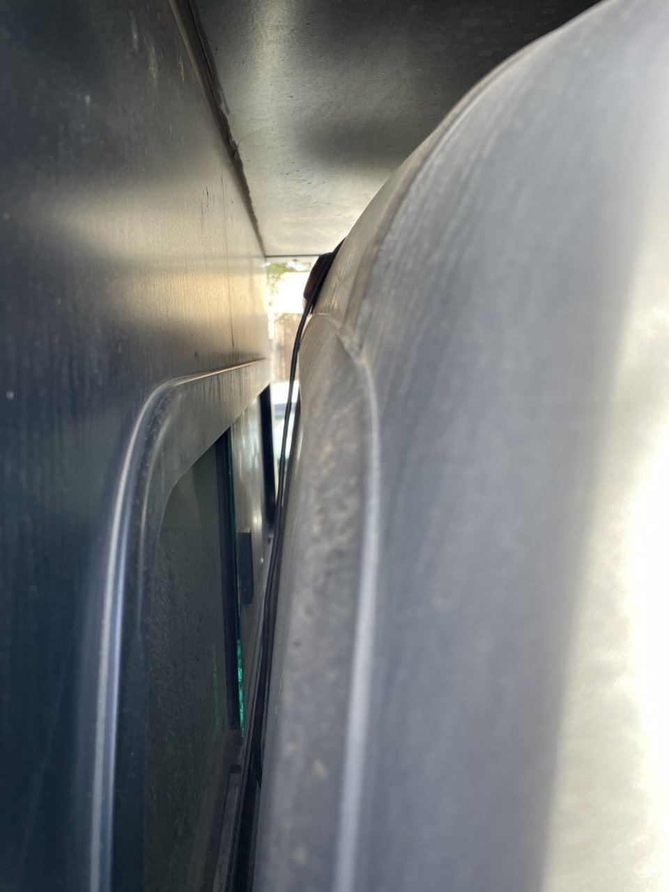

    Does anyone have an idea where I can buy a replacement bulb seal for the Drifter? I want to buy a bulb seal of the correct size and foam density for this application, I have not gotten any responses to messages to Phil or the VO shop. I think I am on my own at this point.
    I suppose 24 months of continuous 350lb of weight might have compressed the bulb seals. I am guessing that bulb seals aren't designed for this type of long-term full compression. In a car door, the seals only compress part way when the door closes. I can see light under the bulb seal and above the KB Voodoo bedrail cap. I have the Drifter clamps tightened to 80 ft-lb per spec, so I don't think there is anything I can do to get a better seal with the existing bulb seal.
    Per Uni-Grip in their Bulb Seal Design section, "The amount of compression that is needed to achieve the perfect seal is typically 25% to 50% of the original bulb size. If the compression is much more than 50% then you risk over compressing the bulb and creating a situation called compression set. Compression set is the negative result of having a rubber bulb not return to its original size after being compressed over a period of time. This can reduce the life of the bulb and compromise the seal creating leakage and warranty issues for your product."
    I am guessing the bulb seals in this application are compressed to near 100% and that might be why I have seeing issues after only 2 years. I have had not a single leak that I knew of until this winter.
