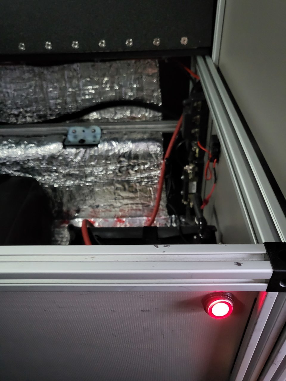

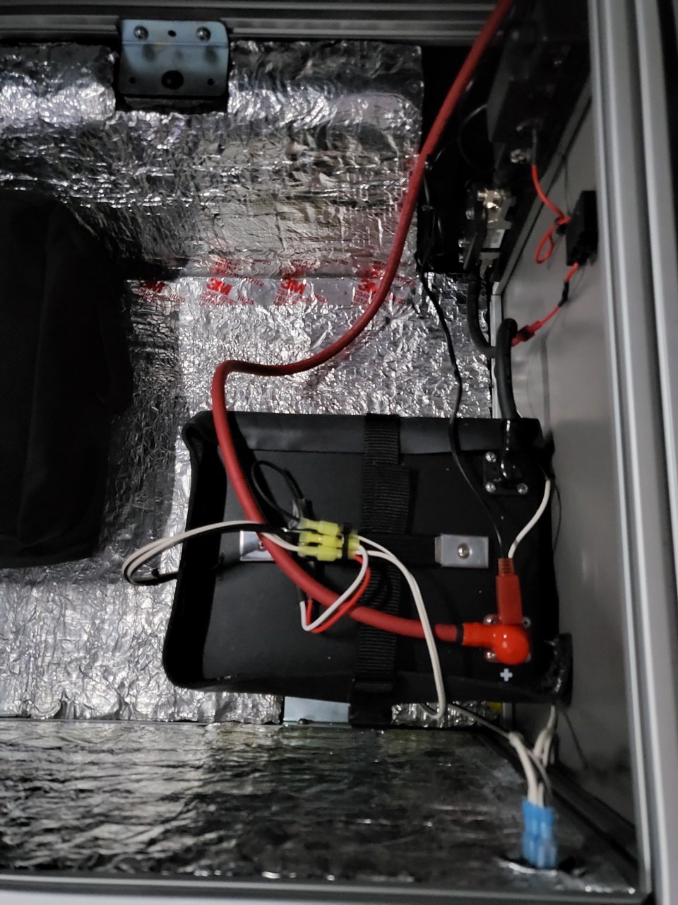

    Did a little project over the weekend, finally wired up my lithium battery heater. Had it installed since last summer but never bothered to hook it up. It has a temperature sensor that turns on the heater when temperature falls below 32F and turns off at 45F. I also added a manual ON/OFF switch and a fuse. Total draw is about 2Ah when the heater is on.

    Nice install @Kclamer. Do you have a link to the battery heater you used? I have searched the interwebs far and wide for a good solution, but I have not found one.

    I used the one that Battleborn sells. Its a bit pricey and was not a perfect fit for my battery size but I couldnt find anything better. A cold rated battery with an internal heater would probably be the best option.
    https://battlebornbatteries.com/product/heat-pad-for-bbgc2/

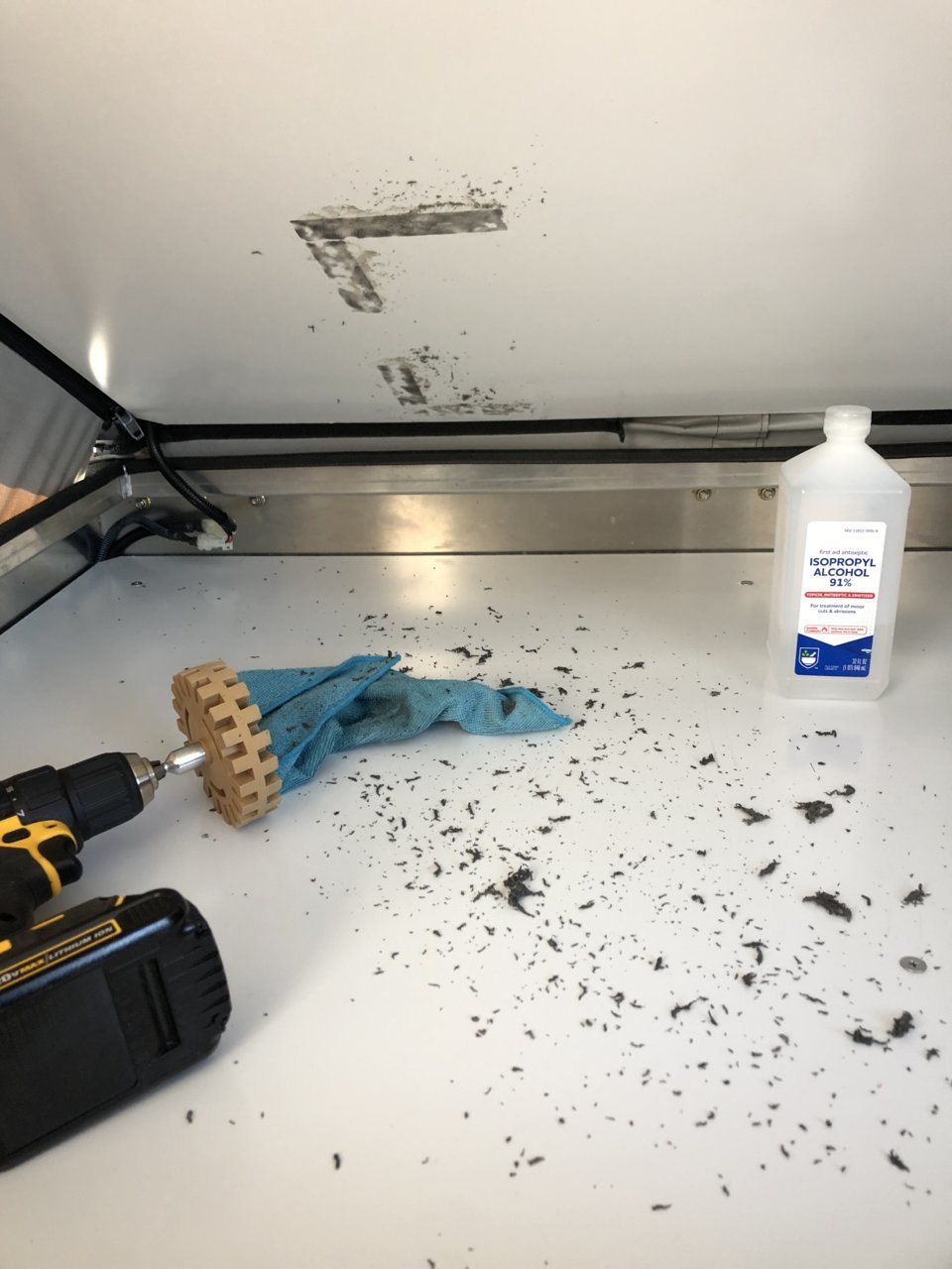

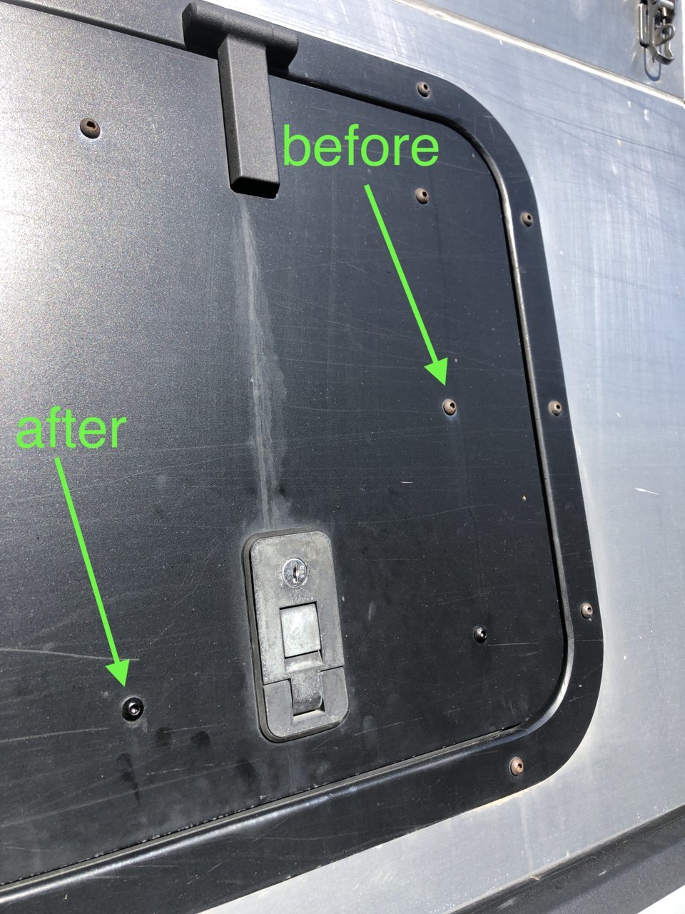

    rehab-ed my frontrunner gullwing doors as the bolt heads were showing signs of rust, (clearly because of the couple months the truck spent in the PNW) i removed them all and sprayed them with rustoleum rust reformer. I also added a gasket along the inside top of the door to help (its worked) with a very small amount of water ingress i had. Then i figured out why my latches on the passenger side were so tricky to open, the bolt securing them was a touch loose, whamo. back in action!

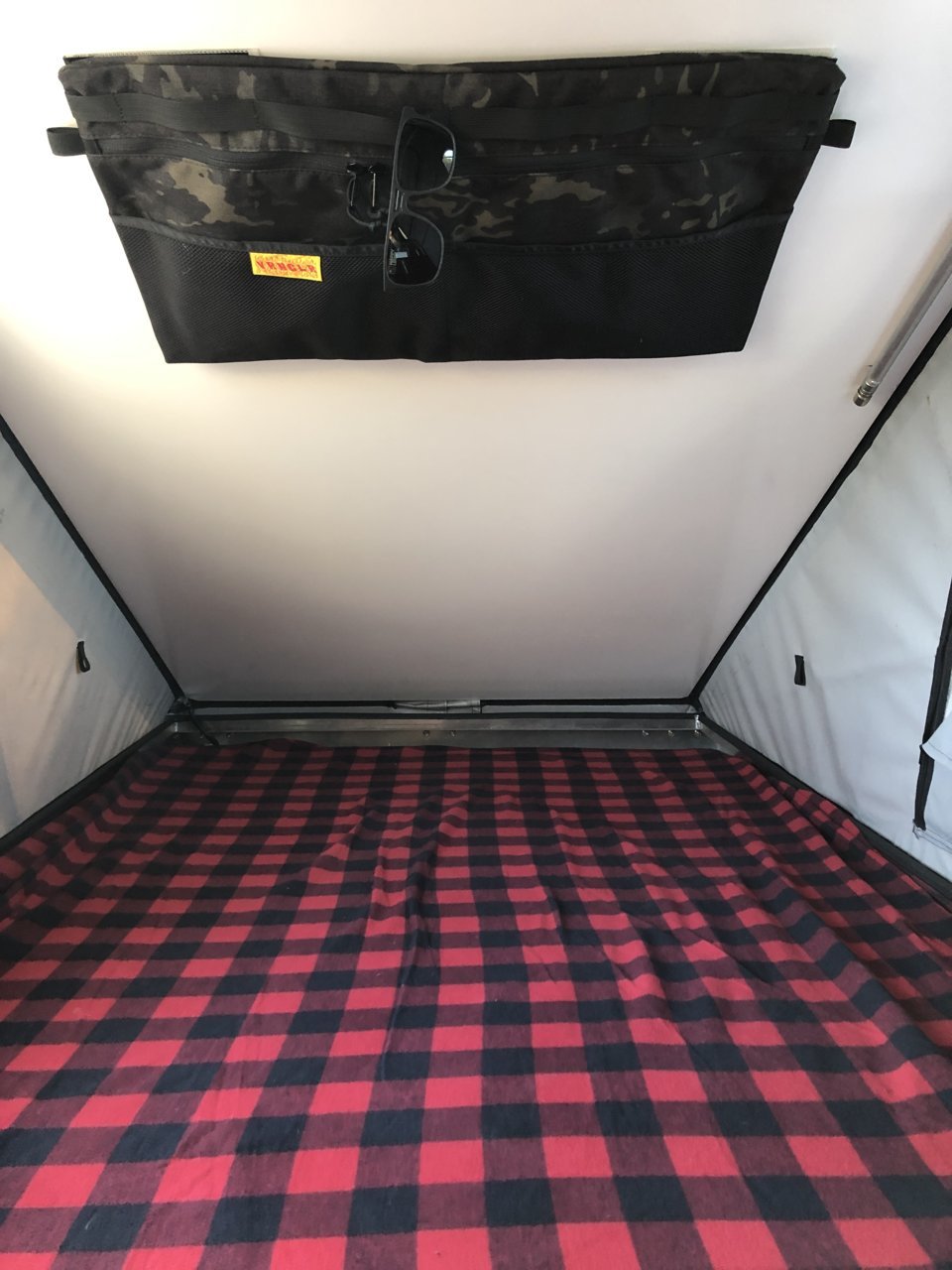

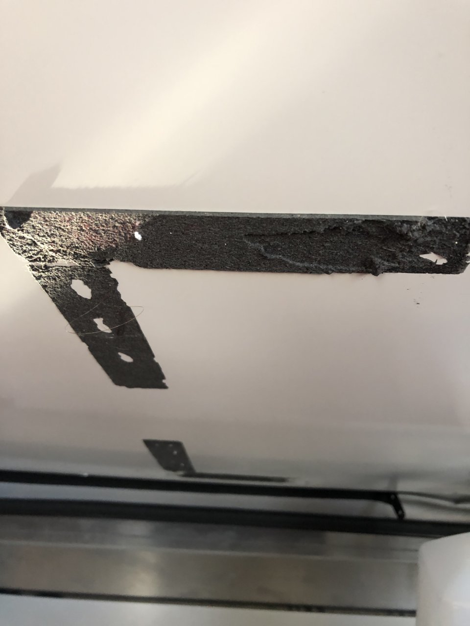

    then after realising the spot i installed my vrnclr sewn storage 'top shelf' (way up in the wedge) was not so convenient - having moved it a while ago the leftover VHB tape had to go. i tried several things - none of them working i invested in this vinyl remover kit. worried that the roof of the drifter would be able to handle it, it all worked out great. some isopropyl alcohol to remove the last bit of glue, back to looking 'sweet as' again
    https://www.amazon.com/FONSWEA-Remo...hdWls&pd_rd_i=B094PRQBQS&ref_=pd_bap_d_rp_1_t
    https://vrnclrsewnstorage.com/collections/camper-and-tent-products/products/the-top-shelf
