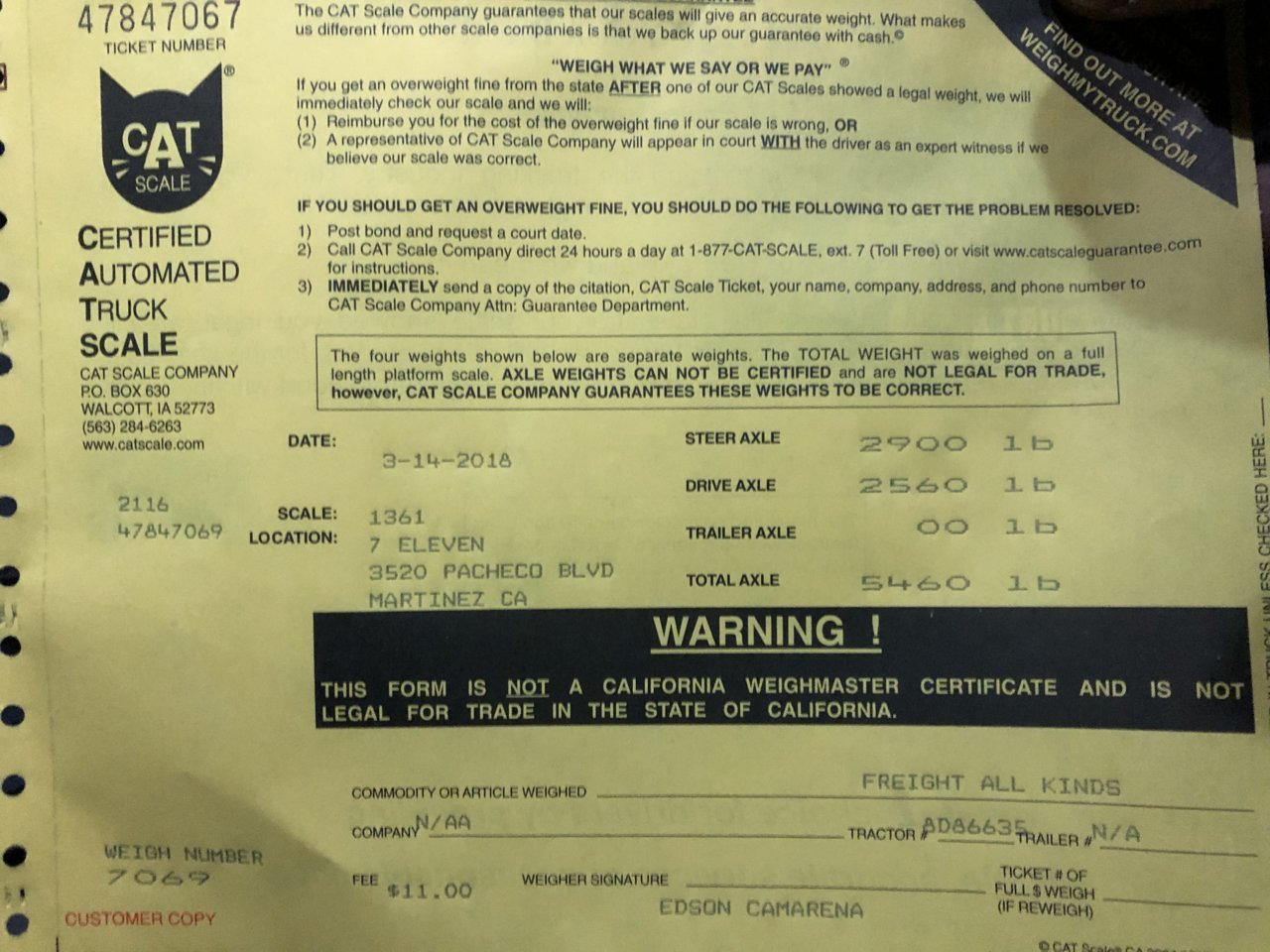

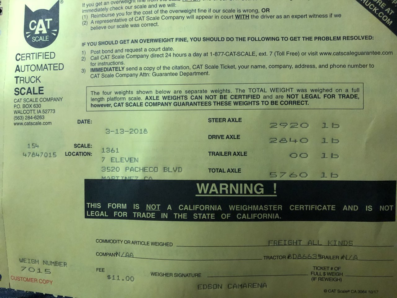

    From March 13th & 14th. Knew these pictures would come in handy!
    There was no mattress or ceiling in the Drifter at the time. And it had the heavier cabover panel.
    Filled up the gas tank before hitting the scales both times... for science.

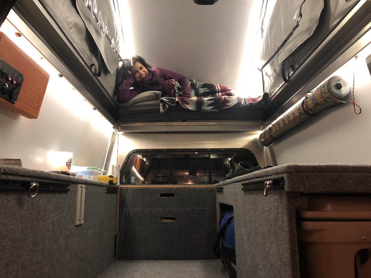

    this is a shot I just threw up on IG.
    My wife found a cozy spot to hang while I worked on my stow away table and mount. Also a good shot of some of the interior updates.
    I made some paracord loops with carabiners to hang out Madmat in an easily accessible spot. It is the first thing out and last thing in when we set up camp. You can also see the front removable tool box that I put upfront. Bottom larger drawer hold a tool roll and some larger tools. It’s also big enough to hold our “little red fire pit” during burn ban months and can be romoved to store our 2gl Dometic cassette toilet for when we are snow camping.
    I made some changes to the Ltrac I had inside. I sectioned it to allow us to open our alubox fully its its inside (apparently I measured really tight) sectioning it also allowed me to mount the fixed portion of our table bracket higher up. This allows us to raise our table to almost bed platform hight. Idk maybe for watching movies? Either way, we have the adjustability!
    Lastly you can see a little bit of my “custom” ARB electrical box/switch panel... more on that later :D

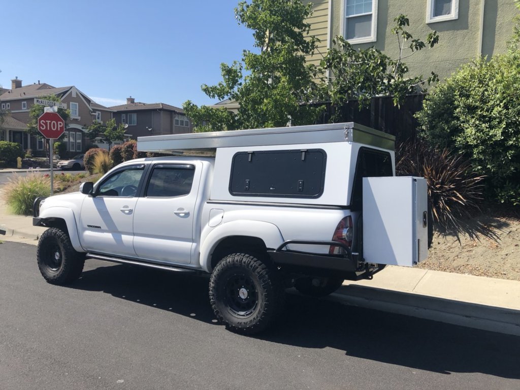

    I just finished up re configuring my swing out set up over the weekend. If you are needing a good mount option for propane I highly recommend the new mount from Expedition Essentials! @Jeff@ExE has this thing dialed in and its nice to have the option to run a 10# tank if needed in the same mount. Loving it so far!

    I finished the reconfig of my swing out to fit the new propane bottle mount and figured I might as well make it work while I'm at it. Pay no mind to the fuel pack, it was just for test fit since my water packs were both full :D

    How are you going to run the propane line into your camper? Do you just connect/disconnect when you open the swingout and have to use it?
