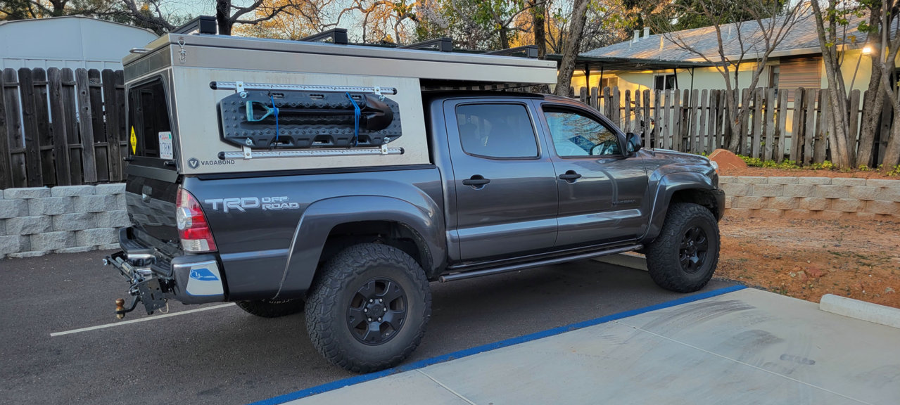

    *** FOR SALE ***
    Selling my Vagabond Drifter. Its in perfect condition. Located in Northern California.
    • Full interior light setup
    • Insulated
    • Front runner roof rack
    • L track on both sides for Maxtrax, gas, etc.
    • 14" Maxxair fan
    • 10" bed extension
    I will include baltic birch baseplate with vinyl flooring as well as mattress topper. Dm if interested.20220209_170803.jpg
