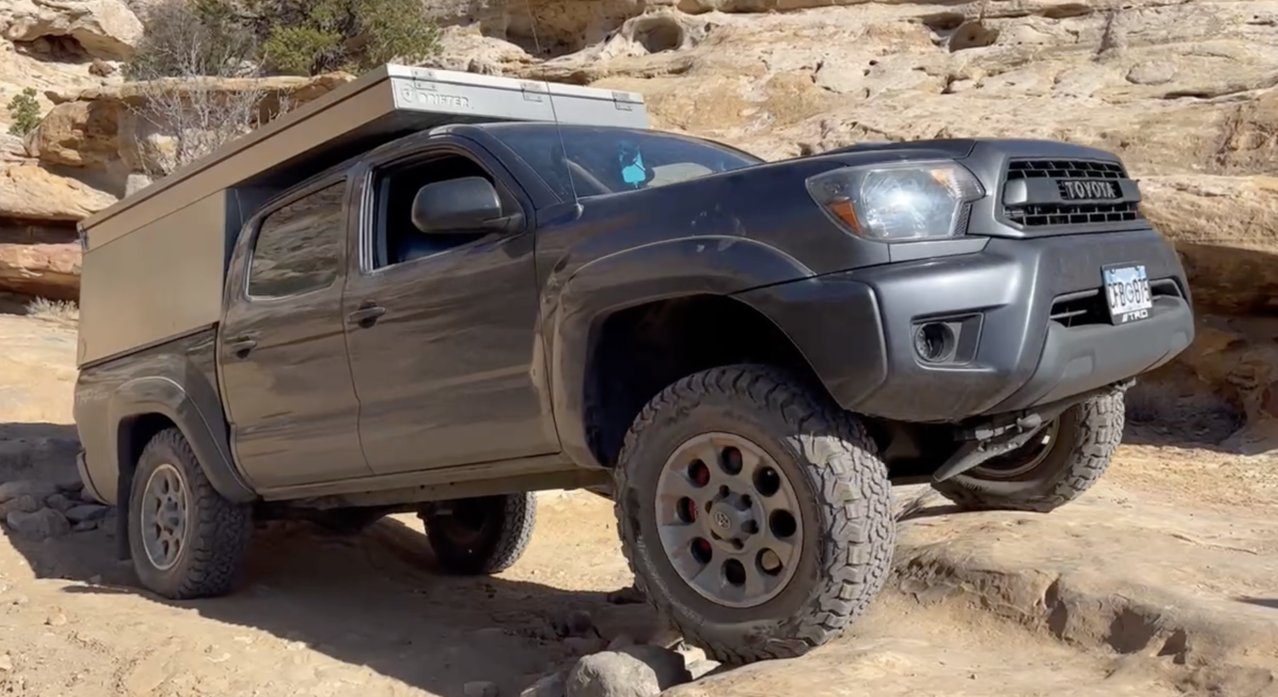

    I would have moved it back a foot or so to tell people it's the world's smallest 270 degree awning.

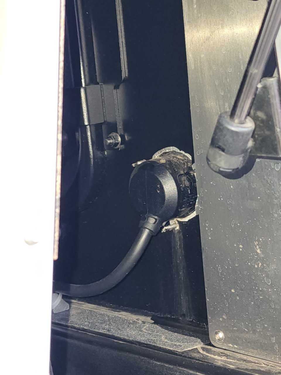

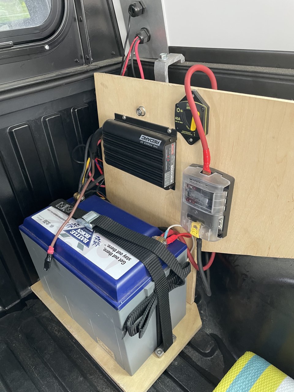

    Can you post some photos of the inside showing how that NOCO A/C power plug looks on the rear? I'm planning on installing one of these soon as I dial my electrical design.

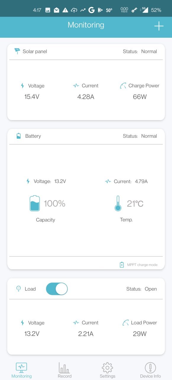

    Drifter and setup made a bachelor party in NV great this weekend.
    Fridge and power didn’t have any hiccups from Thursday night when I started packing until Monday evening when I cleaned out the fridge.

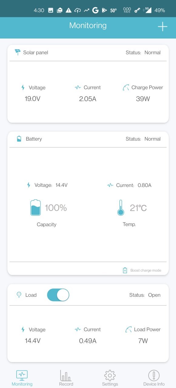

    Come today when I went to do a final wash inside the fridge, nothing in the back worked. Charge controlled showed incoming solar and alternator power, no breakers or fuses tripped but no lights or fridge power. Start tracing wires and found this.
    I didn’t hook the charge controller output back up when I took all my pieces and parts out when I stored my truck a couple weeks. Whoops.
    No solar or alternator charging to the battery and everything ran all weekend! Pretty happy with that unplanned test.
    Now it charges for who knows how many hours on an AC charger to get it back up to charge.

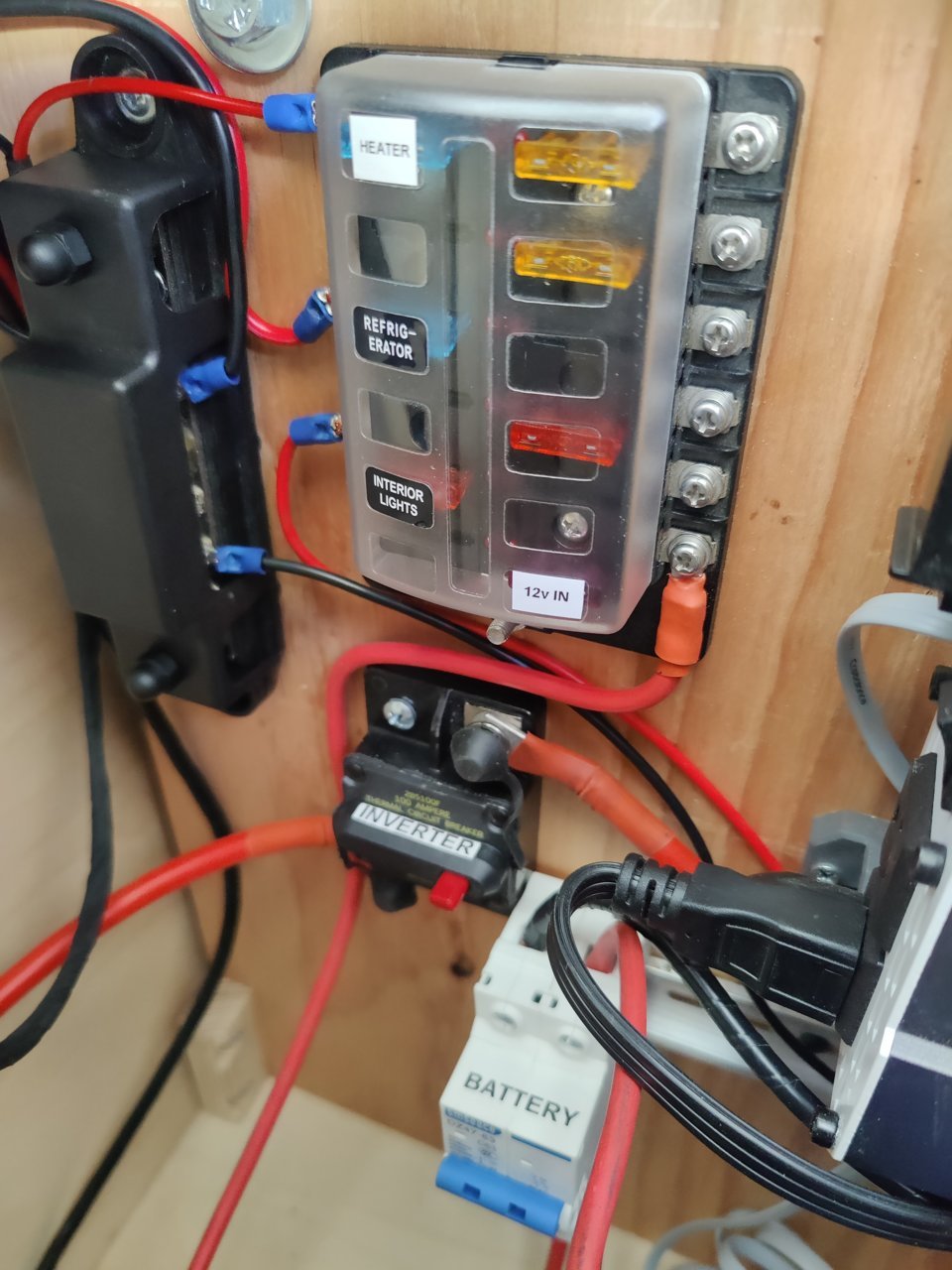

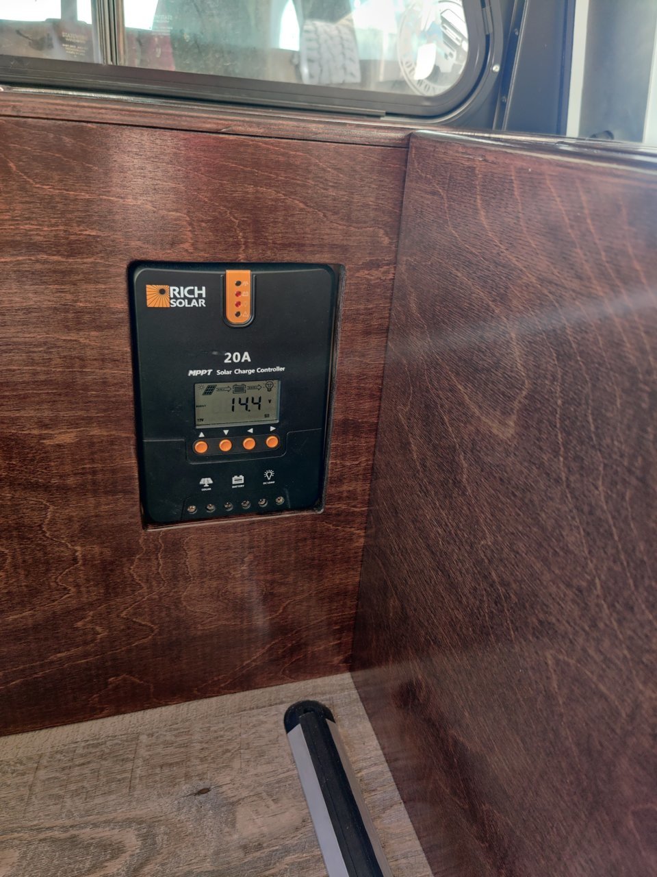

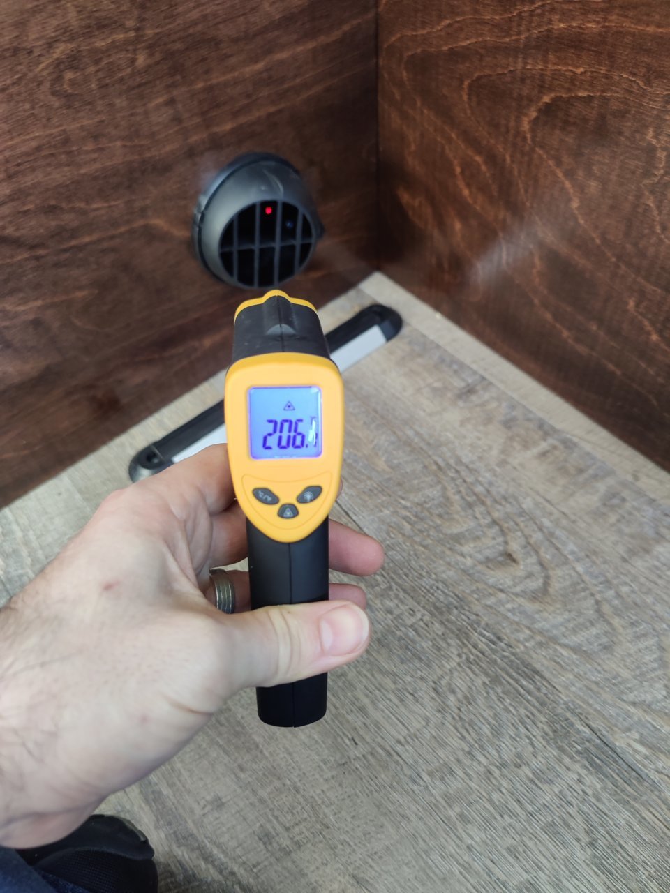

    stock af, but hover if you think you disagree... RV living: Vagabond Drifter (6' bed) Custom bed cabinet buildout 175w Renogy solar panel 40a Rich Solar MPPT solar controller 1000w Wagan Pure Line inverter Lavaner Pro 2kw diesel heat exchanger Suspension/wheels: Toytec Aluma 2.5 front shocks with resis 13x700 coils (soon 14x700) Toytec Aluma 2.5 rear shocks SPC UCAs Deaver Stage 3 rear leaf springs Wheeler's 3 degree axle shims Wheeler's U-bolt flip Wheeler's Super Bumpstops 18"x9" XD Monster (x5) 275/75/18 Cooper ST MAXX (x5) EBC Stage 3 pads/rotors Electronics: Kenwood DNX773S iDatalink - Maestro RR Stubby Antenna No-name Switchback LEDs Hella Sharptone horns (no relay) Relocated backup camera w/DIY bracket Armor/recovery: BruteForceFab Rear HC w/swingout BAMF Sliders (DOM, 10 degree w/kick out, rattle-canned) BAMF IFS Skid (BAMF powder-coated) BAMF Mid Skid (BAMF powder-coated) BAMF TC Skid (BAMF powder-coated) BAMF LCA Skids (BAMF powder-coated) BAMF Rear Diff Skid (early model, powder-coated) BAMF CMC Plates US Offroad Winch Bumper Smittybilt X20 10k synthetic rope winch Total Chaos Bed Stiffeners ARB compressor w/air-up kit DIY cowl snorkel ARB rear air-locker Interior: Husky Floor Liners (F&R) Rear 40% seat-delete Hinged fridge platform in place of rear seat Exterior: CaliRaised Low-profile Ditch Light Brackets CaliRaised Side-projecting LED pods CaliRaised Faux TRD Pro Grille Morimoto amber LED fog lights One-of-a-kind 1GRFE plate (second iteration) Removed: OEM Bed Mat CaliRaised bed molle panels
    Got the heater wired and plumbed.
    The initial start-up produces some serious heat, but after the engine gets to temp, the heater goes into low-production mode.
    It also draws some decent power on start-up, but calms down on low.
    Start-up:
    Low (1.2hz):
    Idle:
    916TacoTruck, SliMbo4.0 and rob1208 like this.

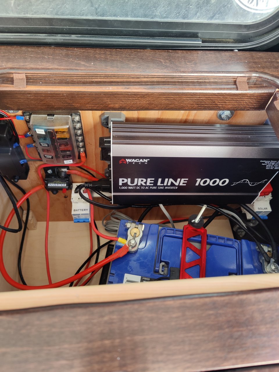

    Still need better cable-management, but this'll do for now.

    Here is a picture of the back of the ac adapter.
    JasonLee[QUOTED] likes this.

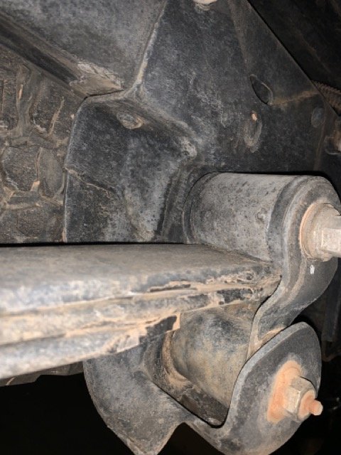

    My Dobonsons 112's have been great, but I'm not overloaded.
    Drifter, Hest mattress, 50L fridge, a few bins with tire chains, spare oil, hand tools, two bikes, hitch rack, 20# propane tank, kitchen bin. No interior. Stock bumpers, no sliders.
    I guess if you have a heavy steel bumper with swingouts and a big spare as well as an interior, you may need the 113's.
    I just spent a week in Canyonlands flexing out the Dobinsons with stock hangers and shackles. I haven't crawled underneath to do my post-trip inspection yet, but that will happen soon and I'll post an update. I have NOT trimmed the second leaf even though I am aware of the potential shackle interference.
    EDIT: Apparently I didn't wheel hard enough to flex/spread the 2nd Dobinsons leaf into the shackle. No signs of damage.
